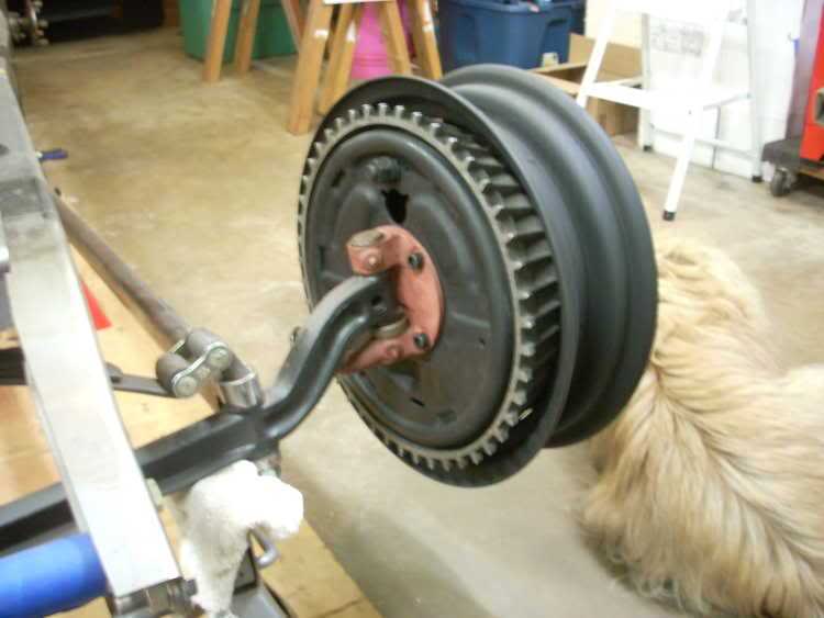

  10. Unless you like the drum being way exposed, you will need wheels with some decent backspacing. Not a reversed type wheel. Study the pics above by J, the one with black wheel looks much better. It also puts the center of the tire at approx the line from the kingpin extended down to ground level. This line should be at the center of the tire for best handling.
    Just mount any wheel and see where it lines up. Then decide to add or subtract backspace distance from that wheel to get the desired end result. You may be able to find some stock wheels that will work, or may need custom offset.

  15. Jmountainjr
    Joined: Dec 29, 2006
    Posts: 1,869
    Jmountainjr
    Raven - Not sure about the wheel in the pic as it's not mine. I kept the Buick drums mounted to the Buick hub and used bearing adaptors from 29Rat to mount to my spindles. So I kept the 5 on 5" bolt circle that's on a bunch of big Chevys, Caddy, vans, etc. I'm running 15" wheels, and settled for 5" wide rims on front. They have a 3" backspace and my drum exposure is about like the black rim pic I posted. I've not played around with the 4.5" bolt circle, so I can't point you to a specific rim for your application. If you can't seem to locate anything, perhaps you can contact WheelKid and he may be able to help.
