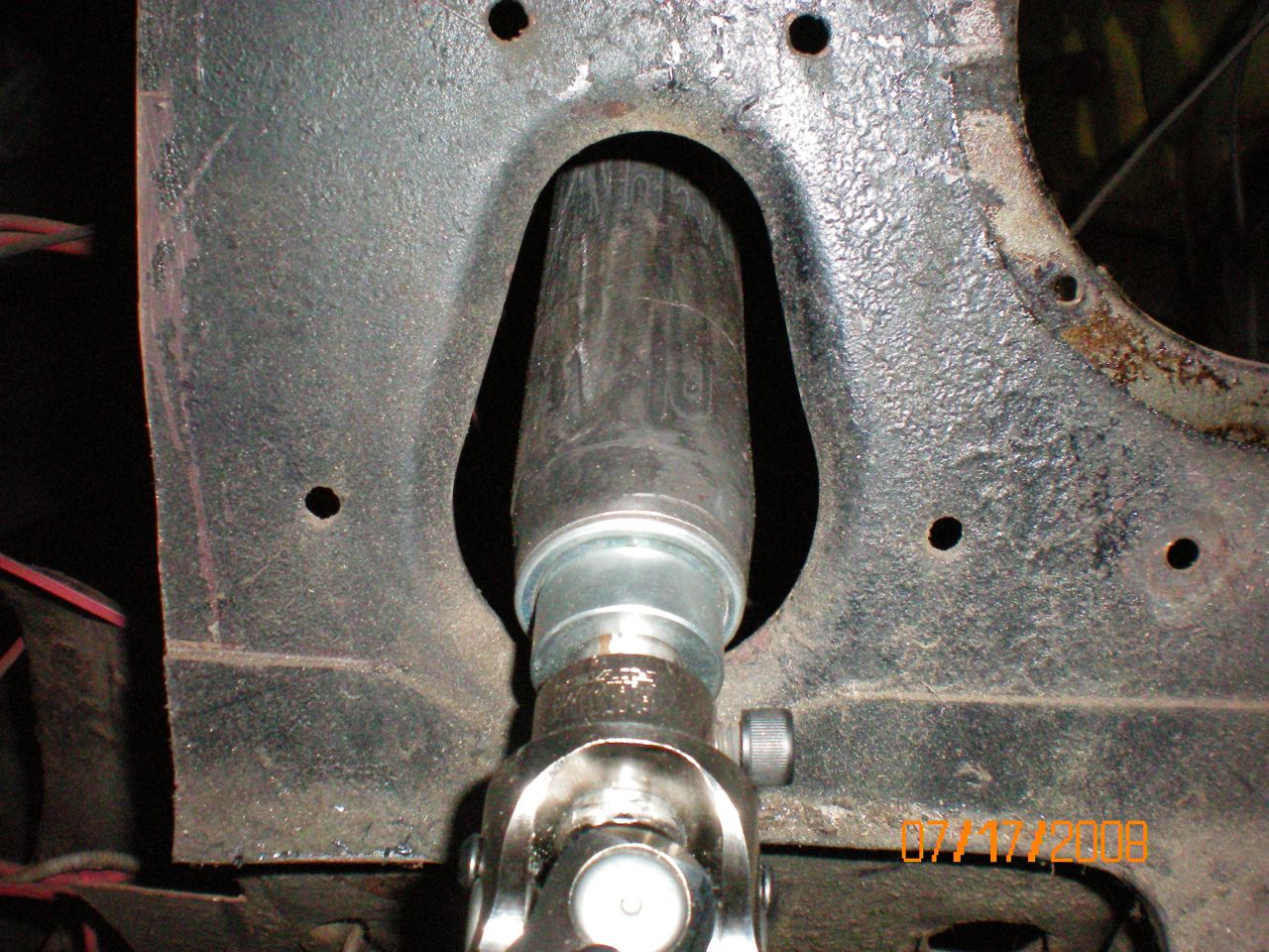

  8. Heres a couple pictures of how I did the modification on a 51 I use to own.
    As Squirrel mentioned,the bearing might be a bit smaller than the tube.
    So at the end of the column tube it tappers into a smaller diameter. Utilize that by shaving it down(and keep the cut square) with a cutting wheel or grinder blade and test fit the bearing until it fits snug.
    Now go back on the tube and cut to shorten tube to desired length.
