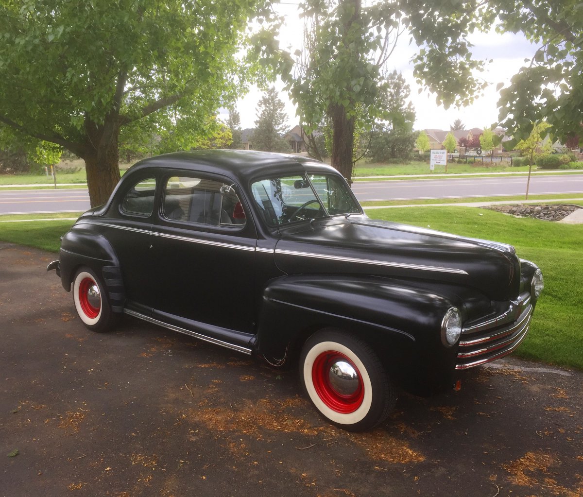

    If you want gloss and you are painting a car, sure, but if you have a car like that '46 Ford it might be a great option to get a whole new look.
    05snopro440, skooch and BJR like this.
