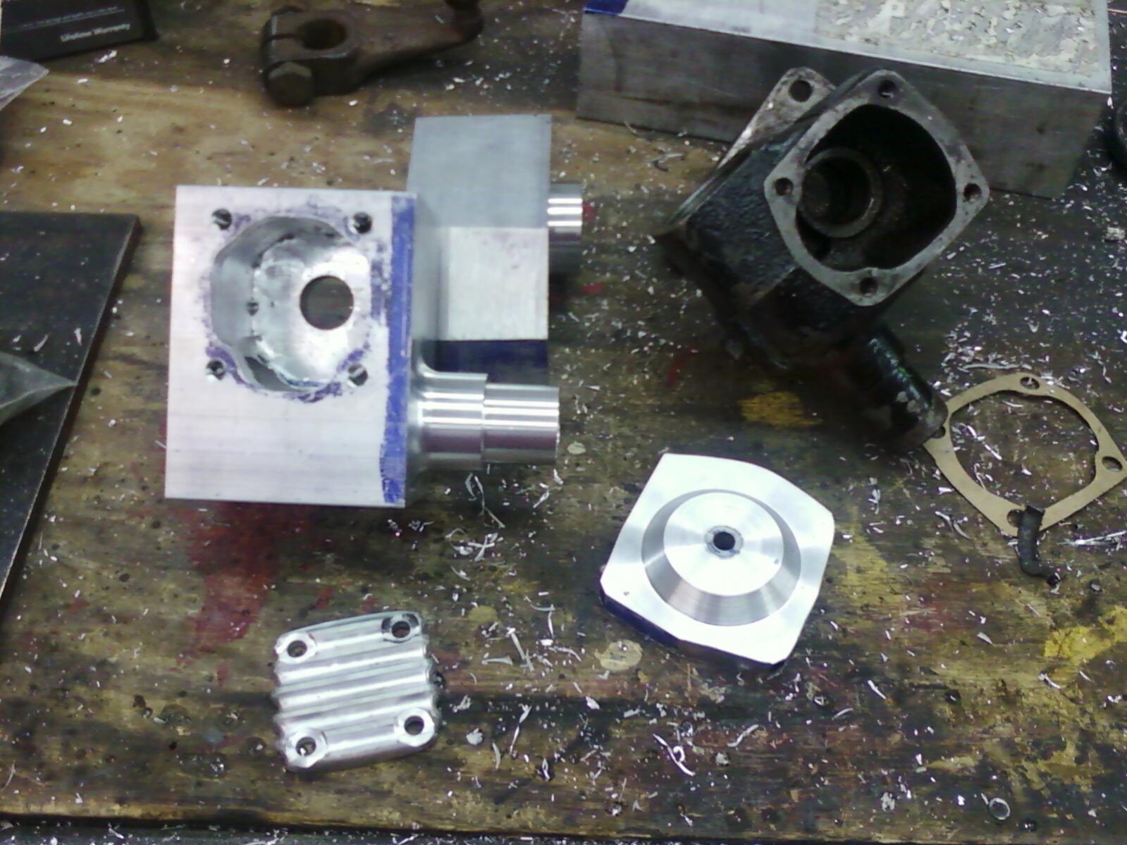

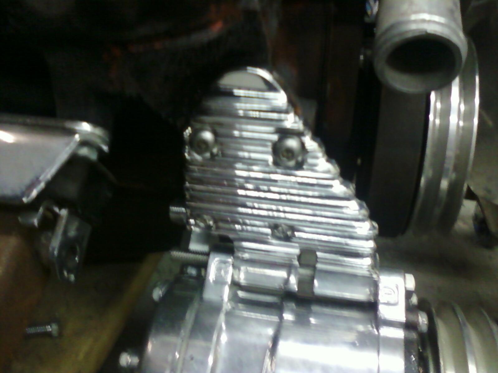

    after so many bashing threads about harbor freight crap i wanted to post some stuff i have made with my 9x20 lathe and bench top mill. both cheap china crap but are good castings. with some help from my friend joe we set the machines up tight and went to town making some parts.
    f100 steering box
    slave cylinder for camaro t5 bell
    trans crossmember
    throttle linkage
    37 degree AN fittings.
    throttle pedal
    ac bracket

    In that top right picture of the steering box,... how were you able to get the round (where the shaft goes thru) protrusion "off-set" on the square block?? It comes with a 3 jaw chuck right? I am under the impression if you used a 4 jaw you would be able to "offset" the block in the chuck jaws so the shaft area would be centered, just confused?!?!? I'm no machinist, and I can't figure it out. BUT VERY IMPRESSED!!! Also very ingeneous on using the fuel pump bolt holes for that mount. Ken

    due to the size of the block for the steering box first step was to bore the holes for the steering shaft and pitman arm shaft. then box was held off those hole in the 3 jaw chuck and turned from there. many hours spend thinking on just how to set up the tools to work with what i had to do.

    Ahh haa, I get it!! Makes perfect sense (now that you explained it)!! DAMN GOOD JOB!!! Very impressive...Ken
