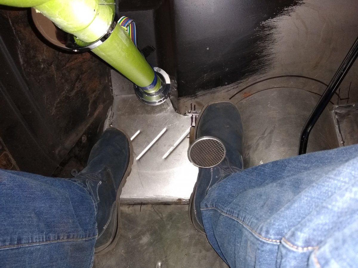

    I've seen pic of the throttle pedal on to of the trans tunnel but that work for me. I was thinking of getting a brake/clutch bracket and use only the clutch lever for the brake. Anyone else have this issue? There is no room for my size 14.

  2. goldmountain
    Joined: Jun 12, 2016
    Posts: 4,822
    goldmountain
    Why don't you just cut off the mount for the brake pedal and instead of it turning to the right, weld it going left?

  5. Do it Over
    Joined: Dec 25, 2017
    Posts: 478
    Do it Over
    from NYC, NY
    Thought of that and it's a must do but it still doesn't make more foot room. I want the throttle on my side of the tunnel but not up under the brake lever. My size 14 is really hindered by the lever location. My thought was to get a clutch/brake bracket and weld the brake booster lever on the clutch arm, remove the brake level using the clutch to activate the brakes.

    If you choose to not move pedals you can sink a heel pocket into the side of the transmission tunnel and build your gas pedal assembly accordingly, assuming the trans case is not tight to the tunnel. I've seen it done many times but apparently my Google search skills are deficient today.

    I sympathize and I'm only fighting a pair of size 12's.It seems like every fraction is a fight. You definitely don't want a gas pedal under the brake or under the edge of your foot on the brake. That would make a brake failure an even more exciting ride. Like HRP (who types faster than me) said try to move the M/C to the left and as others have said mount the pedal on the left side of the arm. From your pictures it looks like the pedal will clear the steering column with enough room for you to be able to get your foot solidly on the pedal.

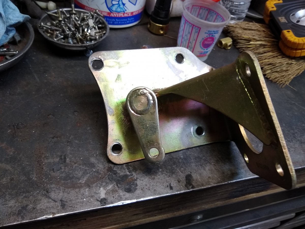

  11. Bandit Billy
    Joined: Sep 16, 2014
    Posts: 15,195
    Bandit Billy
    Gotchya 6 bro!

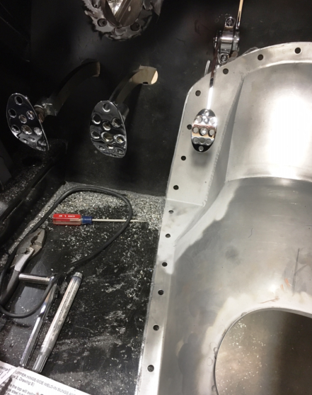

    I fabbed this one up for my 34 a couple years ago. Not much real estate on that floor board for 3 pedals.

  15. Bandit Billy
    Posts: 15,195
    Bandit Billy
    Its an option. I didn't have any other choice, I couldn't go to the left with the pedals so...
    If you go this route make sure account for the sound deadener, pad and carpet thickness.

  19. no need to move the master cylinder , heat and bend the brake pedal arm. then poke a new hole through the toeboard
    the pedal pad needs to be moved over to the other side too, as goldmountain said

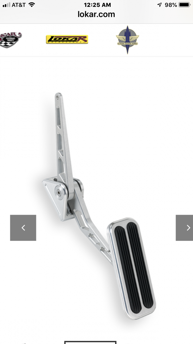

  20. 19Eddy30
    Joined: Mar 27, 2011
    Posts: 3,418
    19Eddy30
    from VA
    Put the gas pedal On Left ! :eek:
    My self size 14 , Im asked all the time about wheres my gas pedal because not seen , its High on firewall

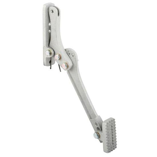

    (30 FordA) with mounting tabs but with no bolts/screw holes going through firewall just the cable ,i used this style from Lokar , I-like this model because cross shaft is supported on both sides, I made brake Paddle with offset and different Pivot points,, OP Just take a few minutes or so , think look around and come up with a solution that will work for you and be safe , Brake pedal Is way far to the right , how about a picture of your master cylinder and brake pedal from underneath your vehicle ,

  23. 19Eddy30
    Posts: 3,418
    19Eddy30
    from VA
    Yes that looks Hot Rod , but cast . I prefer billet aluminum one , I added needle bearings , I put the miles on my car and race it , I need to make sure no possible binding at over 100 mph in the 1/8th
    Again you have to bend down and look under to see my gas pedal, I'm into nostalgic looks/parts .
    My 60s Eelcoo tank & 60s Moon hand pump on my steel 32 build will be used for the meth injection ,but most I do I modify parts to suit my needs to give a HotRod vibe ,

  24. Bandit Billy
    Posts: 15,195
    Bandit Billy
    True but they look better smoothed, polished...and lightened a bit.:cool: Also installed bushings to take the slop out. Sold it to a fellow HAMBer .
    nochop and 19Eddy30 like this.

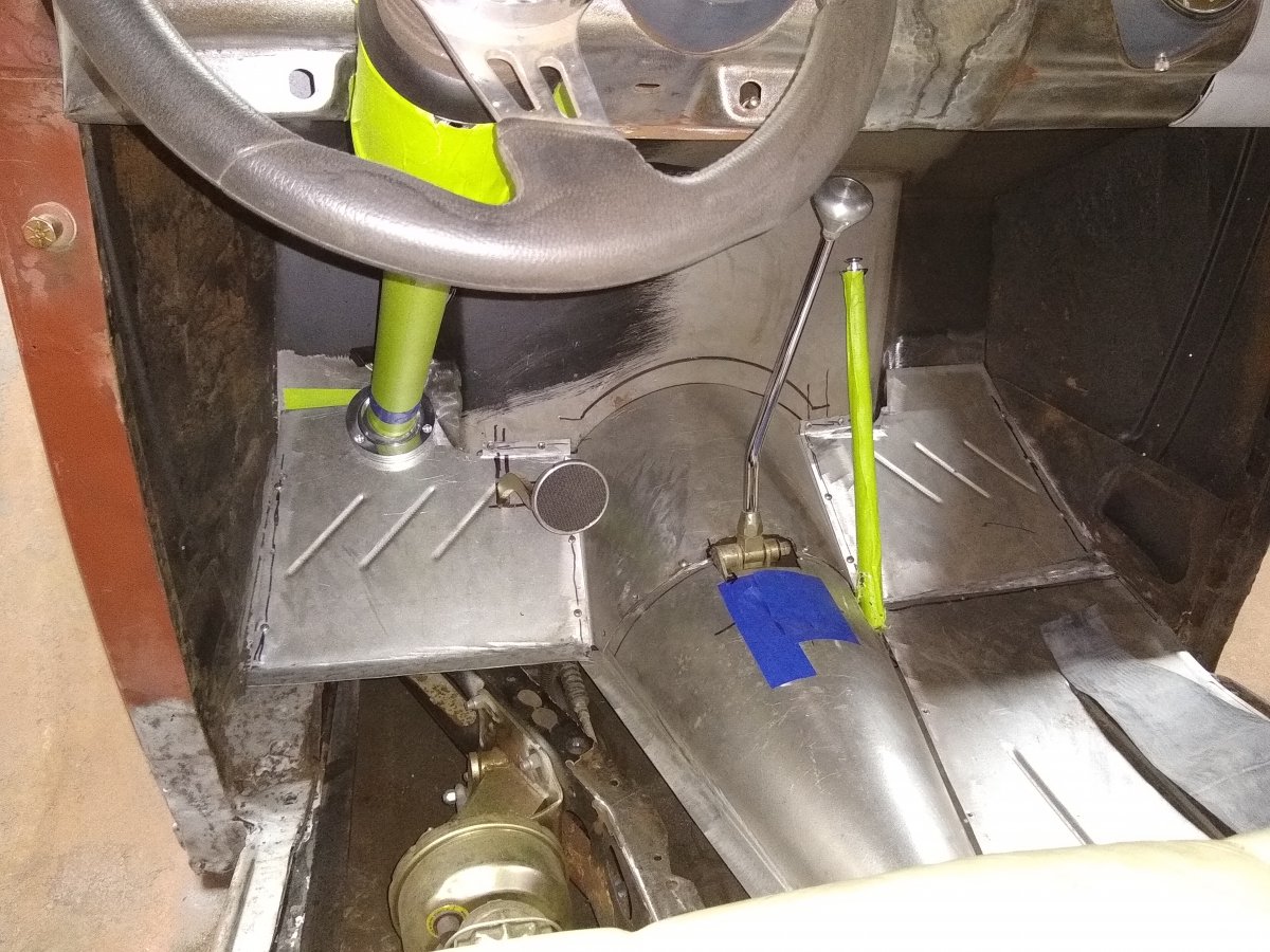

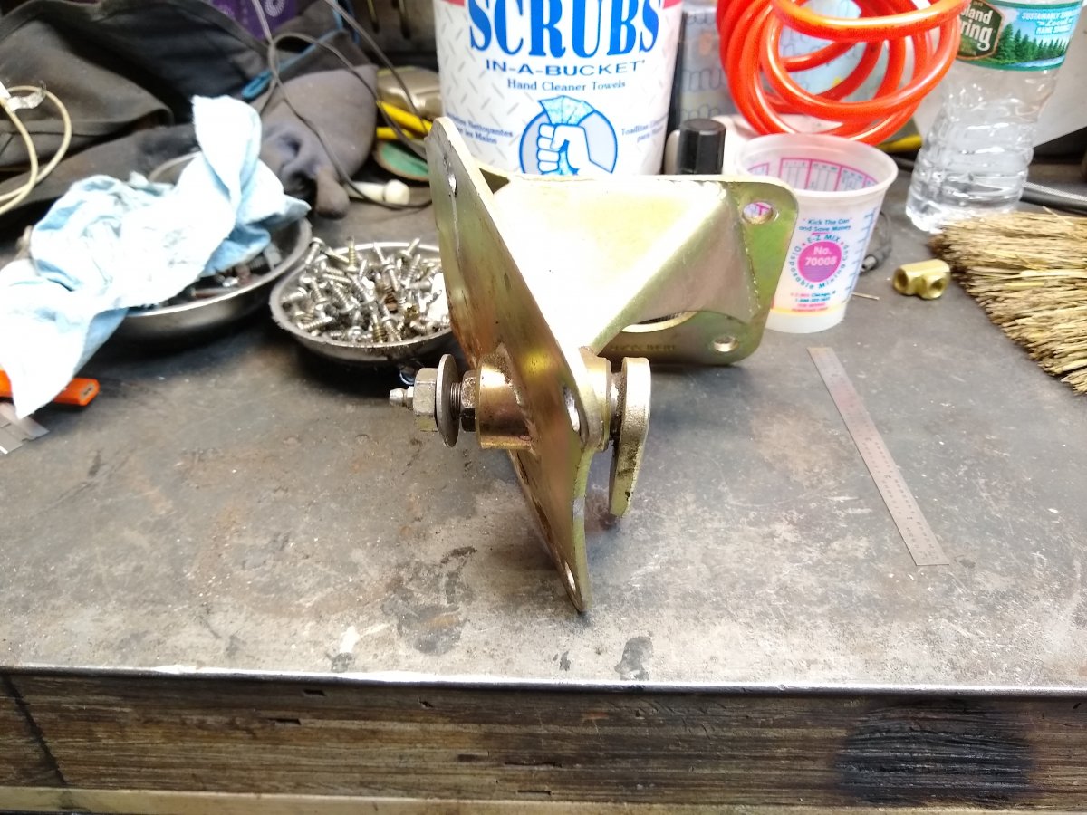

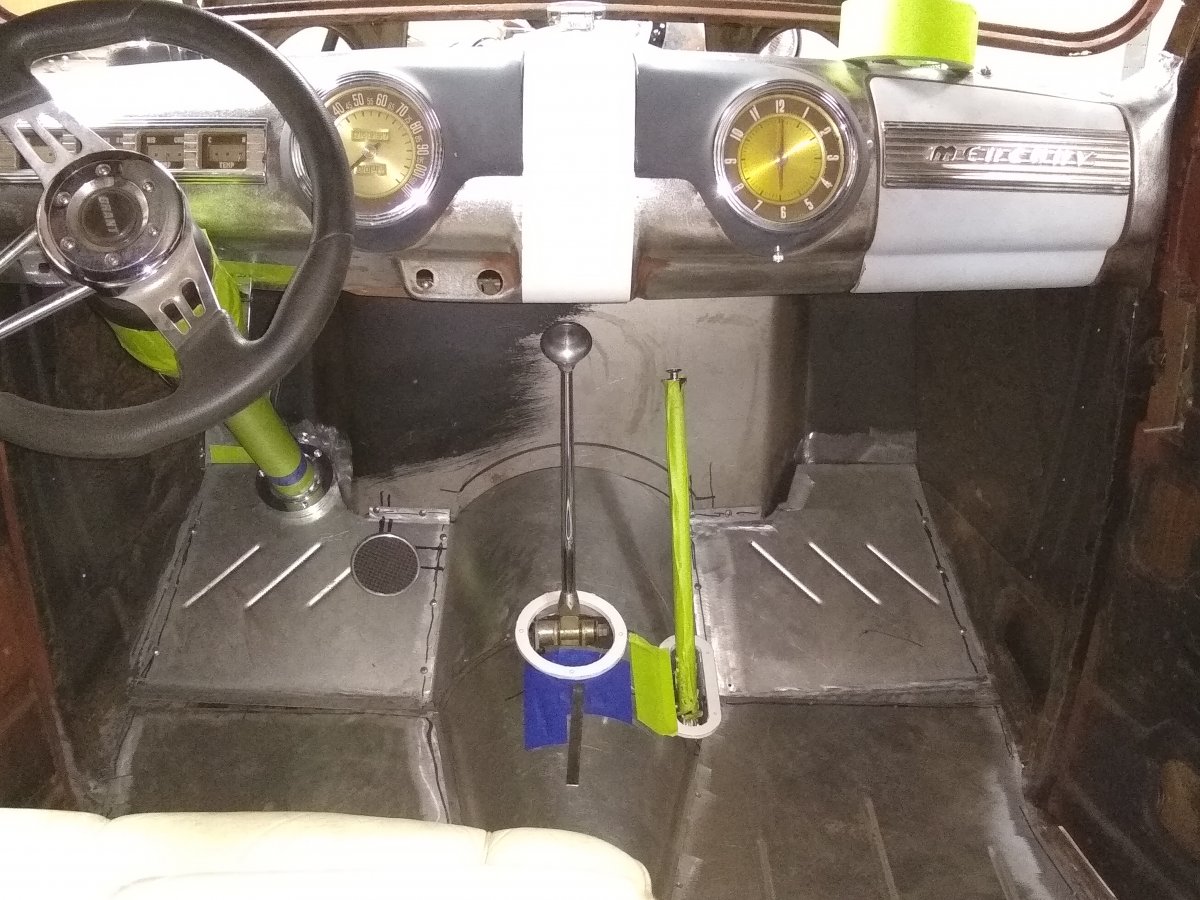

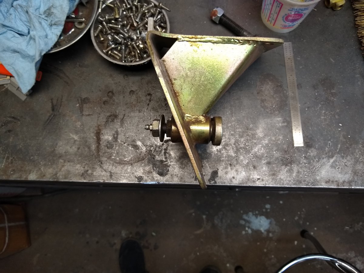

  30. Do it Over
    Posts: 478
    Do it Over
    from NYC, NY
    Here's some more pics of what I'm working with.
