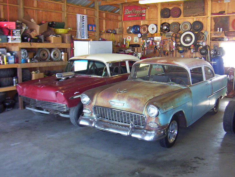

    \'55 chevy and RUGRAT .jpg I have a similar set up in my '55 chevy and 4spd, 355ci , roller rockers, aluminum factory mid rise Vette intake, 2.20 valve 461 double humps because they are traditional and flow well, I am not sure the specs on the 30-30 cam but my Engine pro cam is .510 lift and works perfect with flat top pistons getting the CR around 10.5:1, The desk top dyno program said about 390 hp, but my estimate would be closer to 350hp which makes it alot of fun.
