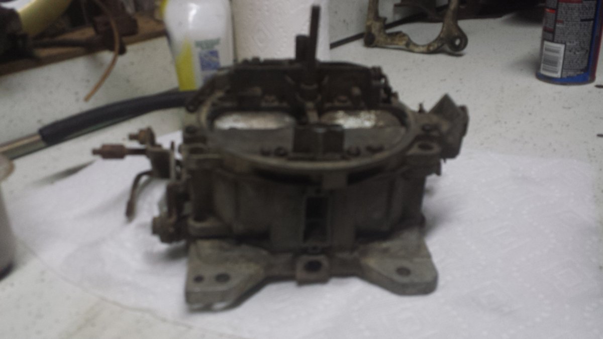

    Got a 4bl Carter Quadrajet ("mfg for GMC") on a cast intake. OLD and NASTY! The numbers I can read are - "D36 (R) (C) 70A7687" maybe(lol) on the main body, "47876" on the front linkage and "44889" on the back. ...and is it worth rebuilding?

  12. vintage44
    Joined: Dec 27, 2007
    Posts: 290
    vintage44
    from NY
    1. New York H.A.M.B.ers
  13. vintage44
    Posts: 290
    vintage44
    from NY
    Here ya go, squirrel.

  15. squirrel
    Joined: Sep 23, 2004
    Posts: 59,227
    squirrel
    looks like an mid 70s chevy carb, from what I can see. I'd look a little closer to see if it has a number stamped on it...maybe rub some sandpaper on the pad where the numbers should be? I have one that looks just like that, 17058213 number showed up after I did a little sanding. 1978 chevy truck carb.

    Eureka! The application of some 'magic' sandpaper at the right spot reveals ..... wait for it ....
    7045213 and D6 and YA !Thanks for the tip! Now, what does that tell you/me/us?
  19. vintage44
    Posts: 290
    vintage44
    from NY
    I was able to see that it is most likely from a 75 3/4 ton PU w/350ci and 750 cfm . Question is it worth having rebuilt, what should be the most I should fork out for the rebuild or should I go with a later model 4 bbl and what would be the recommendations? Man, it's nice to have you guys for a reliable resource! Thanks.
