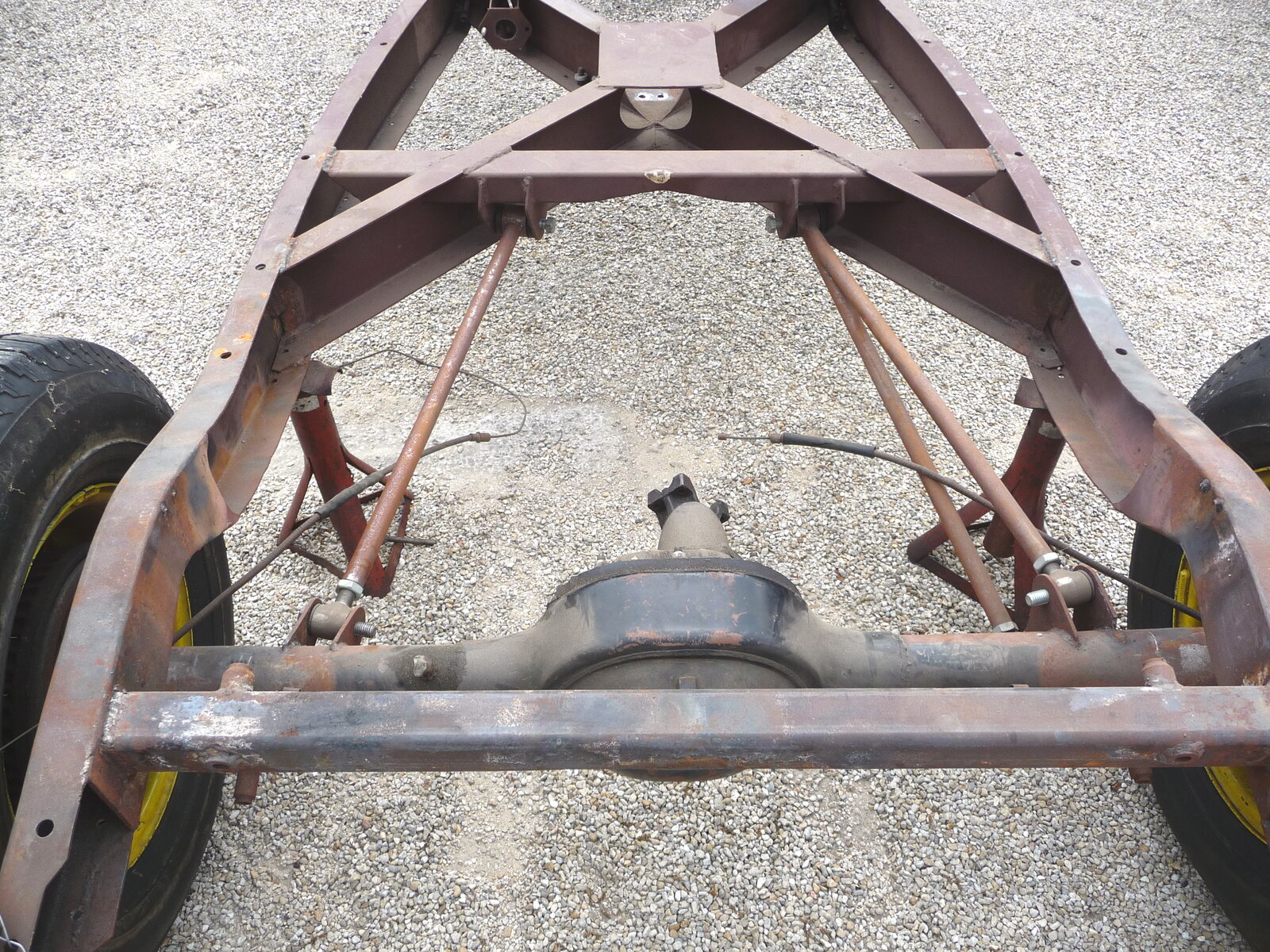

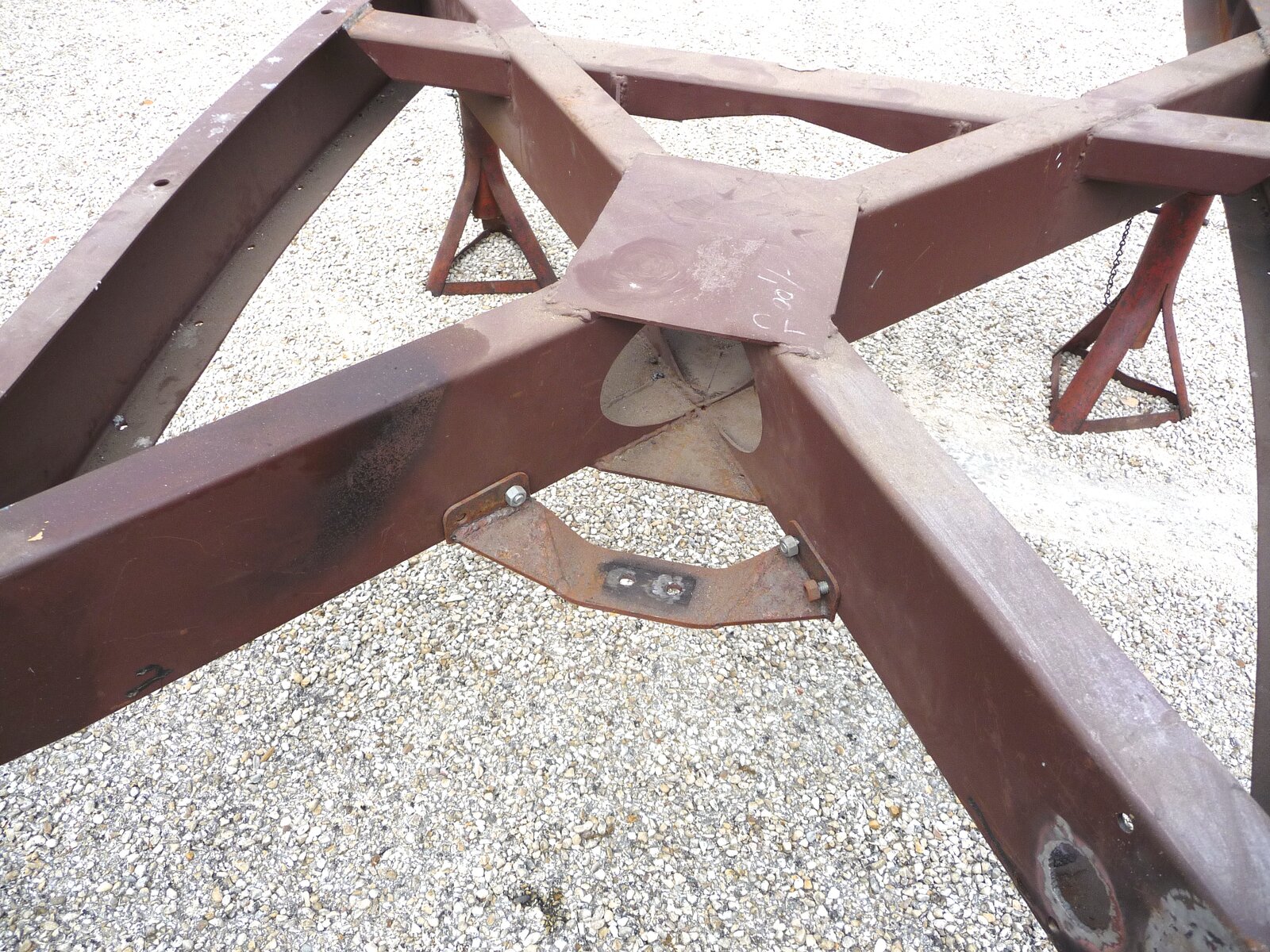

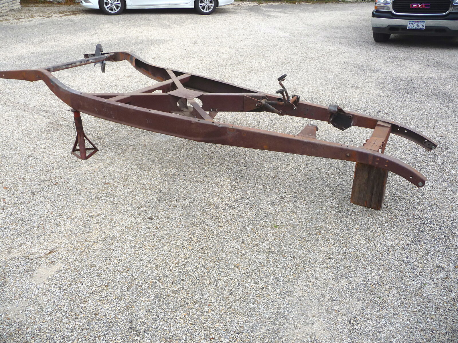

  8. I've posted the photos of this ch***is an unknown number of times over the past years. It's 35-40 X in Model A rails. It's kid play in ch***is building and works very well. Installing it in 32 rails is no different (yes I've done it). If you want stock under the floor pedals getting the forward leg angle correct is a must do in my book. I haven't seen any of the repro X members hit that mark correctly. You can use 39 or 40 pedals, I prefer the 39's. Another issue for a first timer doing this set up is getting the Pedals inside the Body in the correct place. Nothing there that some well thought out tape work won't get done. If you can get these two things right setting a T-5 in place of the early Ford box won't be a big deal either.
