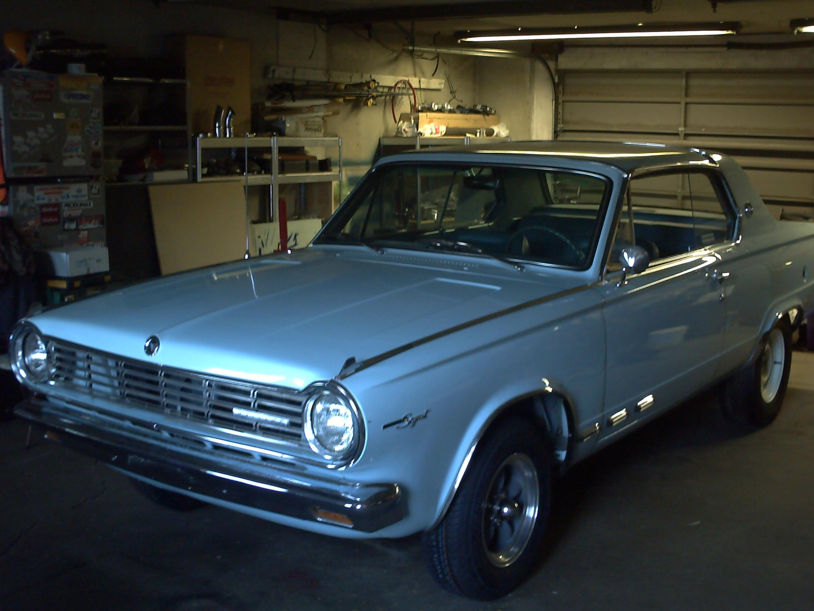

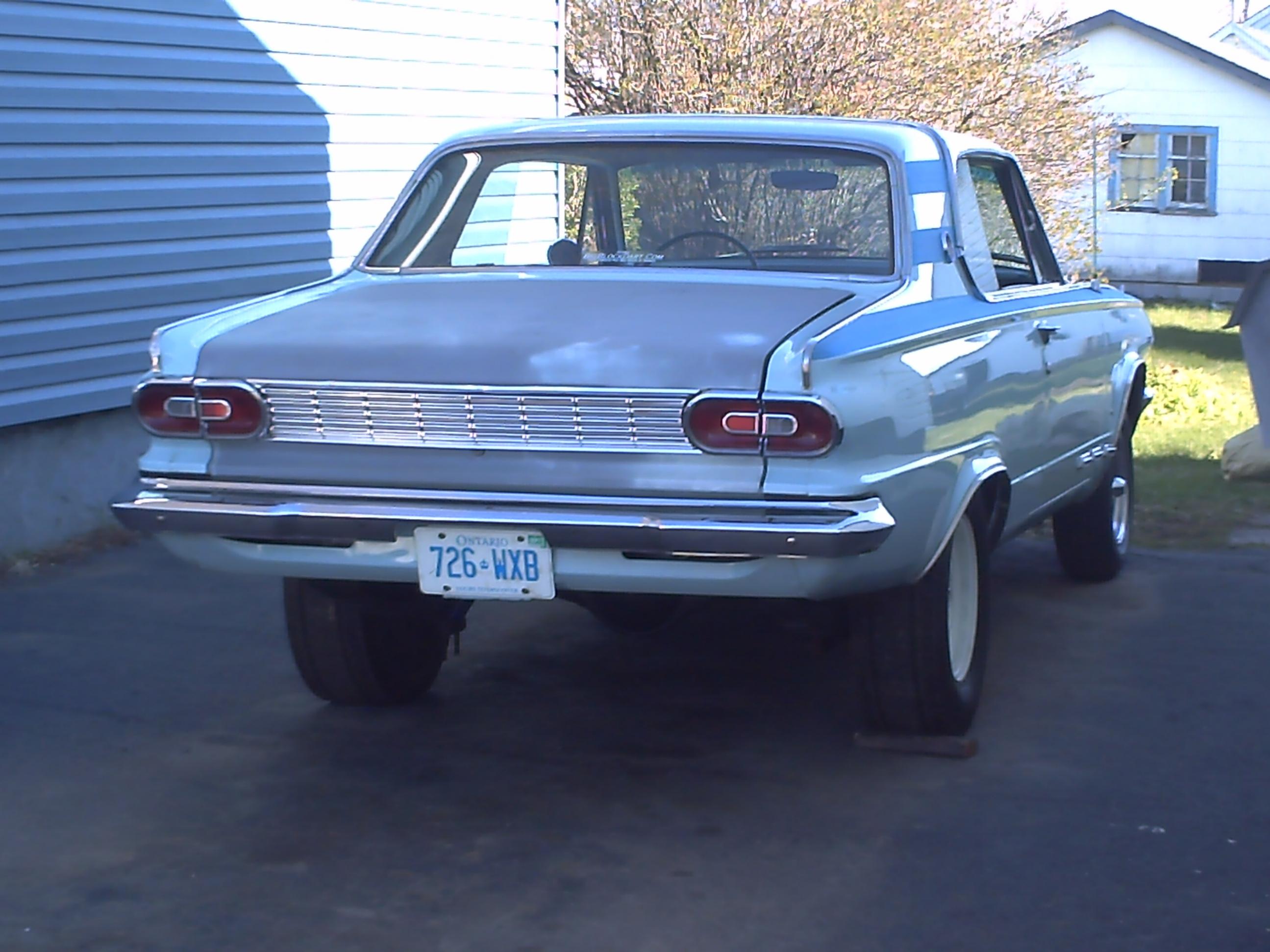

    I am designing the lettering on my 65 Plymouth Valiant Signet (Ya I know it looks like a Dart but its a Canadian built Plymouth). I'm going for the 60s Drag car look. What my question is: If this car was built in 1965, what cl*** would it have run. 440/727, full interior, no fibergl***. 3129 lbs with the big block in it.
