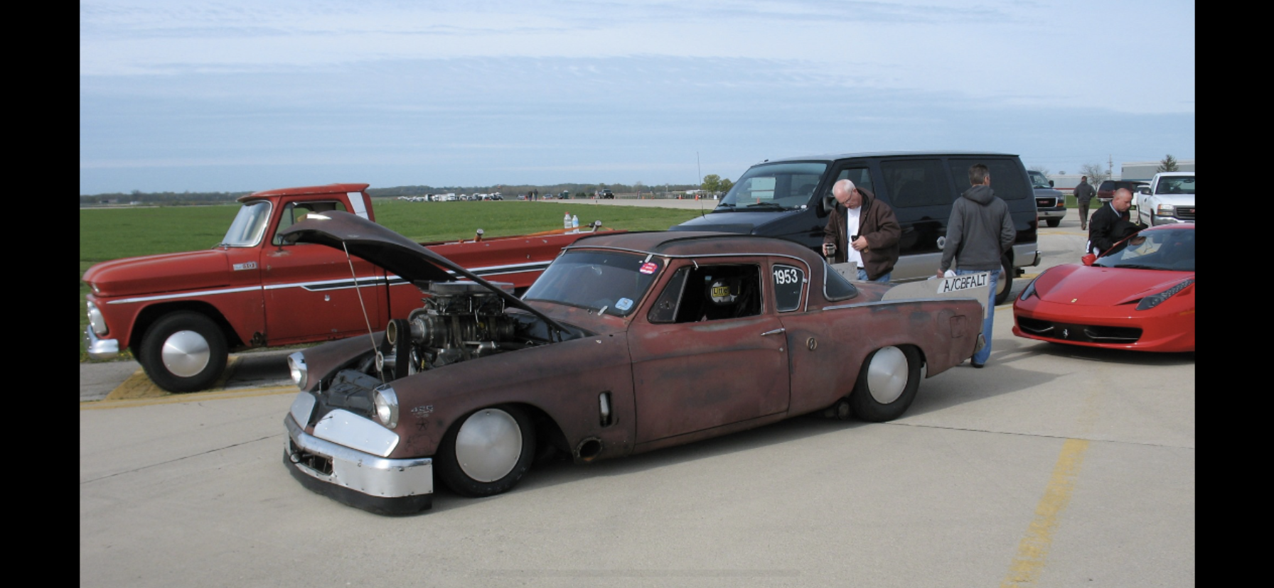

    IMG_5085.png Those cl***es denote engine displacement, aspiration, fuel type & body style/modification. For example, my old Studebaker was raced as A/CBFALT, so A, between about 7-8 liters, C, for a body made after the war, up to 1980, B, for a blower, F, on E85(puts it into "fuel"), and ALT to indicate limited aero alterations such as the air dam, spoiler, covered grille, etc.
