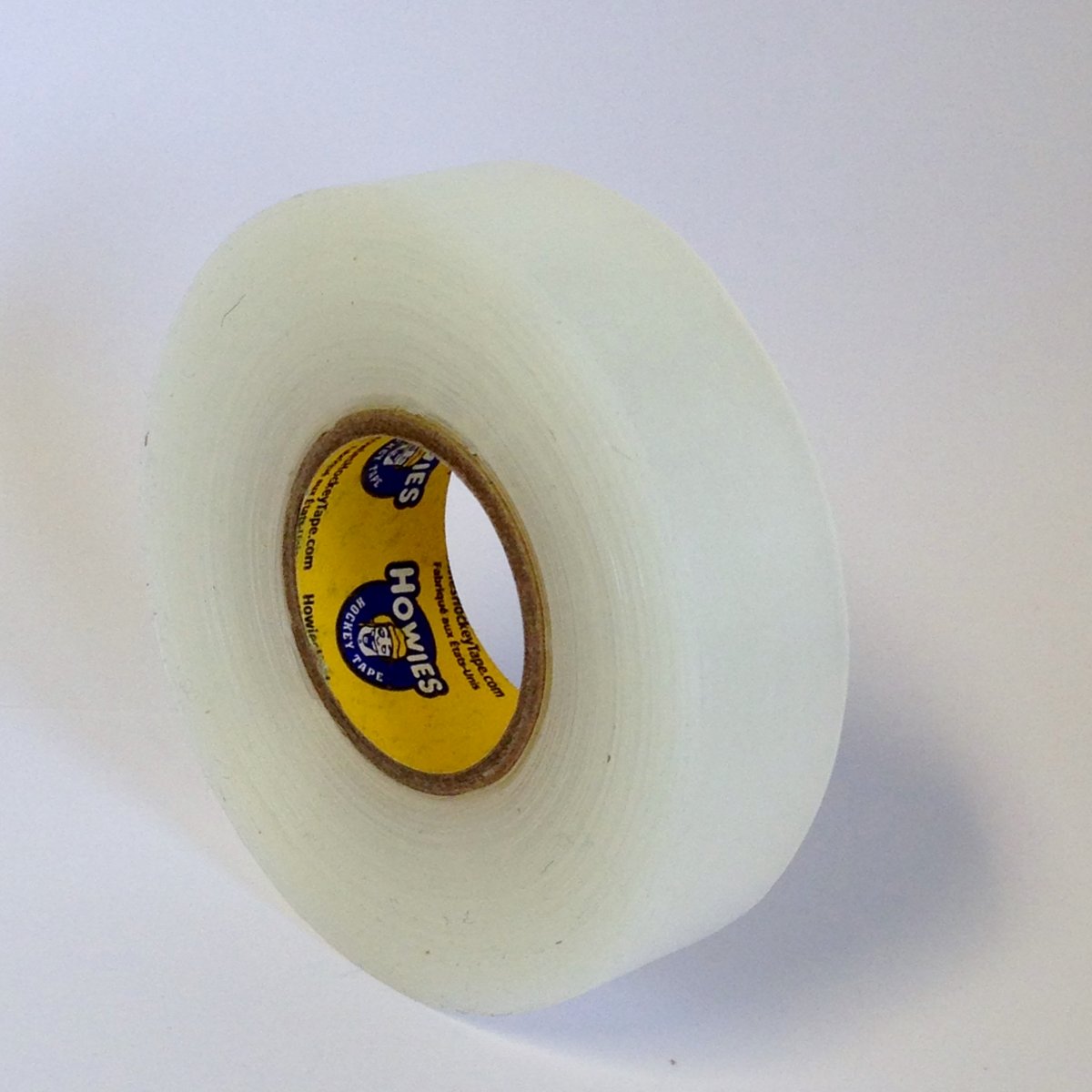

    Do you live near an ice arena? Go to the pro shop and buy a roll of clear sock tape. It's a stretchy clear tape that hockey players use to secure shin pads to their legs. It's got all the qualities you're looking for--very versatile stuff. clear sock tape.jpg

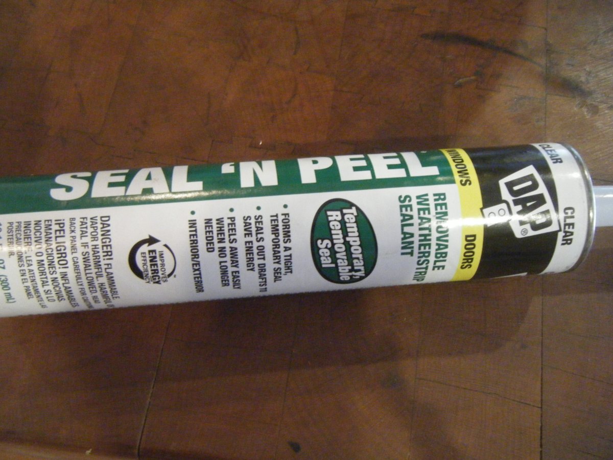

    there is a product called seal 'n peel by dap. it comes in a caulk tube and is clear as gl***. i live in a drafty 100+ year old farm house and use this to caulk the windows in the winter. it could be put on or next to the gasket then close the vent and window. it comes off easily if it is not spread too thin. an 1/8" bead or more that can be grabbed with a needle nose pliers will pull right off. DSCF0072.JPG home depot sells it

  23. I'd try the clear hockey tape. I've used it on fast RC boats and it works well. Never had it pull paint. Just remove like you would masking.

    That is what I used one time, and it worked perfect.
