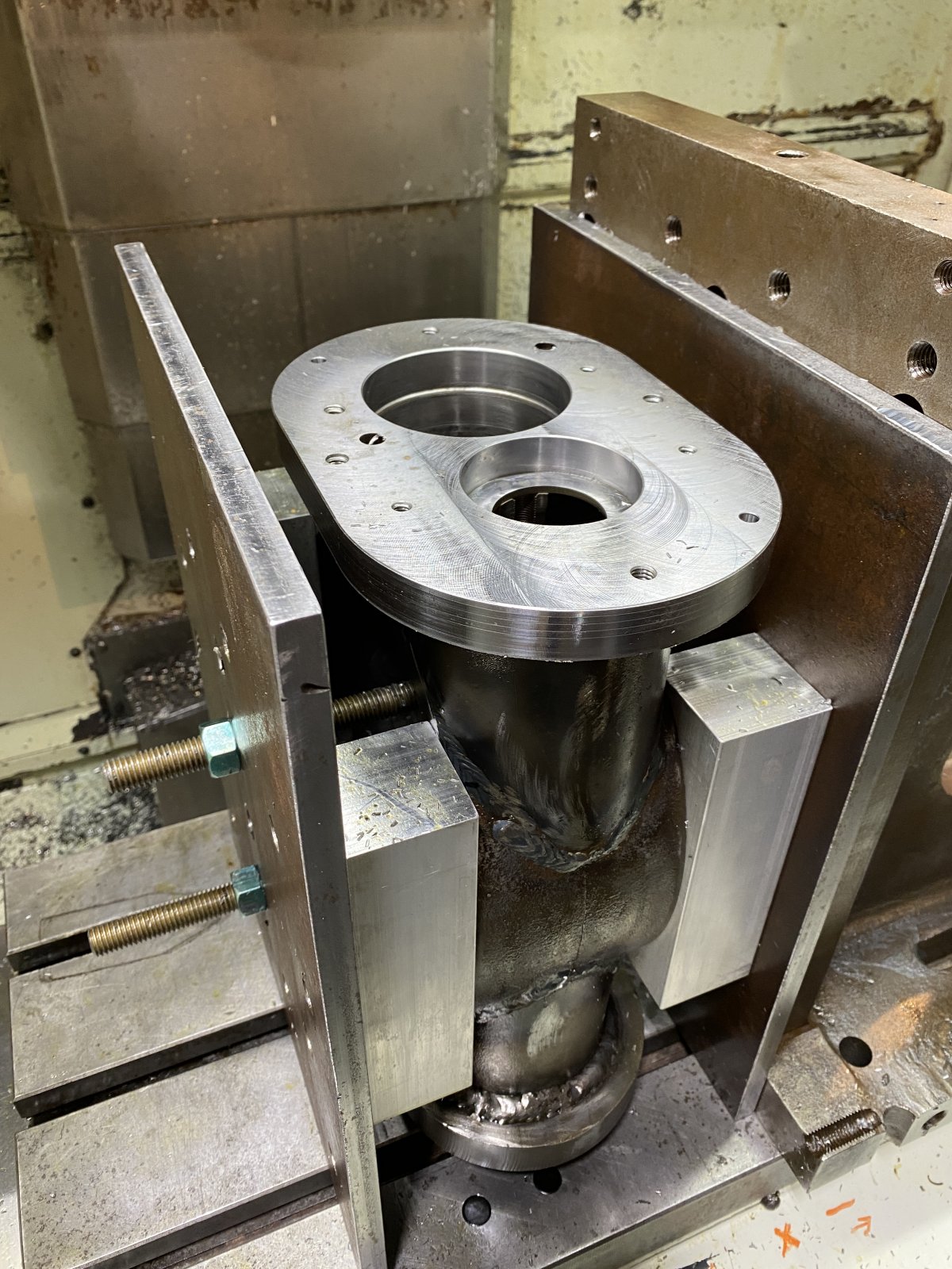

    I will be cleaning up our quickchange project soon (machining is all done!) and want to paint it with something that will prevent rust as it sits on the shelf until use. BITD guys used to use Glyptal or even Rustoleum on internals of engines and other components. The stock Ford banjo centersections actually had a red paint coating of some sort too.
    What is the best currently available product? I would probably like to thin it down a bit and dunk the center into a bucketful. Lots of nooks and crannies now that need coverage a brush can't reach. I will then wipe the paint off the machined surfaces where bearings and such will fit.

    I did the welding on the front snout. First welds with my brother's giant Lincoln. That thing would weld up a bridge. I was a bit inexperienced with it. The rest was done by my nephew, and he did quite a bit better.
    The old quickie we are using for an example was stick welded. Not as pretty, but it sure held all this time.
