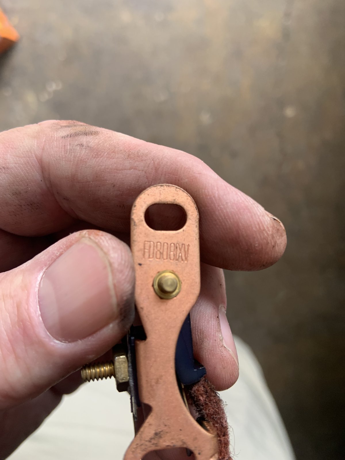

    I can’t figure out how to remove the rotor, which Napa suggested I replace. But I did get the point off. They say fd808ixv on em which I guess is a model. But to my untrained eye they look ok. They were burned together.
    Sorry guys I do know someone local I can ask for help, but im trying to avoid my brother, it’s Our car, from knowing since it’s embarr***ing
    the rotor says fa67, I don’t mind spending the money If I should replace it too. But again, I couldn’t see a screw to remove it
