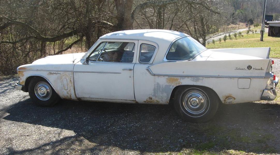

    Lark in Vanilla Shake paint:) AND a rusty Silver Hawk!!!!:D
