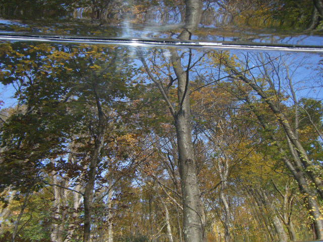

  12. tb33anda3rd
    Joined: Oct 8, 2010
    Posts: 17,583
    tb33anda3rd
    ppg 9300 black on a '58 caddy limo on a new england fall day.

    The pics on that Caddy are surreal. And showcase an awesome paint job.

  21. tb33anda3rd
    Joined: Oct 8, 2010
    Posts: 17,583
    tb33anda3rd
    thanks, i had to hold the camera upside down in the first picture so the trees would look right side up. i also had to keep a body line in the photo so it would look like a reflexion.
