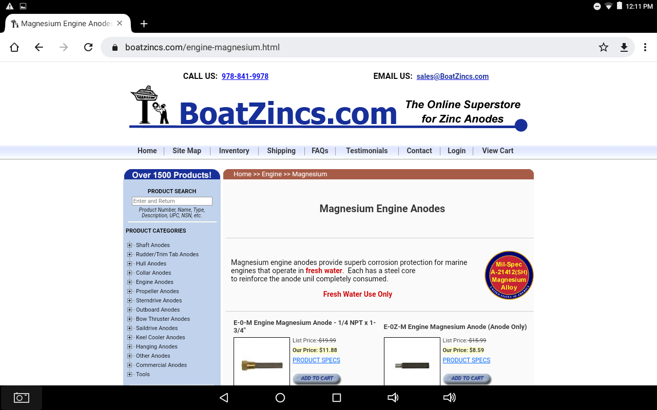

    A couple of things. First, magnesium anodes work better than zinc, especially in cooling systems with aluminum components. A simple check of the Galvanic Table will tell you why. RV's with aluminum water heater tanks always use magnesium anodes. Second, there are no particles as such involved in galvanic corrosion; it is an electrical process in which material from the anode is converted into electrons, that goes into the electrolyte (coolant) and is deposited on the cathode (usually the iron block). Where do you think that "crud" that builds up in the block comes from? Some of the electrons stay in solution and change the composition of the electrolyte, which is why it has to be changed regularly. Third, I have heard that Evans Coolant is quite expensive. It is also incompatible with anything else, so a slight loss of coolant requires a top off with more Evans, or a complete drain, flush, and fill with anything else. It is my understanding that it is a very specialized product designed for certain extreme applications and is impractical for regular use.
    Fabulous50's and 2OLD2FAST like this.
