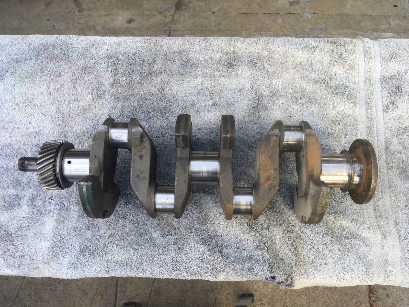

    I’m guessing Ford of some description but how do I tell what model? Counterweighting looks nicely done, is that fairly common?

    Bolt on counterweights are still used in some circumstances. Not sure what this is off looks 40s vintage.

    Any features or measurements I should check to help ID it?

    Model A Rods are 1.500. Mains are 1.625
  5. Looks Willys to me, the flange would confirm if it has 6 holes and two have a taper. JW

    this is a Jeep crankshaft

    Thanks Jim, looks like you nailed it
