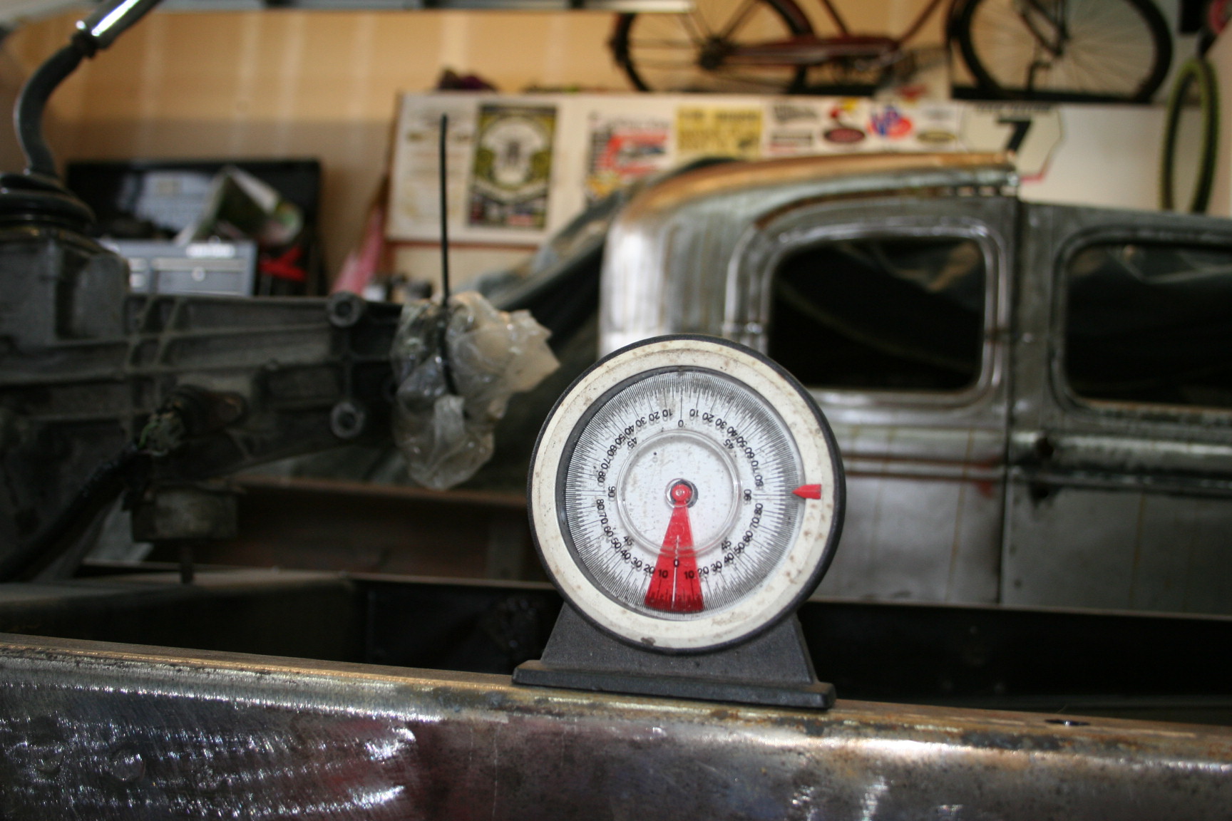

  9. DirtySanchez
    Joined: Aug 31, 2006
    Posts: 408
    DirtySanchez
    from So Cal
    I've been using an angle protractor. It is magnetized and flat on the bottom, has a weighted pendulum pointer inside that will obviously point vertical, no matter what. It has a circle marked 0-90 every quarter, to let you know what degree your at, whether vertical or hoizontal, and a moveable red pointer that is able to be moved to a certain desired degree, on the outside. Believe it or not, I did pick mine up at Home Depot, in the tool section. I have an entire build thread on another site. I'm not sure how the mods are about posting links to other car building sites though. Here's a pic of a fellow club members truck that I am taking ideas from though. Mine will be more of a dirt track type than his.

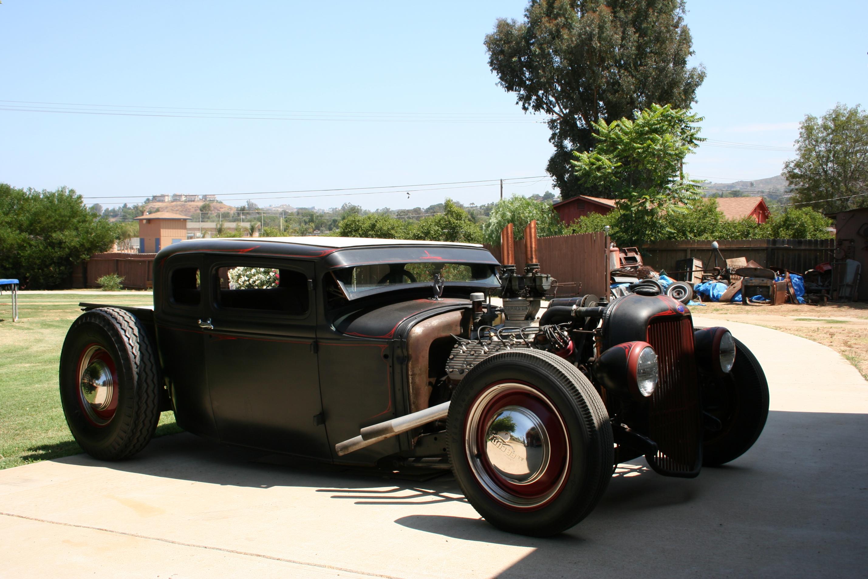

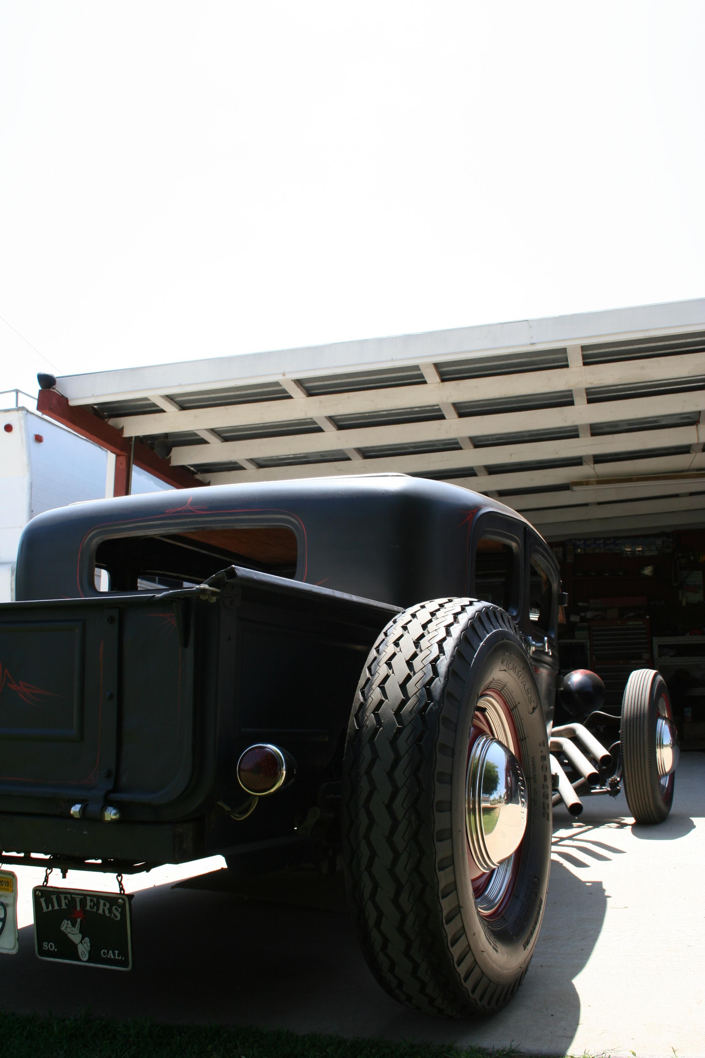

  10. DirtySanchez
    Posts: 408
    DirtySanchez
    from So Cal
    This is a fellow Lifters c.c. member that I am building mine similar to. It's a four door sedan cut down to an X-tra cab truck. What do you guys think of the rake his is at, and should I go more/less?
  11. lowsquire
    Joined: Feb 21, 2002
    Posts: 2,567
    lowsquire
    from Austin, TX
    its fairly simple to work out if you know your tyre sizes, and frame to axle clearances. a fairly standard ch***is rake on a 32 frame is 3-5 degrees. so this number comes off the amount of caster you build into the front end, to give true caster when finished and running down the road.
    if you dont have some idea of tyres and rake desired, you arent thinking far enough ahead in setting up your ch***is.
    working out ch***is rake in the car posted above is near impossible, as the ch***is has no base line, its bent like a freaking pretzel...
  12. the-rodster
    Joined: Jul 2, 2003
    Posts: 6,960
    the-rodster
    Wow. If you're trying to go that radical, then a lot of the "common" suggestions for ride height, rake, etc go right out the window.
    Cool truck, but, the scrub line - eek
    It looks like there is MAYBE, 2 inches clearance.
    The bones have probably been cut to get the caster correct.
    Huge kick in the frame, front and back.
    If that's the look your going for, you best bet is to talk to the builder.
    Rich

  14. gimpyshotrods
    Joined: May 20, 2009
    Posts: 24,525
    gimpyshotrods
    Maybe. In California it depends on your side wall height. No part of the car can be lower than the lowest point on the wheel closest to the ground. Based on the picture, your fellow Lifters C.C. member's car is too low for the law, technically.
    If there is 5" of rubber between the ground and the wheel lip, then you have to have the whole deal over 5" up.
    You can visualize it this way: Put the car on the ground with wheels and no tires. Nothing but the wheels can be touching the ground.
    Yes, these reg's were written before the days of low profile tires. I once measured a tire with 1-5/8" of side wall. So the car could have plausibly been 1-3/4" off the ground. But just try getting that past the cops, or out of the parking lot.:p

  21. DirtySanchez
    Posts: 408
    DirtySanchez
    from So Cal
    Here is the angle finder I was speaking of.
