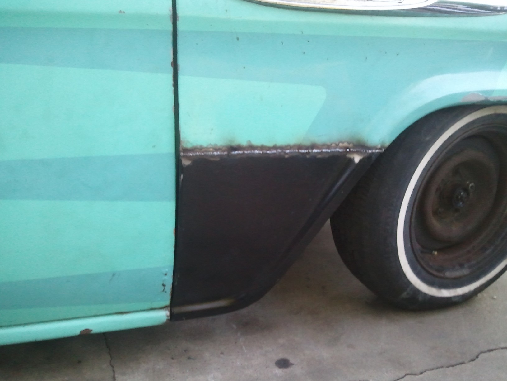

  26. thought i'd add a weekend update, this is my first time replacing fender panels so it prob looks crooked lol you might think your cross eyed when you see it WP_000484.jpg
  27. and the after shots.....
  28. tonight after work gonna jump back on my brakes get them bleed i hope think i got all the leaks fix
  29. one thing after another has been popping up but i finally got to work on my truck got the fenders almost done (lined up and straight) she runs now but i cant get the brakes bleed. either a shit load of air or i got a leak i just dont see hopefully i'll have more progress pix to show in the next few weeks.
