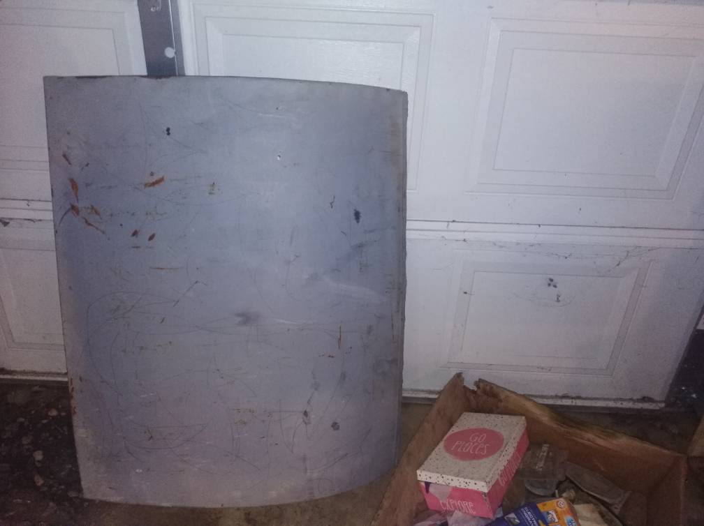

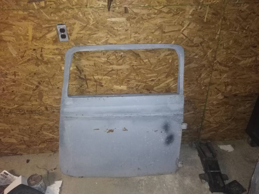

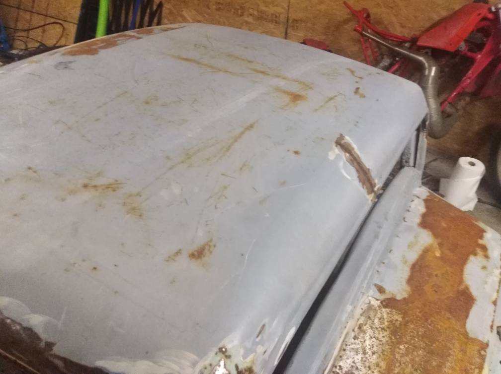

    Long time lurker first time poster! I just bought what I hope is what I've always wanted, however some of the pieces aren't adding up, so if you guys could tell me what I have I would greatly appreciate it! I bought a trailer load of stuff this is just a portion of what was in it.
    Now my issues, the doors have no handle hole, and by looking to the interior panel, haven't been filled it appears...the decklid is the same, but seems to be the correct width. The parts in the pile on the floor, what are the stamped metal parts? And the triangle pieces with the studs?
    Any and all help over what I got myself into are 100% appreciated! IMG_20190102_180822.jpeg IMG_20190102_180755.jpeg IMG_20190102_180808.jpeg IMG_20190102_180835.jpeg IMG_20190102_180858.jpeg IMG_20190102_180917.jpeg IMG_20190102_181115.jpeg IMG_20190102_181121.jpeg

    Might look again for the filled holes. Depending on if it was a deck-lid or rumble-lid...latch would be at front or rear of panel.

    And of course, doors open at front so look for the hole at the rear.

    Those doors look homemade. The triangle pieces w/stud are rumble seat hinges.

    I'm leaning towards a chopped 33/34 plymouth. The quarter windows appear to be filled in. I'm not sure if it's got a different roof scabbed on or if it's the absence of the quarter windows that's throwing me off. Pretty sure it's not a Dodge unless someone messed with the firewall. Dodge had an extended firewall. This one doesn't. There should also be a hole that's been filled where the coil would go.
    Overall it looks like a LOT of work and money.

    It sure looks like much of it was hand formed. They did have a slice of a cowl near the firewall, and maybe some of the body sill. The sides of the cowl and that short body reveal seem to be hand done.
    The doors are hand formed from scratch. The roof skin likely is a donor piece of metal, but the rest of the roof all looks hand done.
    The stuff that could clean it up as far as proportions: The windshield header is just too tall...but, the door windows are too tall also. I'd chop the top to get rid of that ugly W/S header...(you'd be, in a way, moving the top of the windshield frame opening up, to reduce the height of the header). Then chop the door windows to the same amount...I'd bet it would look a lot cleaner.
