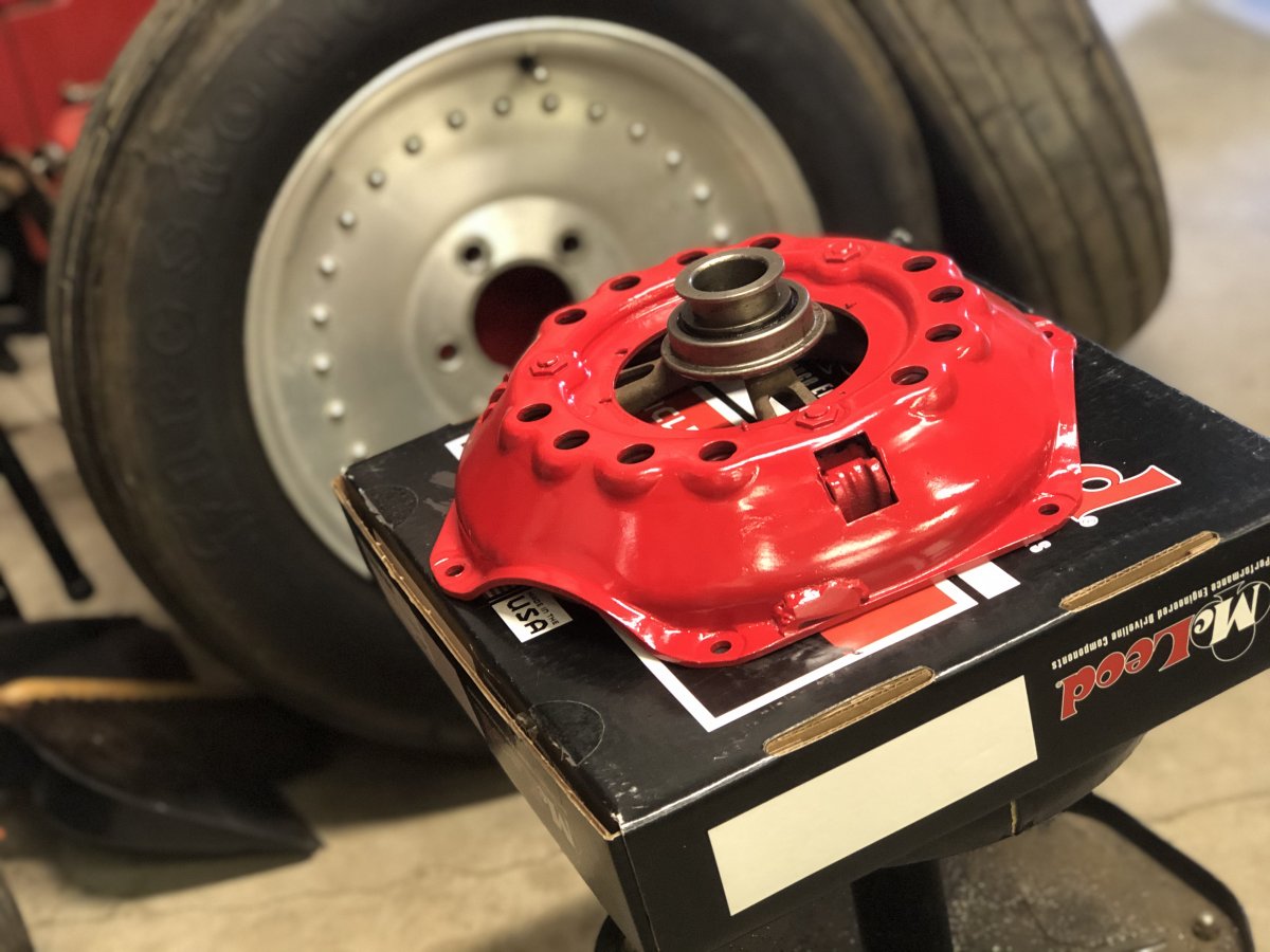

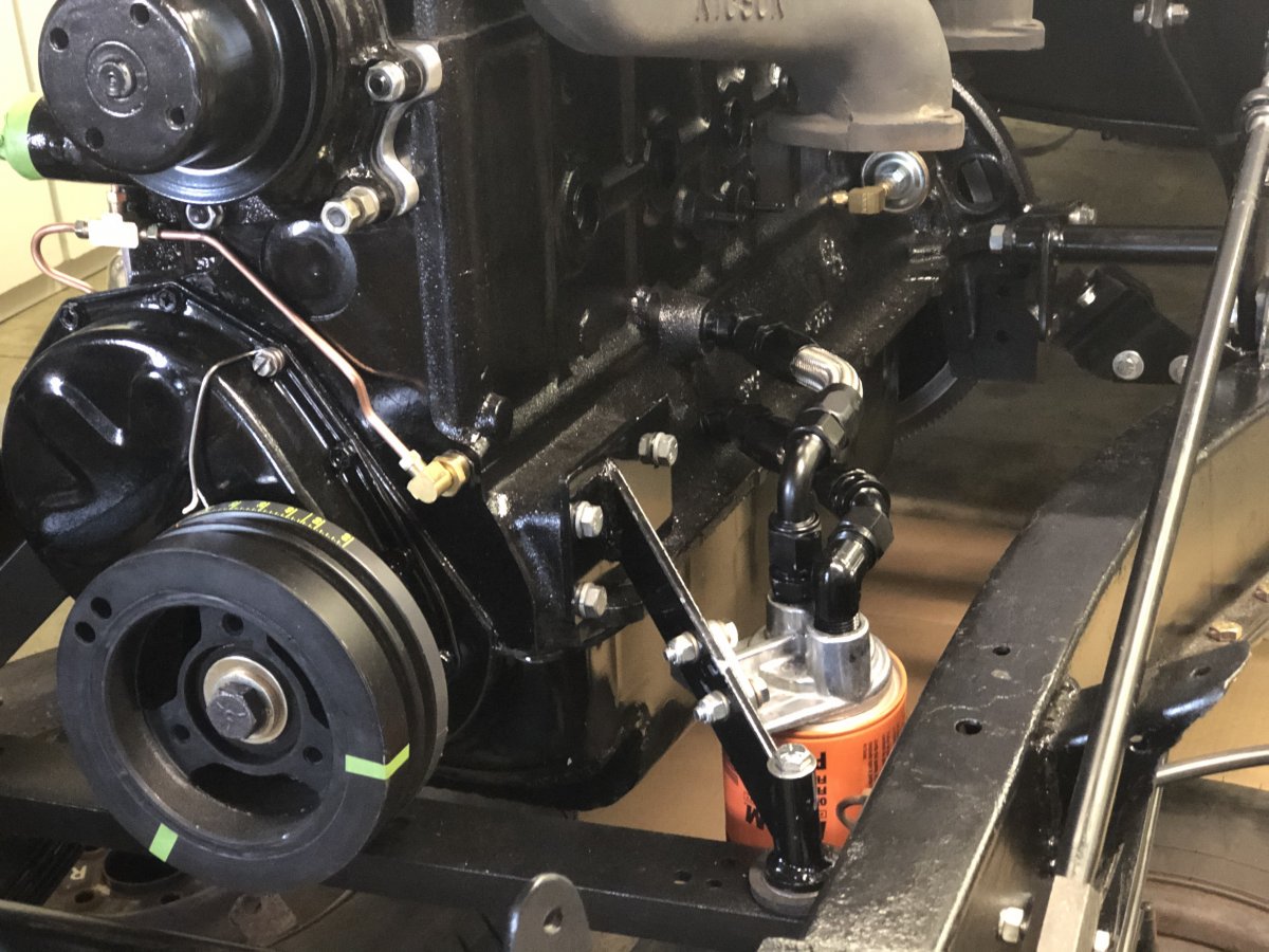

    Finished the oil filter plumbing. Readied the clutch for installation Saturday. 29F34F34-8108-4014-B6E5-6CB70C6EDDCB.jpeg EC4E7838-F0F9-42D9-9A11-038571FA0E44.jpeg

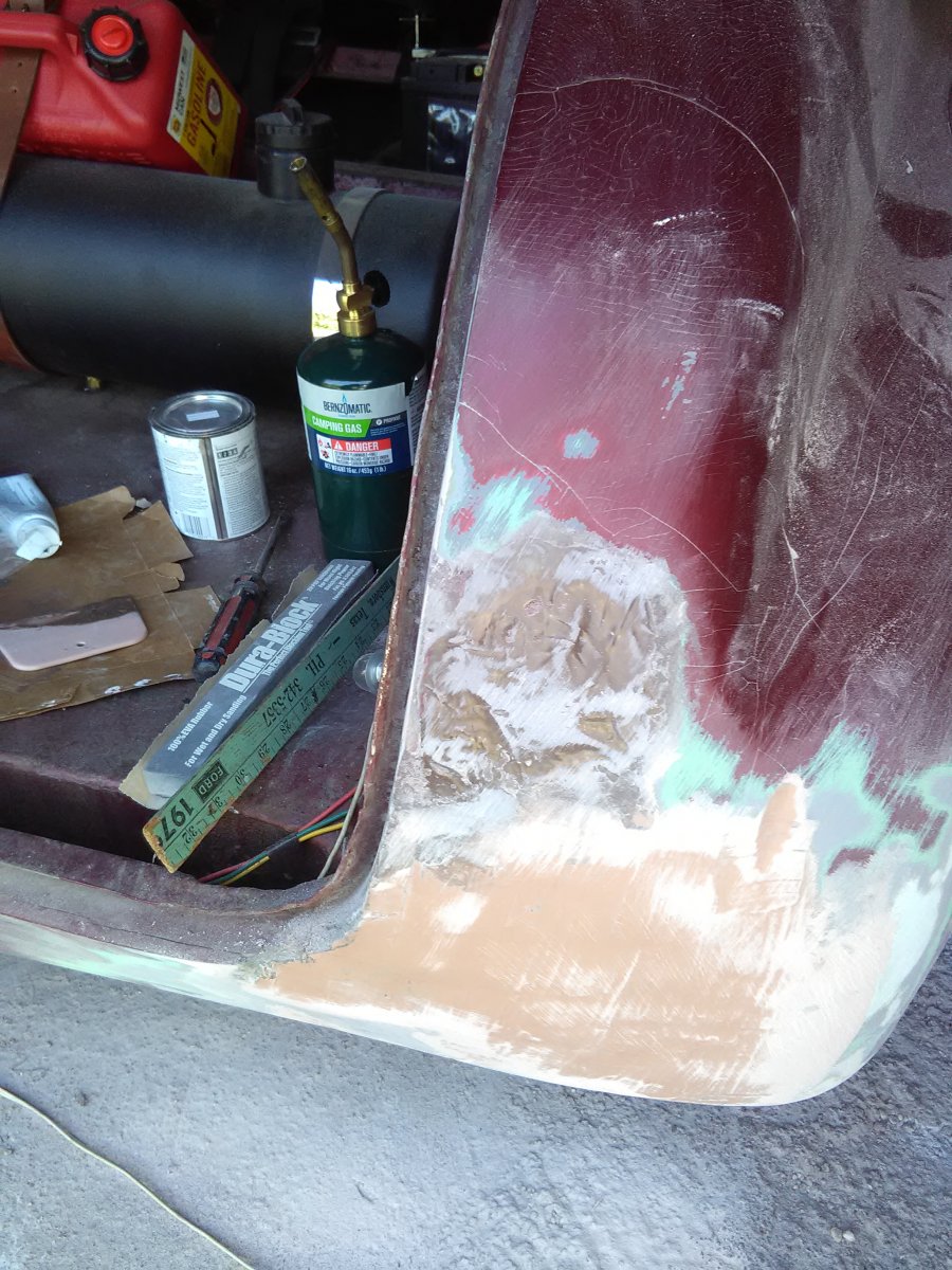

    Screenshot_2020-02-27-16-47-55.png Blocked down high spots in layer of Bondo Gl*** applied over layer of fibergl*** applied over holes drilled for pulling worst dent in back of rear fender ('39 Chevy coupe) two days ago. Removed paint around backside of 2" x3" hole with wire brush in drill. (Where '65 (?) Impala light was removed.) Applied 2 layers of fibergl*** cloth to backside of hole to prepare for filling with Bondo Gl***. Applied layer of Bondo over Bondo Gl***.

    11" clutch? My 302 has an 11" Hays and it fills up the bellhousing to the point of rubbing the high points off the pressure plate enclosure.

    Yes, had it in my stash from use from 1976. It’s never been on a stock flywheel. The 11” diaphragm had no chance, hoping the B&B will make it. It had the lightest springs. It was in that same bellhousing I hope we don’t need to go to the 10” flywheel then I’ll need to buy a complete clutch as I have none buried that size...

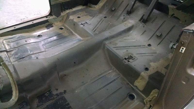

  7. It is nice to see pieces come off the floor, workbenches & office desk...That means progress is being made on the 64GP
    I must be crazy doing 3 cars at the same time with my transporting schedule, but nobody lives forever.
    The other 2 are each a year off topic, so I won't talk about them.
    That last picture shows why I love those southwest desert cars....100% rust-free AMC

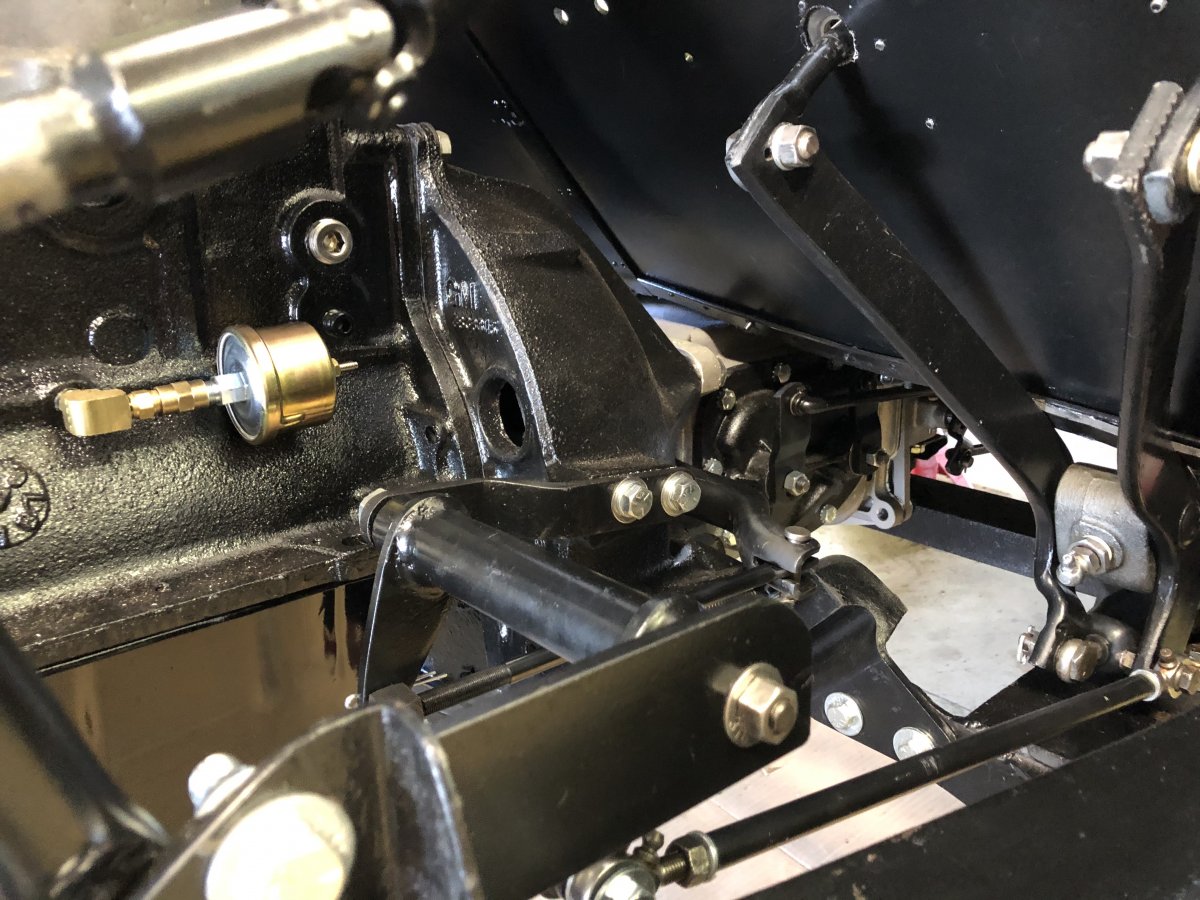

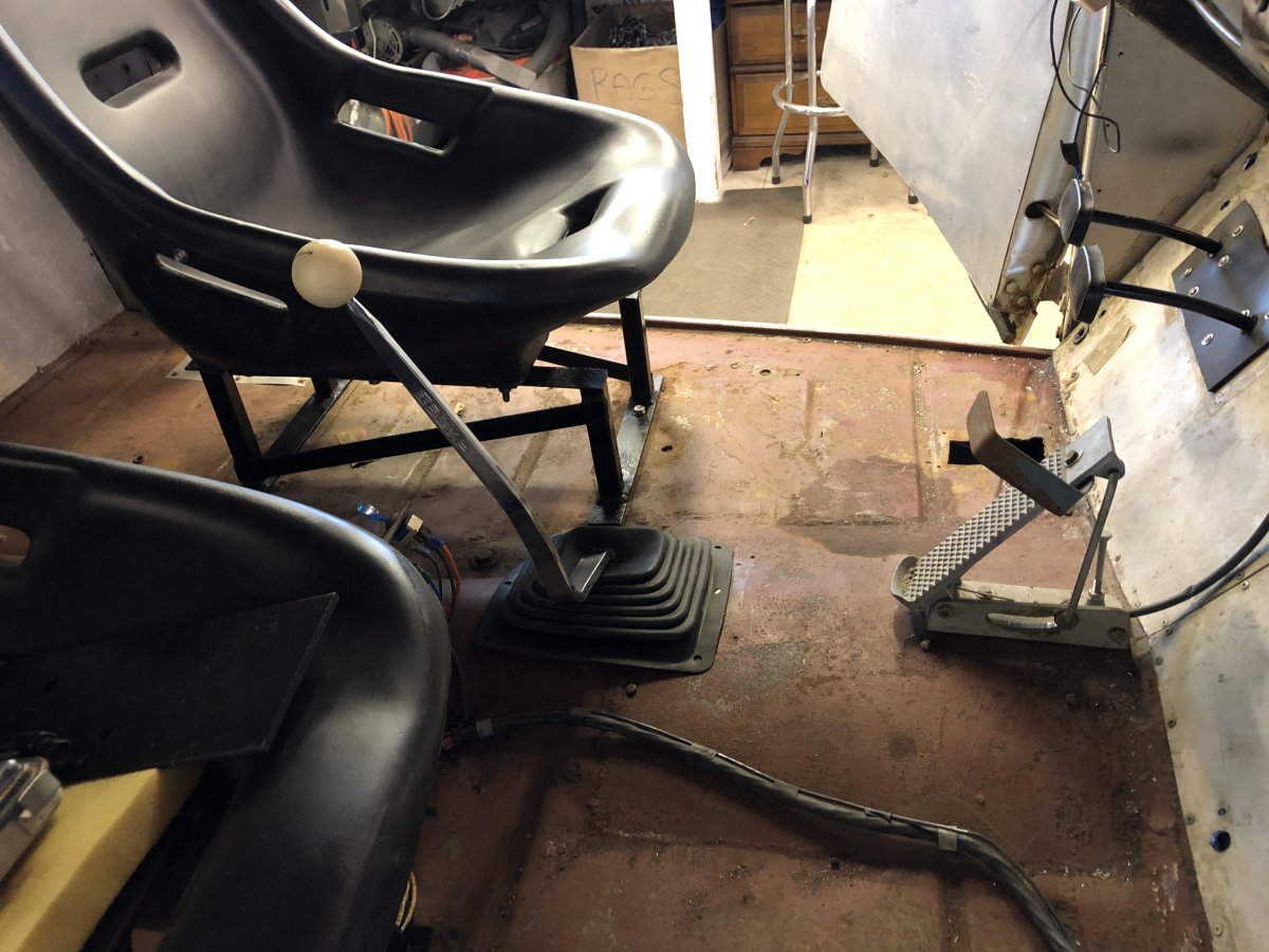

    Clutch and new Richmond Super T -10 went in today. Old Hurst linkage was real close to being too short and the new trans has only one mount. Clutch linkage works perfect, bought a new kit from Cl***ic Industries for $23.99. Nice when you live about 4 miles from them. Larger hole in the floor as everything has been moved back 2”.. 88083603-24A5-4941-A59A-1848E3BC6D8B.jpeg 44E513B2-FE0C-4F00-B642-0D44B328EA0D.jpeg

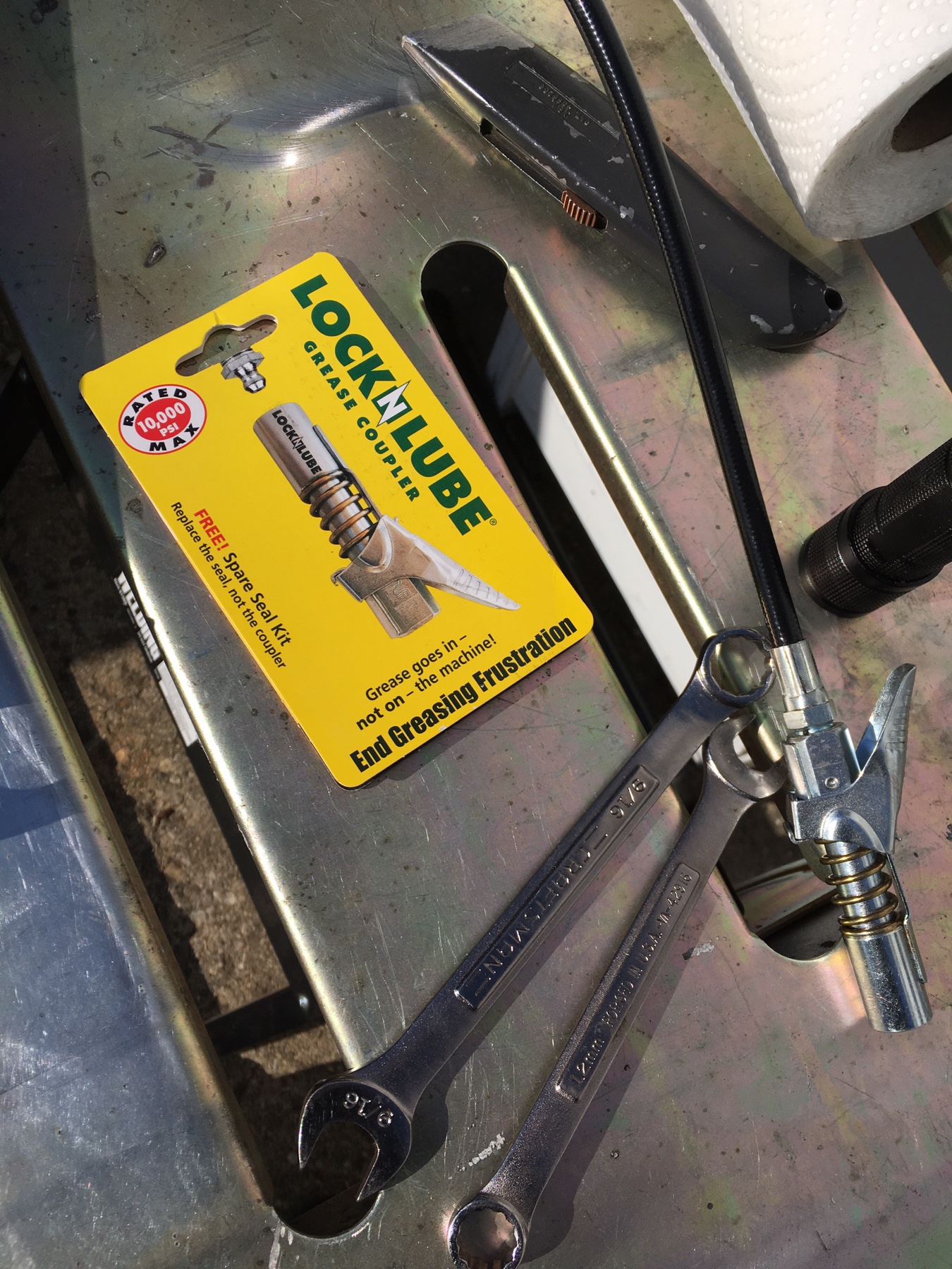

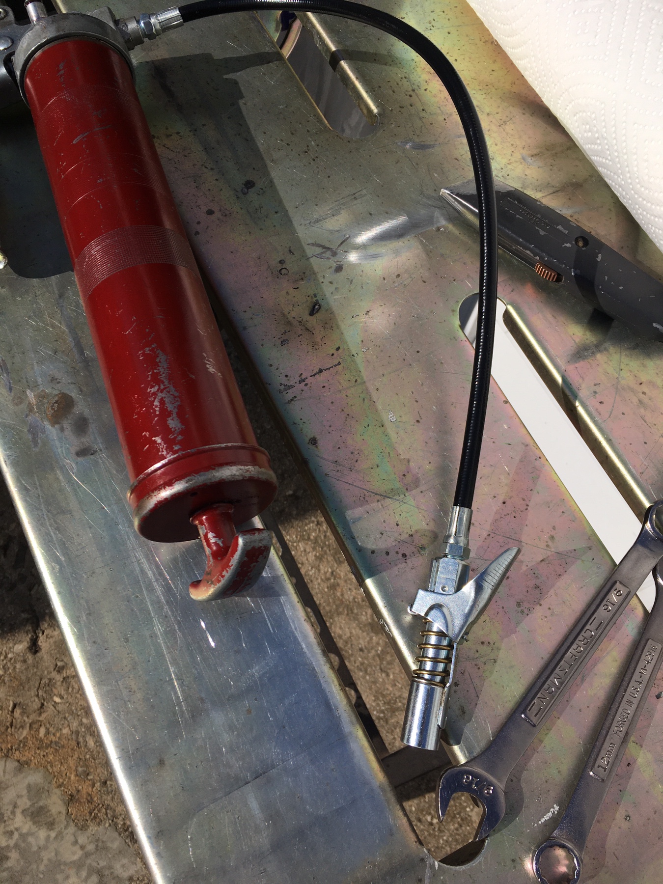

    Oil change and grease for the DD, which wouldn’t be HAMB worthy, but this thing is.
    Made it significantly easier and faster, especially for for the U joint that has to be rotated so that the zerk is up, facing the floor, to get enough side clearance to get on it. That one has always been a pain.

    ^^^ Cool connector

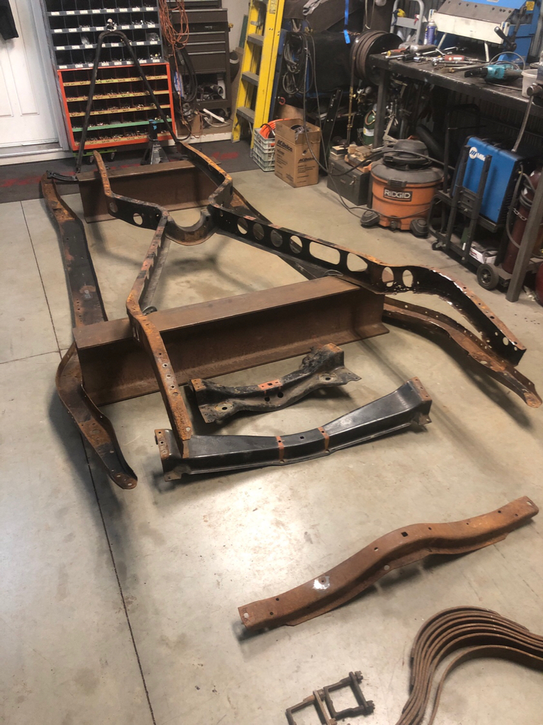

    I found a T leaf and crossmember for the 34 locally which was cool. I also removed the last few rivets to get the frame apart for sand blasting and then the fun begins!

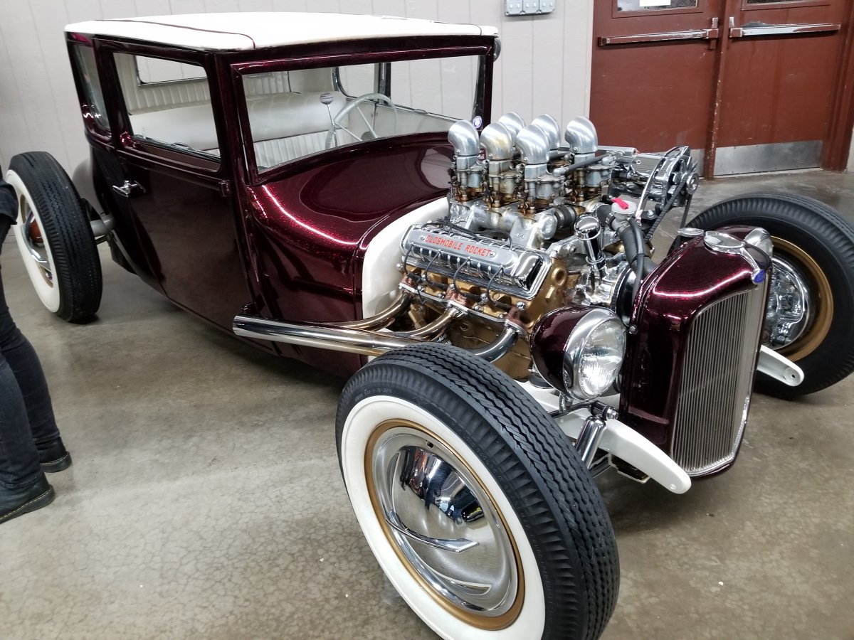

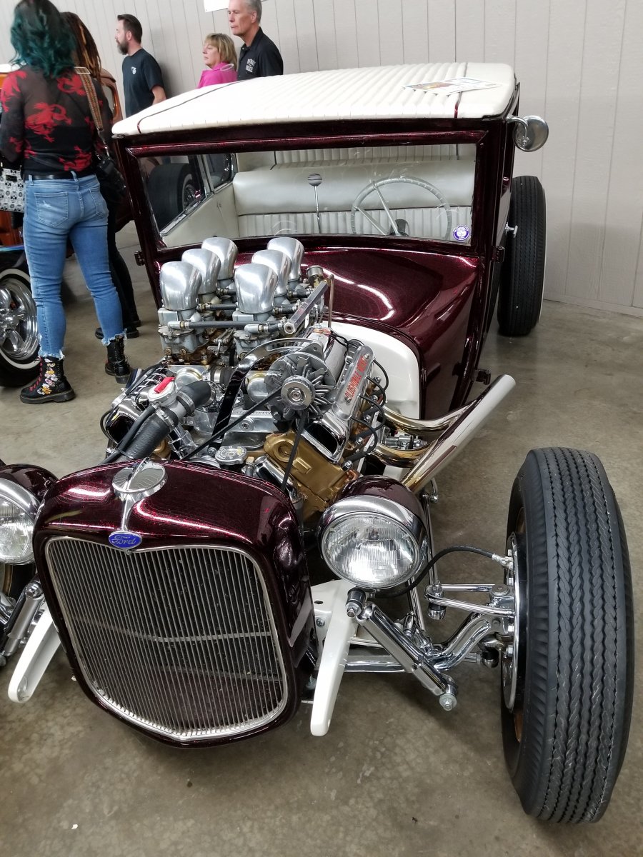

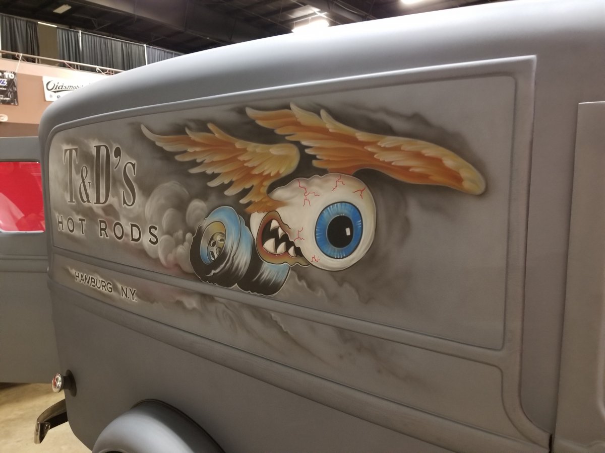

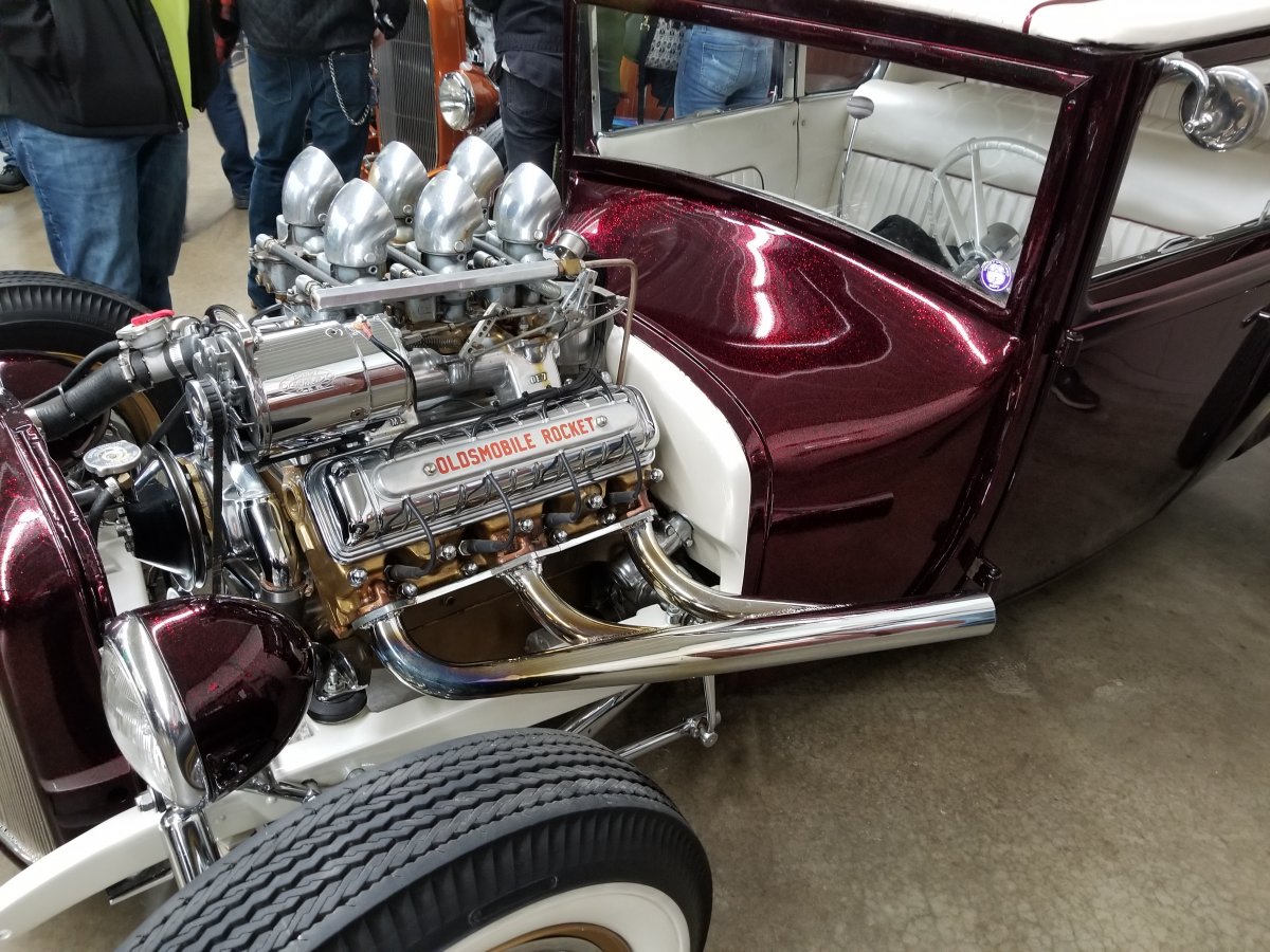

    I hit our local indoor show, Binbrook Speed out of Canada had a really nice T there

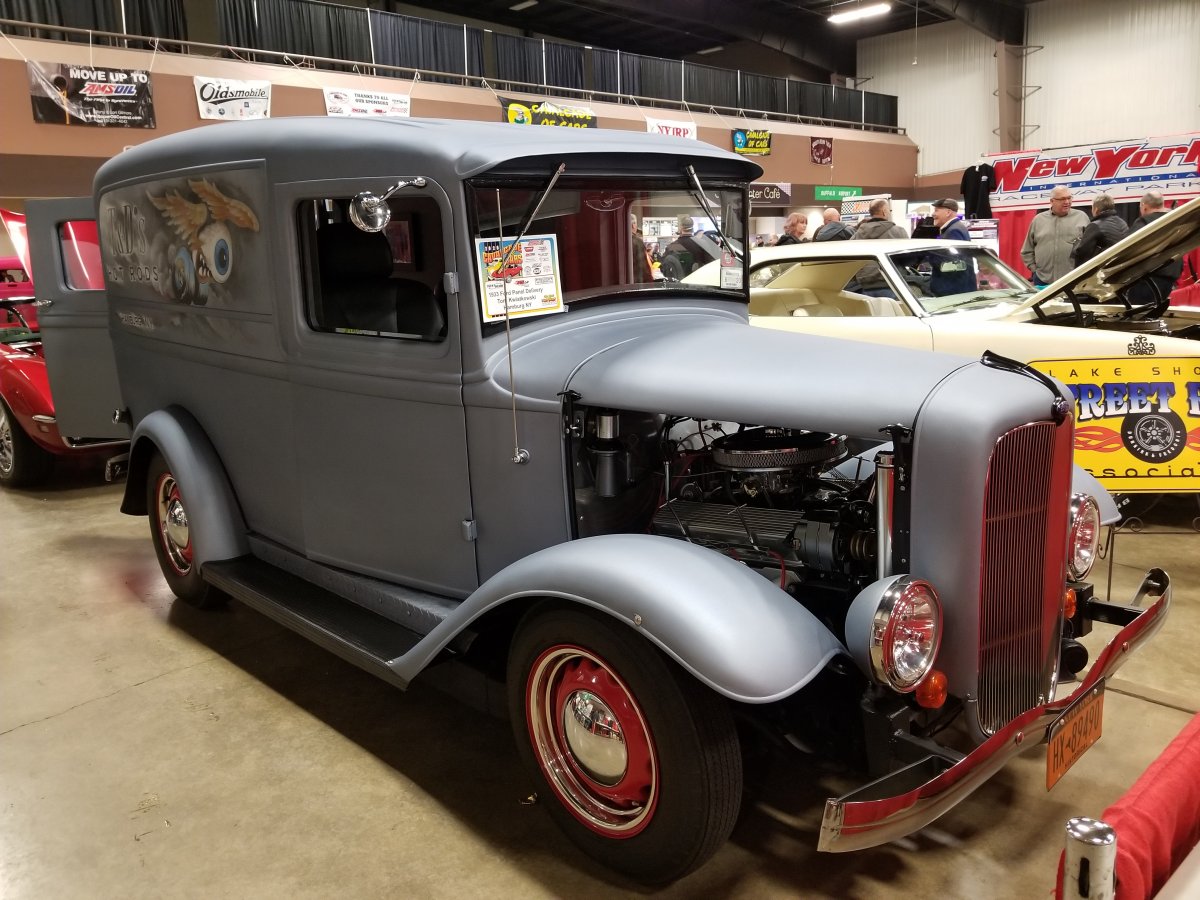

    This one was neat, although I thought the front was a little different looking

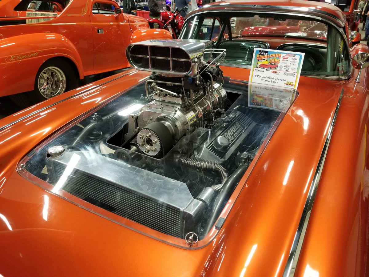

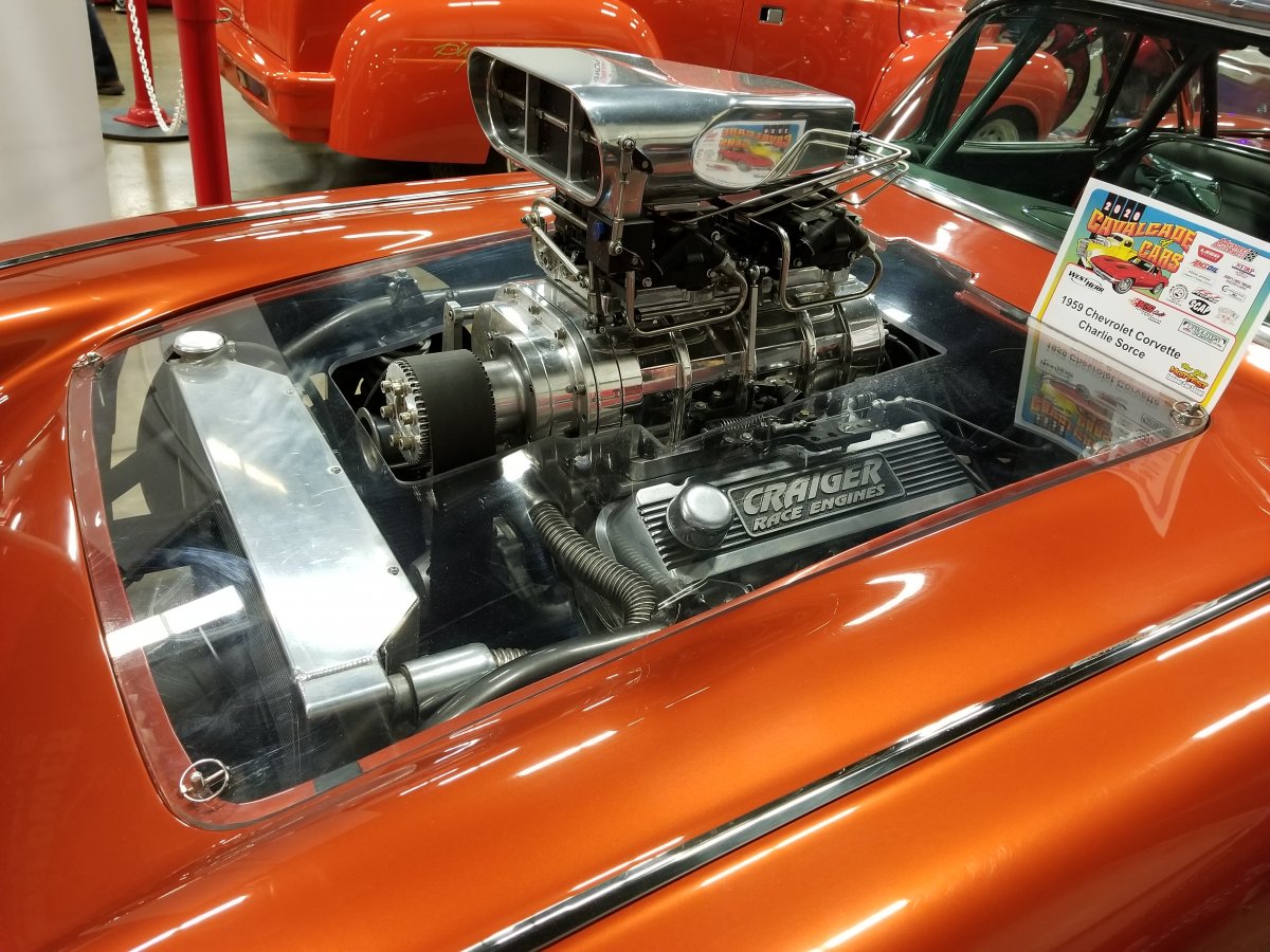

    I liked the see through hood on this 60 vette

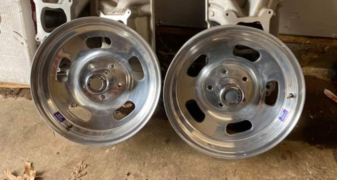

    And bought these 15x4 Bart rims on line, which I've never seen before, the shipping package said 21.20 lbs which is pretty light, hopefully be delivered tomorrow.

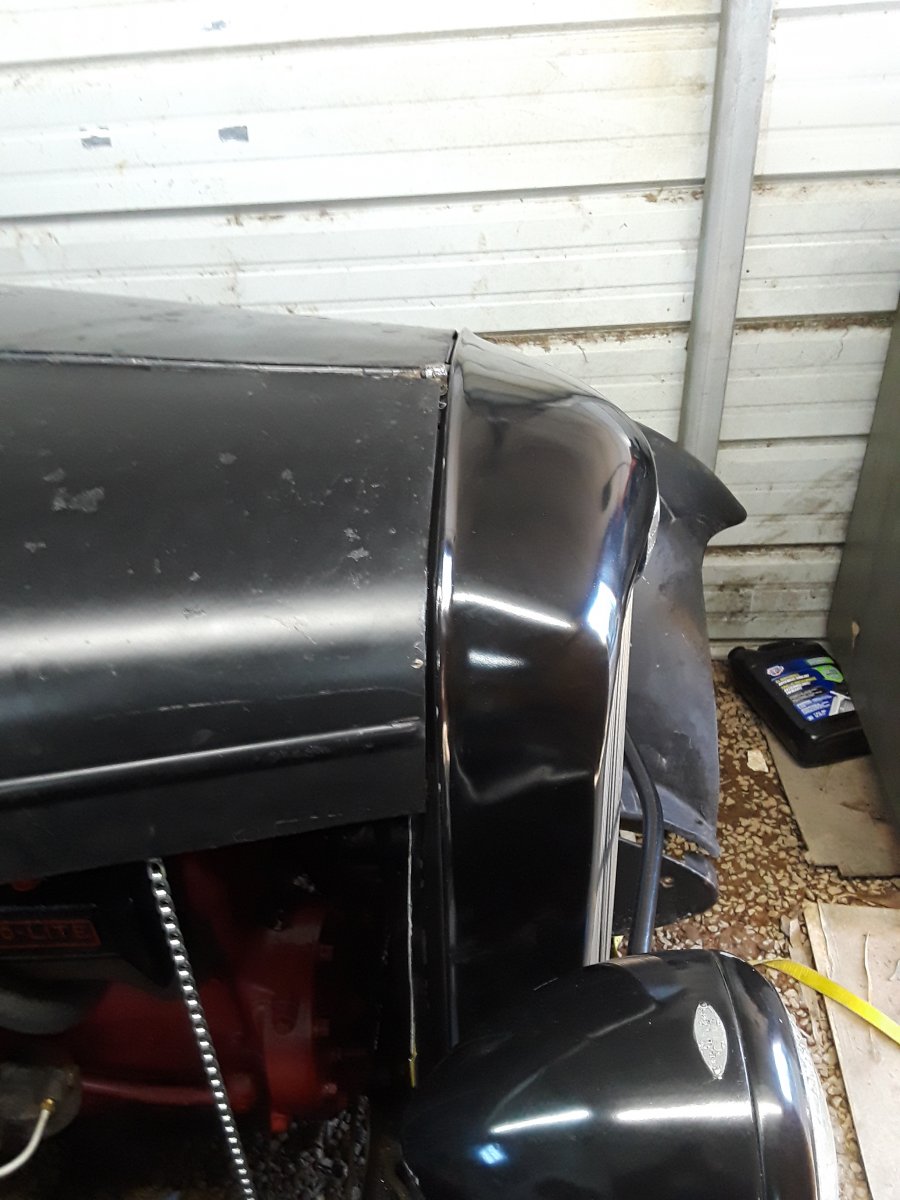

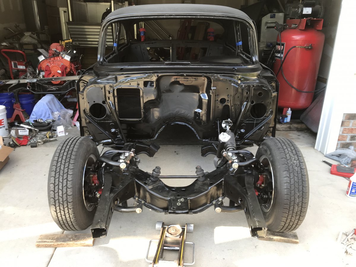

    First time in the garage since November. Have been buying new front sheet metal for my ‘57. Started installing all of it today, nice day out, finally! Moving slow but moving!

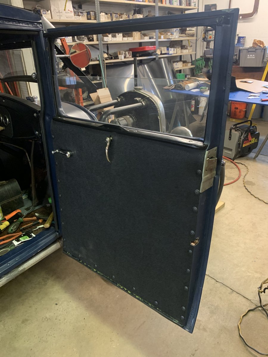

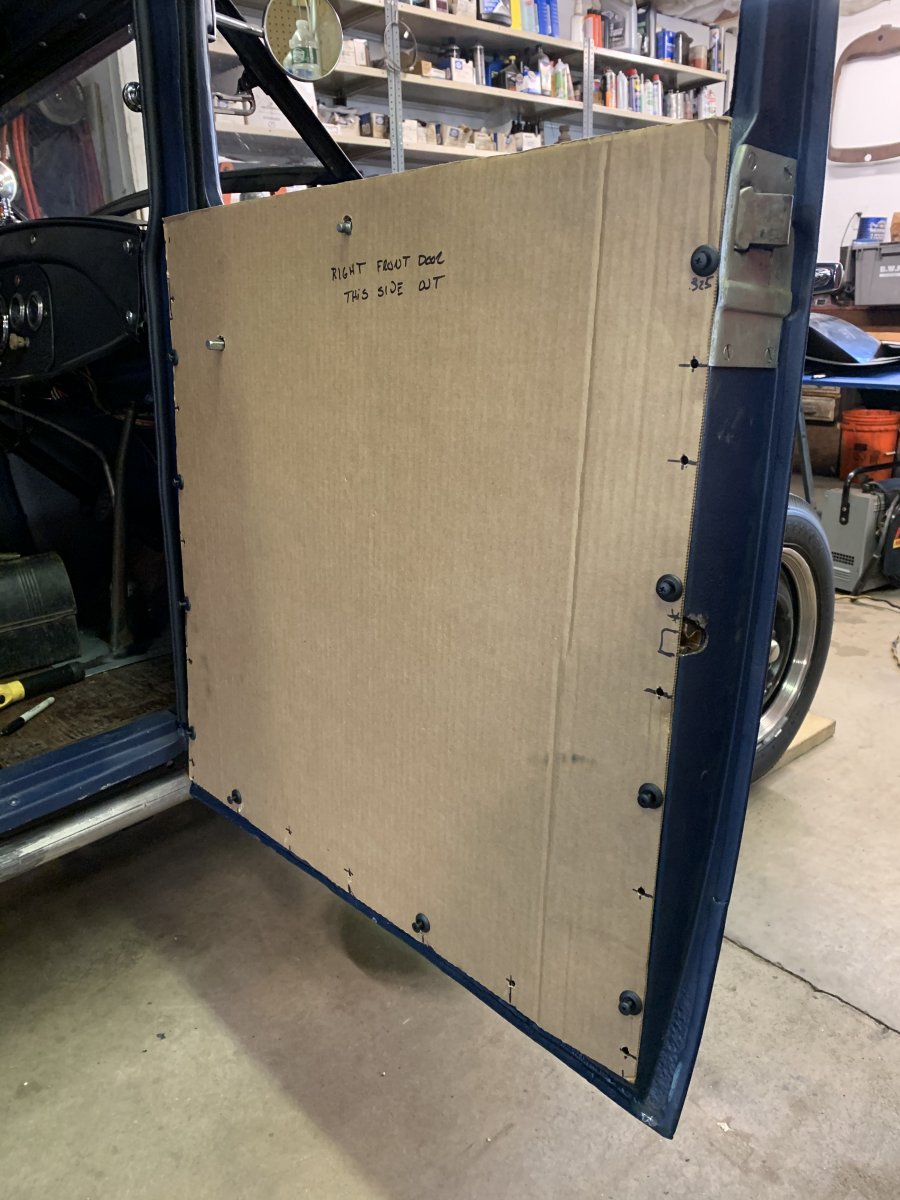

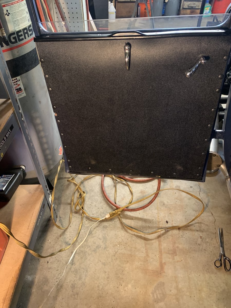

    Started making interior panels for my 28 Tudor.

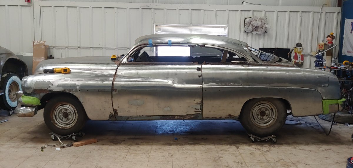

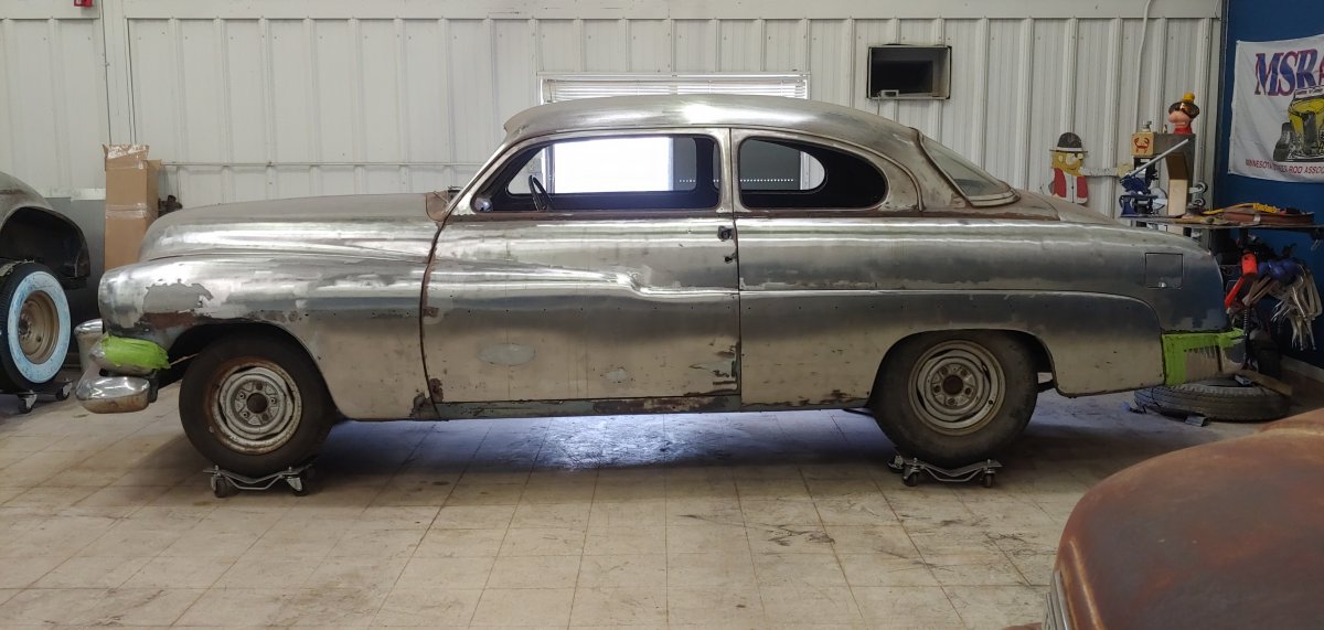

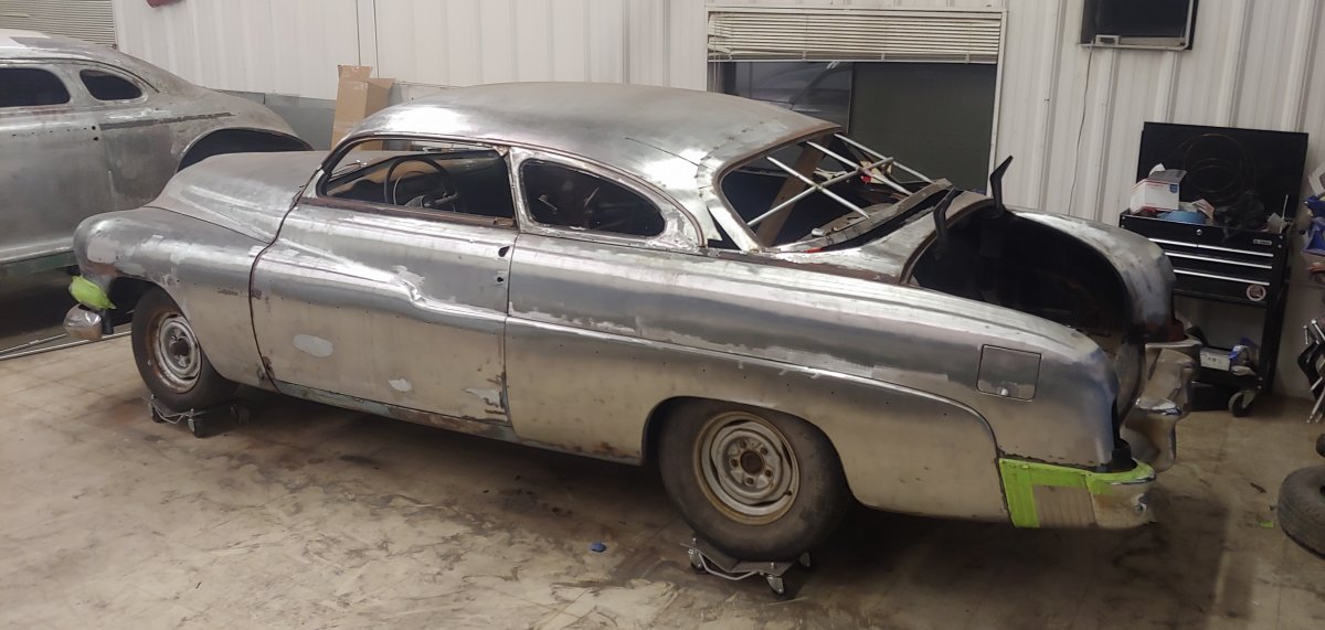

    Just another day making things melty... The B pillar on the Merc is slanted 1.5" past what it was supposed to be. The '47 Ford will get a few more custom touches before going to paint. 20200302_215506.jpg IMG_20200302_212416_390.jpg IMG_20200302_212416_391.jpg

    If you haven't seen it, that bottom shot looks like the Hot Wheels Tail Dragger.
