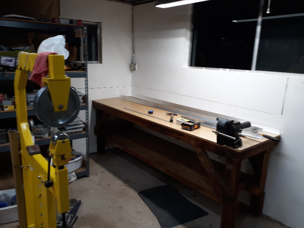

    Started on a long overdue upgrade of my shop. The shelves on the right have a 30+ year collection of "stuff". The shelves need to be pulled, plywood and paint applied to the walls, then put back. probably 30% of the shelving contents needs to find it's way to the trash...

    It seems that no matter how much you toss out, the pile continues to grow...

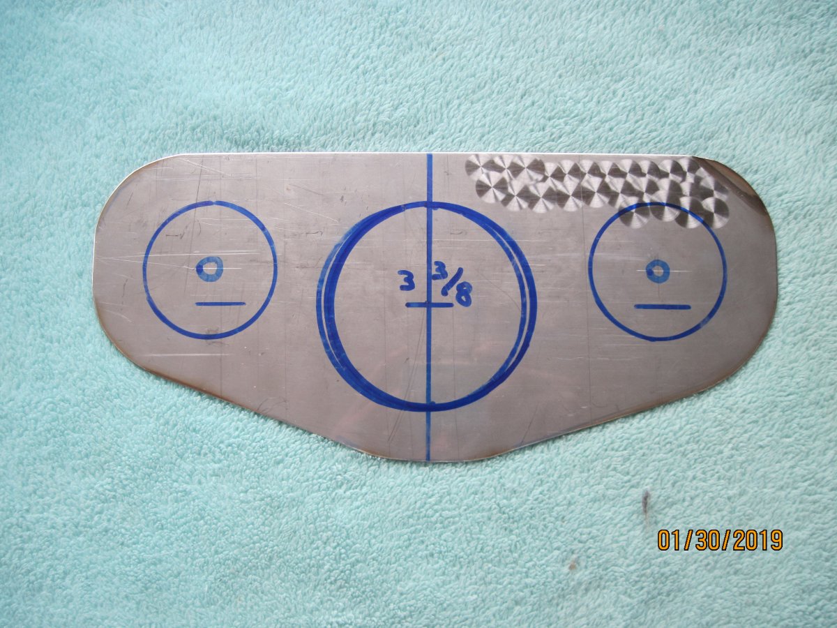

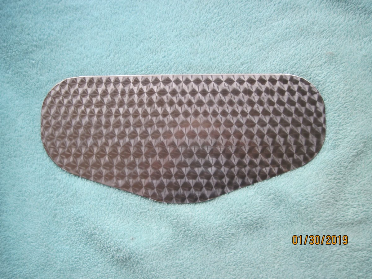

  13. Today? Not at -5 degrees and -20 windchill. Recently, though, I picked up a piece of 16-gauge stainless from the ends bin at my local metal vendor. I cut it down to a piece around 12" by 6" or so, ordered some Cratex half-inch sticks, went to the drill press, established a 0.4-inch grid on some cardboard and did a little engine turning. I'm satisfied with the results, and will cut holes for a 3-3/8" tach, flanked by 2-1/16" trans temp and oil pressure gauges. Then I'll drill some holes for turn signal indicator lights, a high-beam indicator light and an ignition light. I'll mount it up above the windshield of the '29AA I've been working on for decades.
    My bi-metal hole saw may be toast after cutting through the stainless for the smaller gauges, and that may convince me to "invest" in a diamond-imbedded 3-3/8" hole saw for the middle (tach) gauge hole. If so, that forces me to make more of these and sell them, to IMG_2155.JPG IMG_2157.JPG IMG_2157.JPG allay the cost of the pricey hole saw. Whaddaya think?

    I think it looks *****in!

    I used hole saws on my kid's mill to make the gauge holes in my dash. The VFD let us use a slower speed than I could on my drill press. If I did it again, I think I would try a fly cutter and carbide bit.
    In the past I did it the old fashioned way of drilling holes around the perimeter until the center was out and then finishing with a file. I kinda remember that as an accomplishment, getting five gauge holes in a piece of 1/8" stainless.
  18. Thanks for some optional ideas. I wish I had a mill - and the skills to use it - and I guess it would be cheaper to take it to a machine shop and have the holes fly cut. I'll try my bi-metal hole saw on the small holes first, use lots of cutting oil, keep it cool and take my time.
    Thanks all for the positive support.

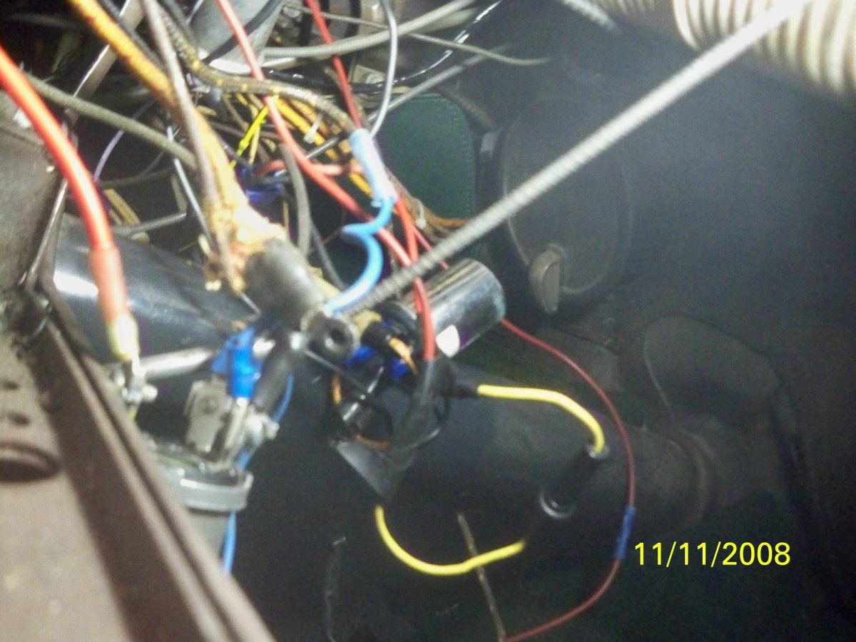

    Too much spaghetti for even my appe***e!!

    My wife did a cluster plate for my '55 F100, similar to your op, but used a circular 7/8" wire brush on the drill press, indexed it and ran the rows like clockwork. Then she did a full length 'strip' across the lower half, matching the engine-turned pattern.
    She didn't use stainless, however...it was hard aluminum. The back said, "SPEED LIMIT 55"...
