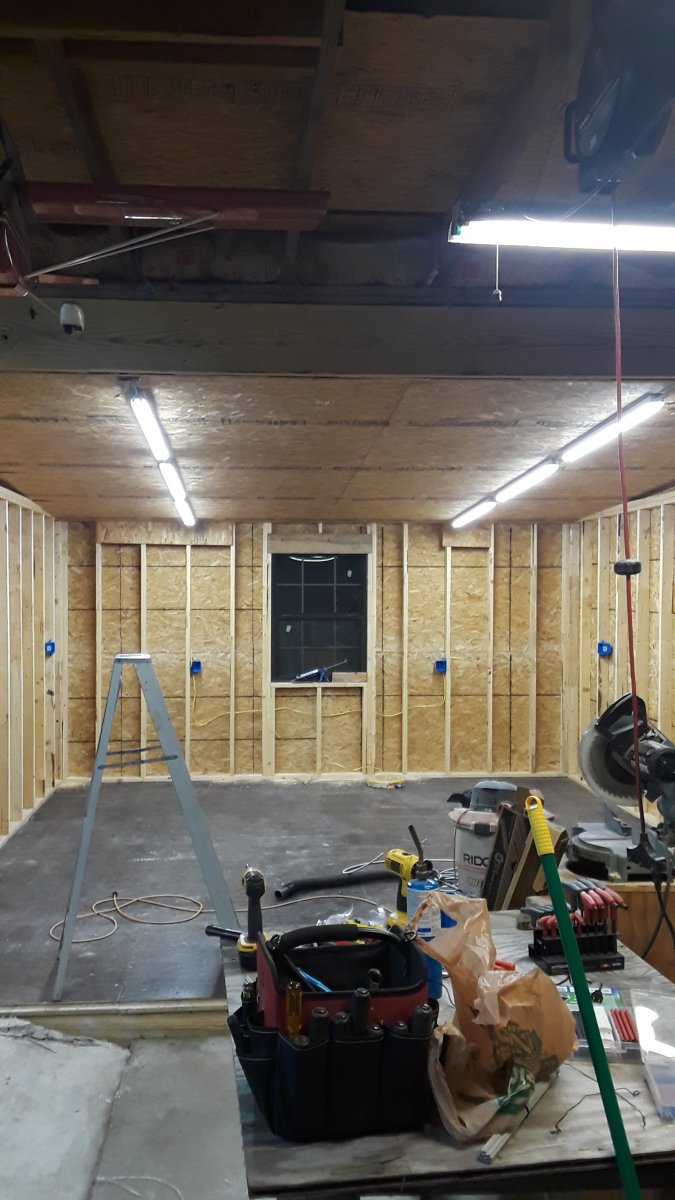

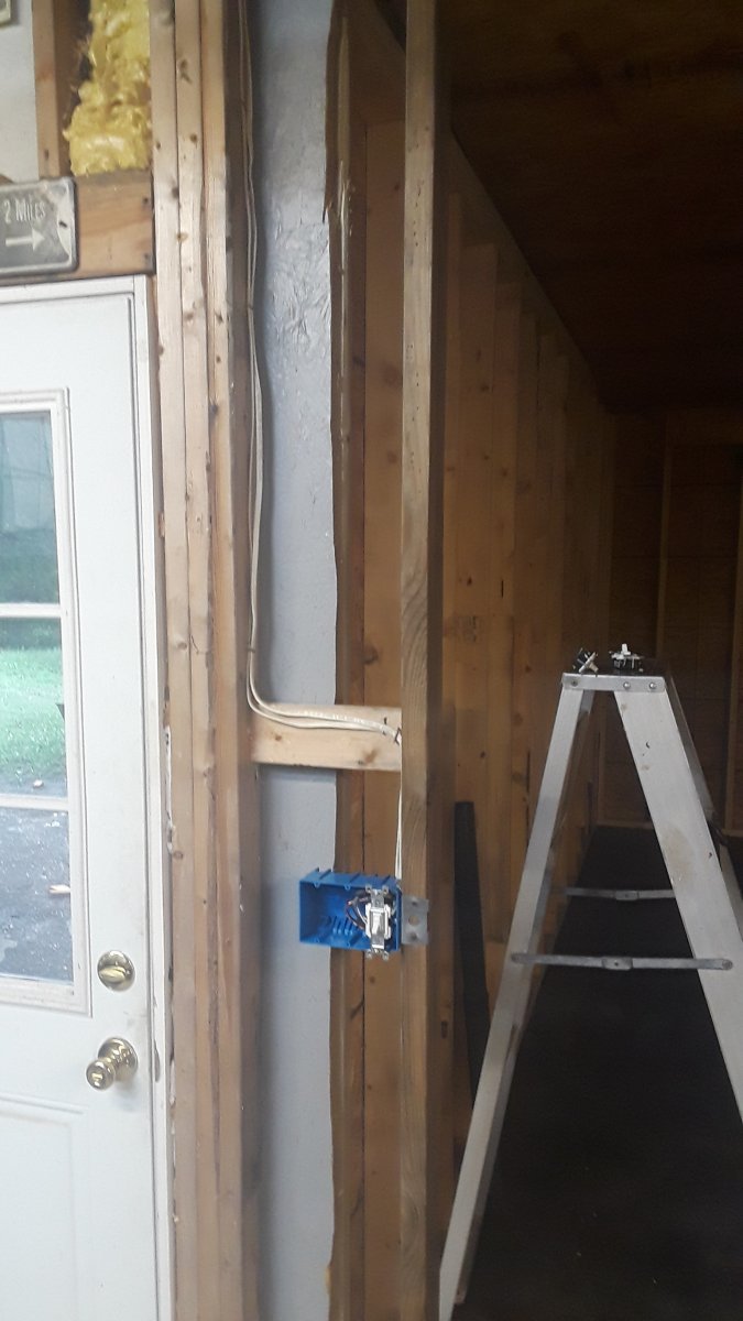

    More progress on the shop. Lights and a switch installed and started roughing in the electrical. 20190419_223255.jpg 20190413_165722.jpg 20190413_165726.jpg

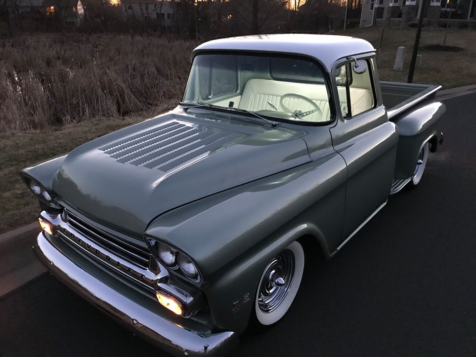

    That truck is extremely well done, brought back memories of my Dad's. Thanks.

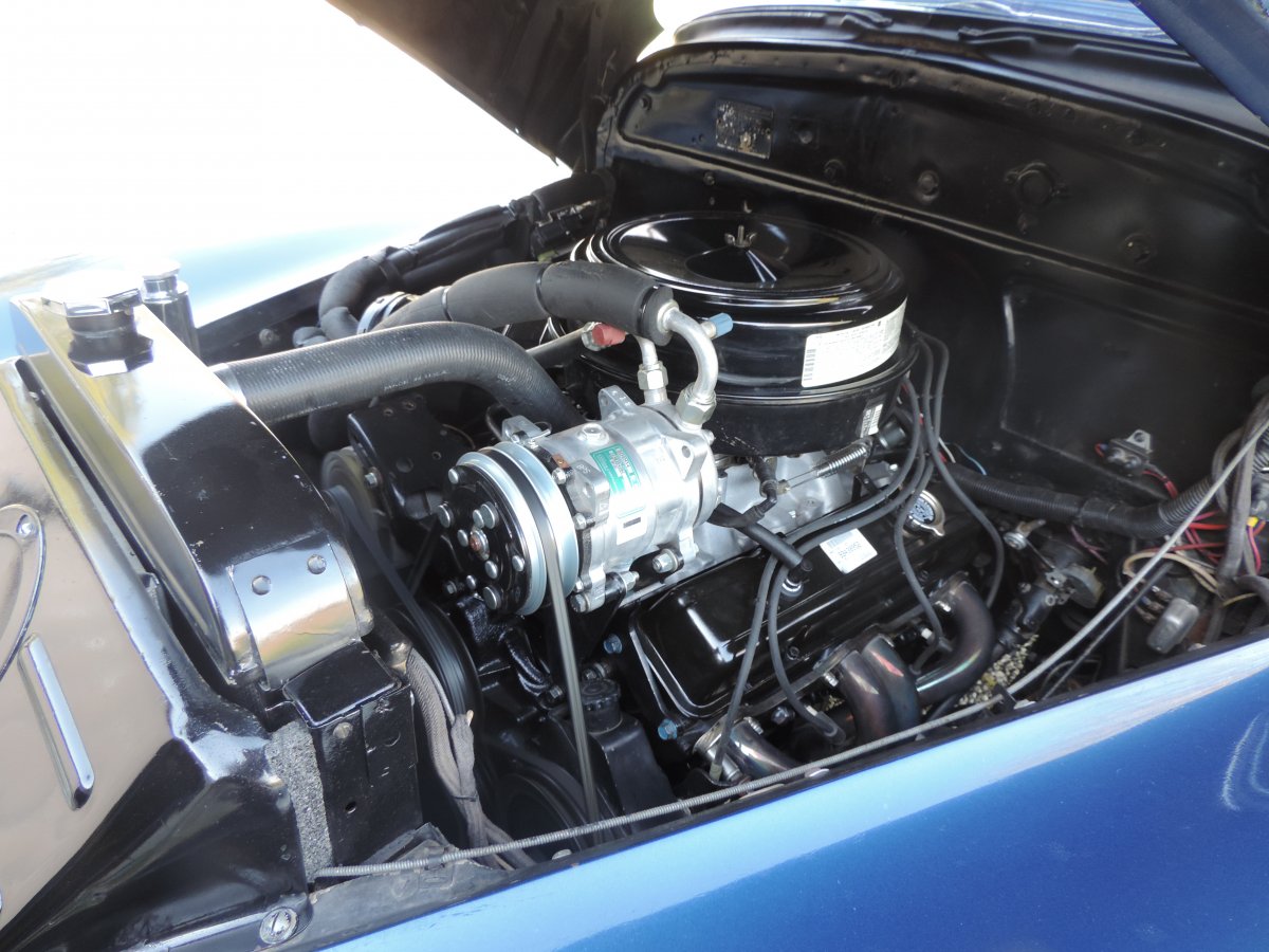

    Installed a new crate engine in the old 48; now I've been racking up some miles to break it in. Those crate engines sure have low oil pressure, instructions say it should have 20 psi at 2000 rpms. DSCN3334.JPG Found out that my oil pressure sender was bad. Installed a direct reading gauge and the pressure is over 50 psi and about 30 or 35 psi at idle. That is sure a relief, engine sounds good.

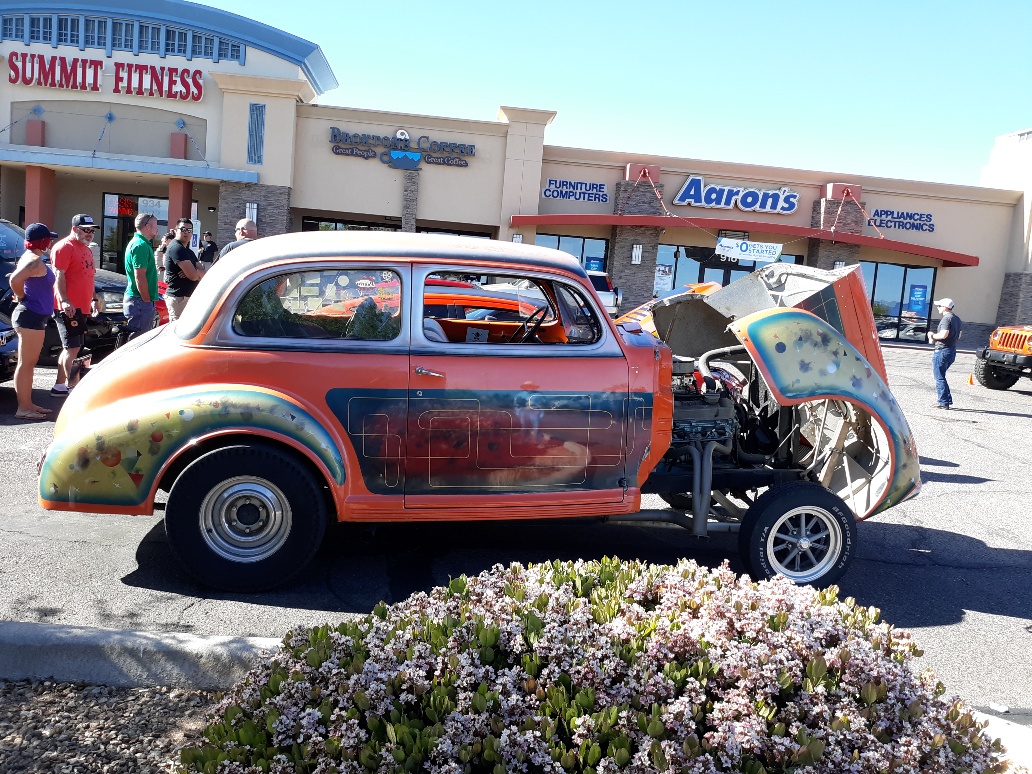

    Cars and Coffee this morning. Mostly off-topic stuff.
    Paul Herbert's Studebaker. He used to be active here, I can not remember his HAMB name.
    I did see some nice work on a 54 Chevy low rider and some neat customizing details on a Karmen Ghia.

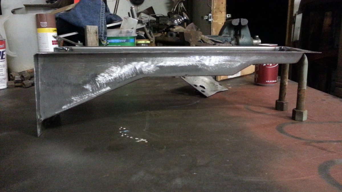

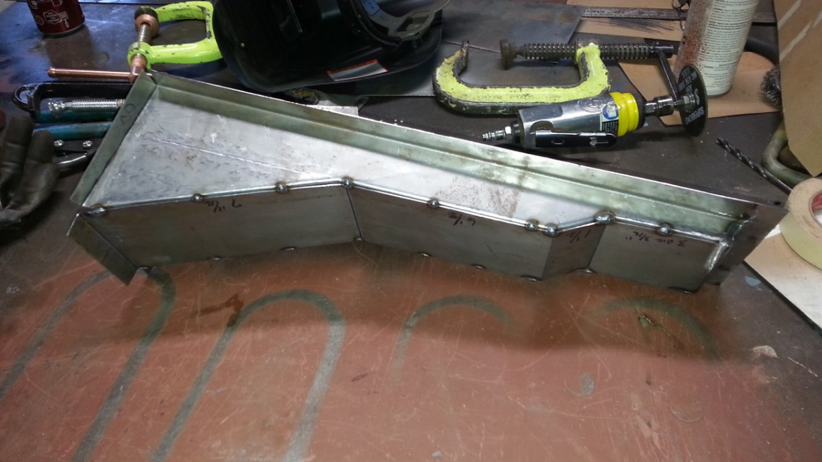

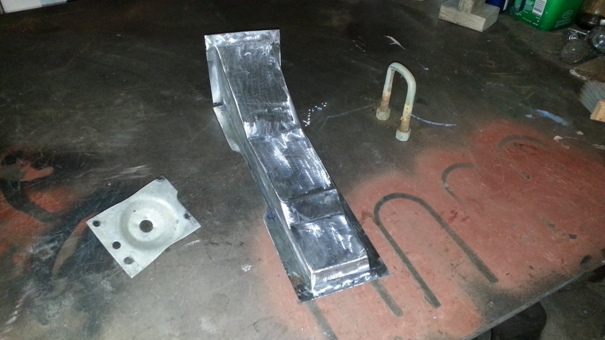

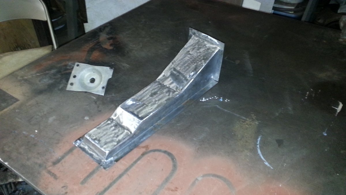

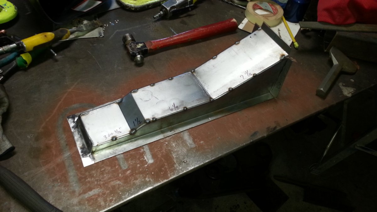

    Built a cab mount for the Unibody, Its not as simple as it looks. The cab floor has a slope to it and the mount kind of wings forward a little from the lower door pillar where it mounts......just have spray the inside and cab floor with weld thru primer and Im calling it a day! 20190420_141623.jpg 20190420_141702.jpg 20190421_213611.jpg 20190421_213636.jpg 20190421_213729.jpg 20190421_213948.jpg
