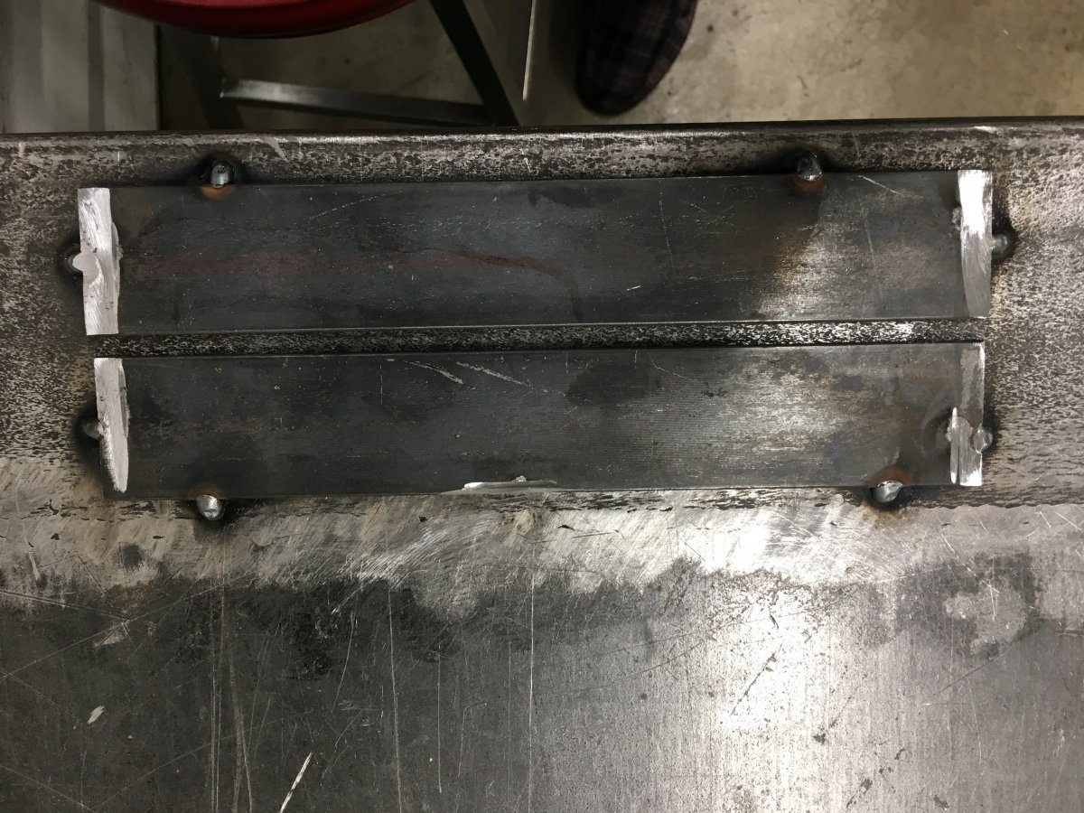

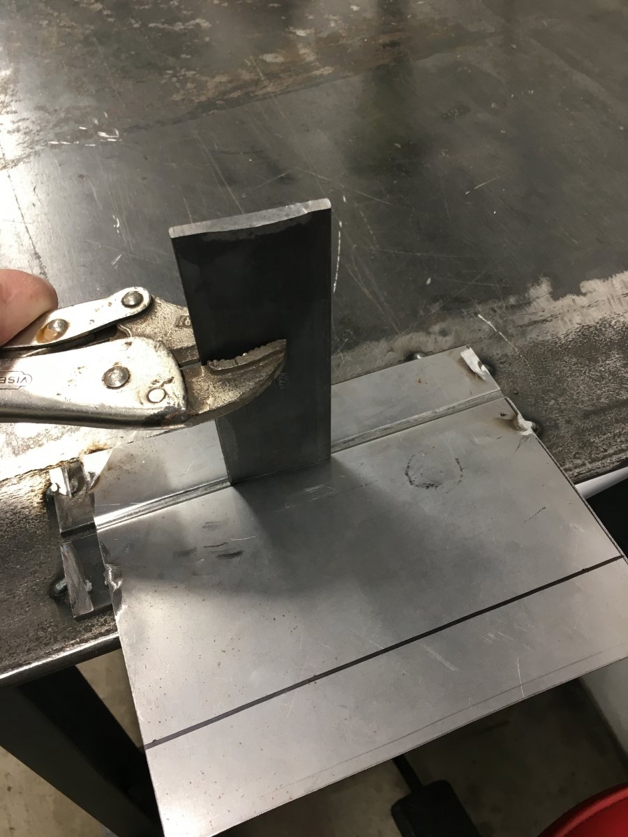

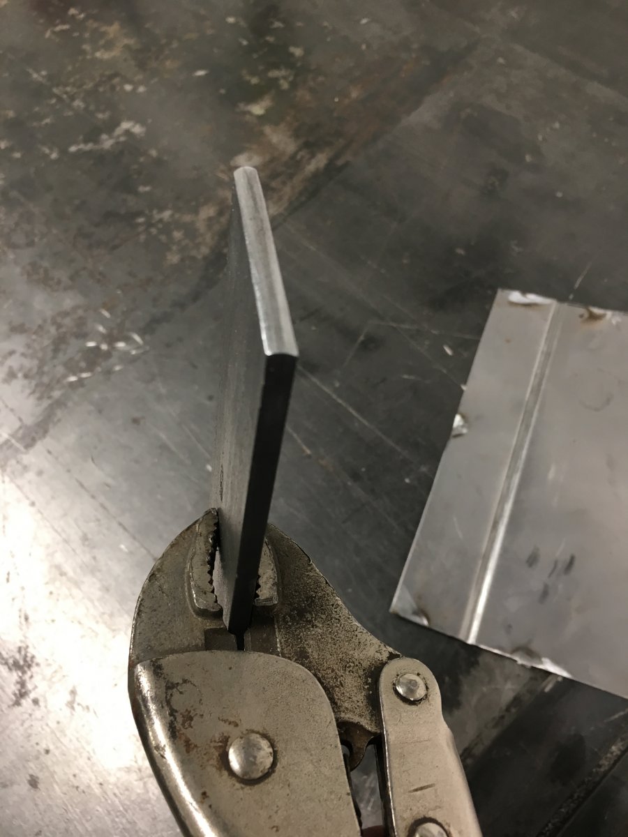

    Needed an 8" long piece of narrow bead to replace rusted section on 30 cowl that the cowl band sits on. Looked thru my bead roller dies and didn't think I had any combo to do the job. Searched the hamb and saw a solution involving tacking 2 pieces of flat bar to the welding table, rounding off the edge of a piece of flat bar to uses as a die, and pounding a piece of sheet metal into the gap between the flat bars with the die. Worked to my liking on the first try. Thanks hamb!!
