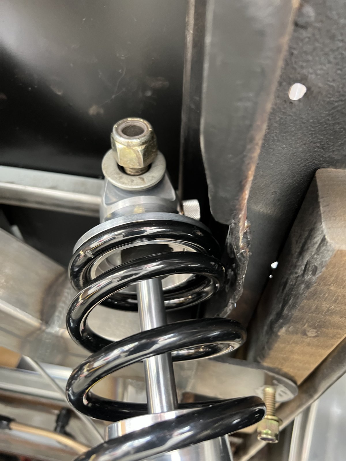

    Spent the day finishing up some small projects. Added bearings and washers to coil overs to make adjustments easier. Fixed a brake that was dragging. Made up stainless steel pipes for radiator hoses. Top hose I found an elbow that worked. Bottom one I made up from a 90 and 45 elbows. I’ve never welded stainless before, so I took the pieces to a local shop that does stainless piping for dairy’s and creameries, and had them weld it for me. DB6AD443-2FCE-406B-8607-90AEB6AD7C5A.jpeg

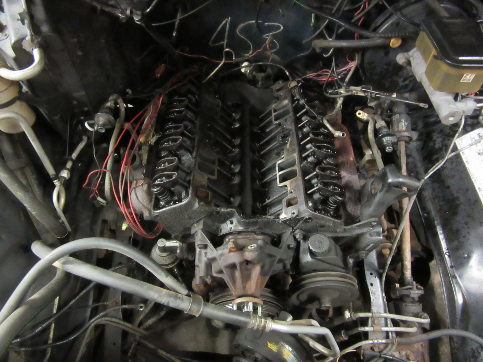

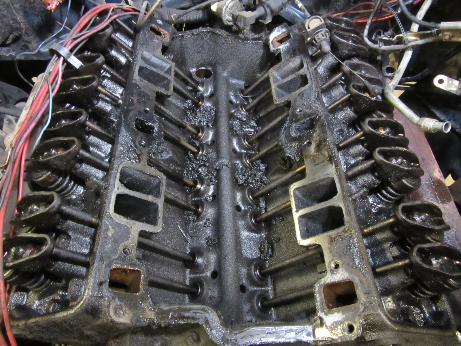

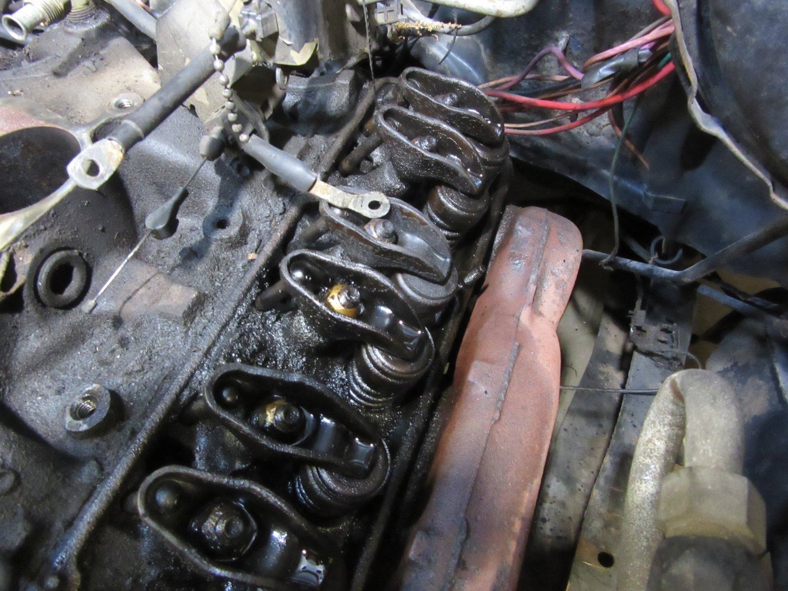

    No offense intended, but man that is nasty! This isn't your engine is it? To me this screams as belonging to a guy that insists the need to change oil is a myth, that oil never wears out, you don't have to change it; and that he hasn't changed the oil in 50 years and has never had a problem. Ima save these photos for the next thread that somebody says that...

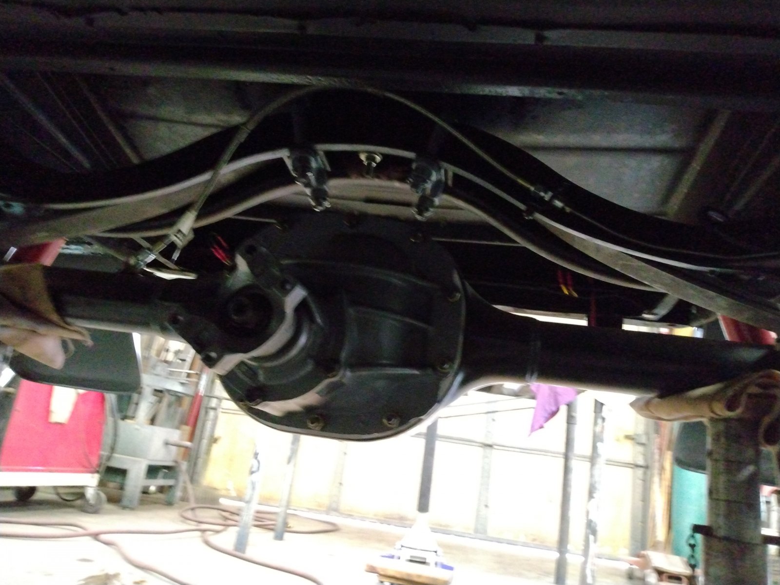

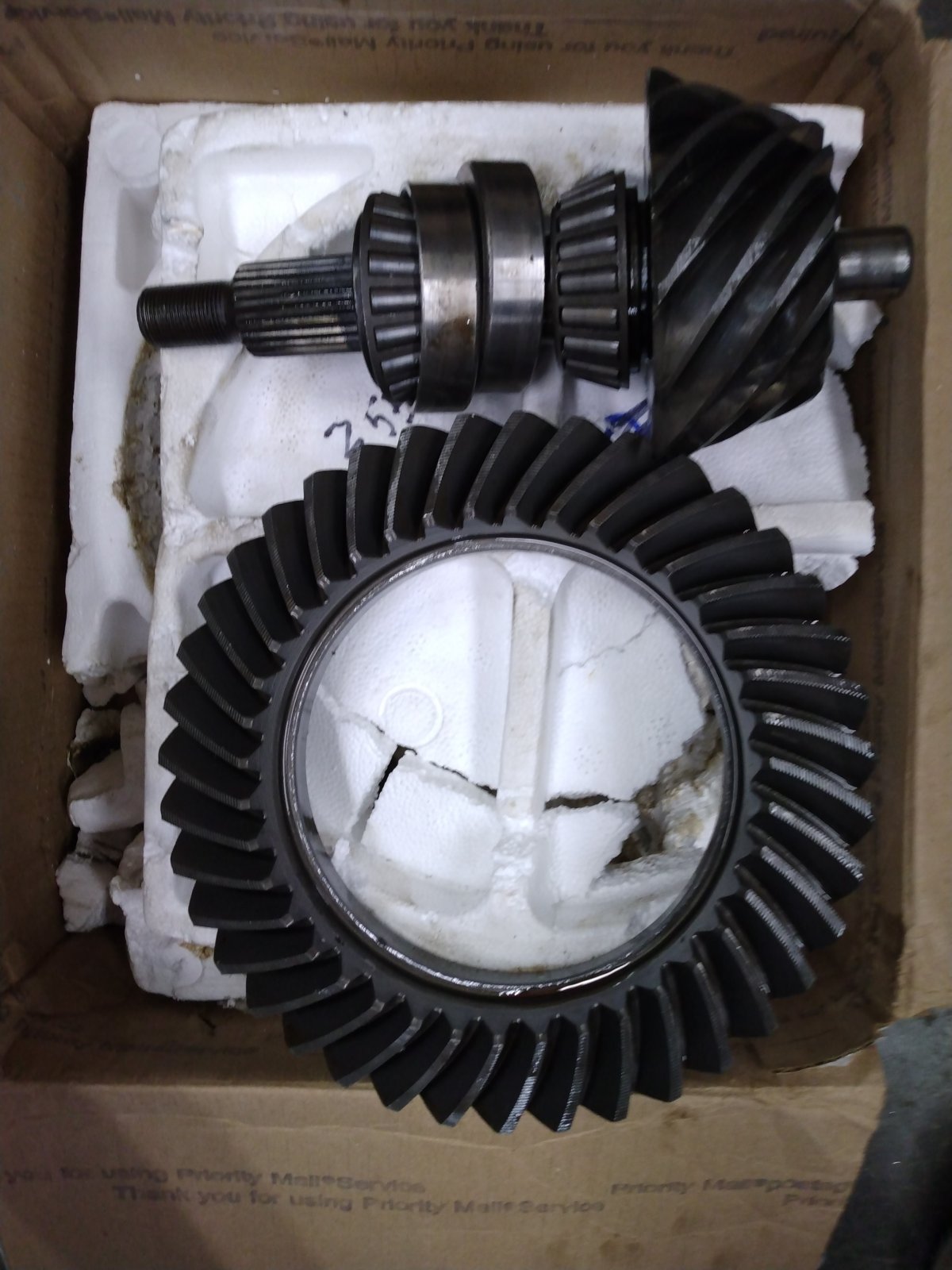

    My Model A coupe with a 2.5L Iron Duke Chevy didn't have much poop when pulling hills with these 3.00 gears in the 8" Ford rear end....
    ....so, I got a good, used 3.55 R&P from another HAMBber and installed them in here...
    The change should bump RPM by about 400 at 57-ish MPH, so maybe the little 4 banger can keep up better on the road. I just hope I did a good job of setting them up so they don't whine or grind going down the road!

    No offense taken, it is mine. It's in a old truck I bought. I planned to freshen it with some valve seals and a timing chain but after I got into it I just am going to do the seals. But really it is not that bad. I just washed it up and vacuumed it out real good and will put it back together and see how it does. Your right though it is nasty, neglected service and just cooking the oil. Pretty common sight back in the 70's and 80's . I know modern oils are much better than that time frame and the OEM's turning the temperature up on the motors keeping the oil dryer has made a huge difference.

    The gear change was a big success, now taking on hills with much greater ease. and didn't notice the rearend grinding or whining. But, then again a Model A makes a lot of ambient noise to drown out any pesky mechanical malfunction noises.

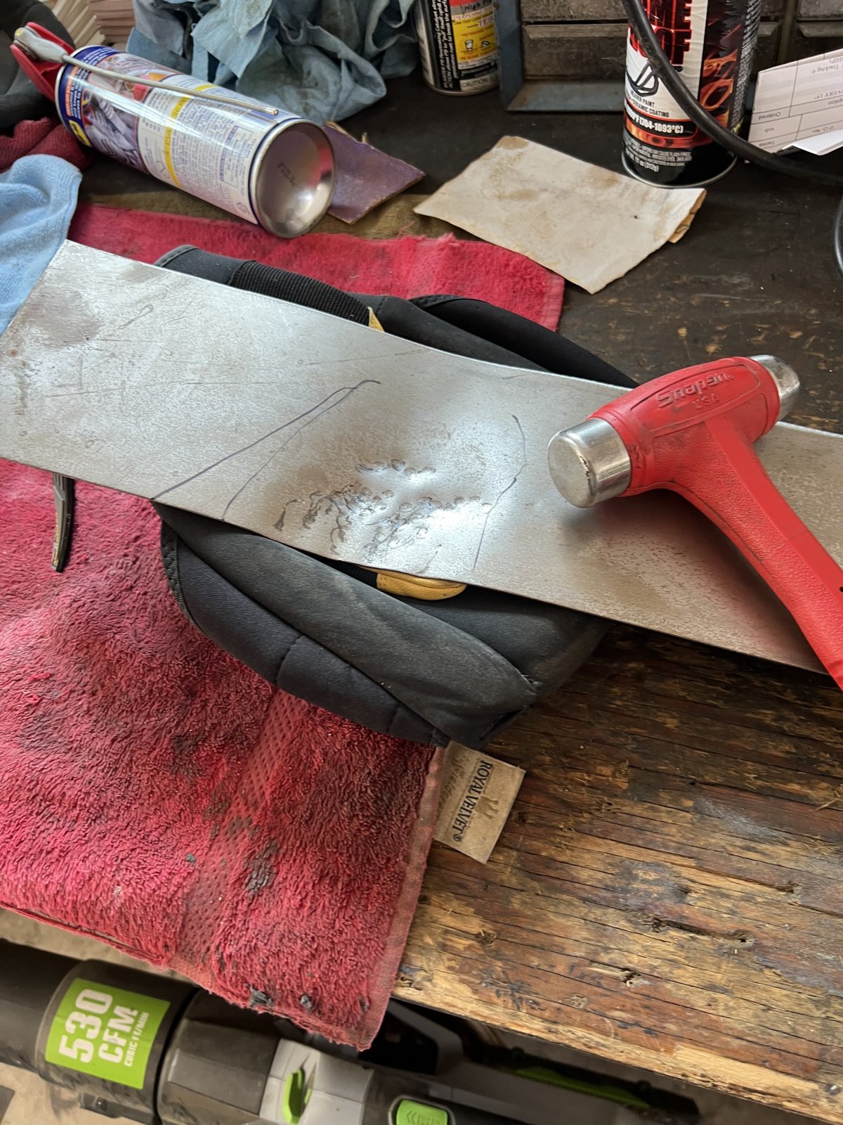

    Needed to make two small panels for under car for the coil overs could clear the sub rails. Didn’t have a shot bag or mallet. So I improved a small shot bag out of a knee pad and leather glove. I used a ball peen hammer to get a shape. Then used a hammer and dolly to smooth it out somewhat. Needed a little more persuasion once welded in, but worked pretty well.
