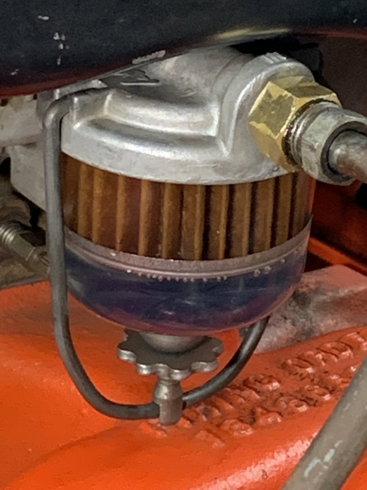

    I did a lot to the 57 by way of a new filter cartridge. ;) F8424FF2-3F9A-4E1D-85A9-6882FA1B7AF1.jpeg

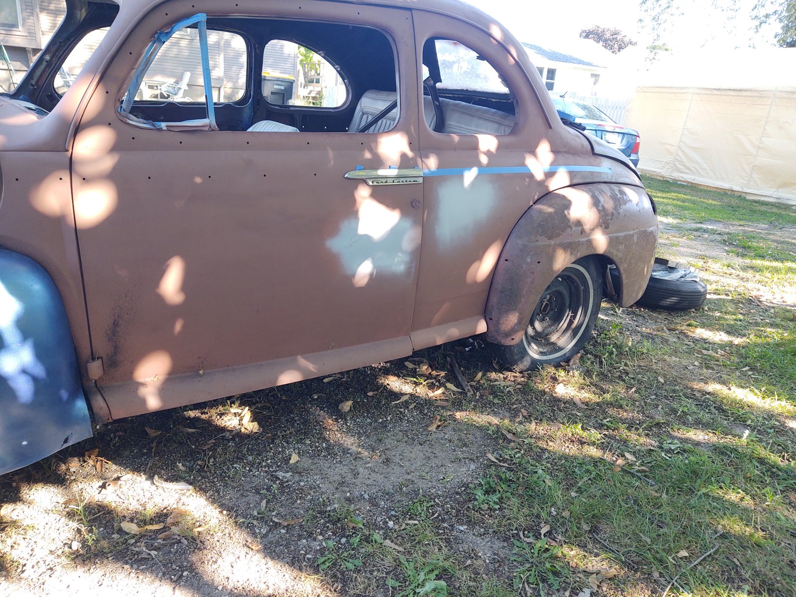

    Bought some 49 Ford Custom script pieces and been playing with their locations. I'm thinking about getting a rear piece of trim lay it out with the blue piece of tape IMG_20221001_162958099.jpg

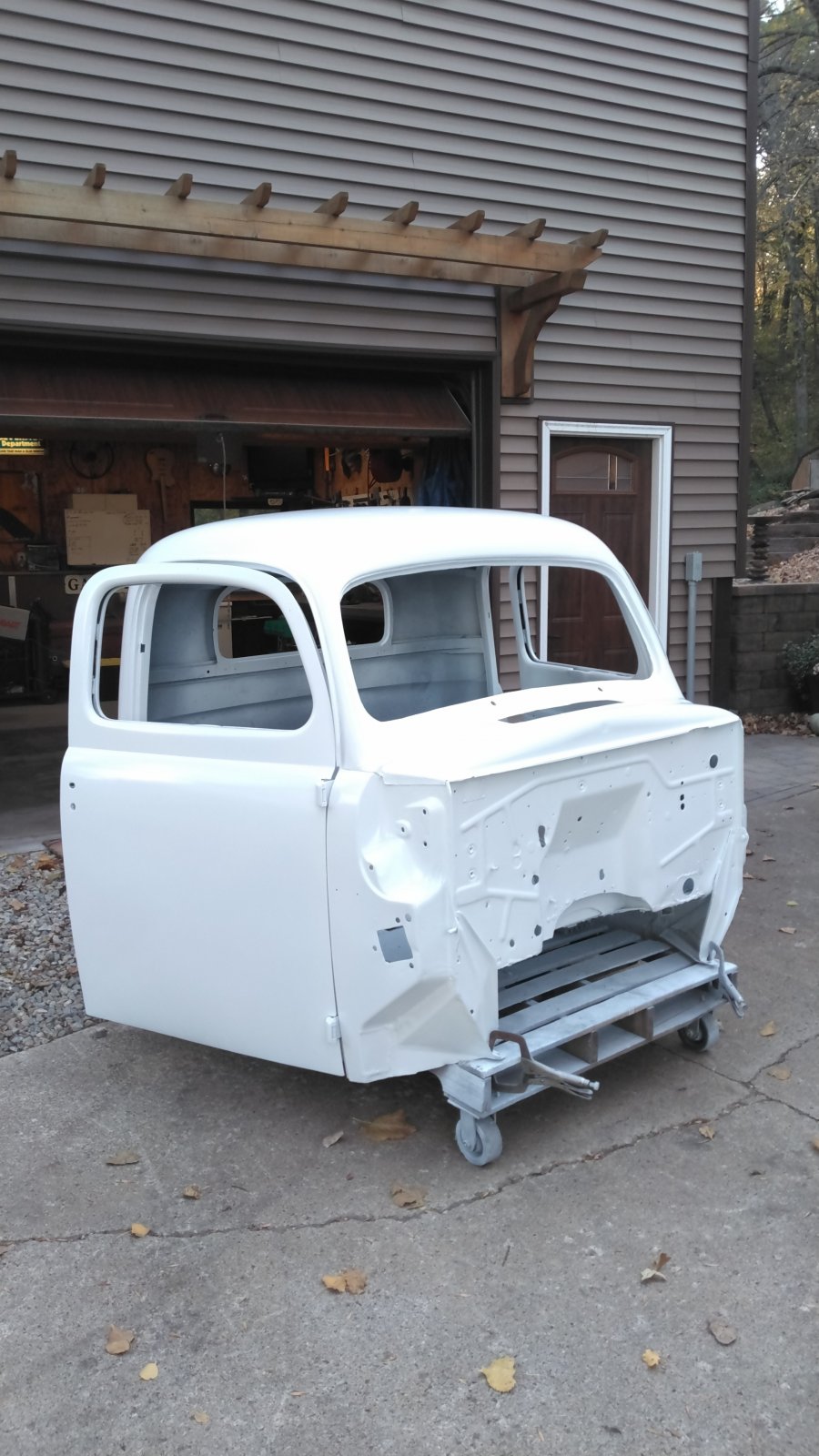

    KIMG1028.JPG Got my cab primed and painted. Have a few spots with some orange peel that I will need to take car of but overall it turned out pretty good .

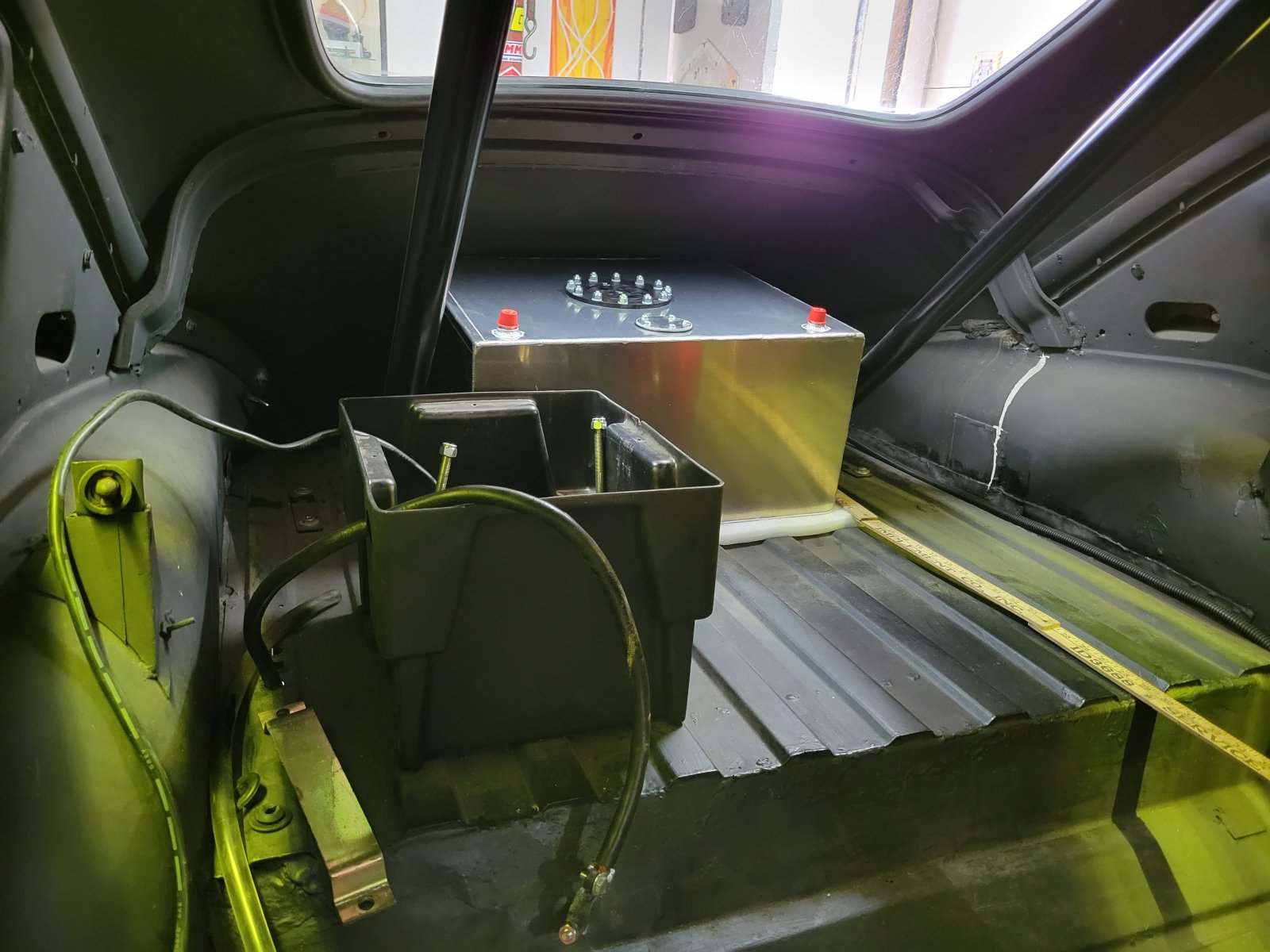

    Opened the can of worms, putting a fuel cell in the trunk less Henry J, sure won't be a bolt in lol

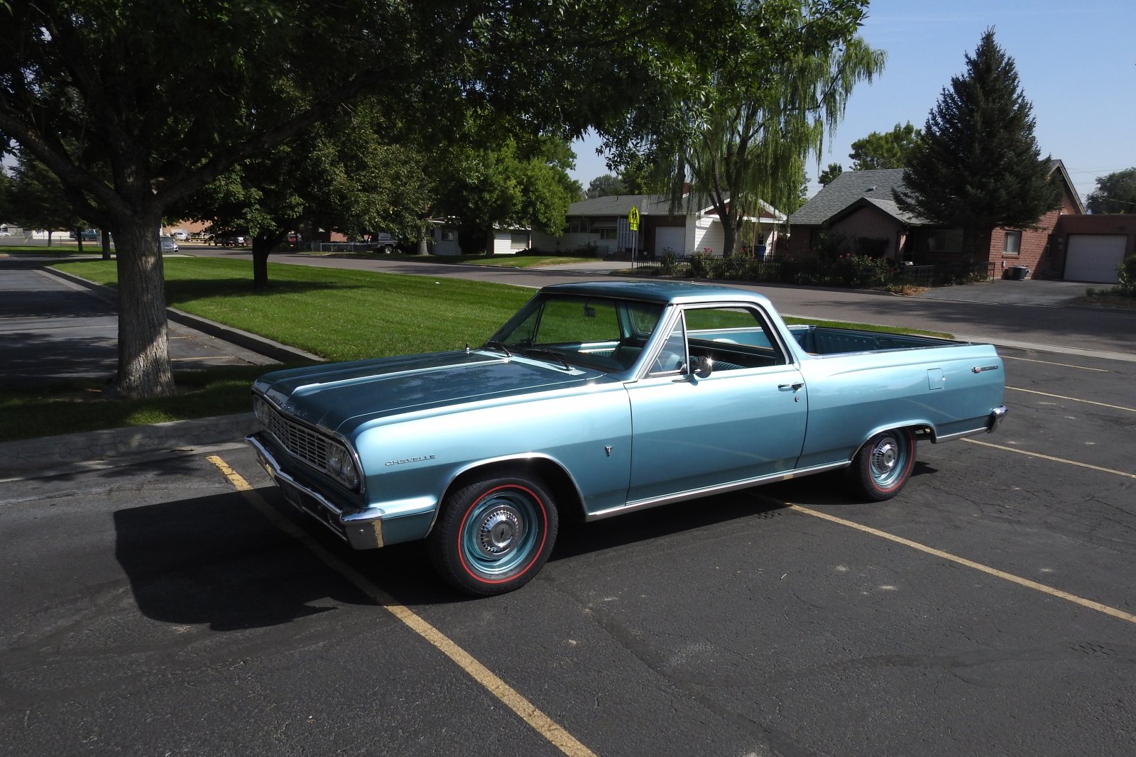

    Drove it 300+ miles. I think it needs some attention.

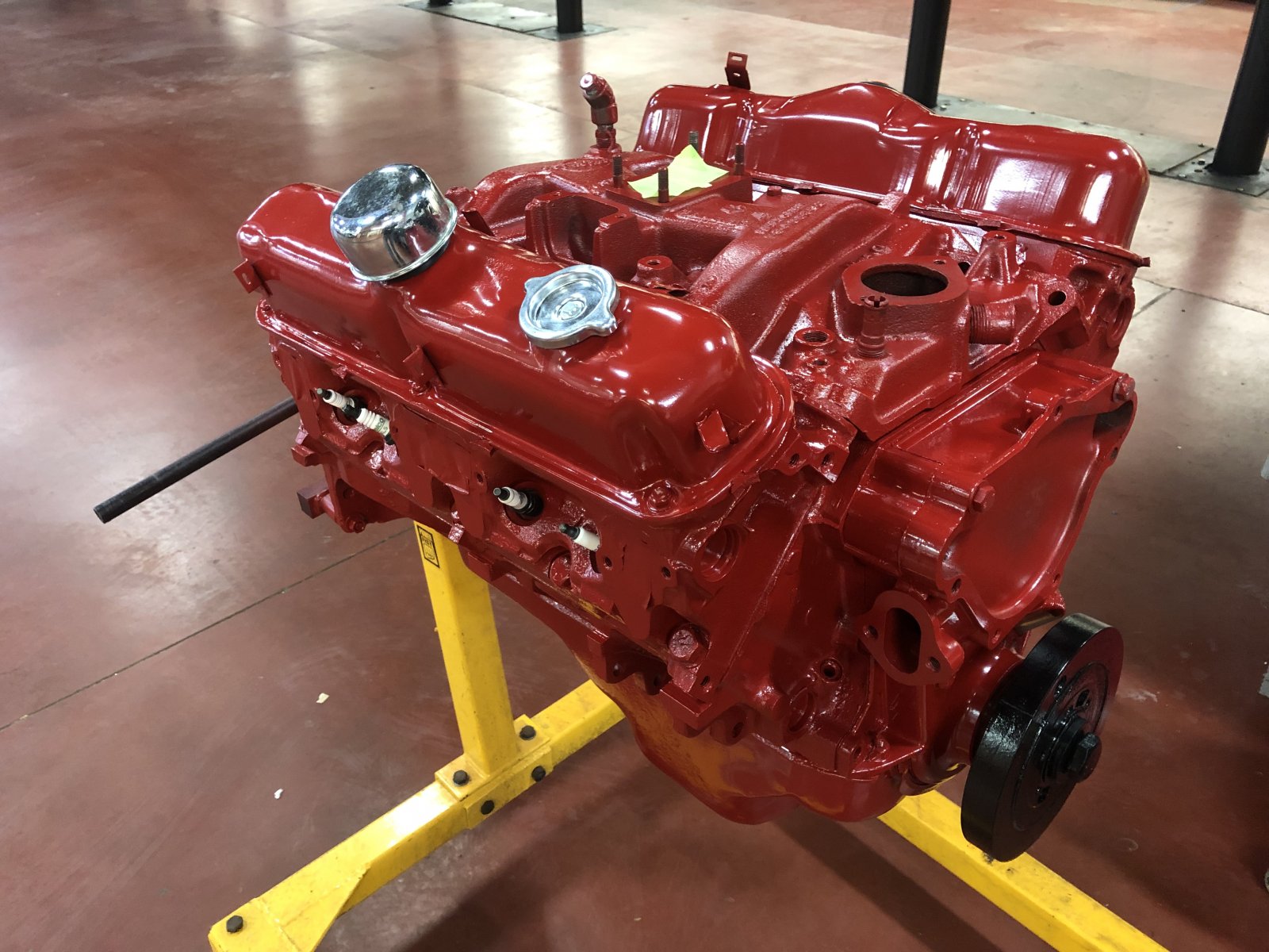

    Mostly finished 318 for the ‘64 Barracuda.

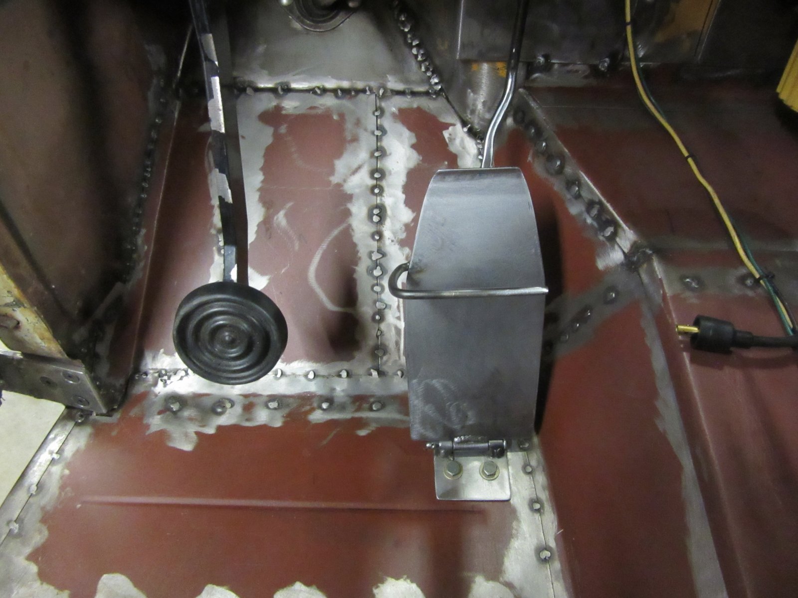

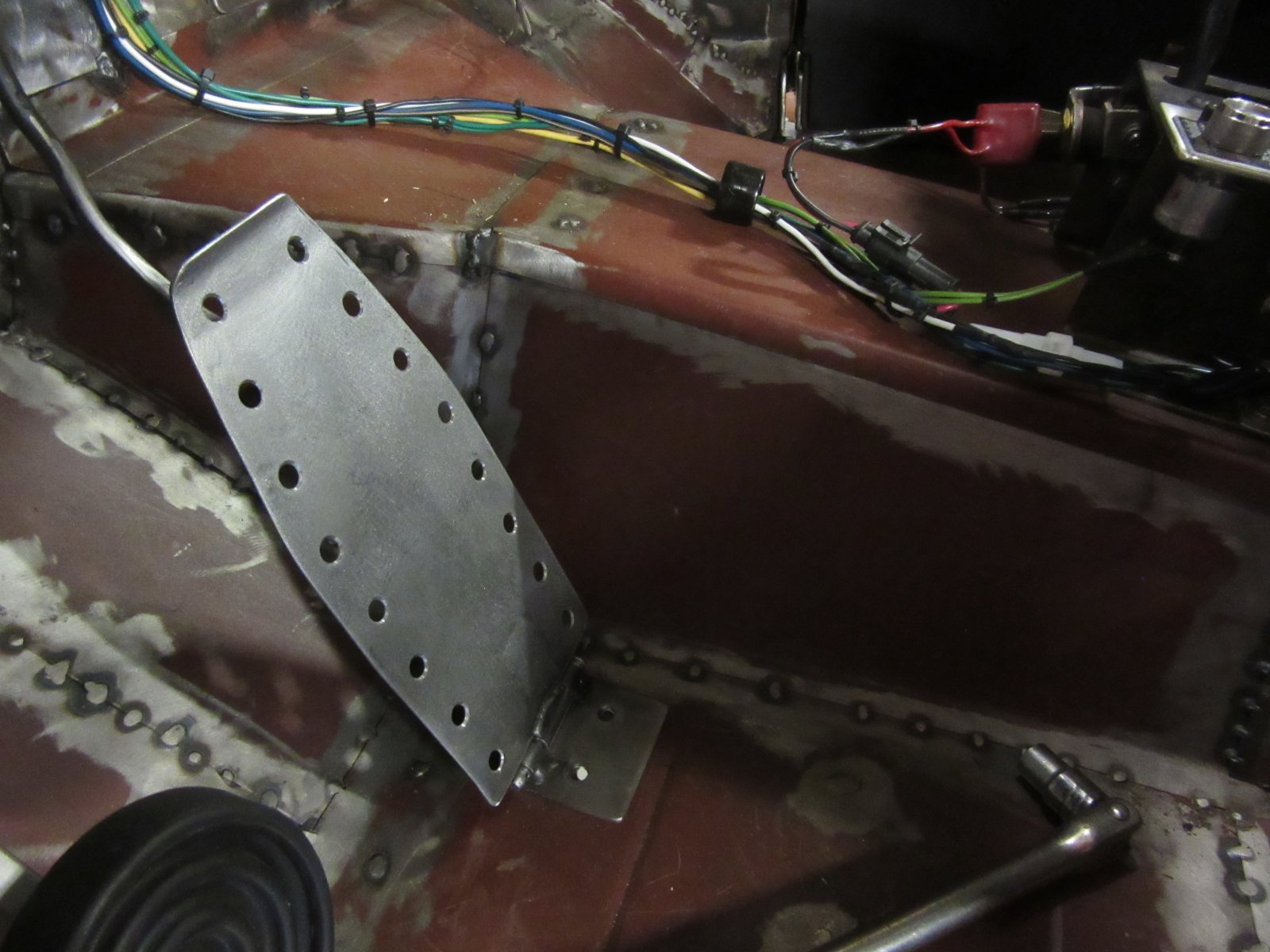

    I have a Dec. 3rd goal of getting this thing to the track. So I have a few things to do and giving it a once over after driving it this summer. All looks good, nothing loose. It had one cooler line at the trans. seeping but it tightened up so hopefully that will fix that. I have never liked the look of the gas pedal so I am making a few changes by IMG_0732 (2).JPG IMG_0736.JPG IMG_0153.JPG adding some holes to that also. I think it could stand to be leaned out a touch more but overall this thing has been trouble free.

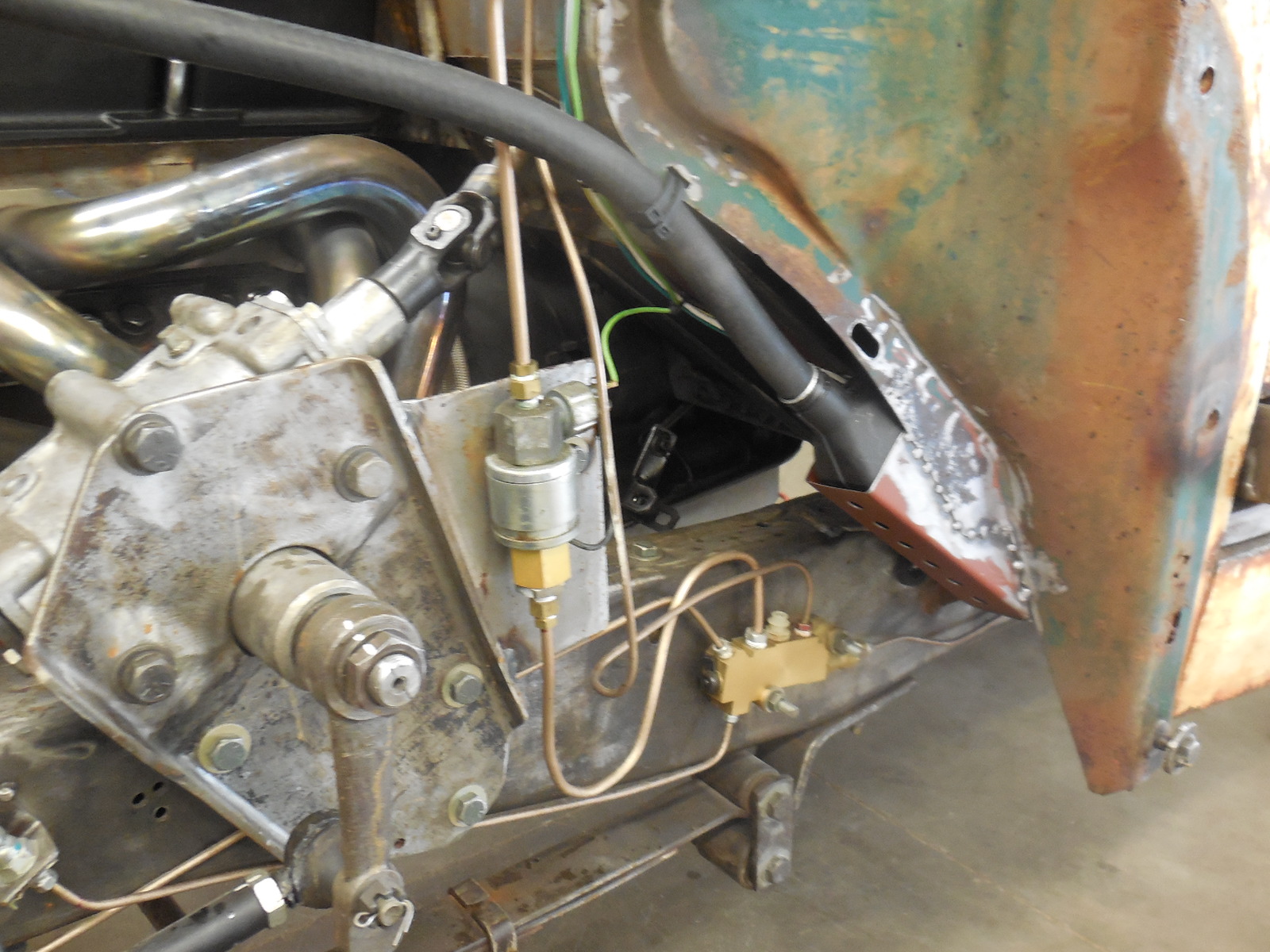

    I have the parts to hook my breathers into the collectors but to do a nice install would require pulling the headers, so with my track deadline approaching I took the easy way out. A couple 20 oz oil bottles and a little time should get me through tech.

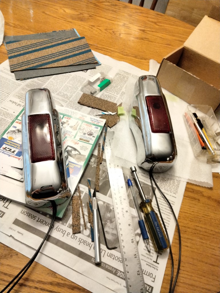

    Cut some gaskets and mounted the lenses and bulb housing in our bumper guard lights and then noticed the "Duolamp" lettering was upside down. Guess this turned out to be just another practice ***embly.

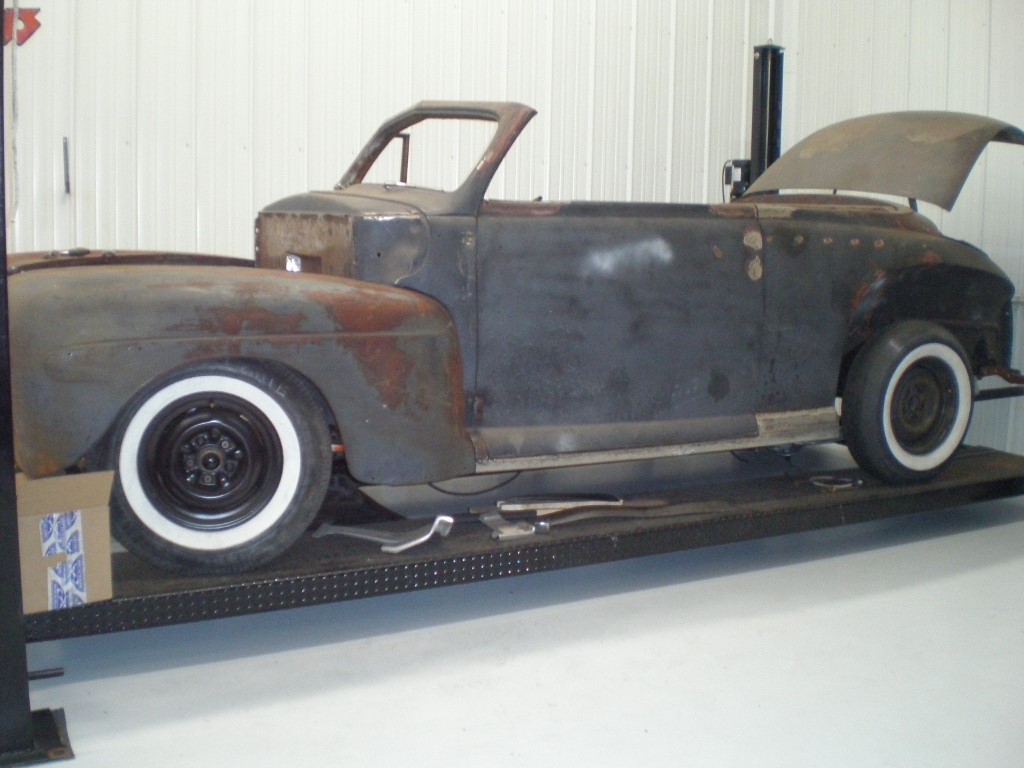

    Probably the closest picture of out '47 looking like car, from back in 2013 during one of the times I decided to work on it. Otherwise just random pictures of areas I have worked on here and there posted to this thread.

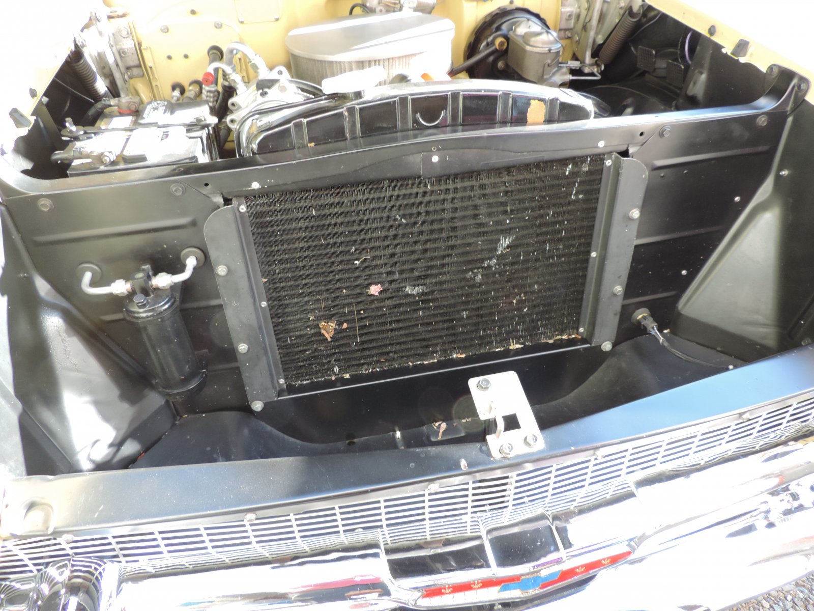

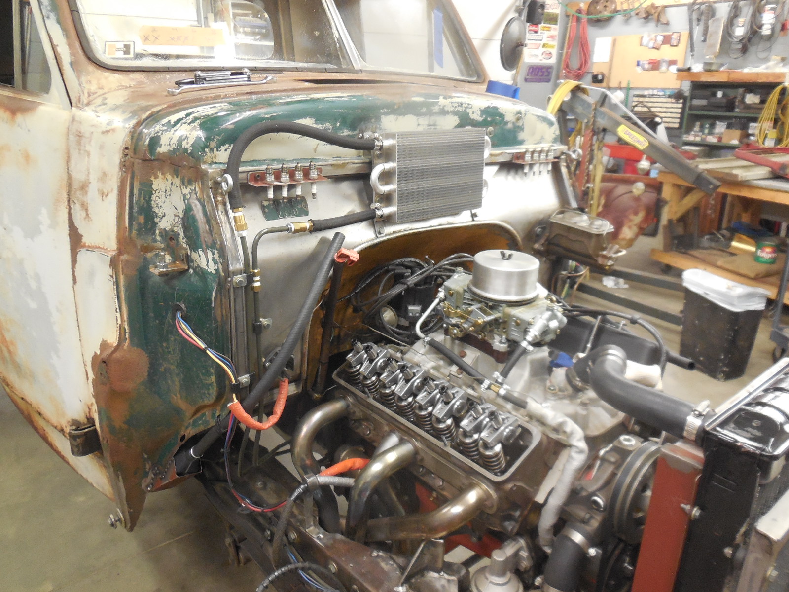

    Keeping a eye on my pieced together motor, I went through the valves and the good news is my used cam and mixed up lifters have made it about 600 miles with no issues. The valves hold there adjustment really well and all looks good, no condensation . Now on to getting the headlights working ! DSCN2665.JPG
  19. topher5150
    Joined: Feb 10, 2017
    Posts: 3,769
    topher5150
    Serious question.... How do you keep that ****** cooler cool?
  20. TA DAD
    Joined: Mar 2, 2014
    Posts: 1,625
    TA DAD
    from NC
    It is really overkill for this truck. The cooler has a 24k GVW rating and the truck weighs 3300 lbs. Depending on the application air flow across the cooler is not that important.

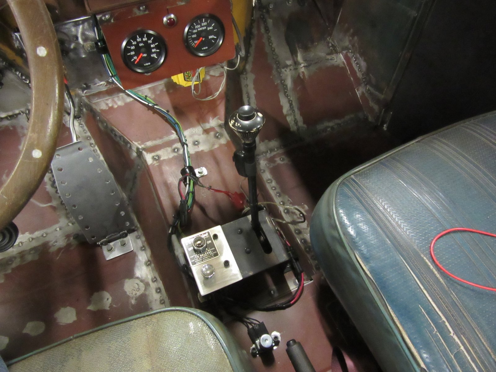

    I have the headlight switch in place along with a dimmer switch mounted near the shifter to operate by hand. The only thing left is to get the headlight buckets shaped up and wired along with getting the adjusters working.

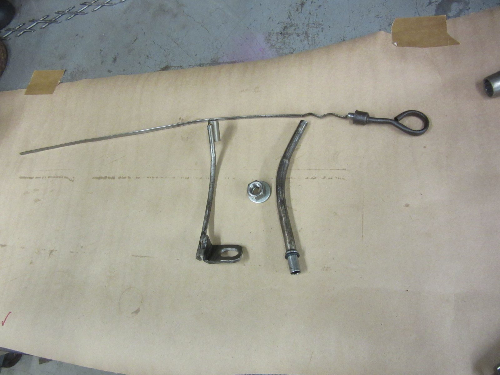

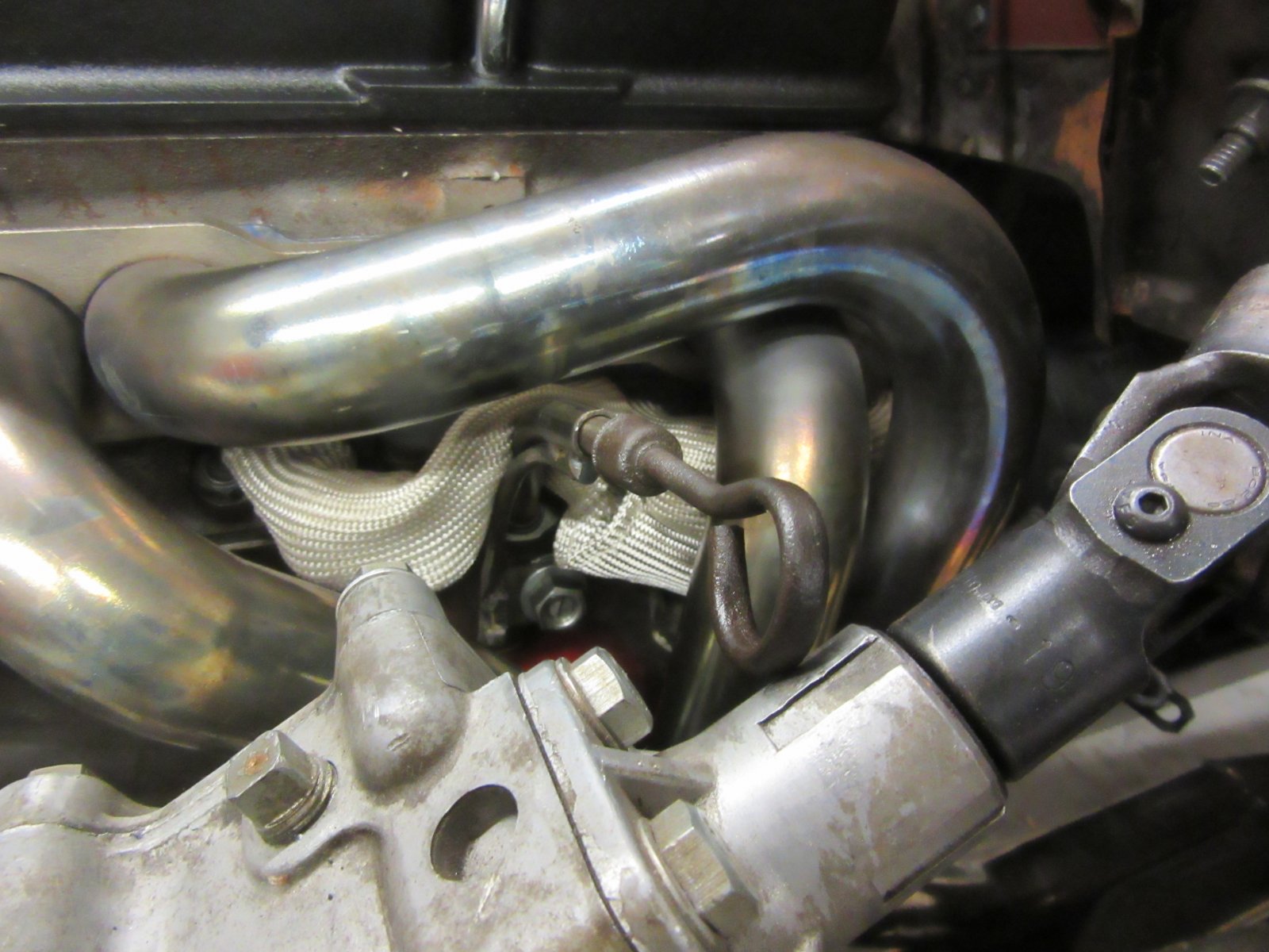

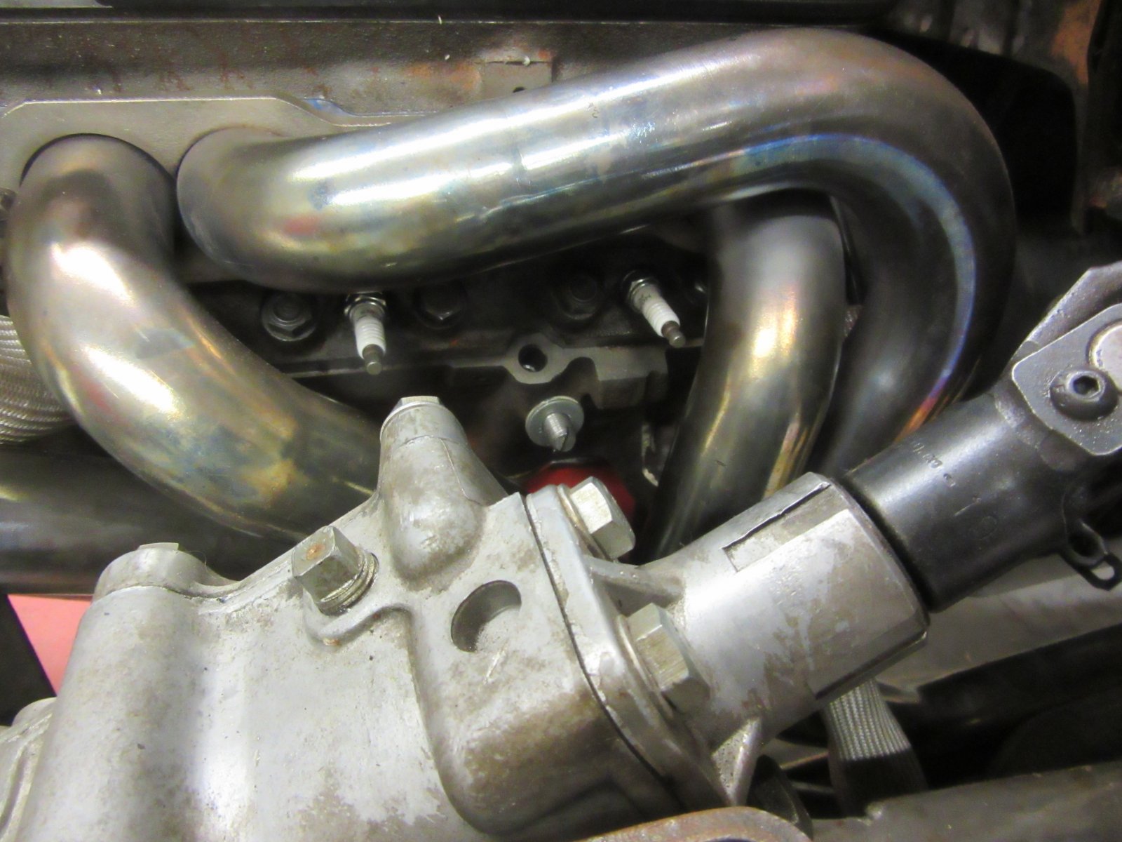

    Everything on this truck is easy to service so that is carried over to changing the plugs or removing the left header. To get 5 and 7 plugs in and out the dip stick is in the way so I fixed it with a bracket that can be removed in about 45 seconds and you can then slide the dipstick tube out of the block making plug access a breeze. IMG_0741.JPG IMG_0740.JPG IMG_0739.JPG IMG_0745.JPG IMG_0746.JPG

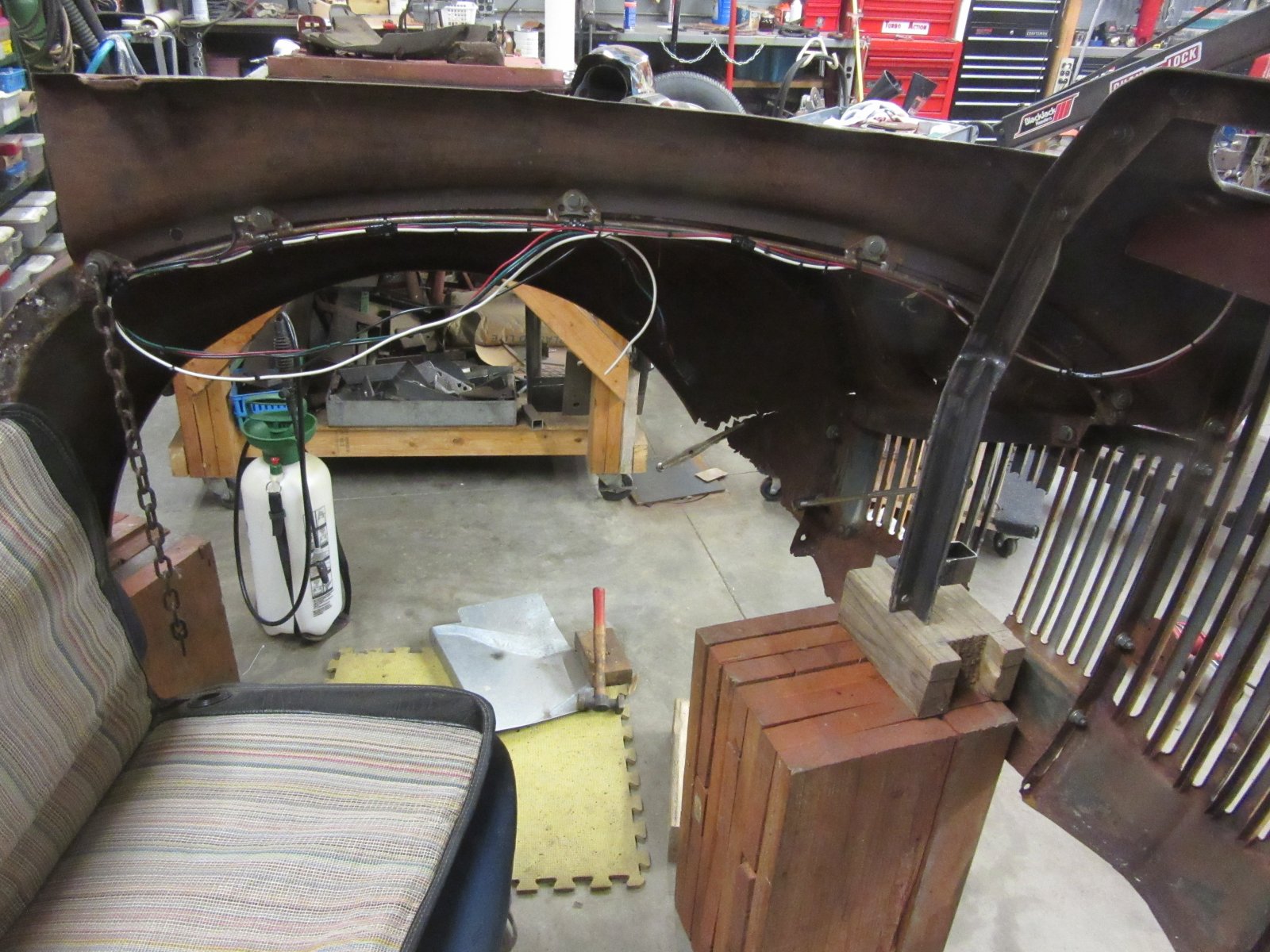

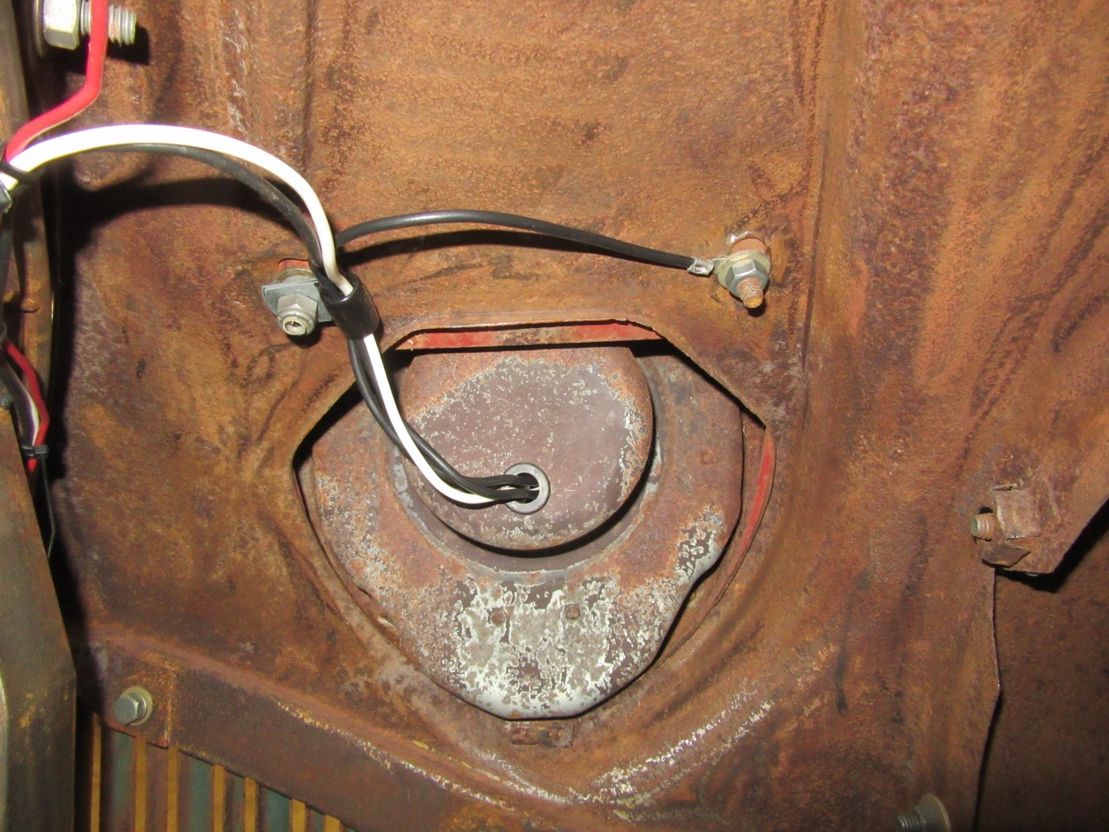

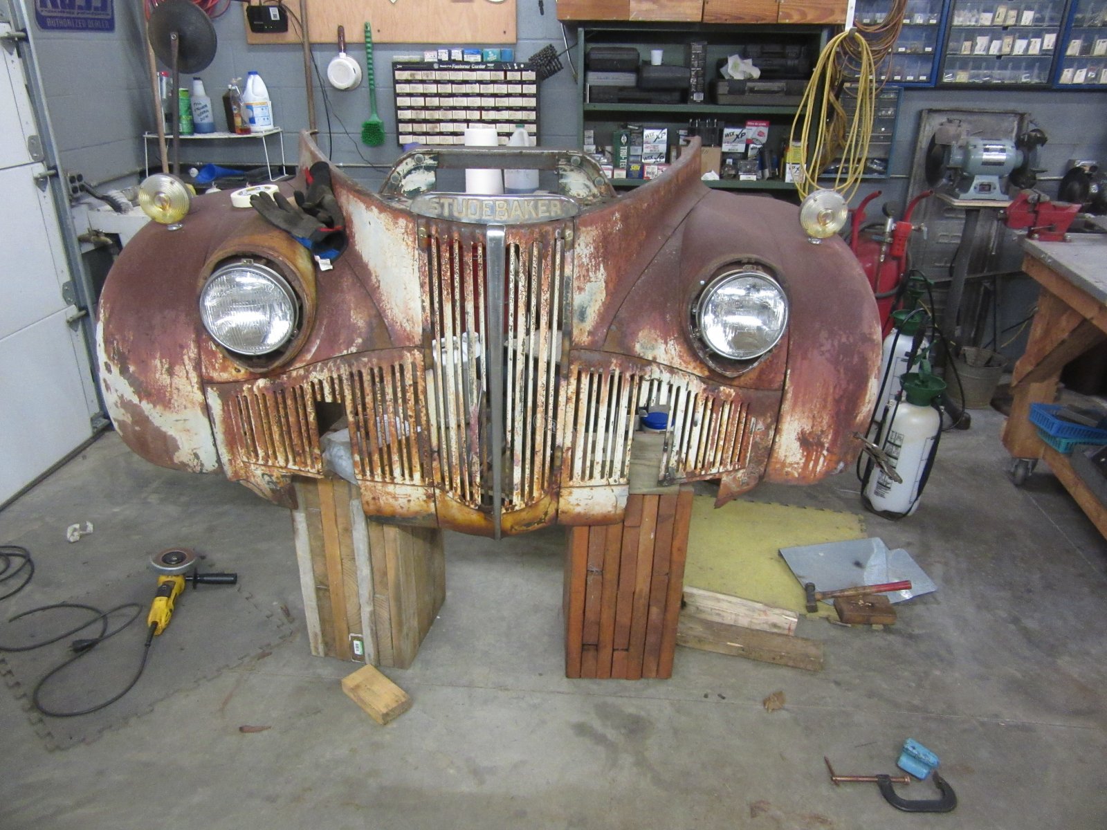

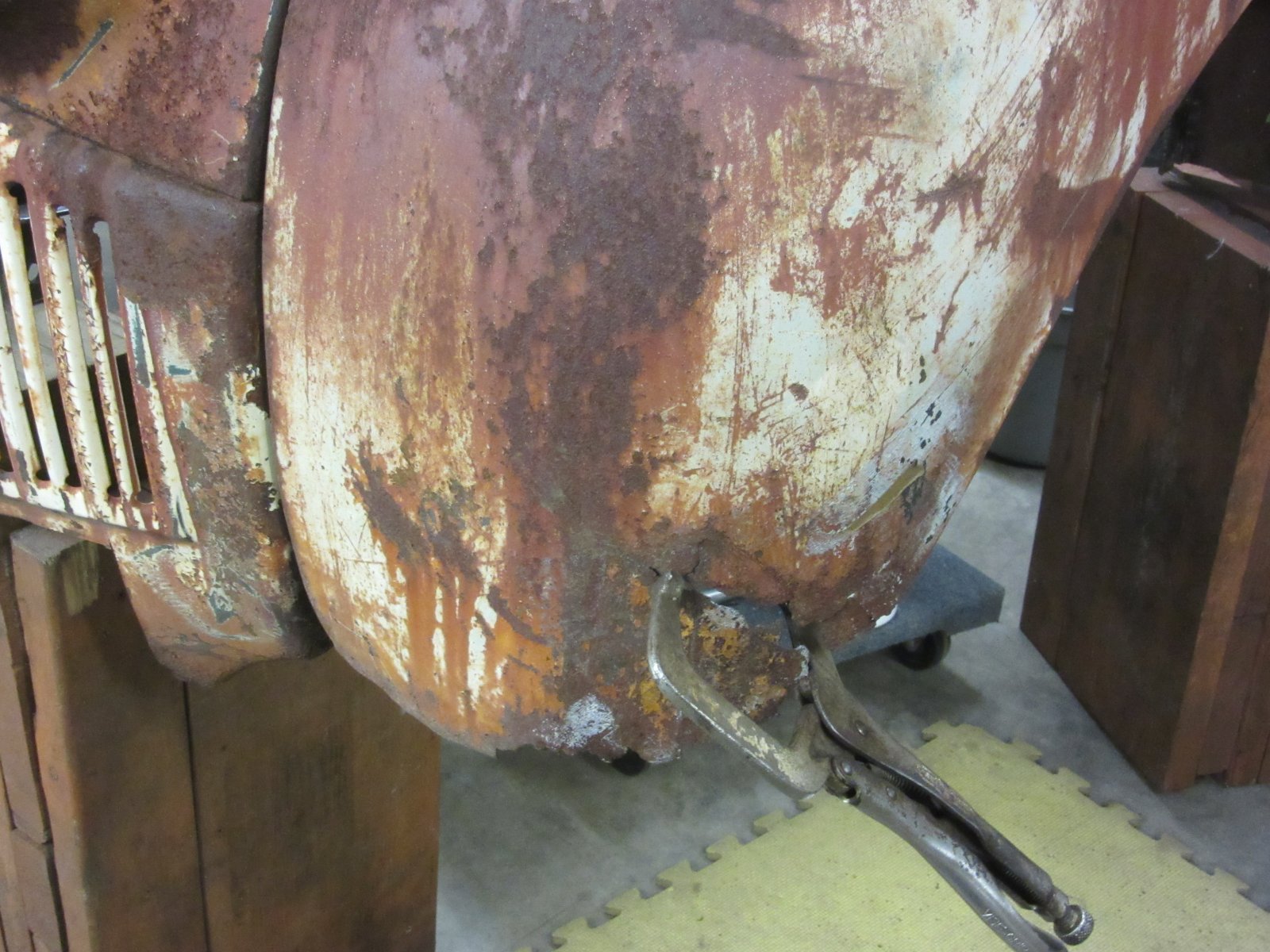

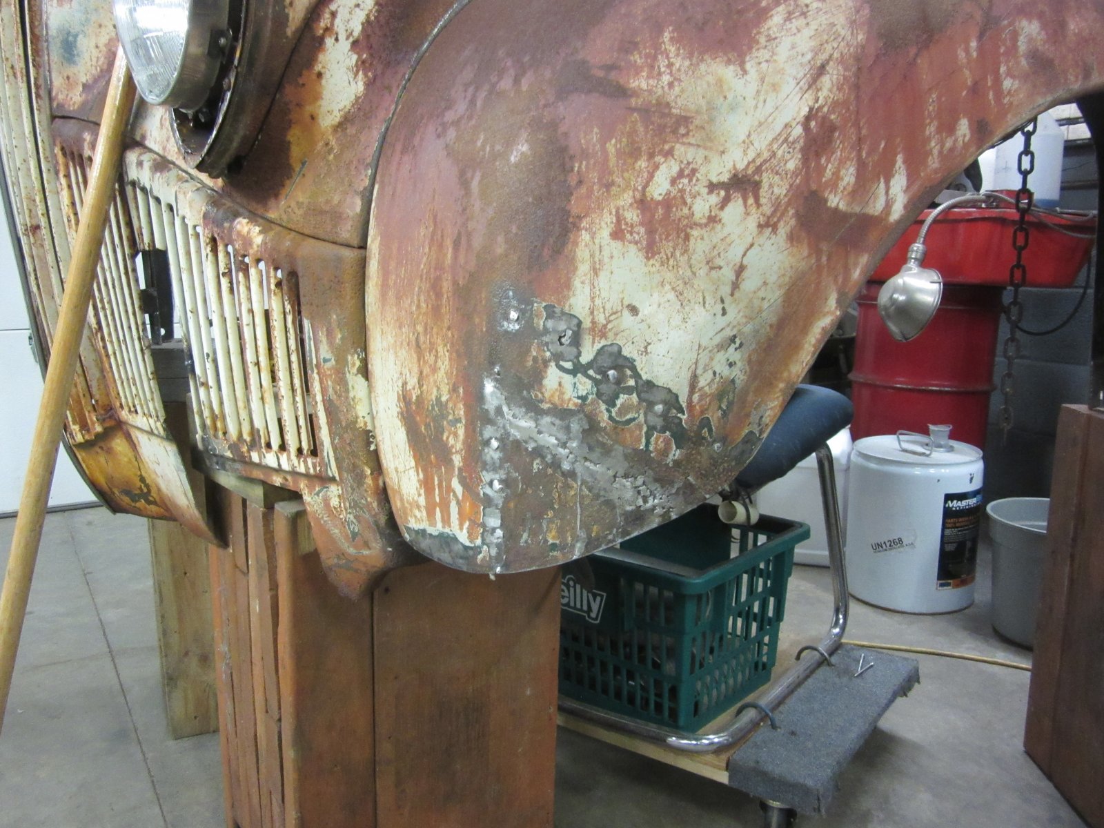

    I got the front end wired out to the headlights, I just have to finish the plug in at the cowl after I set the front end back on . While the front end is easier to work on I am finishing up some welding and going to stich up a tear in the left fender. IMG_0749.JPG IMG_0750.JPG IMG_0751.JPG IMG_0748.JPG IMG_0752.JPG

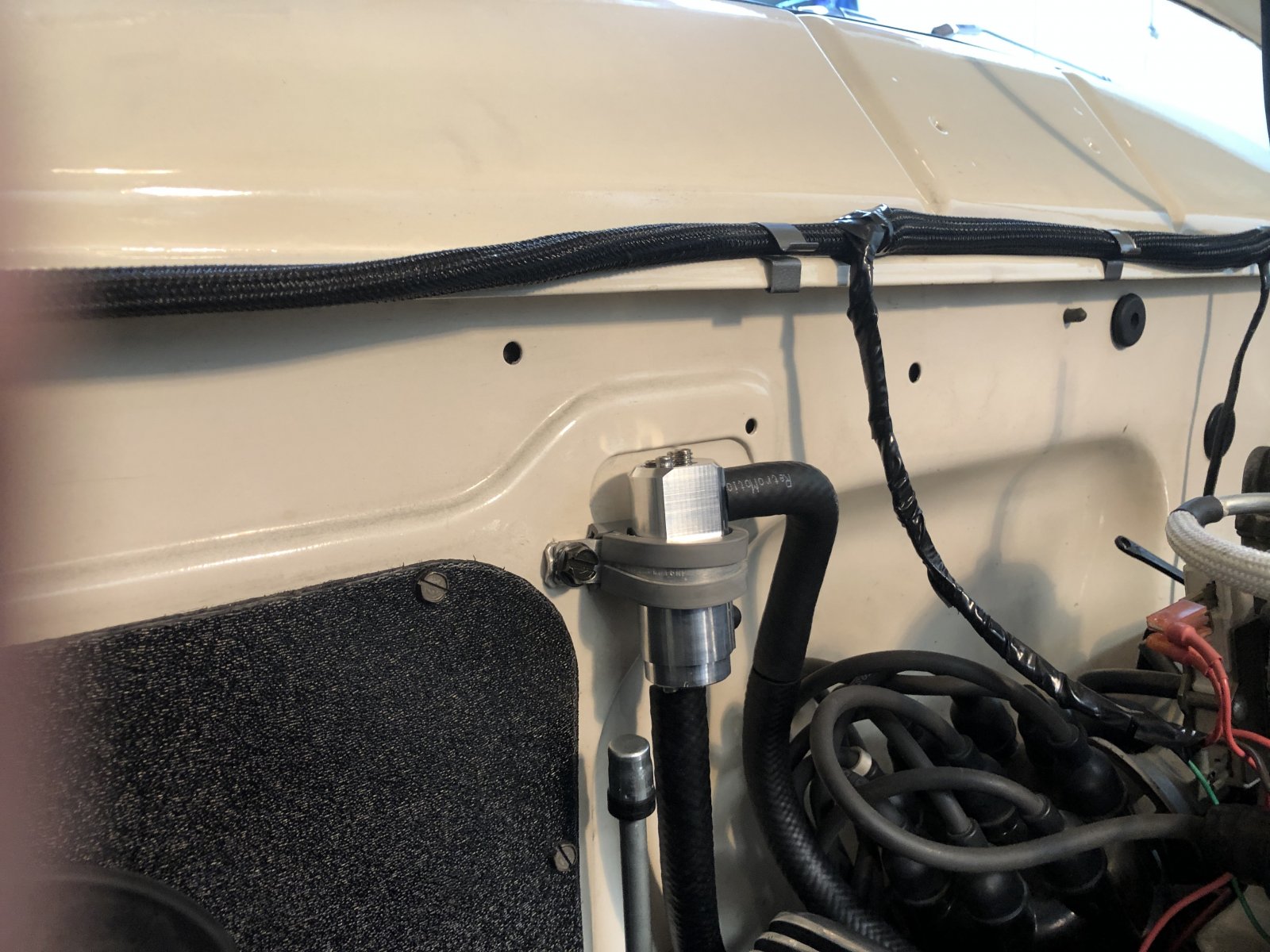

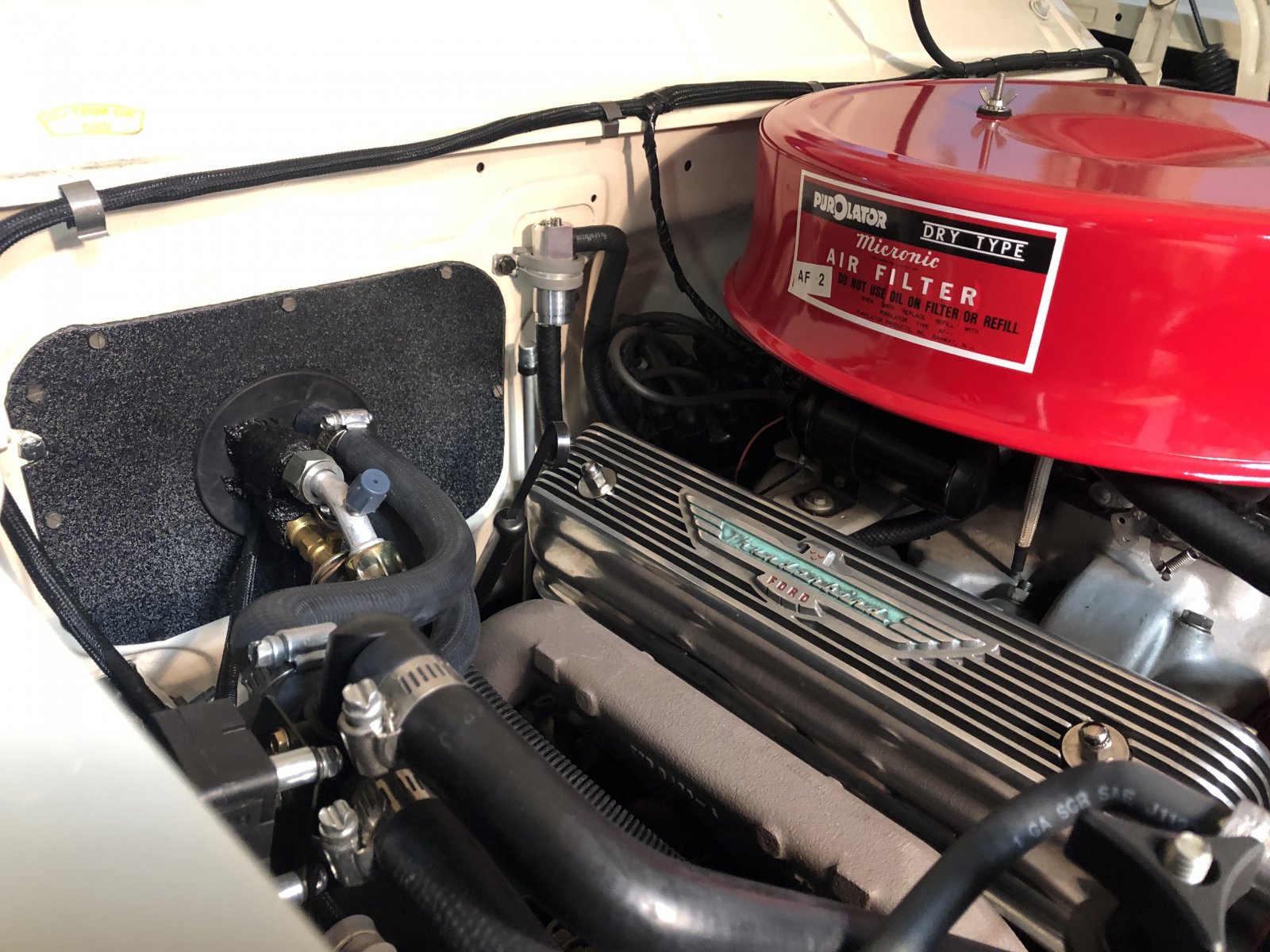

    Removed the stock style PCV valve and line and installed a ME Wagner dual flow tuneable PVC valve. F992C4B8-3983-44C2-A04B-32254E3C92AE.jpeg 095B8962-890C-4890-A61F-433747CE1055.jpeg

    I got my fender patched up , so no more shipping tape covering the sharp edge LOL IMG_0753.JPG IMG_0752.JPG
