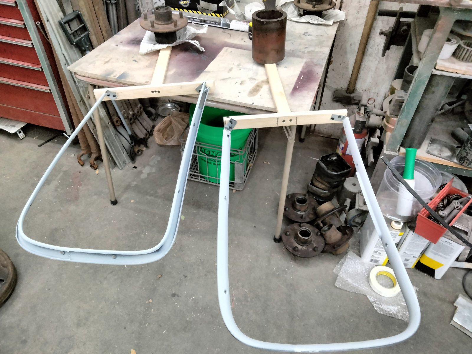

    Made some ghetto gizmos to hold the windshield garnish for our '47. I kept missing edges when hanging them vertical; now I can paint them flat, one side then flip them to do the other.

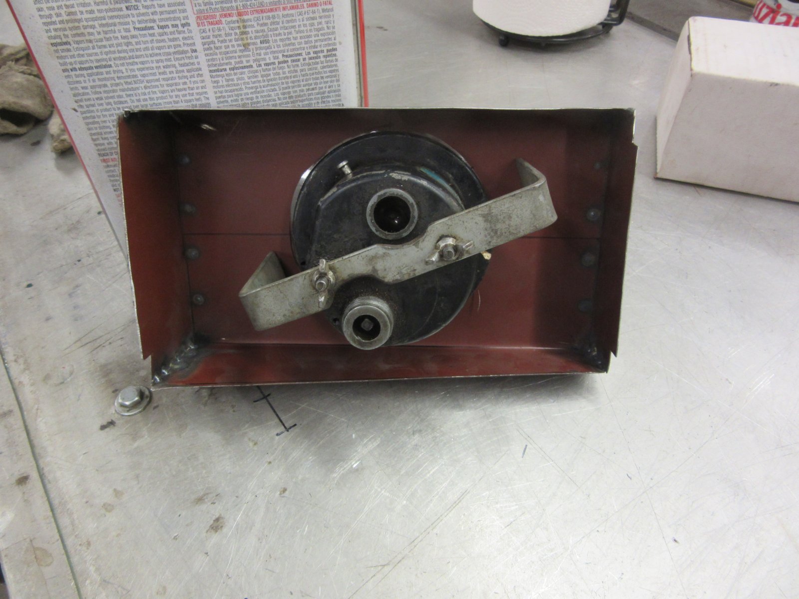

    Spent some time working on a mount for this killer Stahl cable drive tach I bought at a swapmeet Saturday. IMG_0798.JPG IMG_0803.JPG IMG_0802.JPG ay.

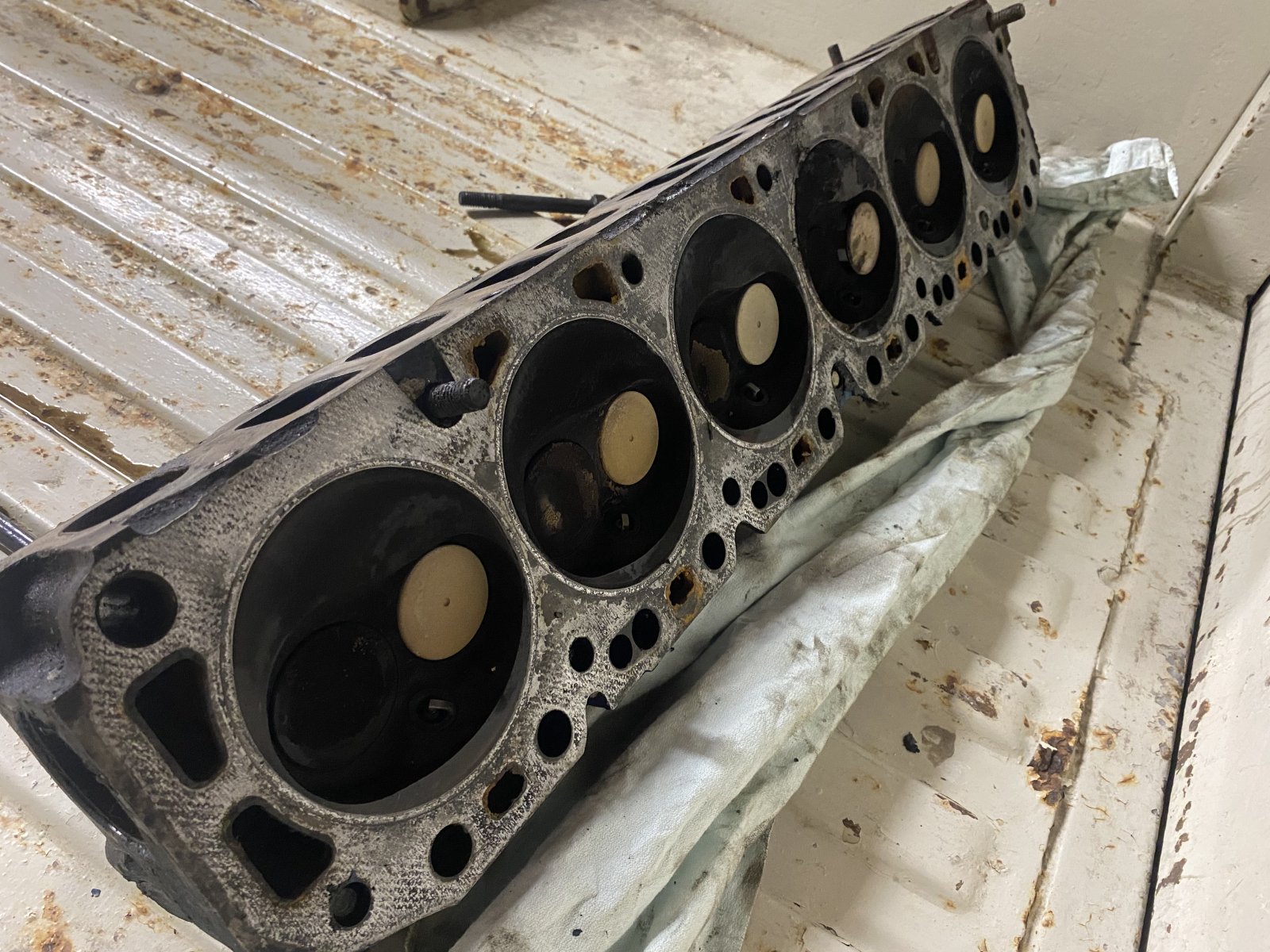

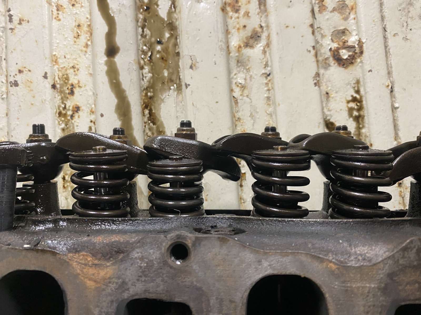

    Popped the head off my F100 to see why it’s running average, stuck valve and several not seating properly. Least it’s had some engine work done with 30 over pistons etc
    D4FDD93F-B3F3-48D4-A910-6A0C1F9C68A9.jpeg 85CE0649-3B06-44AE-A2AB-F95155C3D83D.jpeg 523F7E2F-FBF2-4F13-824A-2748276DE798.jpeg

    Broken valve spring ?

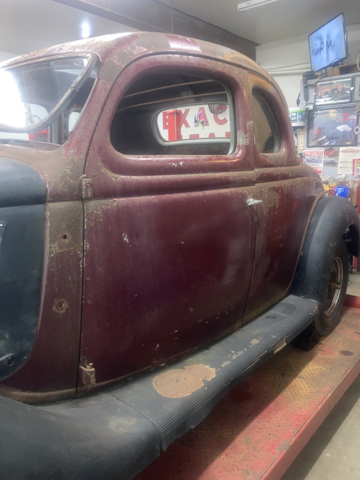

    Today I swapped stall positions in garage with my daughter's OT bracket car and put the 40 on the lift so I could have good look and add to my winter "to do" list. 20221214_200611.jpg

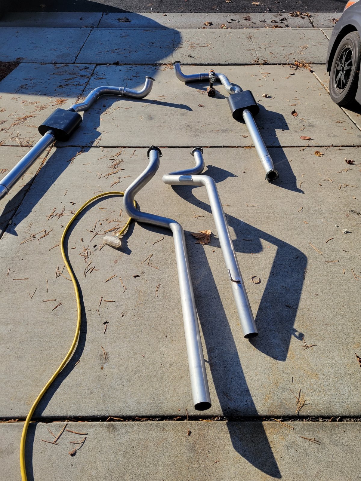

  14.  Finished welding up the exhaust, mandrel bent summit 3" aluminized pipes, summit brand 2 chamber mufflers and flowmaster reducers,flowmaster 2 1/2" tailpipes. Hopefully it sounds great.

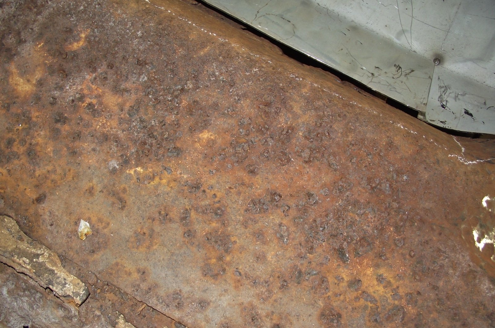

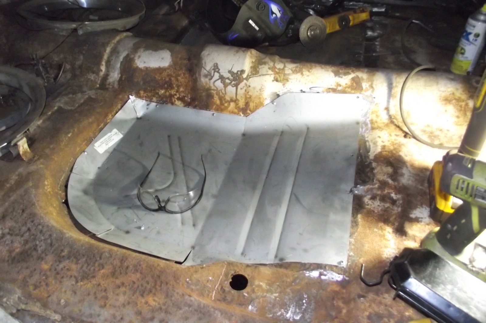

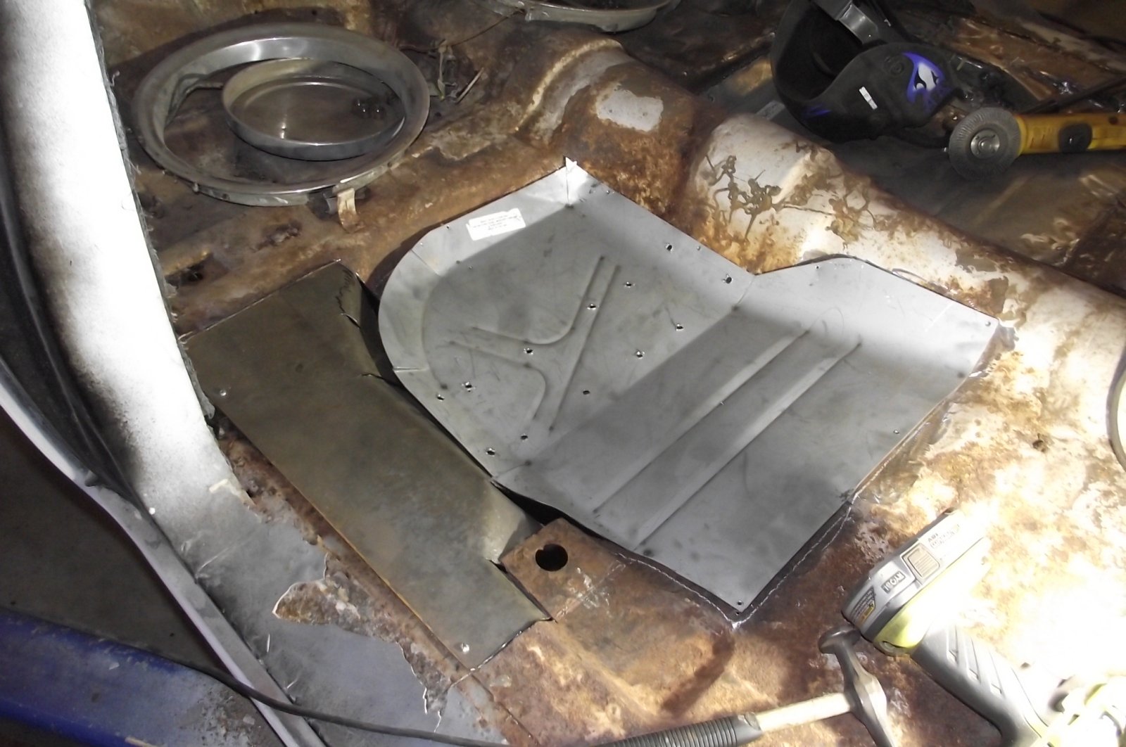

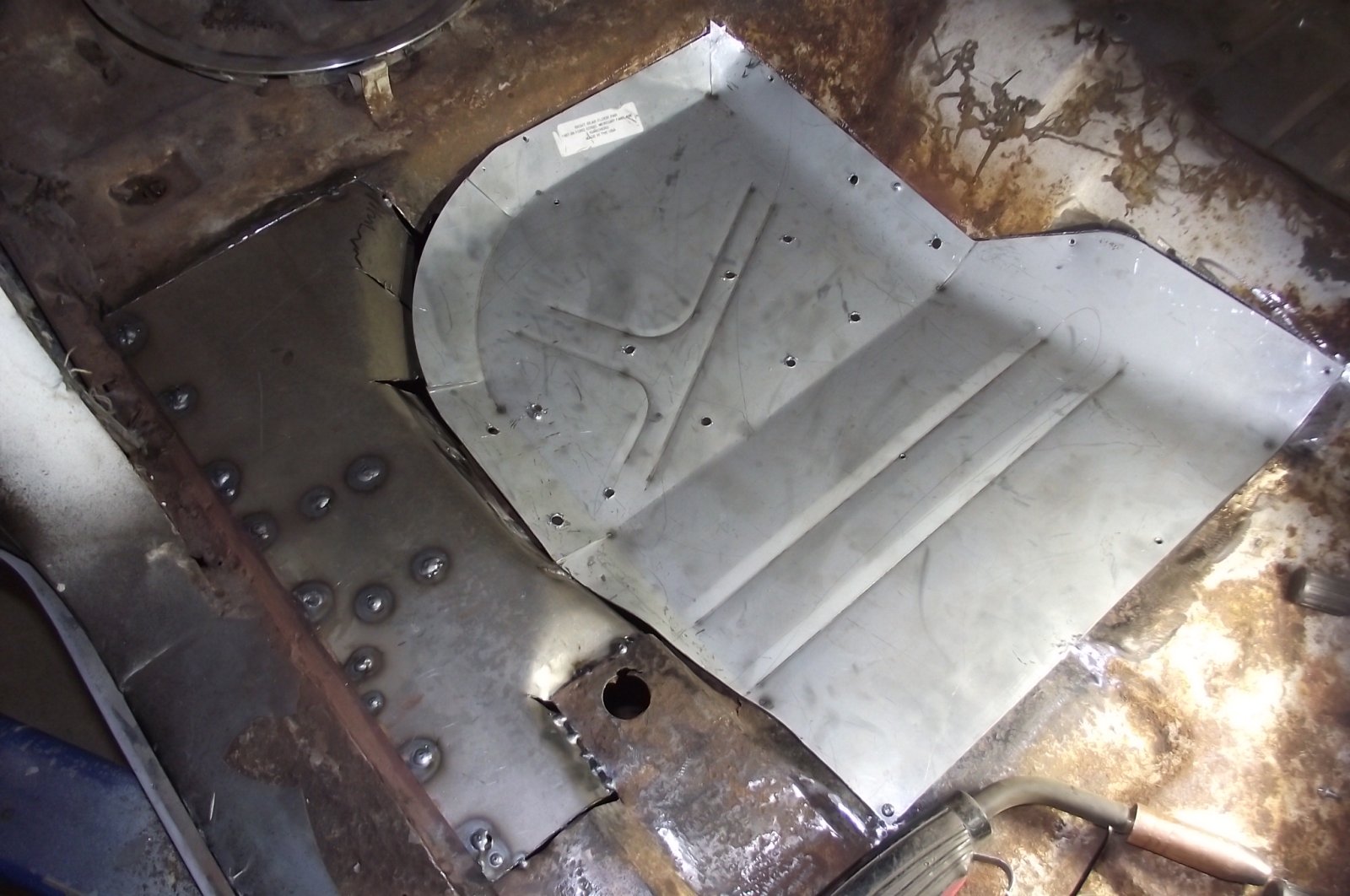

    Worked on the floors.

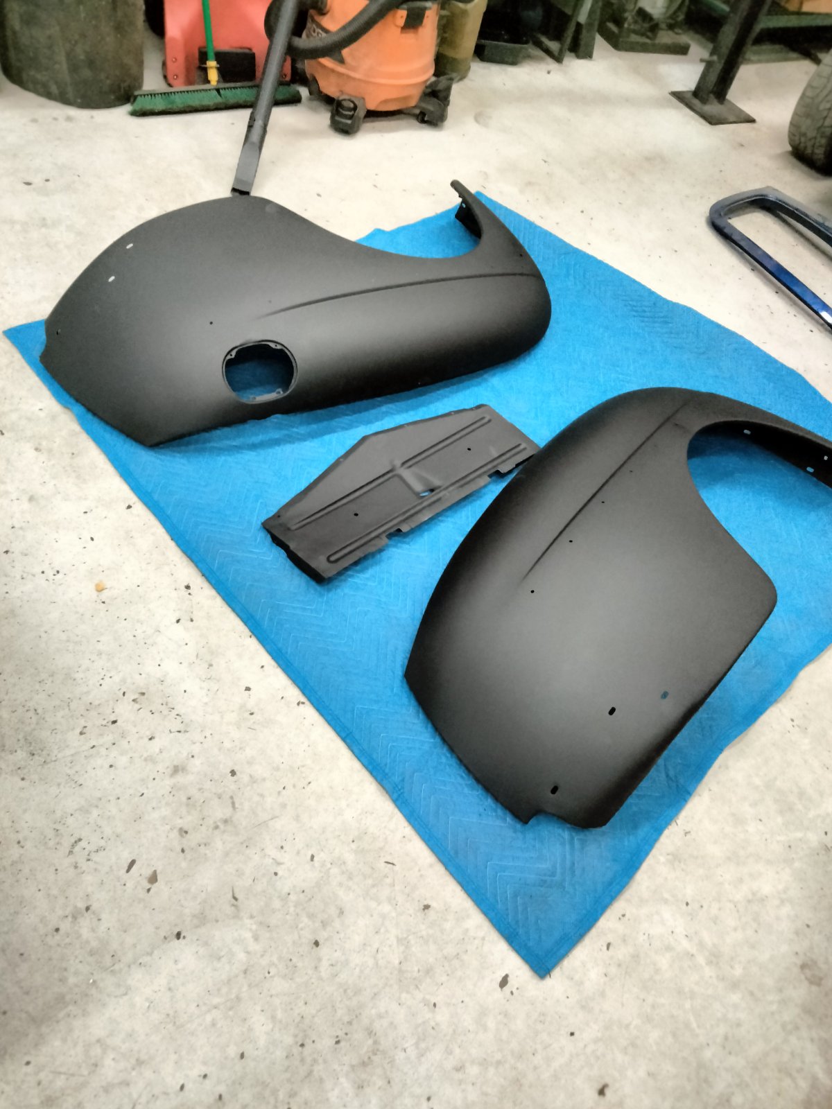

    My buddy recovered my fenders and front pan from the painter Saturday and went on to spring John's Rambler from another paint jailhouse. I don't envy him taking off the year+ old masking tape.

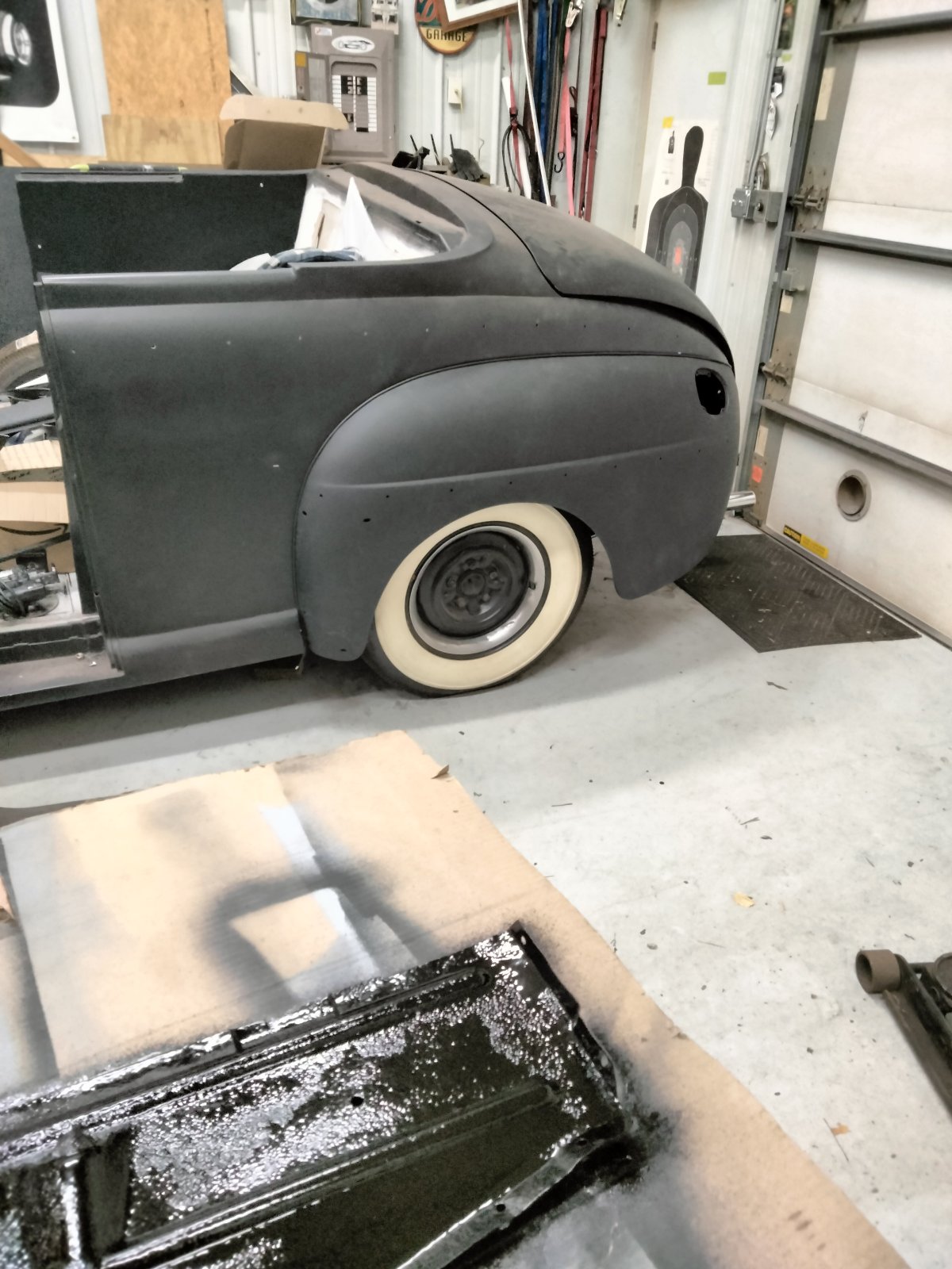

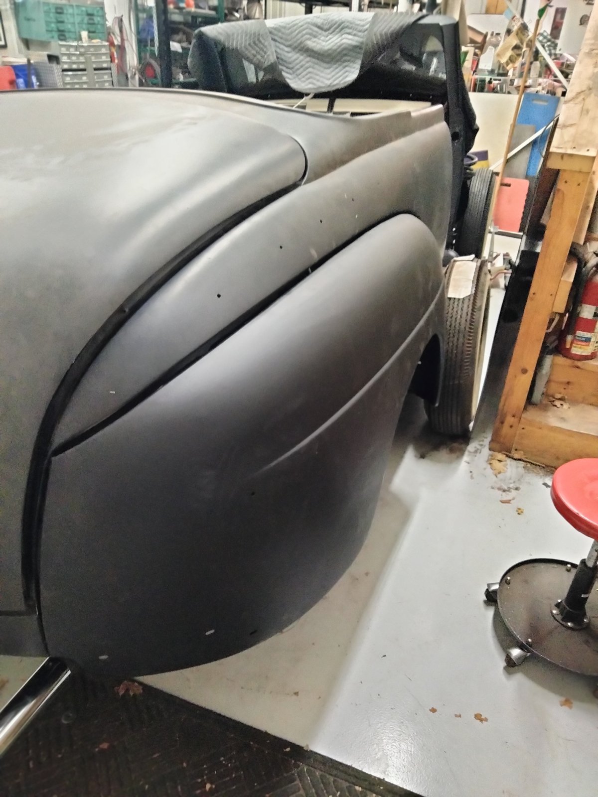

    Managed to get one fender on and the other hung on by a couple bolts. I have to drill several holes as they were lost when I patched the rust holes in the wheel wells.

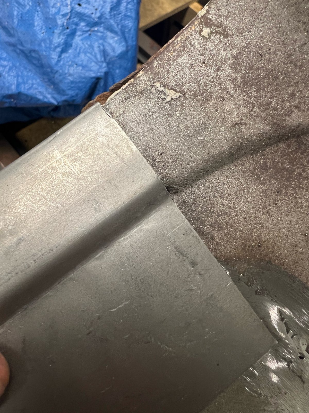

    Hammer forming trunk bead on a 30 coupe
    66178E20-4916-4B5C-9B64-862EEB4F0D9D.jpeg 344C369A-568F-4ED8-827F-ADDD63678DB2.jpeg 587A1B72-461D-47A0-B991-E009B4E86B59.jpeg
