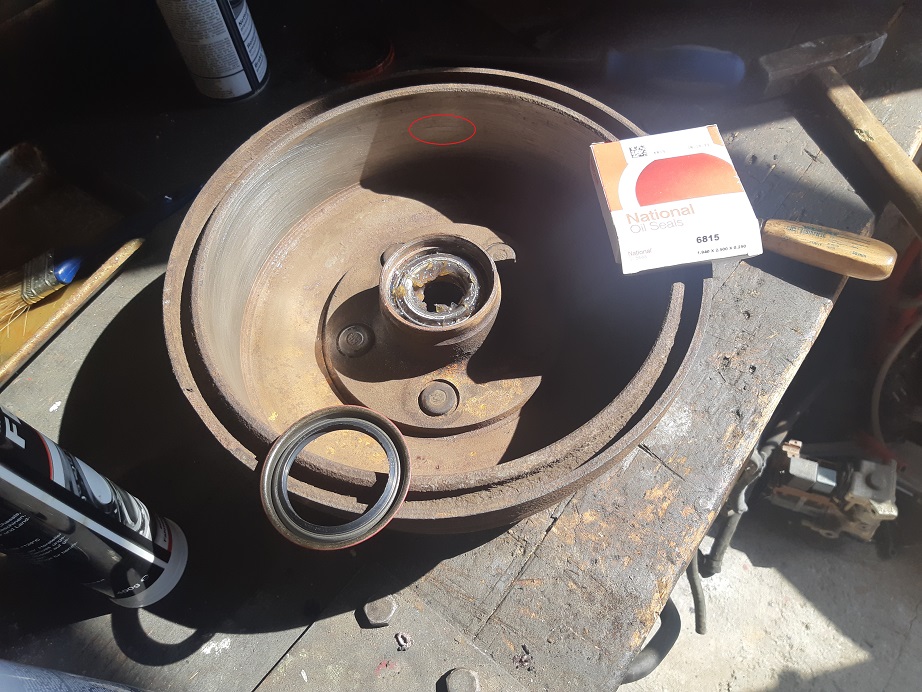

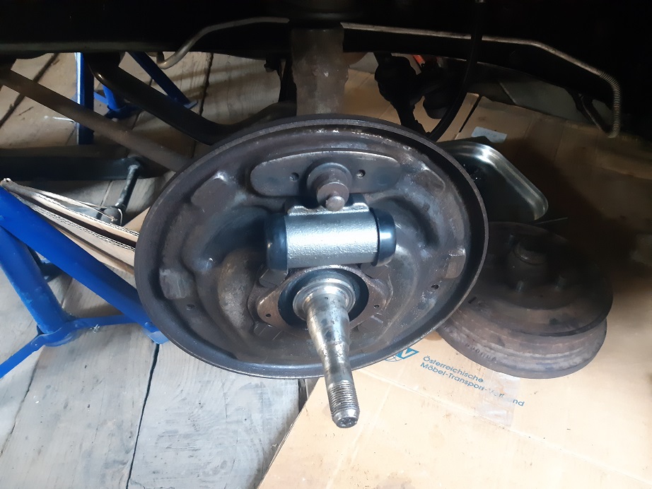

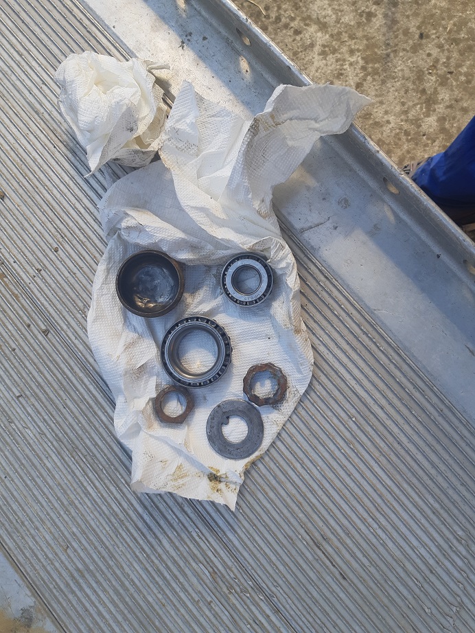

    Yesterday was a holiday here in Austria so I decided to do as much as I can on the car (the speed shop did not have the brake shoes in stock - those are on order and should be delivered to my address this week (one of the guys working there is a neigbor)), which meant cleaning all the wheel bearings/re-packing with grease/installing new oil seals + ***embling the LH wheel cylinder. Good thing I did because the previous owner obviously did not know about the mysteries of packing wheel bearings with grease. I don't think any damage was caused by the car running like this although one of the bearings (proudly stating "made in China") is, well, a bit mweh. But I'll live with it for the time being, this is already costing me more than I want. I also found strange protrusions on the LHD drum which I carefully filled down - again I don't think it would cause any issues once the shoes are bedded in but if it does then I may have to turn the drums. Oh by the way, we Europeans have no issues with finding 10mm sockets or spanners, the problem is with the 3/8" - see pic of mangled brake line union (by previous owner). Luckily I managed to loosen/re-tighten with a special spanner I have for such situations...
    Hope to have the brakes fully ***embled on Saturday and then we'll see...

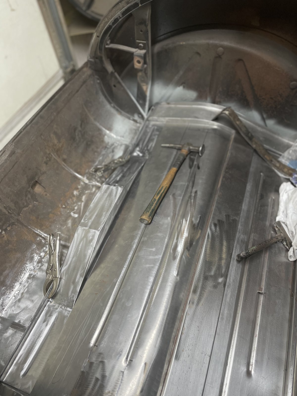

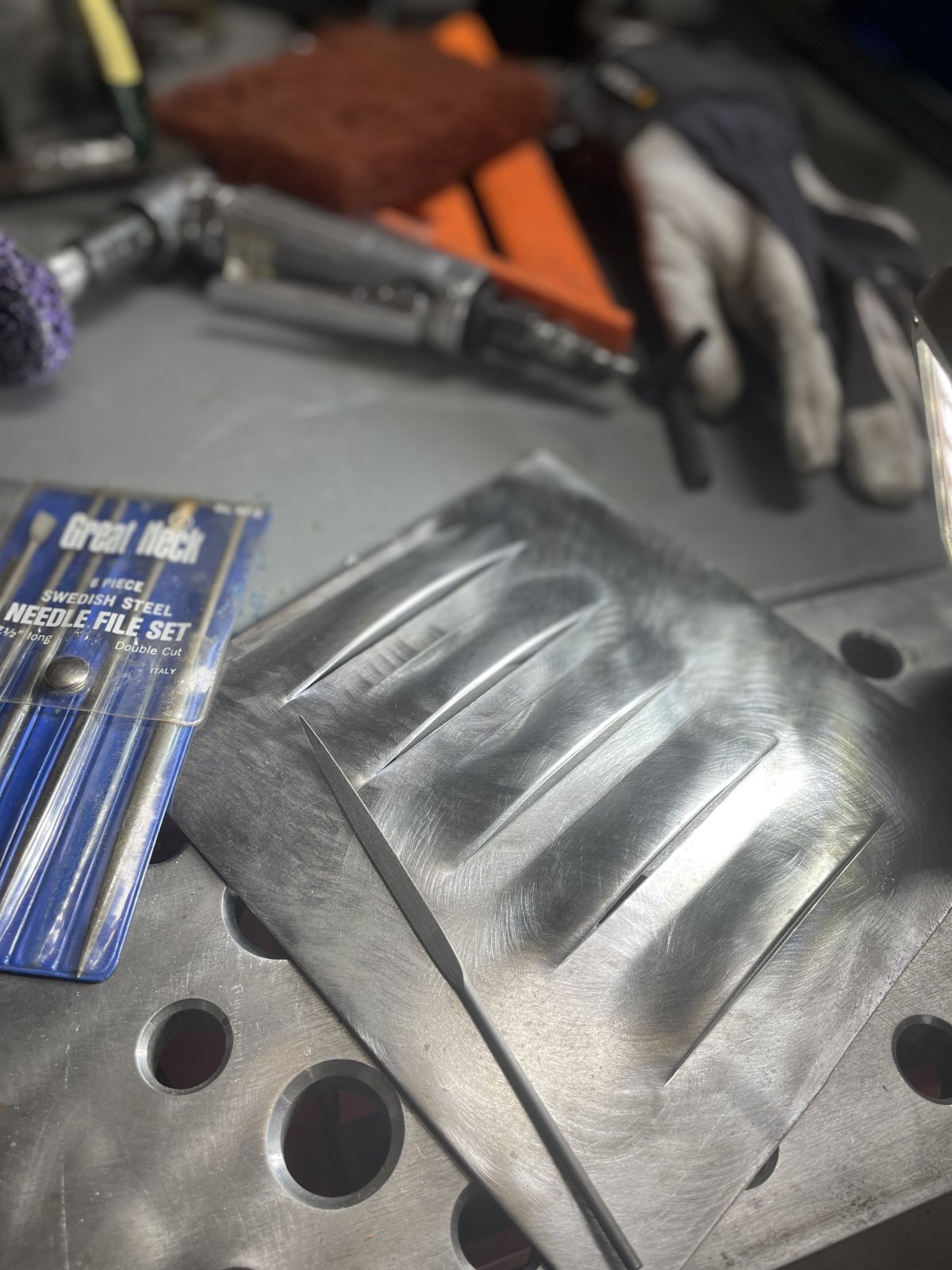

    IMG_8744.jpeg I finally just about finished the rear crossmember cover. I also got my louver press set up recently, and punched my first louvers! IMG_8707.jpeg

    Let’s see that louver press!
