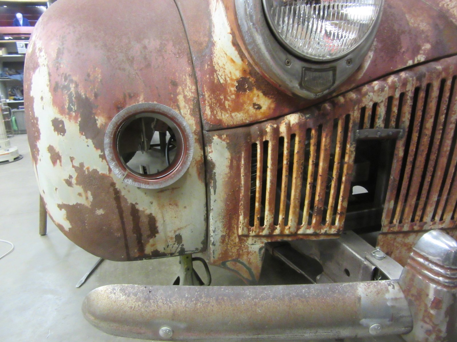

    They have to go in the outer fender
    Thanks, I have really enjoyed building this truck. Other than the store bought solid motor mounts everything is home fabricated. So the old air cleaner was just of of place. And this is what I came up with. Hopefully it will pick the truck up and not slow it down !

  25. Bandit Billy
    Joined: Sep 16, 2014
    Posts: 16,045
    Bandit Billy
    I like it! One suggestion, add a bug screen to your design if you haven't already planned for one. My 442 has fresh air intakes under the bumper and they pick up leaves, rocks, insects and even a plastic bag once. Your engine will definitely enjoy the added cool air.

    Good point, Thanks. I had not thought that far thru it. One thing I did think of this morning is the hoses in the wheel wells will be exposed to road debri. But this thing sees limited use as I am a worn out old guy and my travels are not many these days. I stopped by a buddies shop this afternoon IMG_1203.JPG and this piece of stainless was laying there so I probably have the inlet screen taken care of.
    Chucky, mad mikey, loudbang and 4 others like this.

    I am still chugging along on this project. The whole truck is very easy to service so it took about two minutes to pull the fender off so I could get it up on the table. Then my original idea did not go as planned , so after a couple more attempts I got back on track. I plug welded the the snorkel into the fender that way it keeps the same look as the rest of the truck as far as the welds go. The inlet is about 3/16 of an inch proud of the fender so I have to grind that down and I might weld it in solid and the plan right now is to put a couple pieces in the replicate the grill bars. IMG_1208.JPG IMG_1213.JPG IMG_1214.JPG
