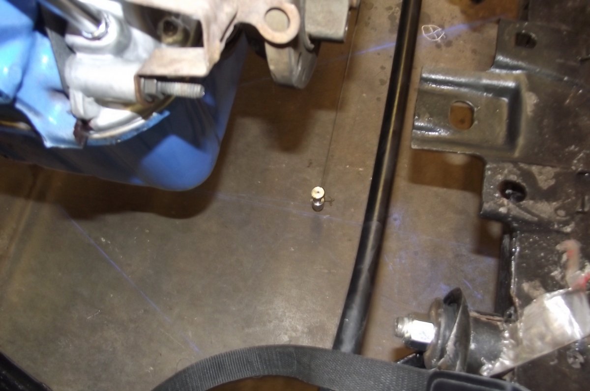

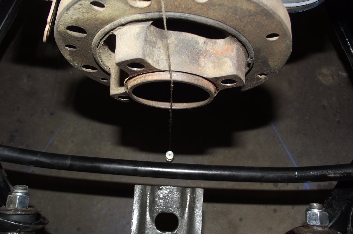

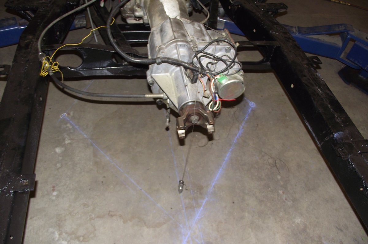

    Finished aligning the mounts on the 56, everything is aligned straight with the pinion shaft.

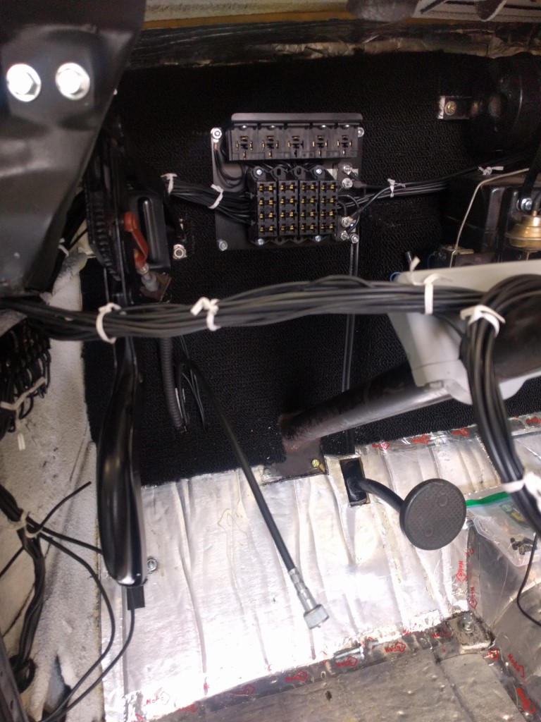

    Mounted the fuse panel in the '47 and started routing the wires. I've always used twist ties as a means to keep the wires together as I route wires; but I'm wondering if there is something better you guys may be using.

    Cable lacing. Cut little pieces to tie up the harness as you’re running it, then lace it once it’s in place.
