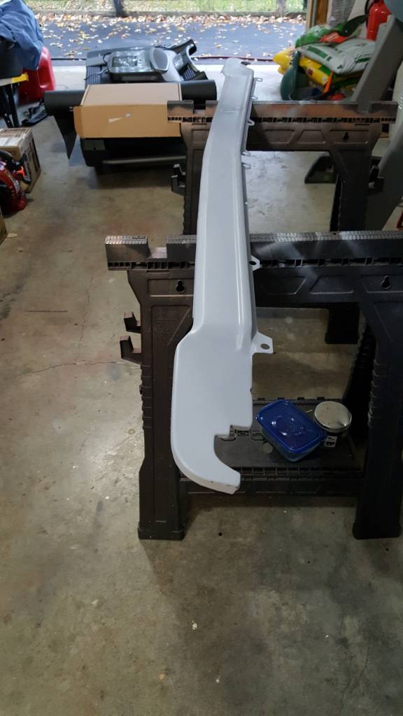

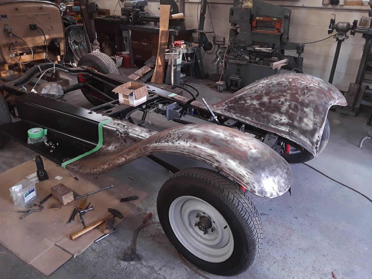

    I got the front fenders, running boards and splash aprons mounted on my '31 frame to finish taking some more ripples out. It's getting a satin/beater paint job so it will likely still have some warts when it gets paint. At least it sorta resembles what an A kinda looks like.o_O

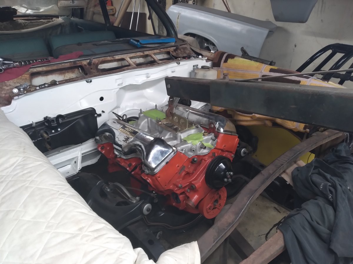

    Got the 409 setting in the engine bay. :)

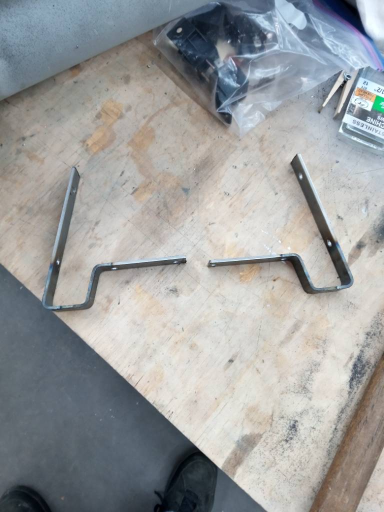

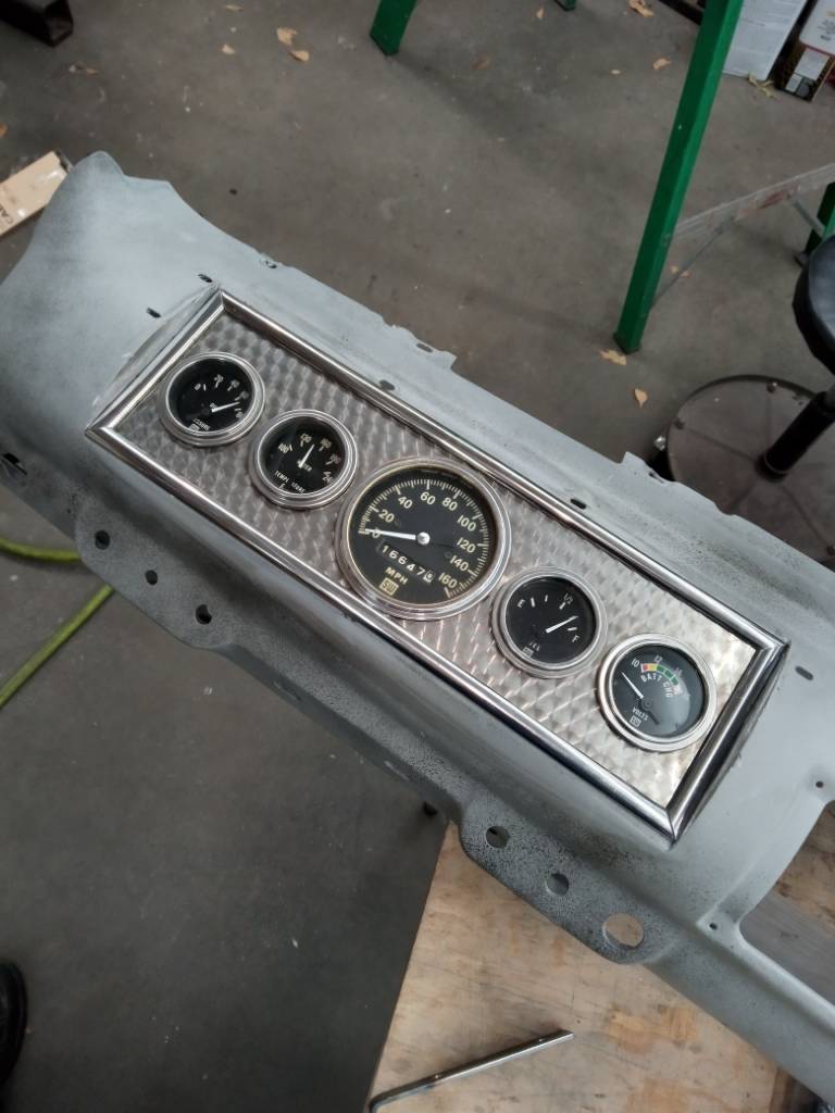

    Decided I better fit the gauge panel bezel to my dash before I get to far along. The bezel is made out of some extra '36 hood spears. My buddy decided it was too thin for him to tig weld; so I made some corner inserts and JB welded it together. Buffed up the SS so it was pretty. Modified the heads on some machine screws to hook inside and drilled some holes in the '41 dash to secure it. Made some brackets to hang the trans cooler under the front radiator baffle, little blasting, sanding, and paint and I can get that installed. IMG_20201012_183115_4.jpeg IMG_20201012_182931_3.jpeg

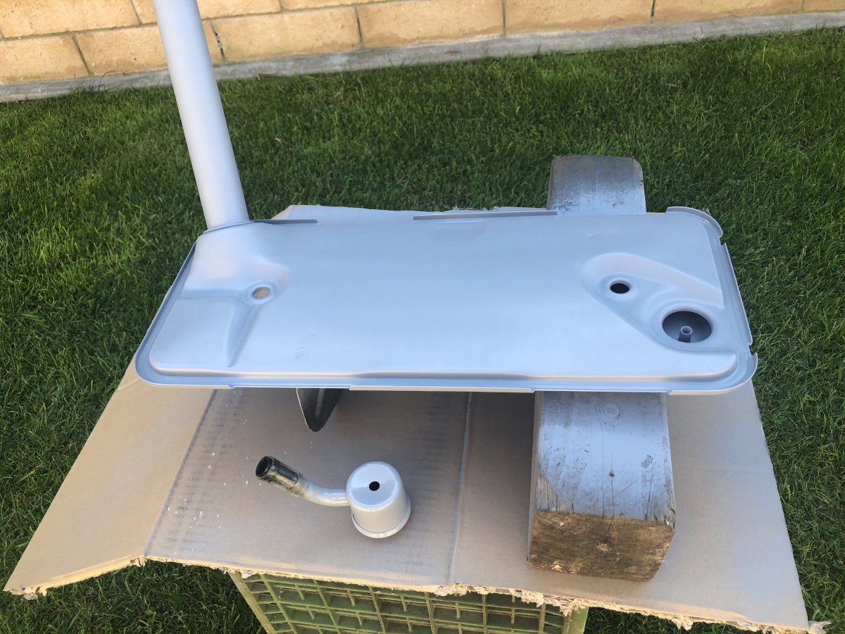

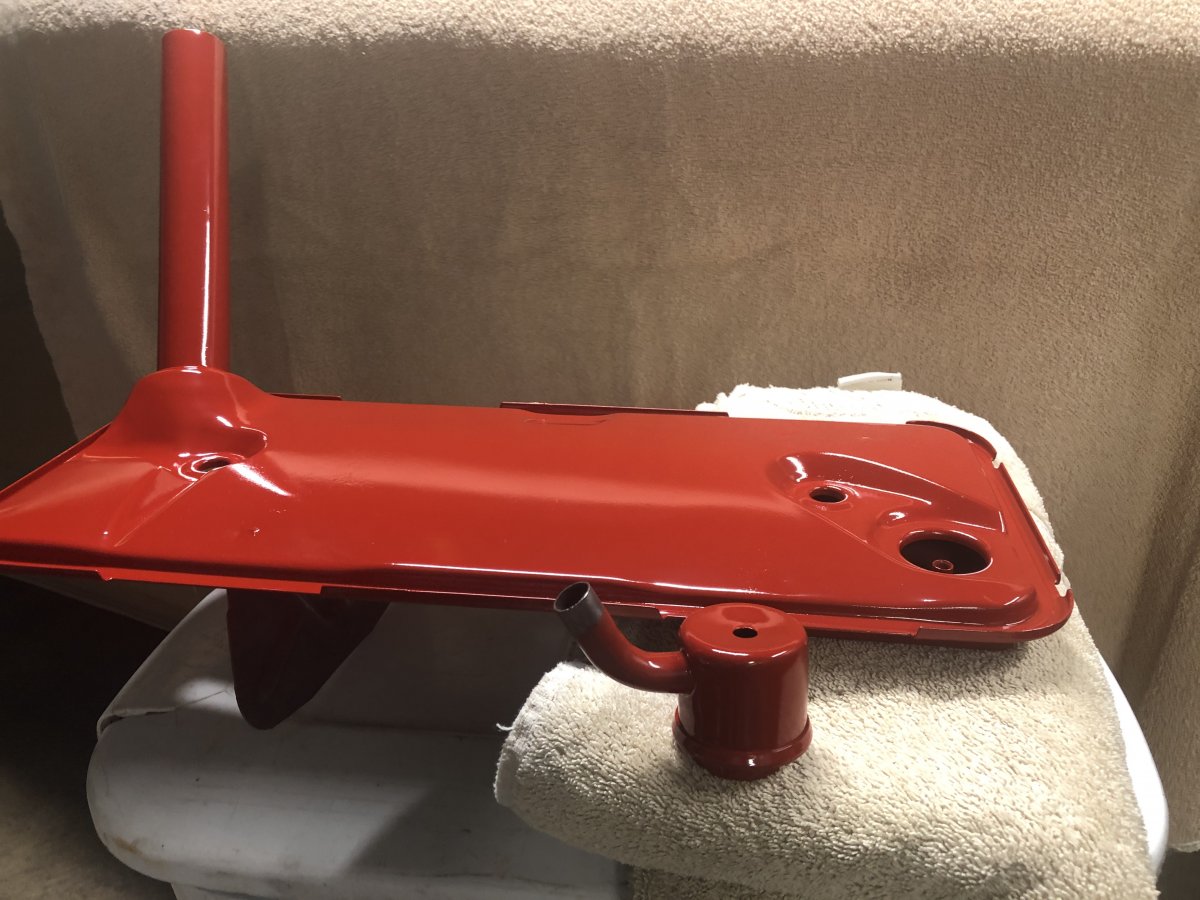

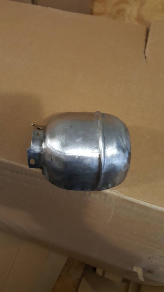

    Cleaned the 62-64 valley cover for my Y to add a PCV system. Paint remover for the metal and wire brushes for the trap and tube. Engine primer and a Ford red finish. A7D8FB43-5A74-4F16-BD61-8A68BCDE25E0.jpeg 7062320B-49F7-4FA9-9176-6BD31A348719.jpeg

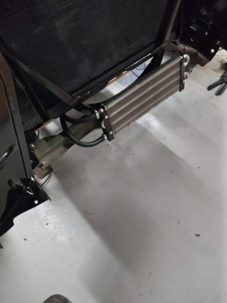

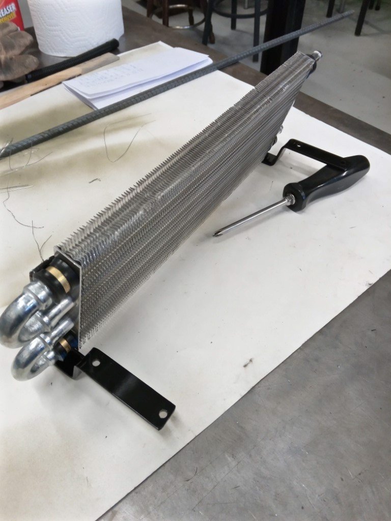

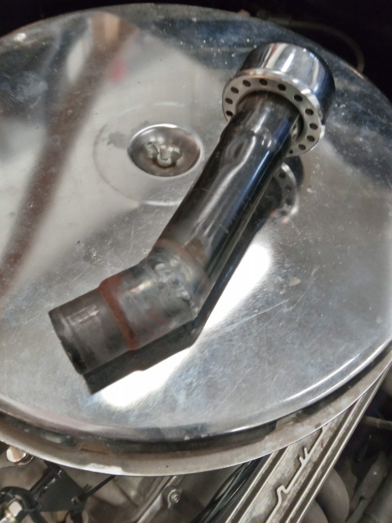

    Mounted the trans cooler. Welded a couple pin holes shut in the hood of my buddy's Rambler. Finished welding an offset in my oil fill tube.
    IMG_20201015_100428_3 (Medium).jpg IMG_20201015_111504 (Medium).jpg View attachment 4846924 IMG_20201015_135849_3 (Medium).jpg [ATTACH

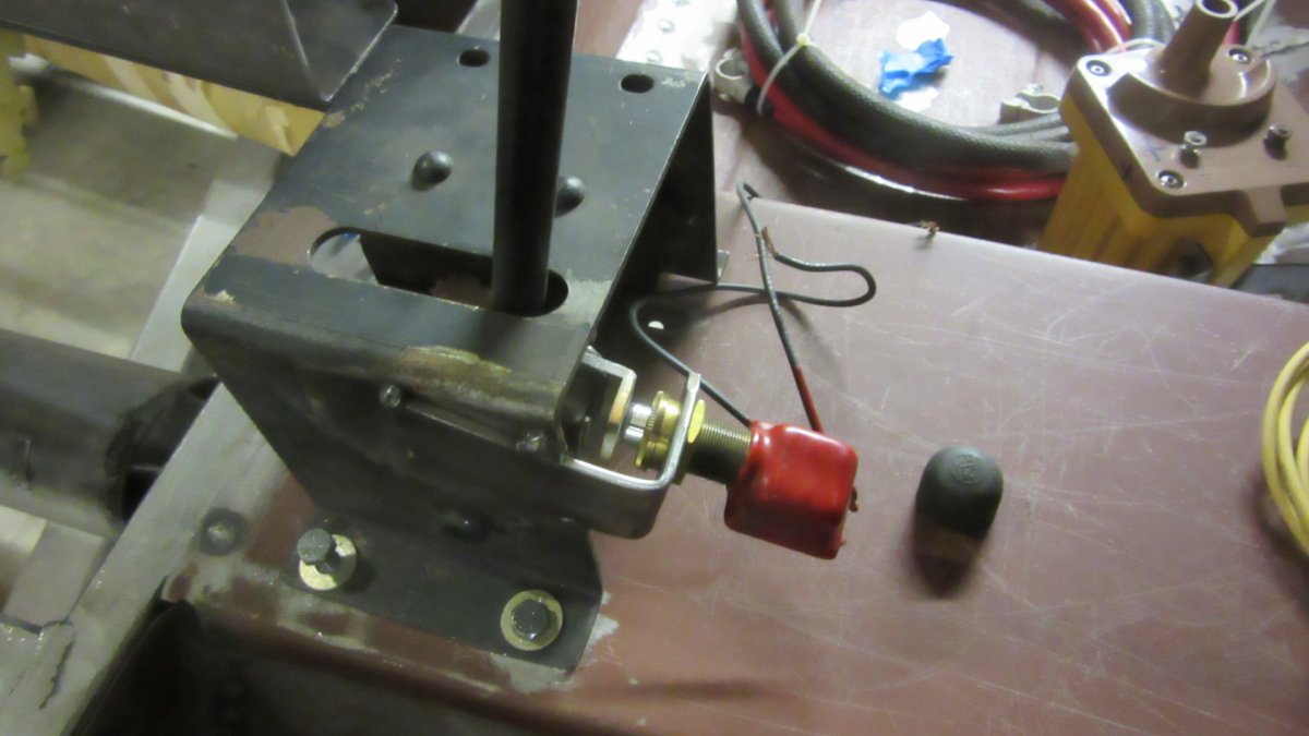

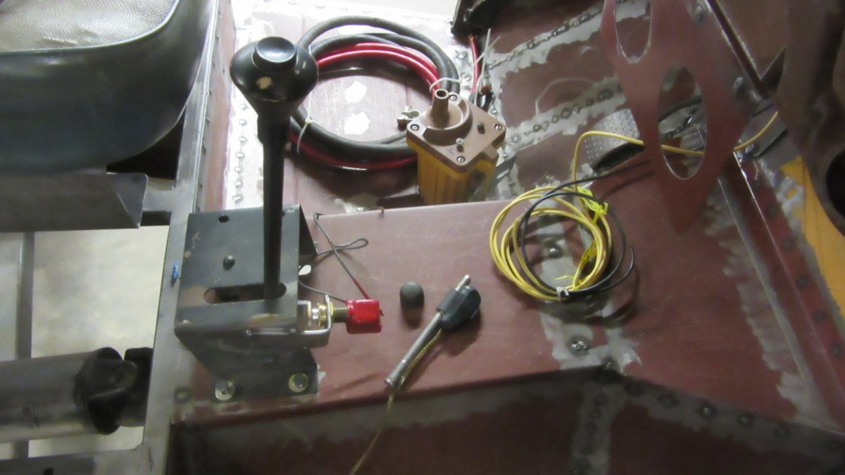

    Fabbed up a neutral safety switch on my shifter, I still have to mount the trans brake switch . I am undecided where I will put it either on the shifter or the left side of the steering wheel. Actually a park safety switch. studebaker build 003.JPG studebaker build 004.JPG

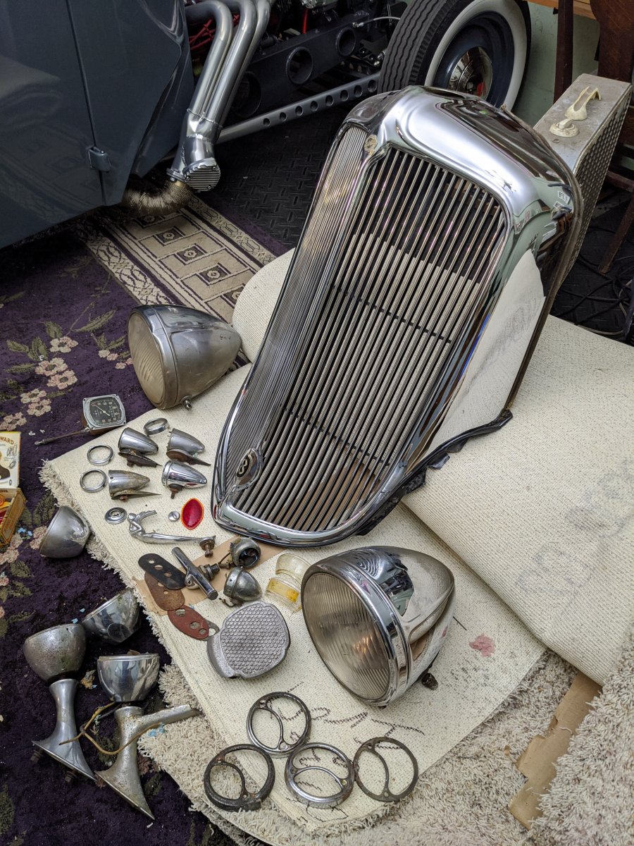

    Picked up some lights to go with the '33 Chrysler Grill IMG_20201013_172822.jpg

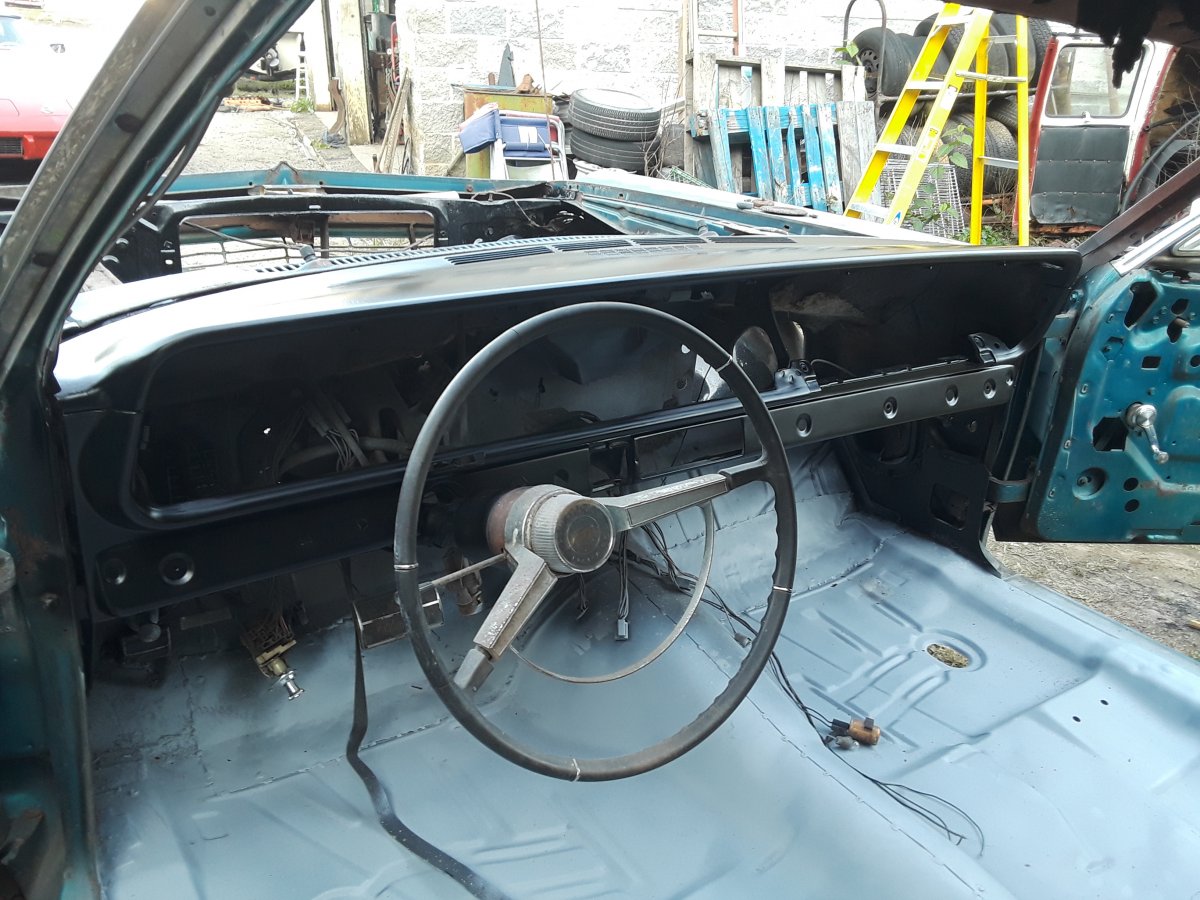

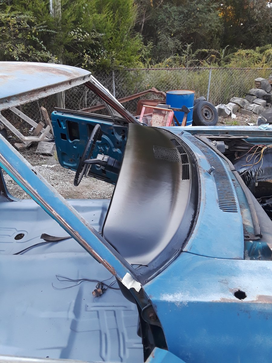

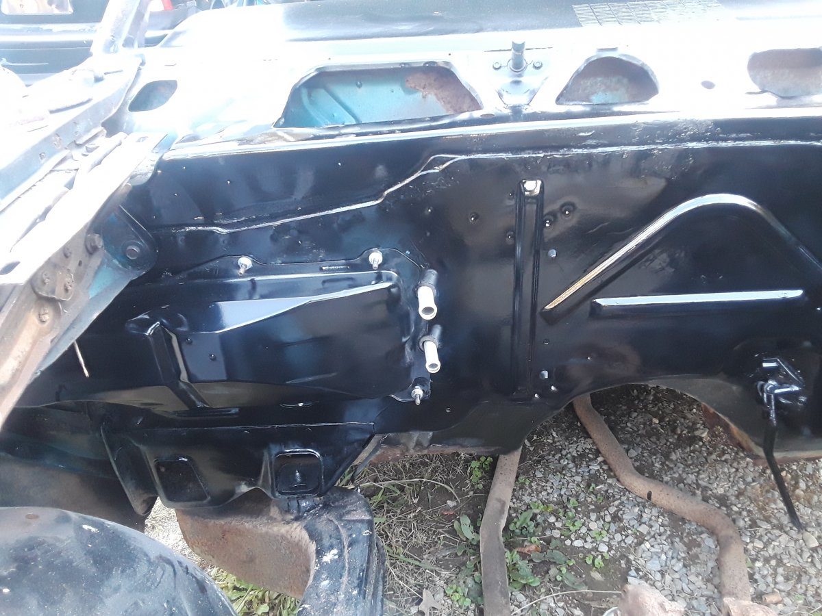

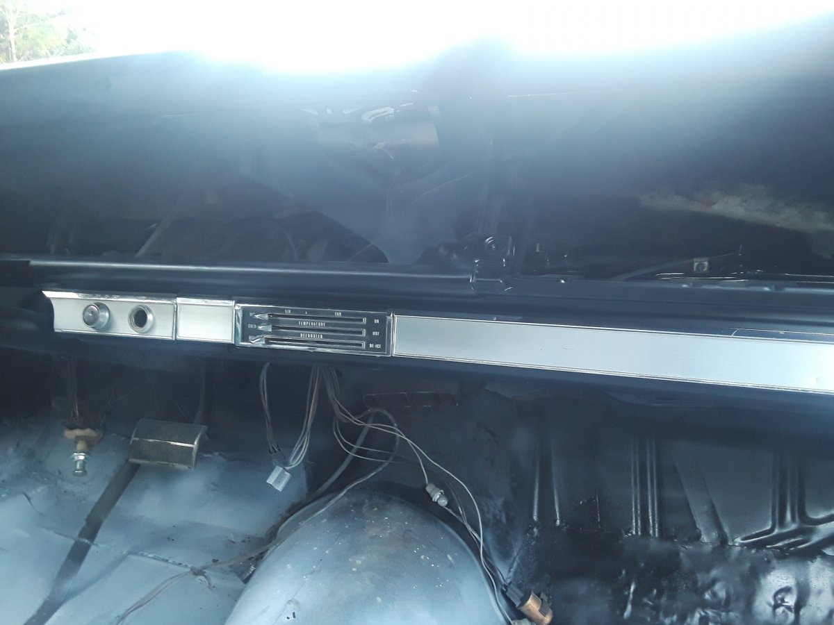

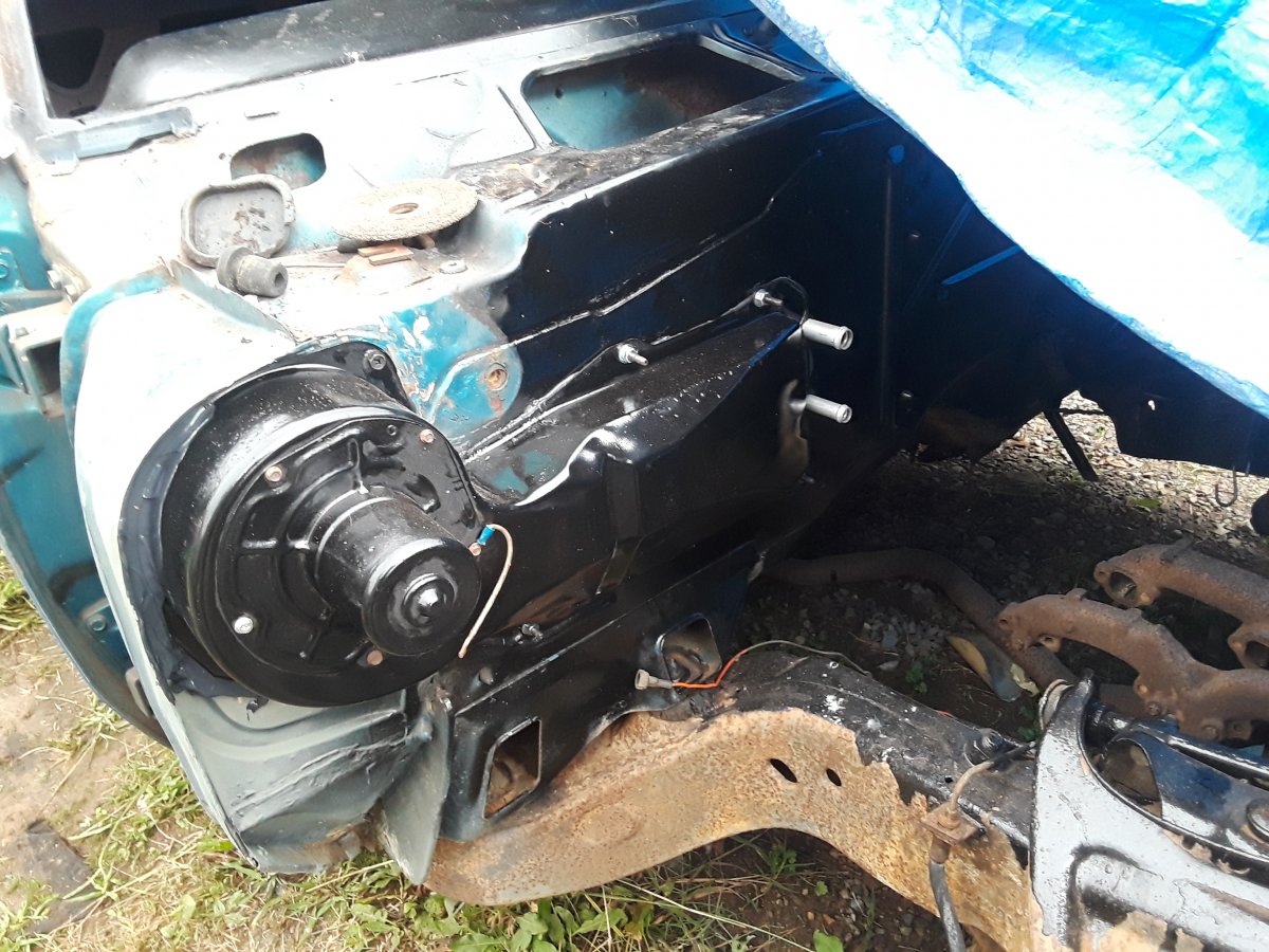

    Started putting the dash back together. Got the heater done. 20201017_163309.jpg 20201017_165749.jpg

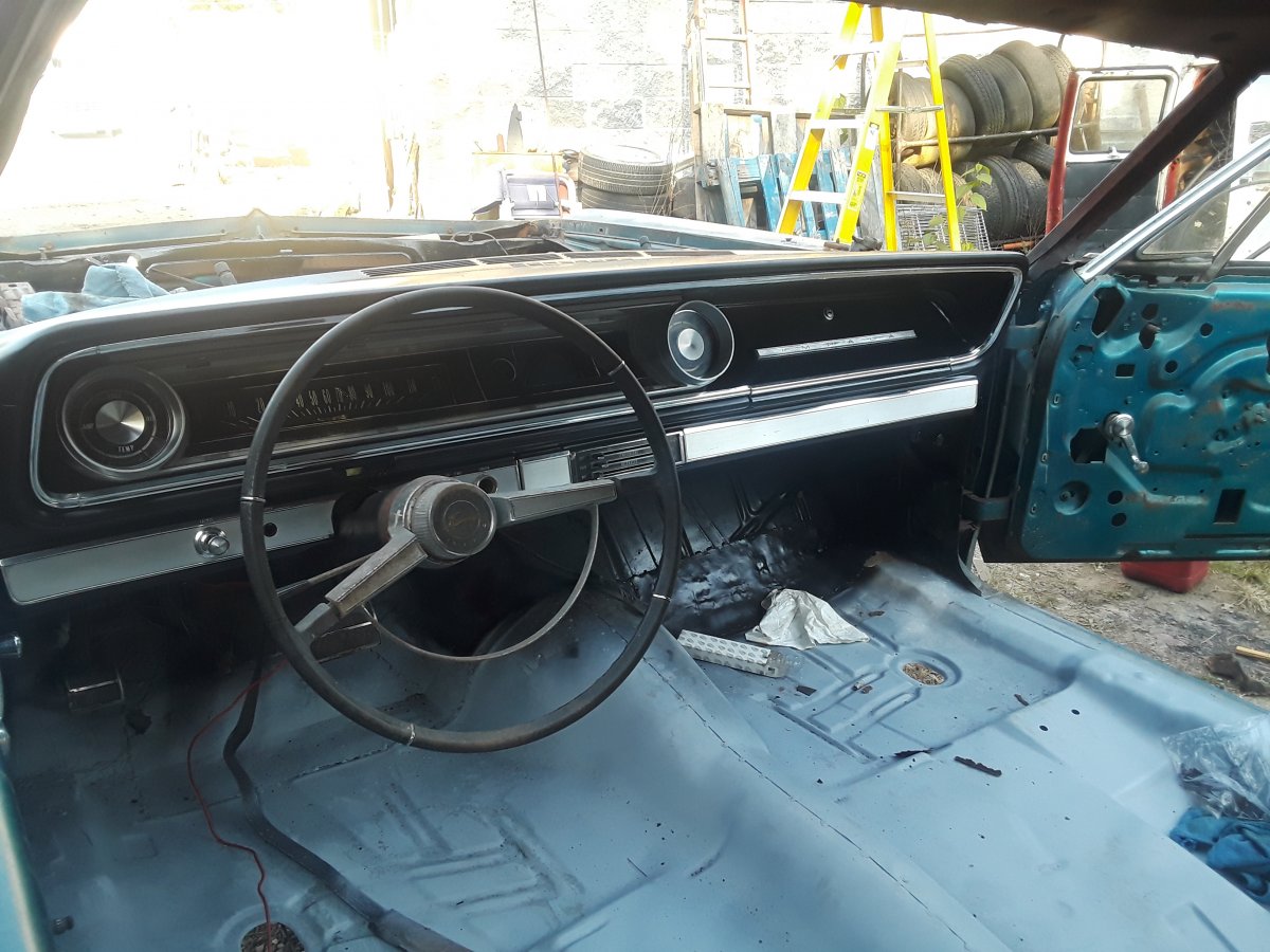

    Dash is done 20201018_160520.jpg 20201018_160505.jpg In project power tour.

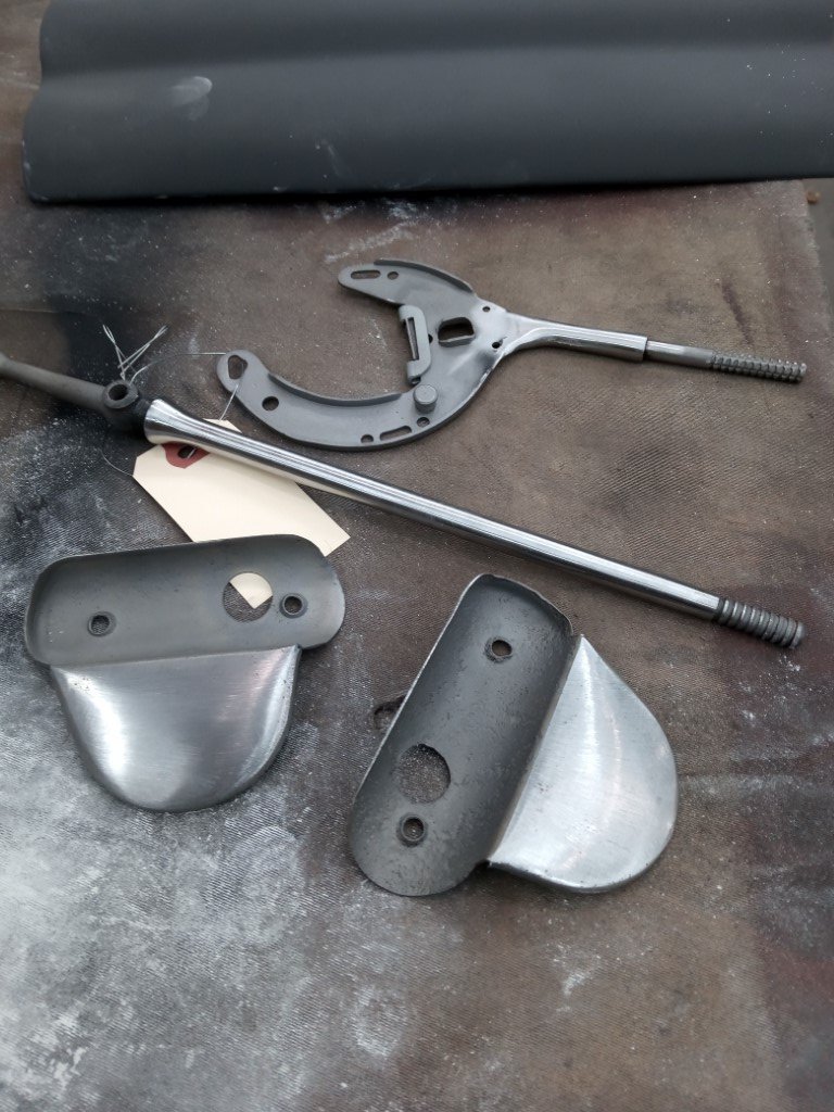

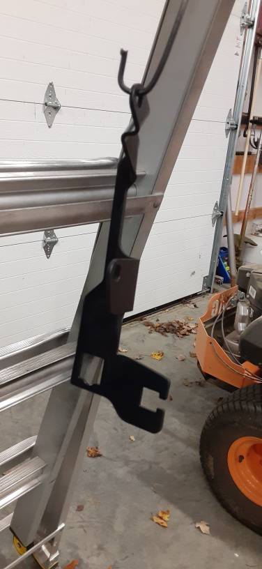

    Slow weekend; blocked out the '47s dash and put down the final coat (I hope) of primer surfacer. Started to sand the pitting out of a couple pieces to get ready for the chrome shop; don't know if the seat parts will make it. Also, smoothed out and painted all the brackets for the A/C parts I made last week of course I grabbed the semi-gloss instead of shiny and had to redo them.

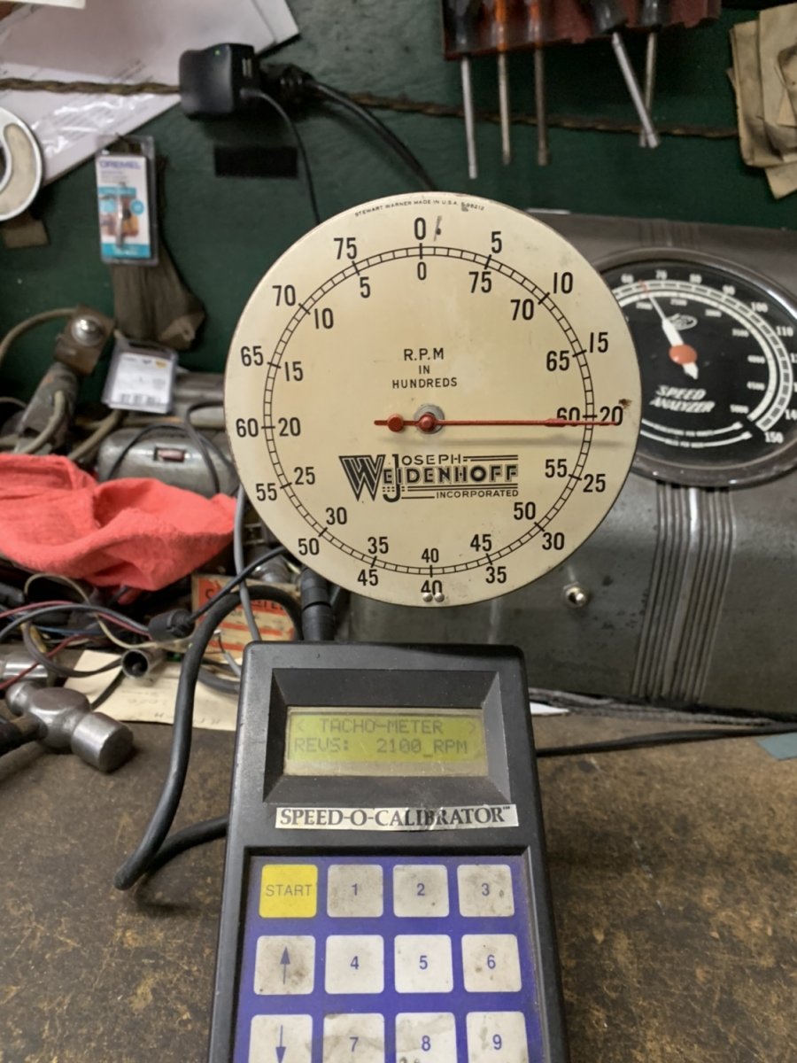

    Rebuilt a Stewart Warner 5 inch 8000rpm tachometer that’s both clockwise and counter clockwise. From a customer in Iowa. IMG_0753.JPG IMG_0754.JPG IMG_0755.JPG

    Well I just thought the heater was done before. Lol now it really is done and tested 20201024_145144.jpg

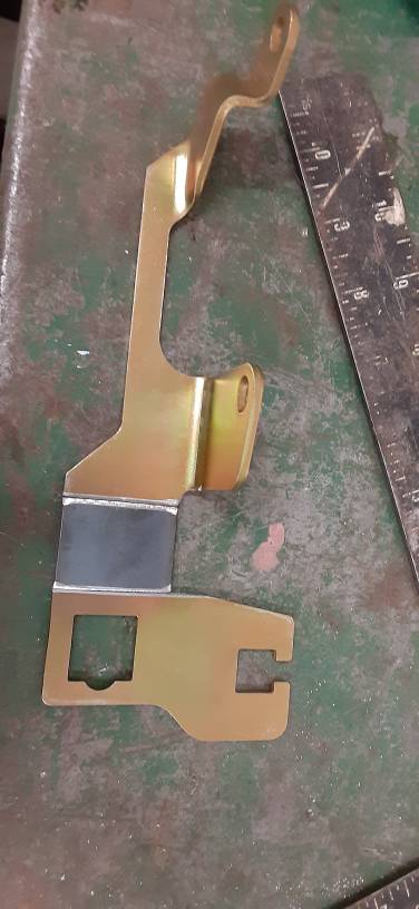

    Bought a 700R TV/ Throttle Bracket from Jegs. It was too short so I had to lengthen it. Trying to understand how they came up with those dimensions! 20201025_125353.jpeg 20201025_133719.jpeg 20201025_183924.jpeg

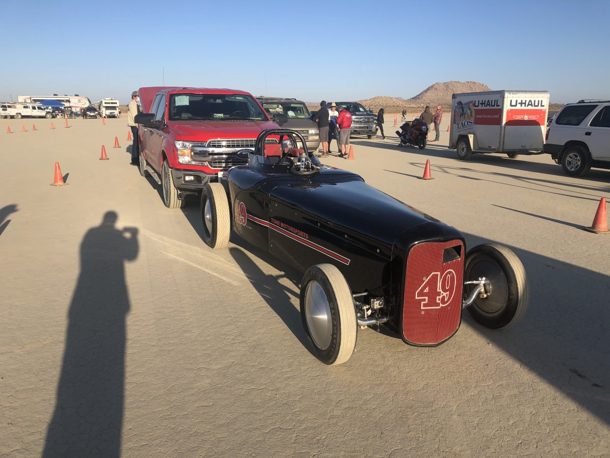

    Spent the day at El Mirage for the First Meet since China virus stopped the world. Not a good day. Dusted out so bad that I could not see which has never happened in 45 years of my running on the dry lake bed. Actually got it stopped and didn’t hit anything and still on the course. Officials thanked me for doing the right thing. There well always be another day. Meet was shortened for high winds and not all 53 entrants we able to make a p***. 6195E095-C7F0-4816-8E67-D8C094DC8335.jpeg
