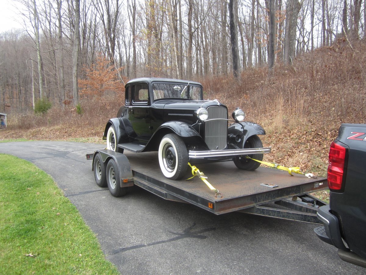

    Well I said one hot rod was enough after selling the Coleman 32. Today that all changed when I bought another 32 five window that I had five years ago. It was the nicest 32 body and fenders that I ever seen. All original parts! Anyway I started working on this five years back and decided it was too nice to chop etc.. I sold it to friend and it sat for five years and now I own it again and plan on taking it to the finish line. Soon as I fix my plow I will start on this 32 when not working on my roadster. IMG_7448.JPG
    it's back home again!:cool:

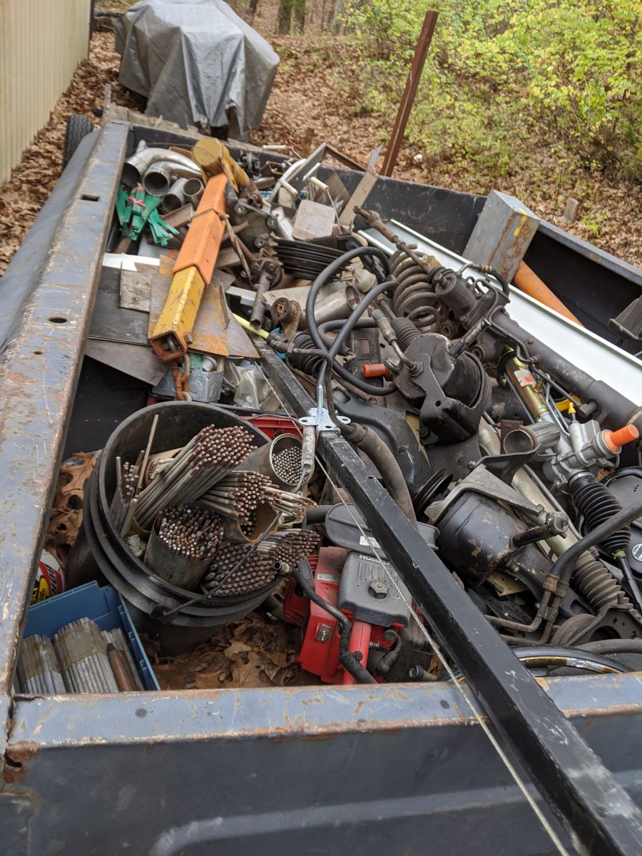

    IMG_20201120_123152.jpg Spent the day cleaning and throwing away **** out of the barn...

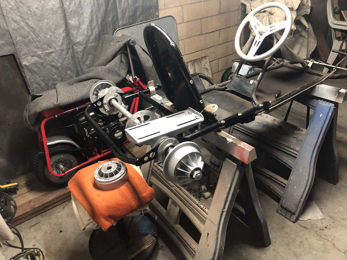

    Doesn’t mean much but back putting an old Rupp Chaparral go kart back together again. Was my sons, then grandsons and now preparing for the next generation. New axle in today... lots of new parts coming. Upholstery at a shop, outer rims out for chrome, and B&S Raptor for power. Final photo will be here.
    PS: the 2 minibkes were finished last week. Both in storage for 10 years. Youngest grandson is now a lineman apprentice at 22. DD091209-0933-4613-8D5D-F1A7C1DC5EE6.jpeg

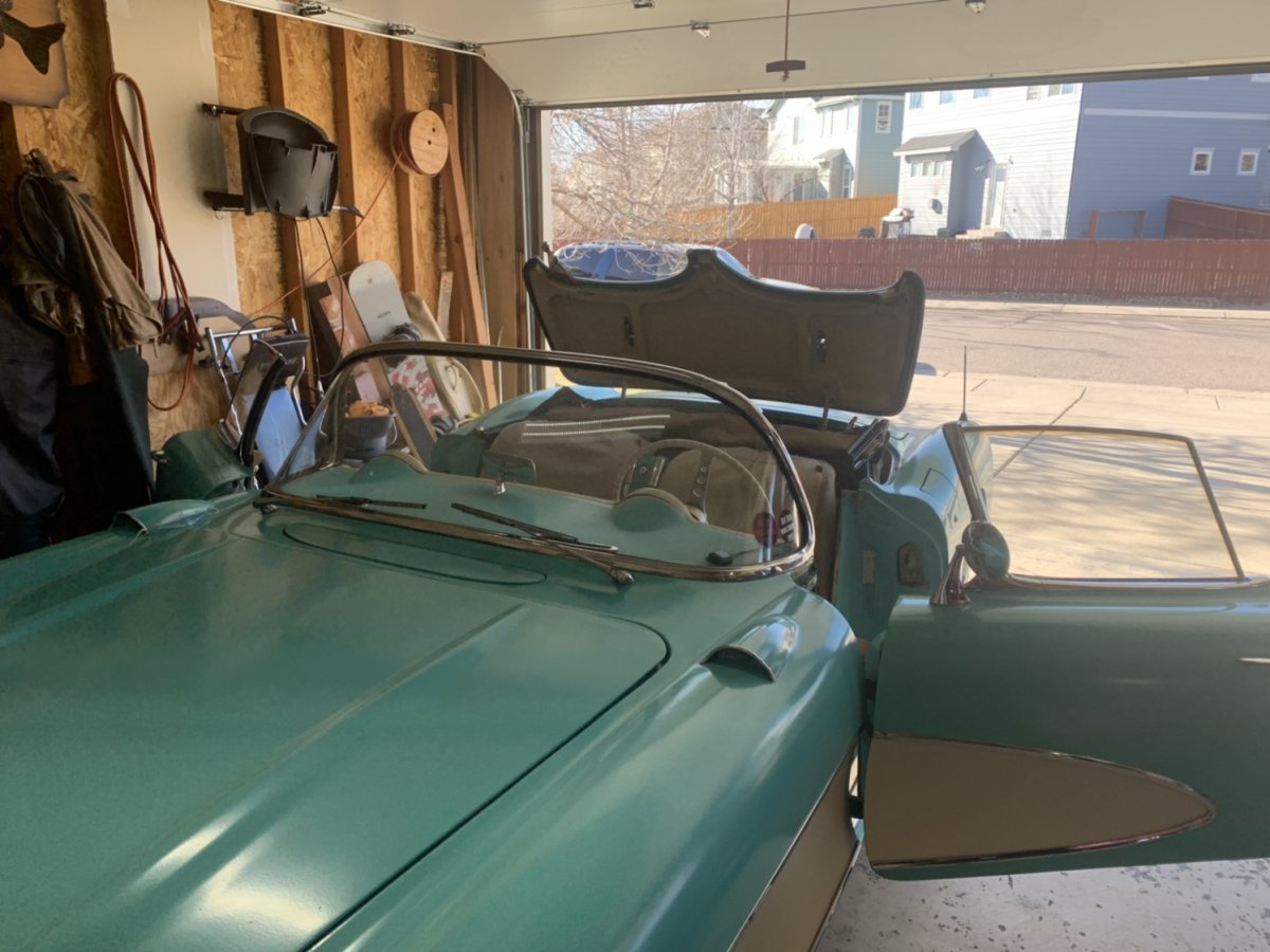

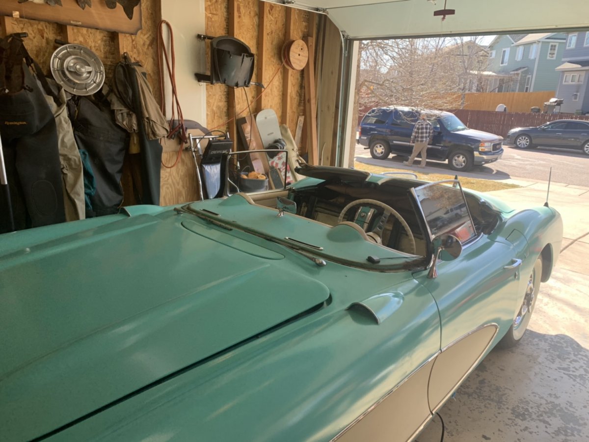

    The Corvette has always leaked bad when it rains so I pulled the windshield off to replace the rubber gasket the goes between it and the body. Took the windshield frame to Randy at Yesterday’s Corvettes and he is also putting in a new rubber gasket around the gl***.
    Seats are going in to be recovered also. 62767060124__60C8AF49-9F6D-4A76-AA9C-FB8EAC953C93.JPG 62767957471__8AC81069-76D3-45C6-B31C-A8A018923A77.JPG 62767960092__01F8215D-A09A-44E6-9CC4-BDDB3C9CAF84.JPG 62767989601__213A4783-2B82-4467-AD90-078369E6C05D.JPG 62767993766__BDB19D47-542B-4FFB-8B95-71BC8547AAC1.JPG

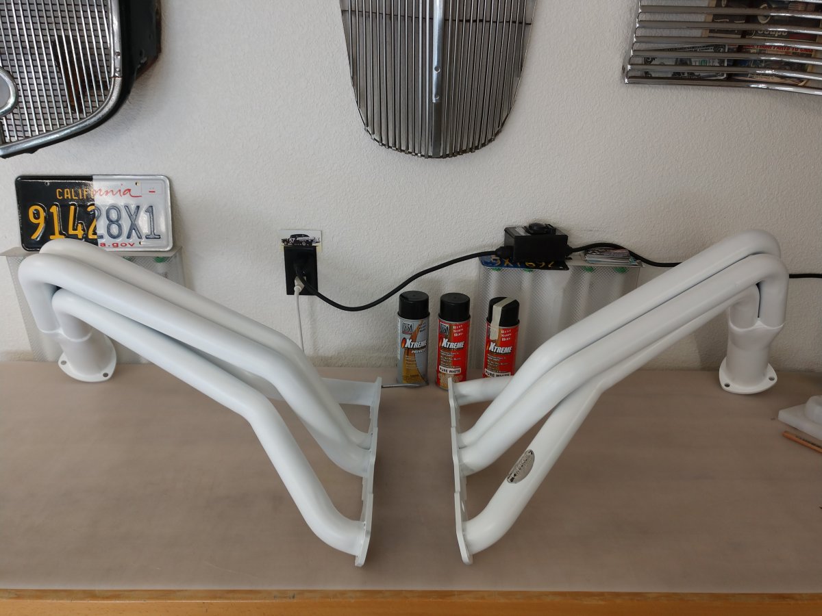

    Installed the ****** Headers finally Headers.jpg Tag.jpg thumbnail_IMG_20201120_123622510.jpg thumbnail_IMG_20201120_140551979.jpg thumbnail_IMG_20201120_140615641.jpg thumbnail_IMG_20201120_140622117.jpg thumbnail_IMG_20201120_141828436_HDR.jpg

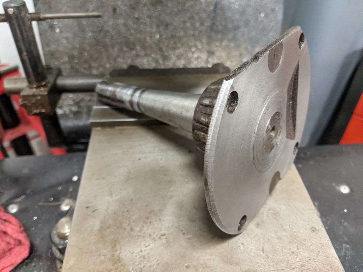

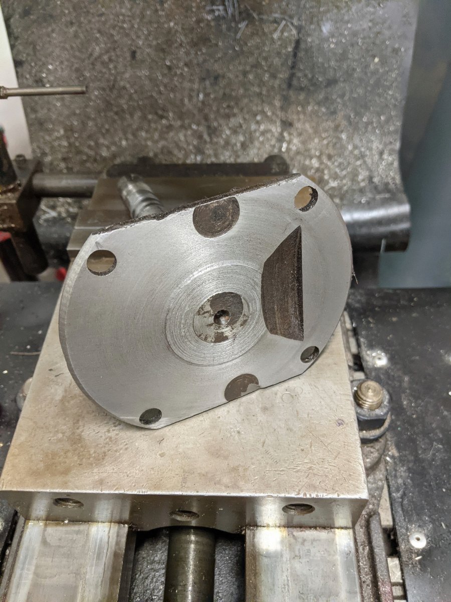

    Today I worked up a single Model A spindle that I have been holding on to.
    I cut everything off of the back side, and made some p***es in the lathe, to make a nice flat, perpendicular surface, so it can be welded to my wheel building jig.
    The slight raised area fits the ID of the tubing it will be welded to.
    127152283_3769139176452336_3638305143662428067_o.jpg 127207992_3769138743119046_4923590295889508729_o.jpg
    The plan is to drill and tap the hub for all common 5-lug patterns. I also have a Wide-5 adapter.
    I already have three orders for pairs of wider Wide-5s, and a pair wider Ford 15s.

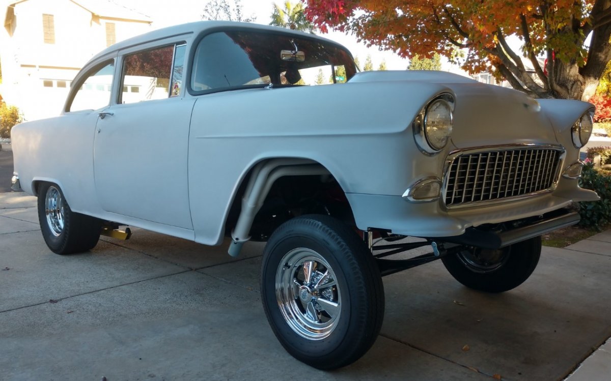

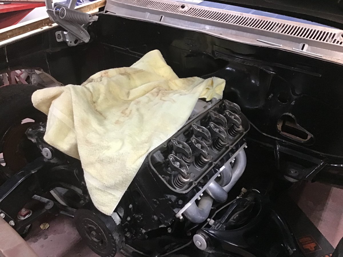

    IMG_20201122_155952247_HDR.jpg the new motor is in the 210 post car

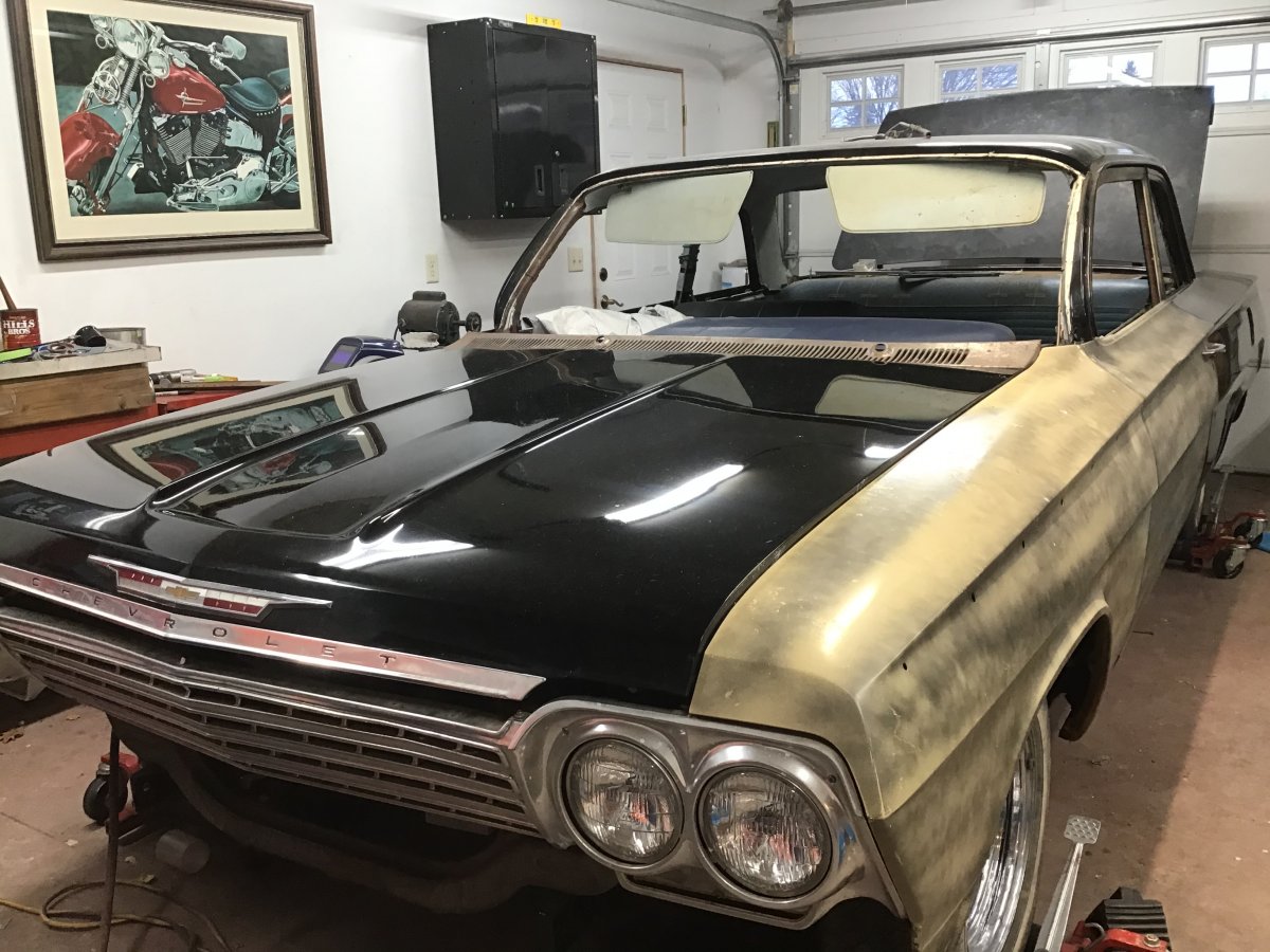

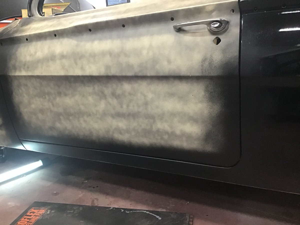

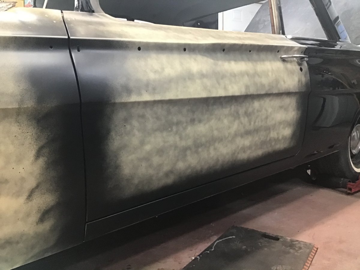

    I’ve been working on my 62 Belair cleaning things up and working on the gaps. EA9BE858-CB73-463A-A175-98B664E1E664.jpeg D6D6FF3E-0A02-4109-A8C5-2EBDEFA7D6E2.jpeg

    I’m curious to your use of a spindle for this, I/e since you have a lathe. I’d guess not enough swing for a wheel? Or just making a separate fixture? If so, I’d like to see what your process is for rotating it and tacking things together.
    When my Dad and I were doing drive shafts for big trucks, we got creative and made a set of rollers to clamp in the drive shaft instead of reclamping the ground.
    My job after tacked in was to slowly spin things by hand. Lol
