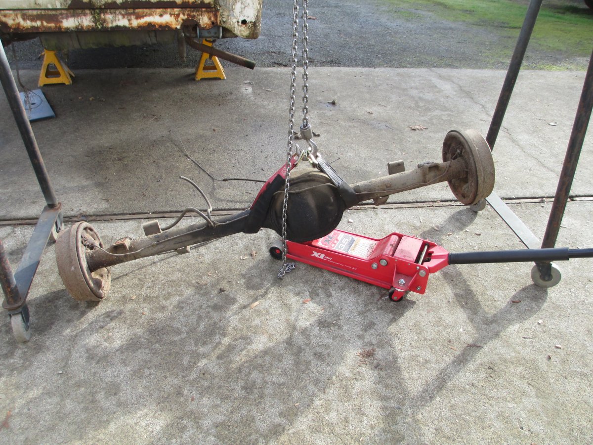

    I have one of those van axles in my car. Shortened the long side 8" to center the housing.

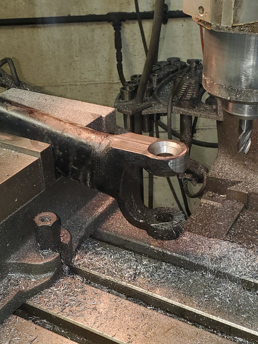

    Worked on making some various 30's and 40's Era front end parts work together...

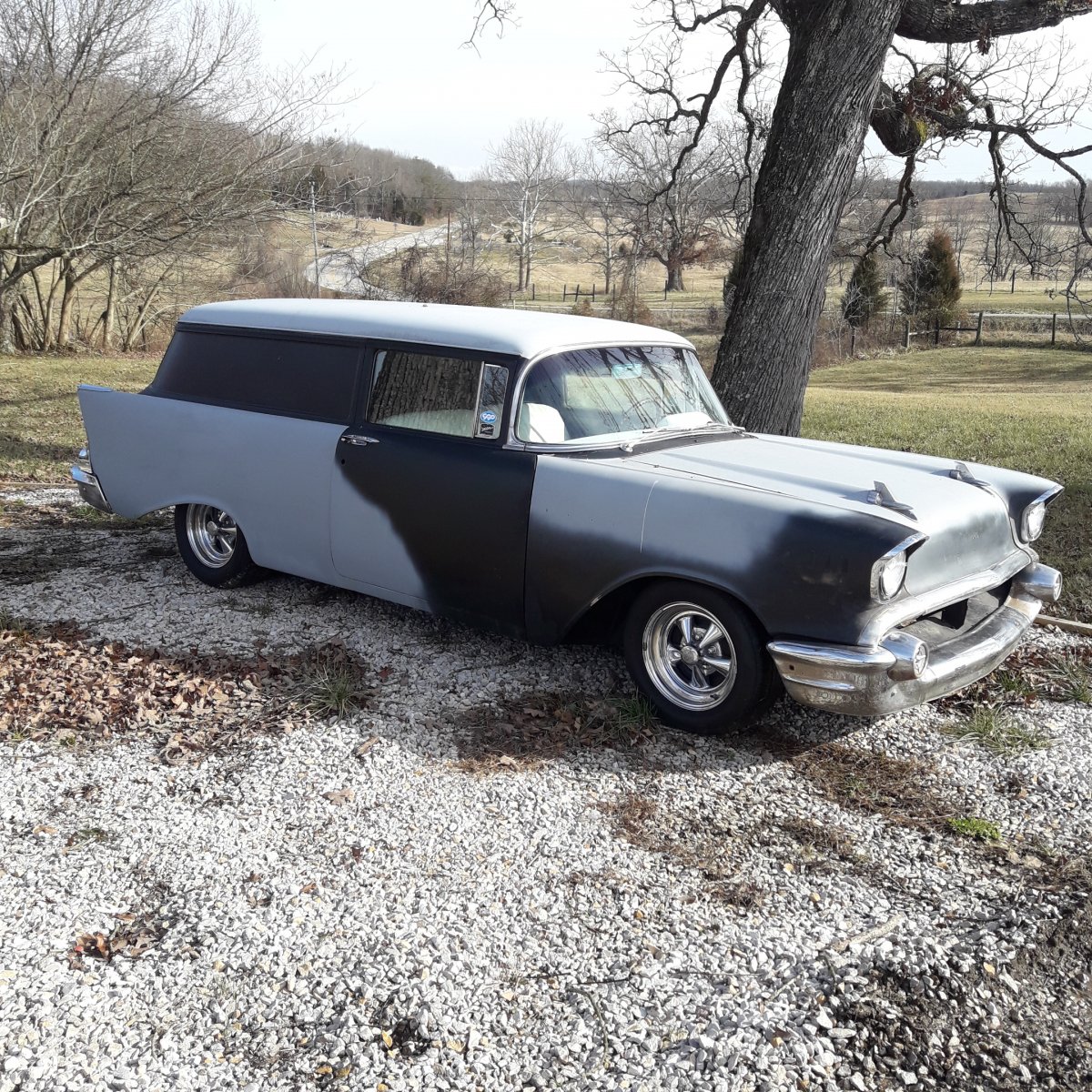

    And to celebrate, my wagon yelled and said "let's go down the road and back big guy!" So we took a quick trip and parked in a different spot :D 20210206_150228.jpg 20210206_150241.jpg

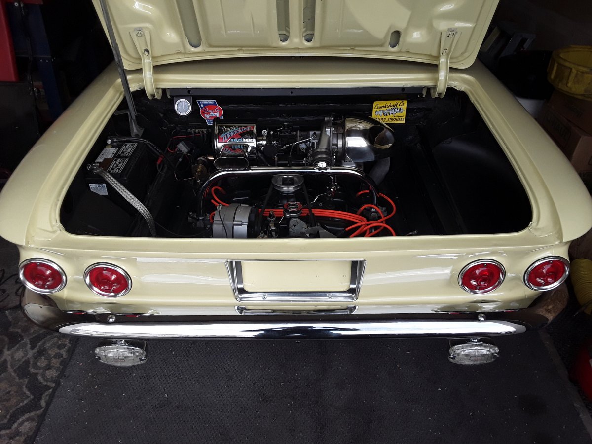

    Hooked up the battery tender and checked tire pressures. Gave the motor a wipe down. I like it clean. 20200625_204208.jpg

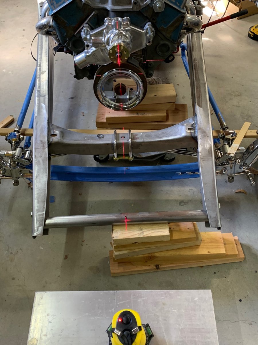

    Worked on setting up motor mounts on the Faux 32, cheap laser came in handy.

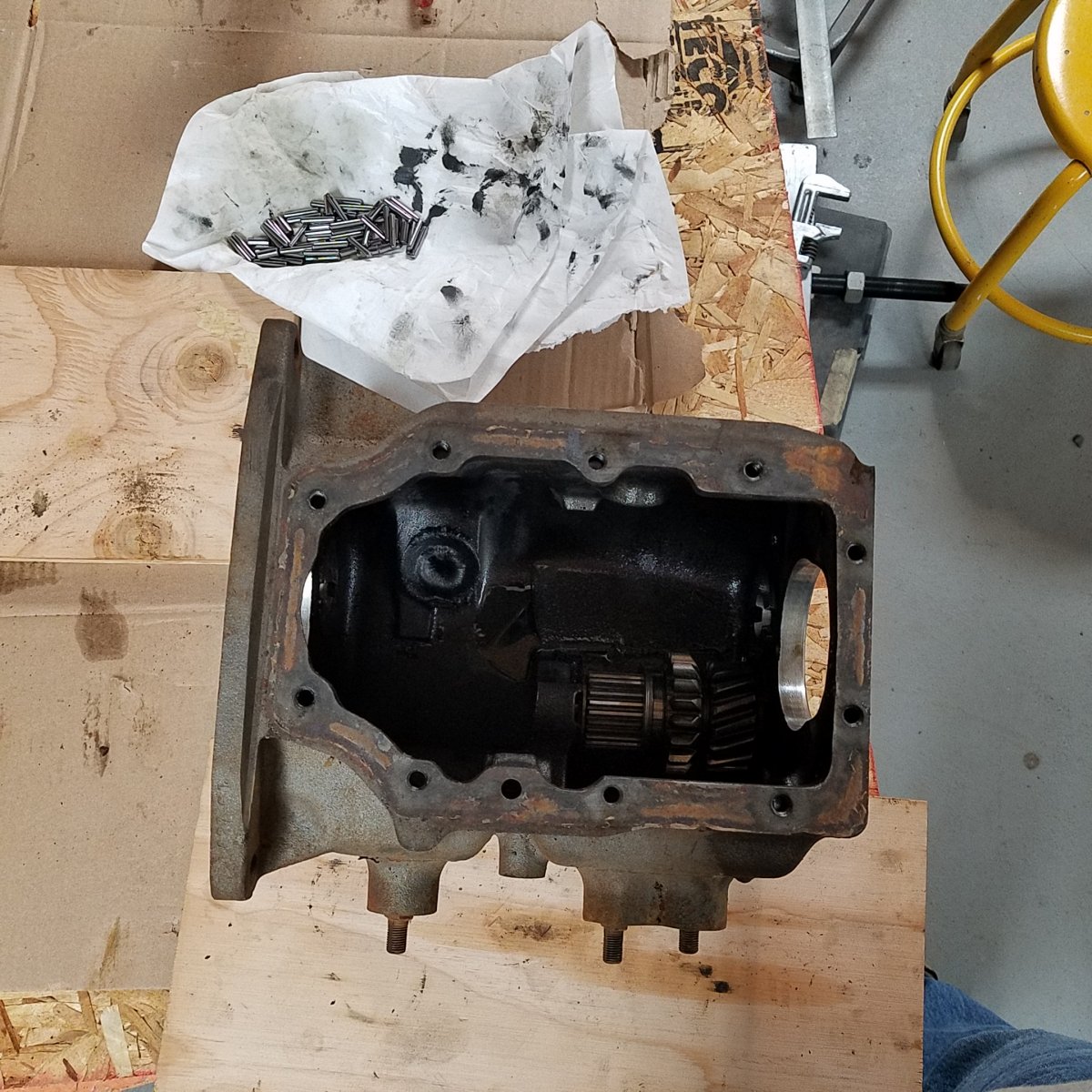

    Outta this thing

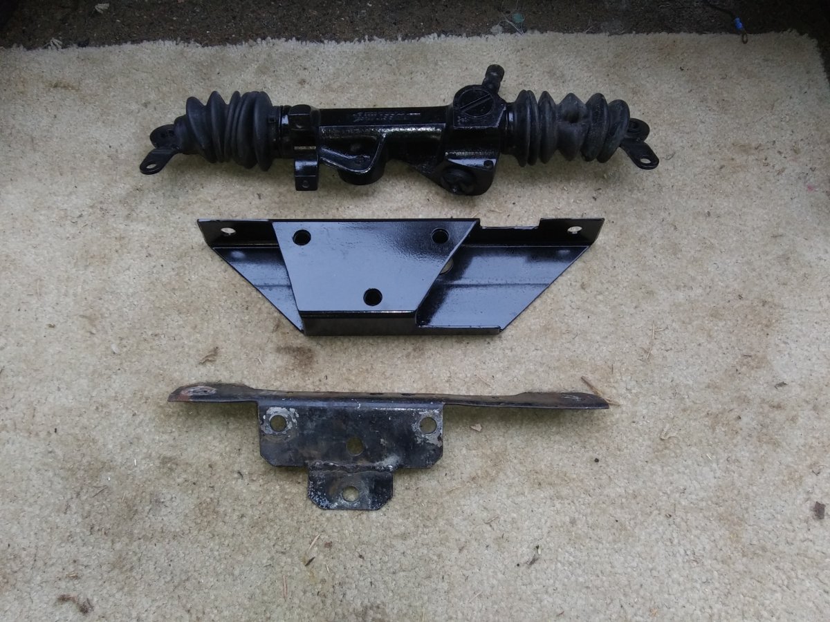

    Made a new mount for my steering rack. When I got my Bantam it had a Corvair box mounted in front of the grill. No room for rear steering so found a circle track rack narrow enough. Took a ton of adjusting but got it steering and handling great. Doing some winter maintenance I noticed the mount I had made was bent. So I made a new one out of 2x4 box steel.
