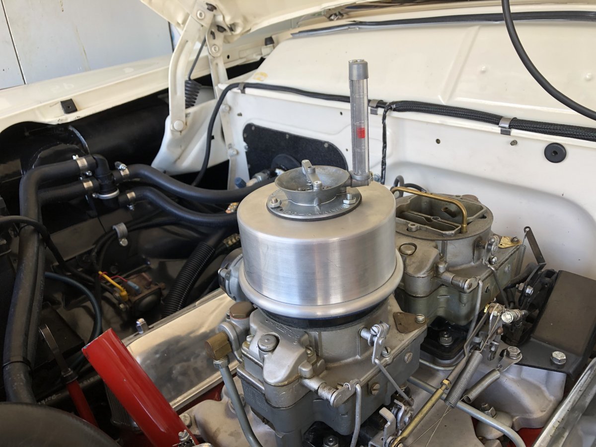

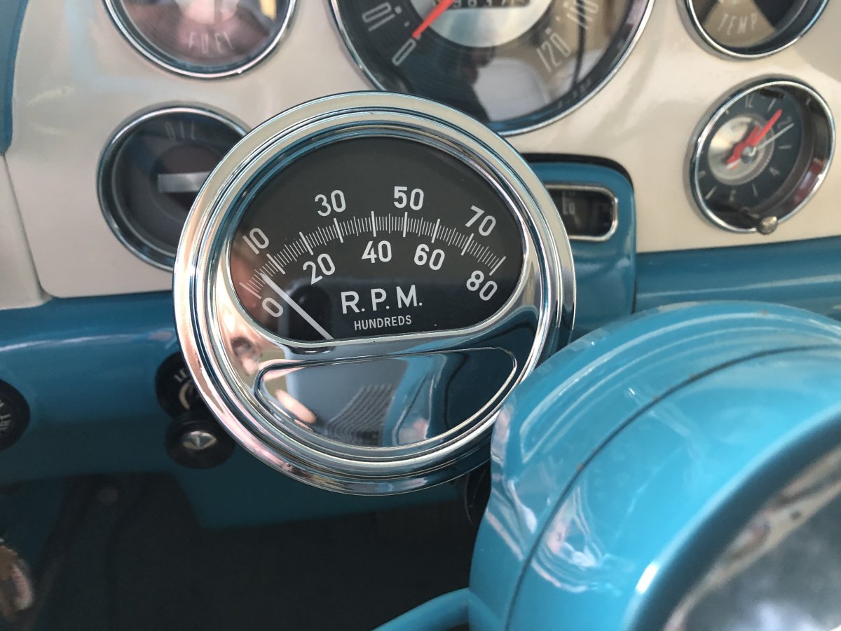

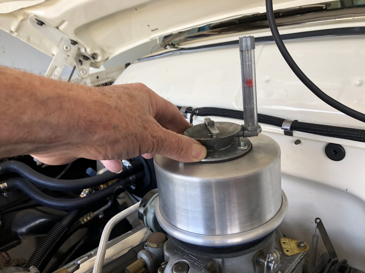

    After installing a PVC system last week been trying find the sweet spot idling. I seemed have found it. Vacuum on the crankcase is 1.5” which is good. 17” of intake vacuum and the Unisyns are very close. Rpm in drive is 600. BC1806DA-2552-4621-BCD1-63BD1DD1977E.jpeg D8AF1E02-590E-44BB-8B6C-623B76BD44F0.jpeg A1621FA7-BAE8-4BCA-BAE9-FD057185039A.jpeg

    Neat. I've used a Unisyn on bikes for years but never thought of an auto adapter.
  10. jimmy six
    Joined: Mar 21, 2006
    Posts: 17,075
    jimmy six
    Thanks. Took 2 adapters to do it. No much available for the carb top.

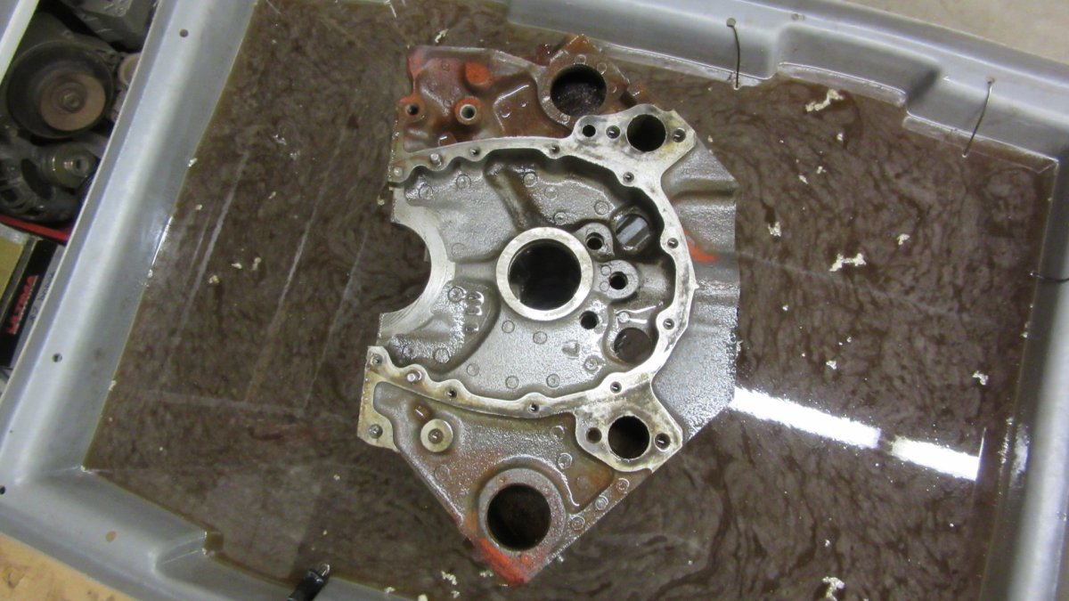

    I am cleaning the block for a rebuild , so after a pressure wash and some cleaning with varsol I have it soaking in some purple cleaner. The first picture is fresh cleaner the second is 2 hrs later. I have a heater element dropped in the tub to heat the solution. studebaker build 001.JPG studebaker build 002.JPG

    That’s great. What kind of heating element are you using? Randy

    I would love to see some pics of the block after it gets pulled and rinsed. Had to sell my jet washer and am looking at options for cleaning. I haven’t been sold on the laundry soda and electrolysis option yet.

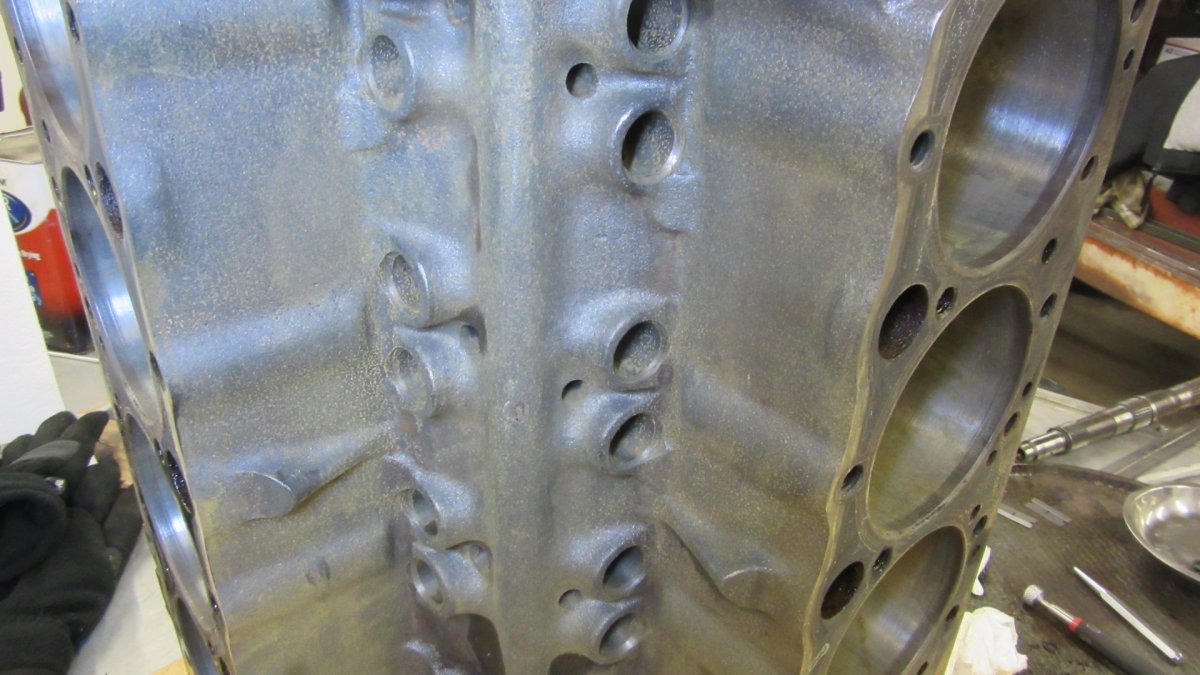

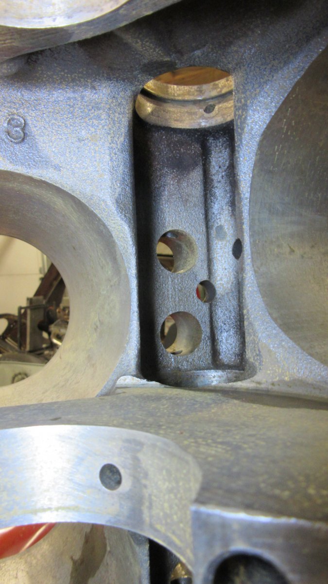

    Here is the end result, the soak time could have been longer ( this was about 12 hrs ) and the solution ( Purple Power ) was on the weak side. That was about one and a half gallons of cleaner in that large tub. studebaker build 001.JPG studebaker build 008.JPG studebaker build 009.JPG

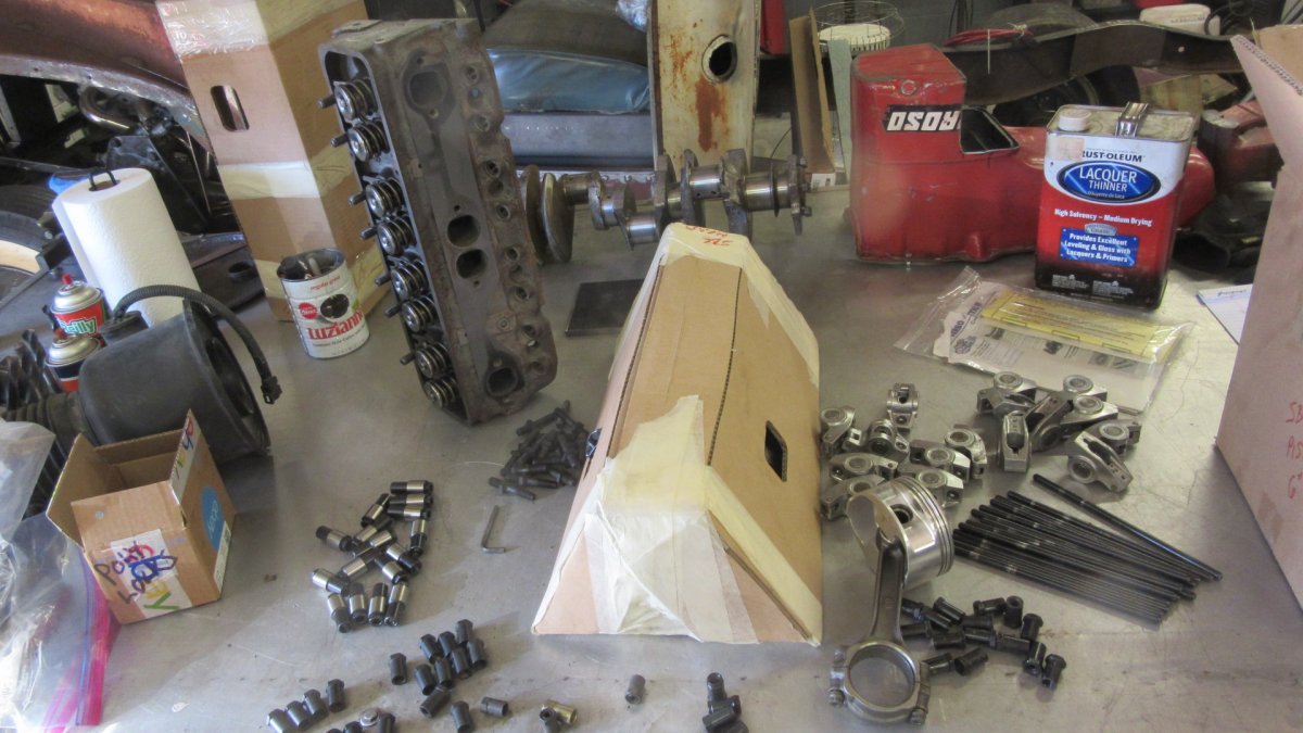

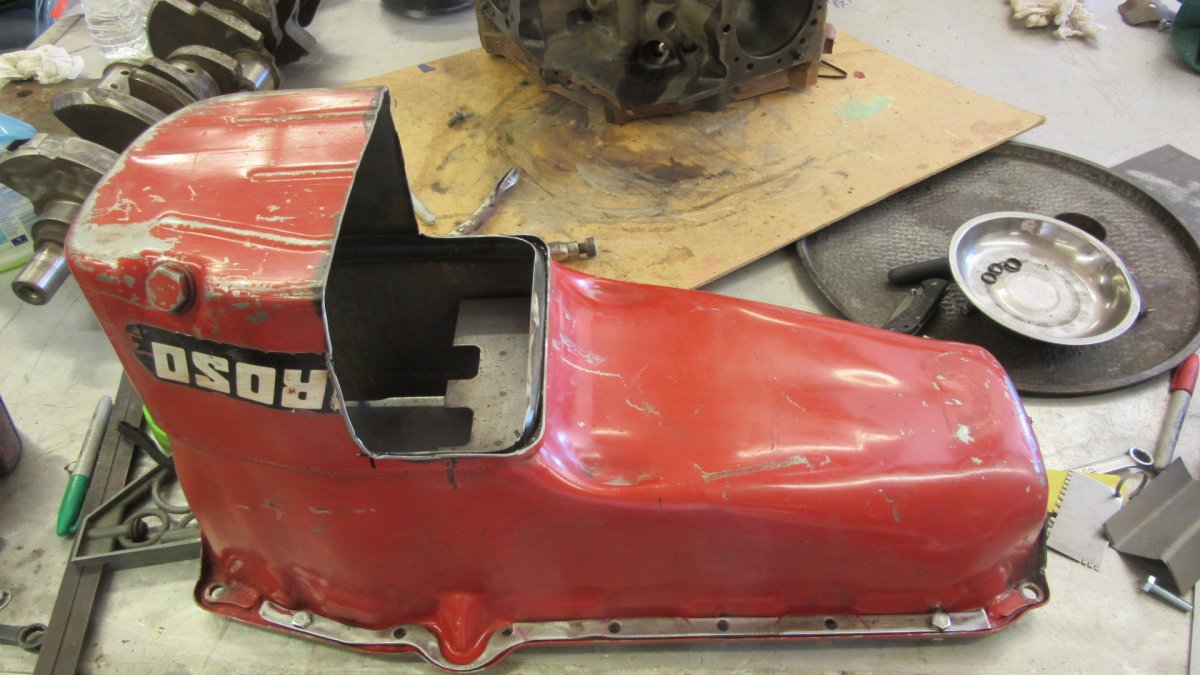

    I spent the morning gathering up parts I have had boxed up to put this thing together. I am having to take a inch out of the front of the sump to clear the steering. I missed that when locating the motor. studebaker buils 001.JPG studebaker buils 003.JPG

    Thanks for the pics. Looks like it came out real nice.

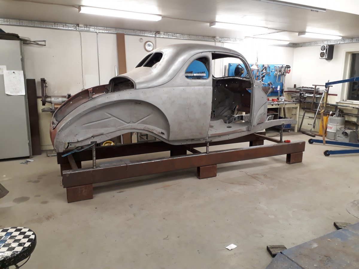

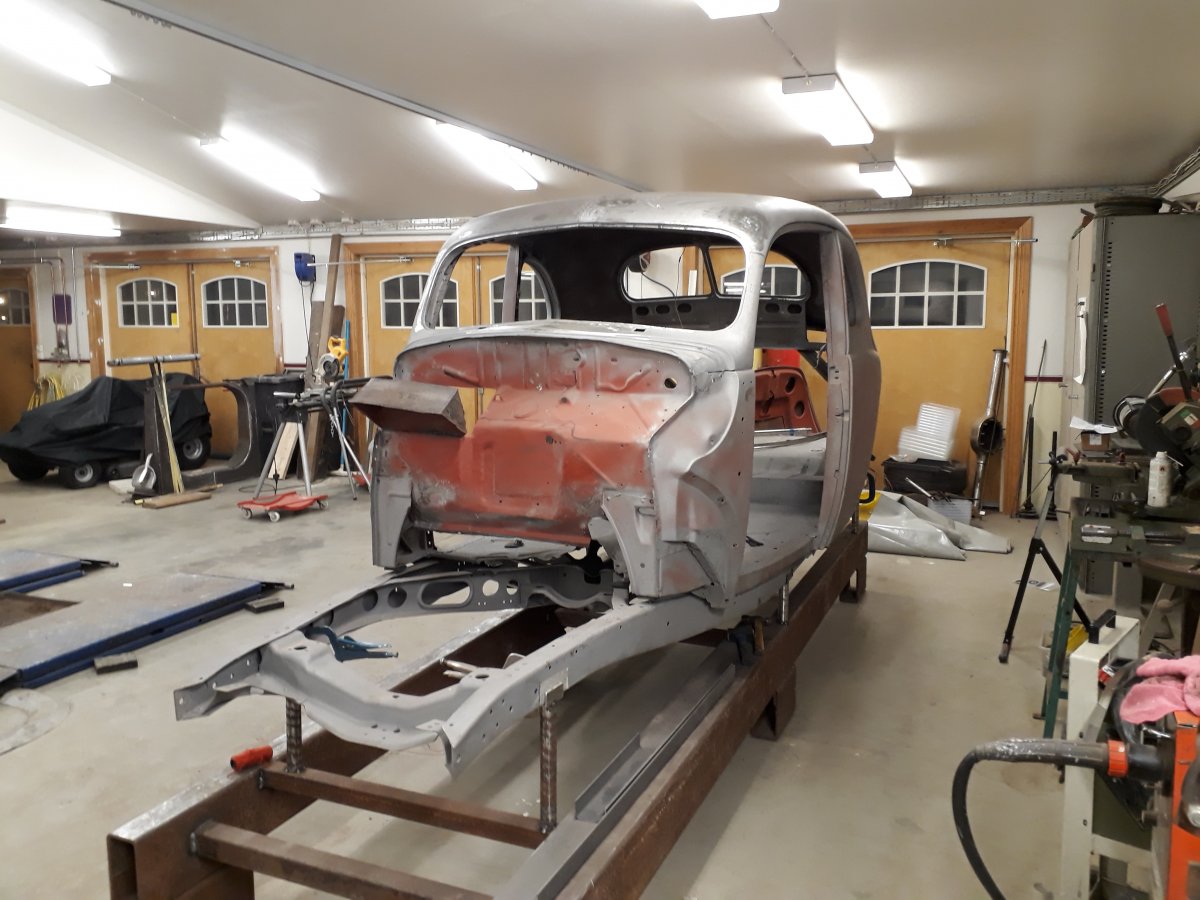

    So the body is back on the frame. I finally got the frame straight and we could lift the body on. Now I " just" have to tighten it to the frame align the doors. Then I can split the roof and replace the raingutters 010.jpg 011.jpg

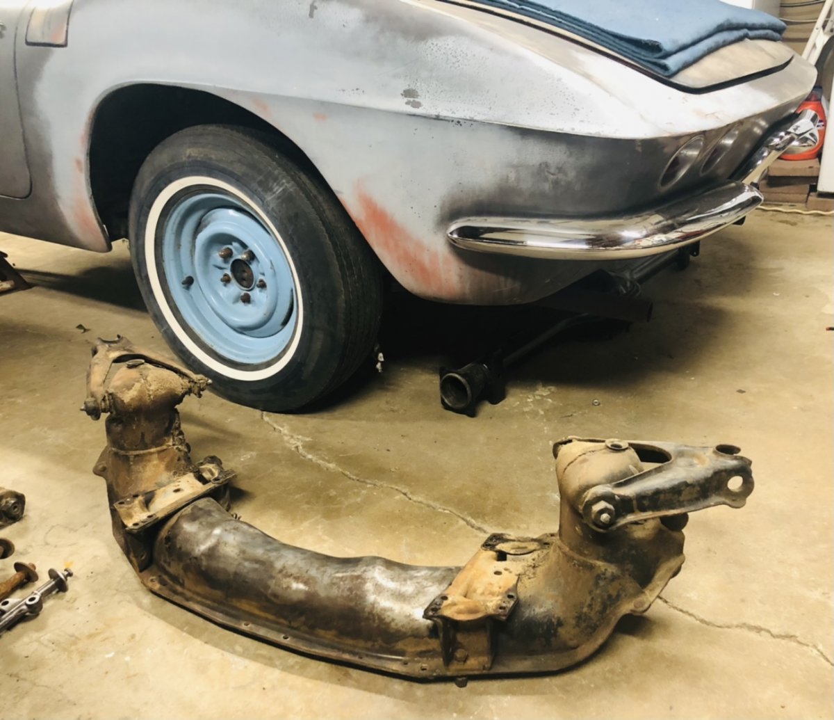

    This is a corvette crossmember. The inspiration for Its design was birthed in the Devil's ****! It was created by angry GM engineers who from their graves find humor in the fact that I had to take all 16 bolts out one quarter turn at a time while under the car!
  28. junkyardjeff
    Joined: Jul 23, 2005
    Posts: 8,703
    junkyardjeff
    The same designers who wanted the trans crossmembers in the 49 to 54s riveted in and the trans needed to come up through the floor.
    31hotrodguy likes this.
  29. jimmy six
    Posts: 17,075
    jimmy six
    Design engineers are not “car” guys. They don’t work on them and don’t care. The motto framed on their office wall says, and I quote.. “****um make them buy new”
    61Cruiser, mad mikey, Papas32 and 3 others like this.
  30. FRANK GRELLE
    Joined: Oct 15, 2018
    Posts: 145
    FRANK GRELLE
    Ummm, excuse my lack of knowledge but why a 1/4 turn at a time?
