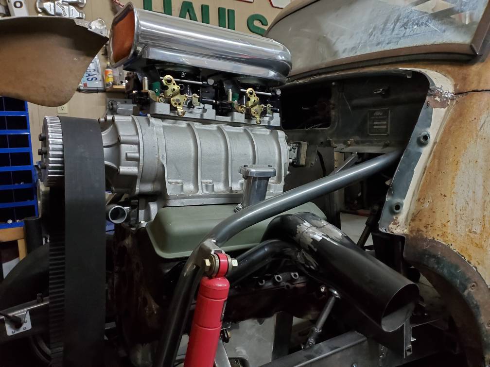

    Shortened a Brad New set of headers 3" and welded the collector back on.

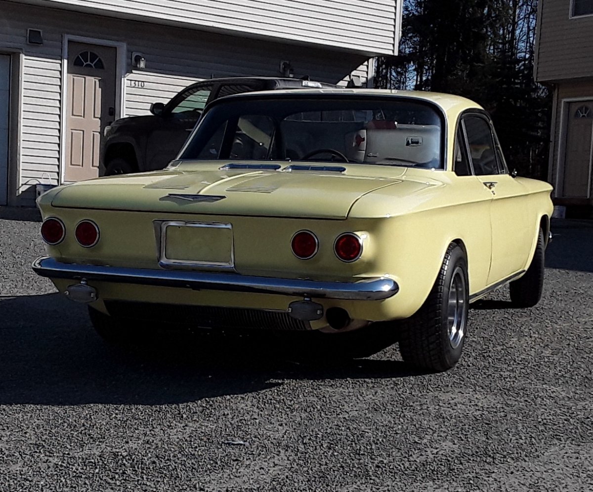

  3. I went for a ride, the first time since early November. :)

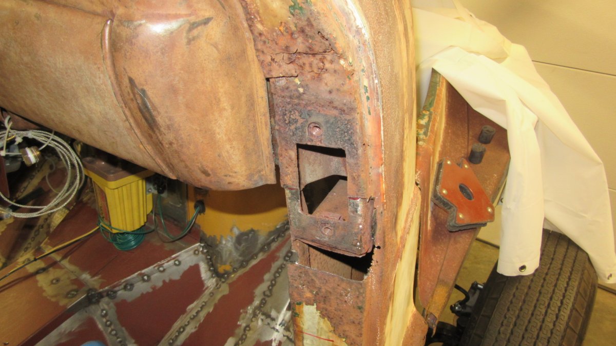

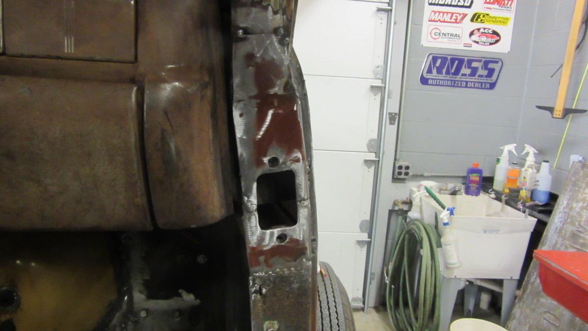

    Doing a little rust repair on the Studebaker. Before and after. studebaker build 004.JPG studebaker build 004.JPG

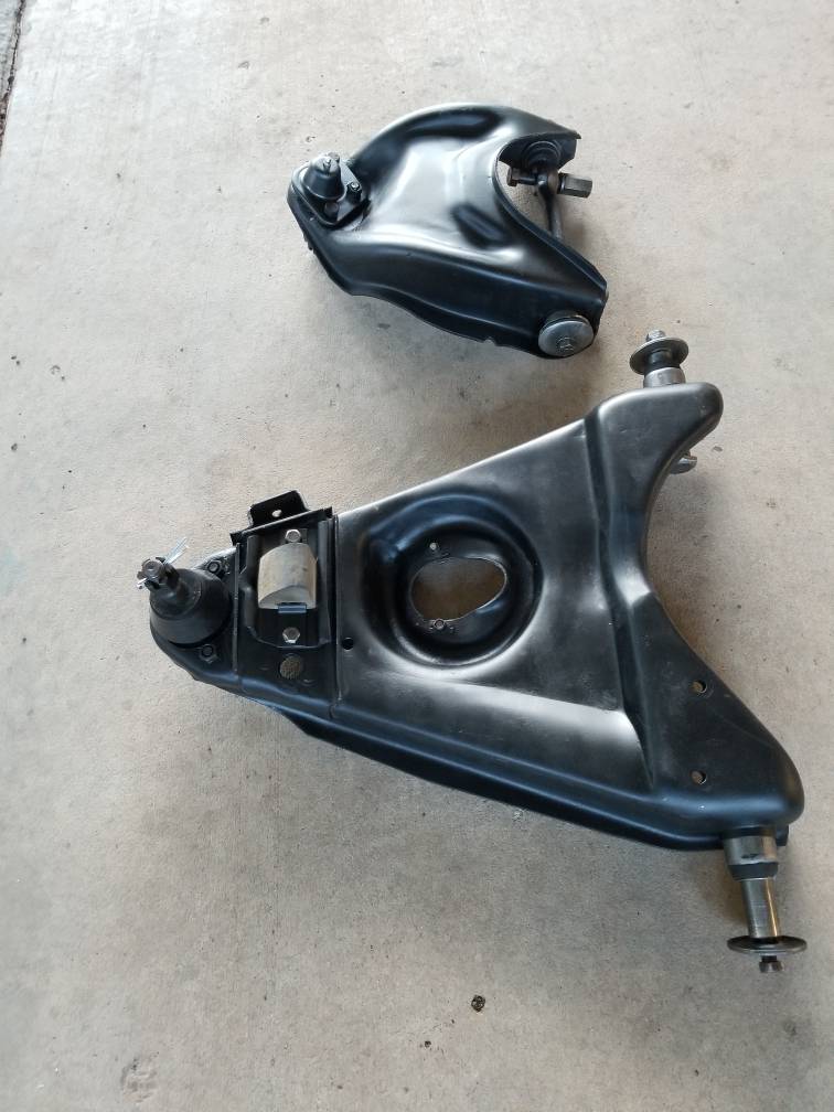

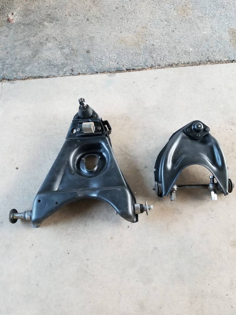

  8. Refurbished the rightside lower and upper a-arm for the Ranchero. 20210309_173927.jpeg 20210309_173933.jpeg

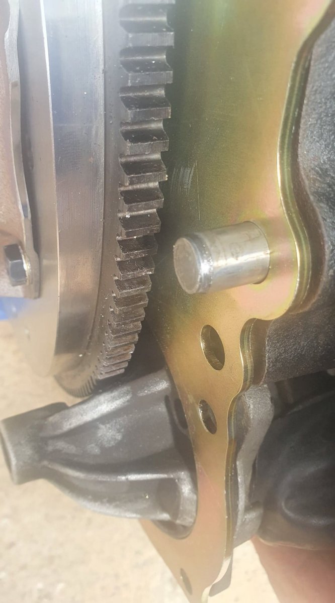

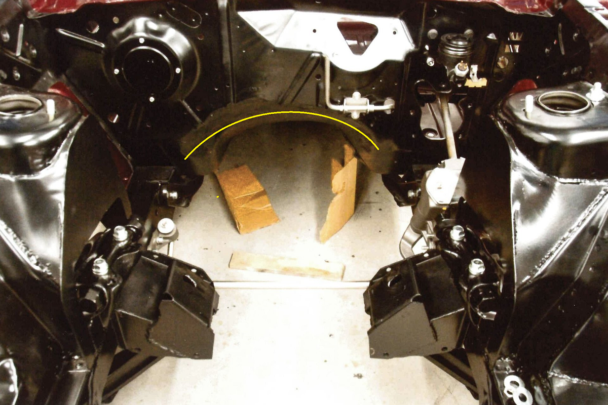

    Finally removed the old [Short] dowel pins on my (1964) FE and installed new [Long] dowel pins to suit the RC Ind bellhousing. What a PITA, I had to use a propane torch in conjunction with a dowel pin removal tool as it couldn't be done in-car. Starter requires slight clearancing. Transmission tunnel was m***aged for OEM FE bellhousing however it requires more to suit [Thicker] bellhousing. There's just no room to access both top bellhousing bolts
    I also opened up both rear aprons behind the towers using windlace on edges to finish things. Another PITA job that's now done.
    OEM Thunderbolt

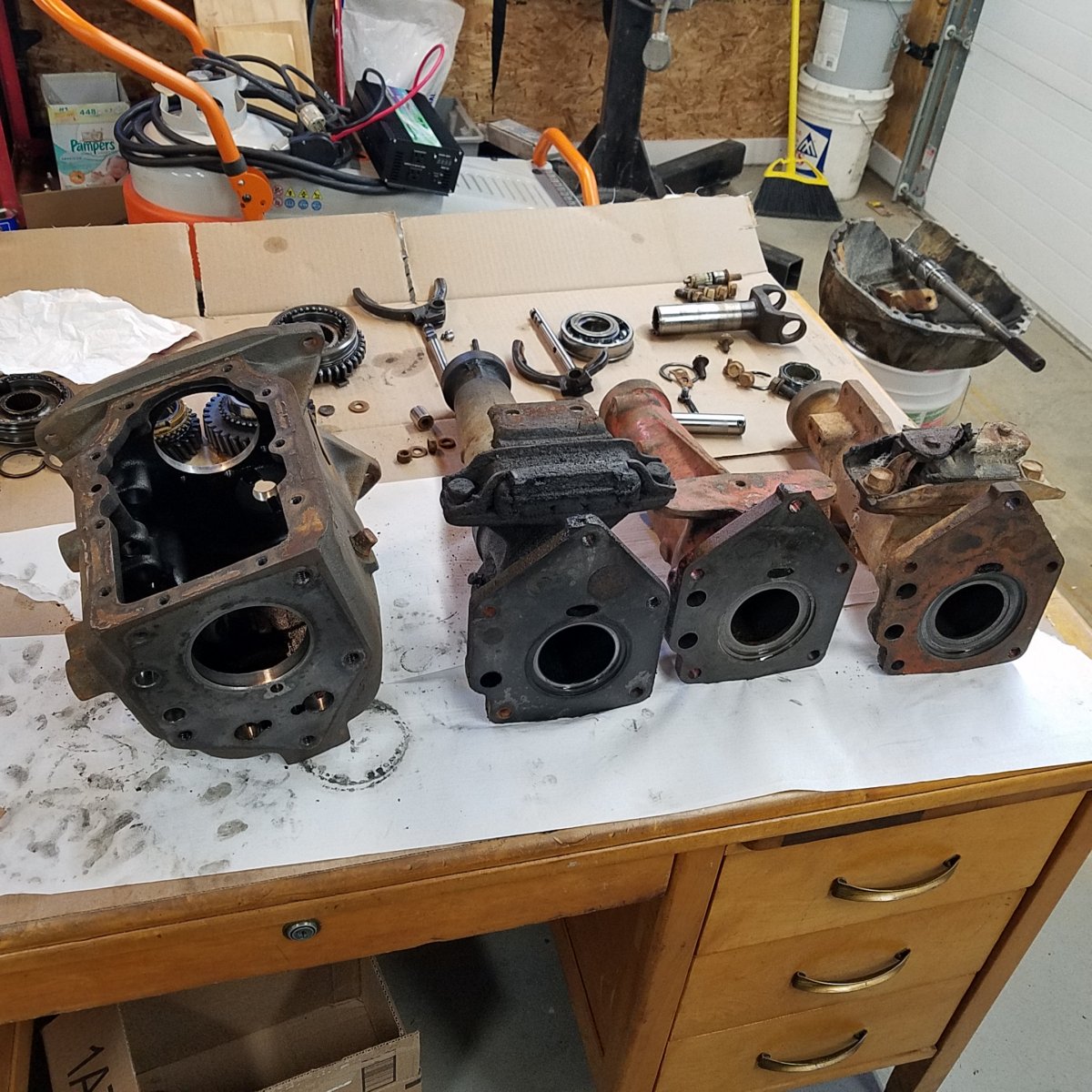

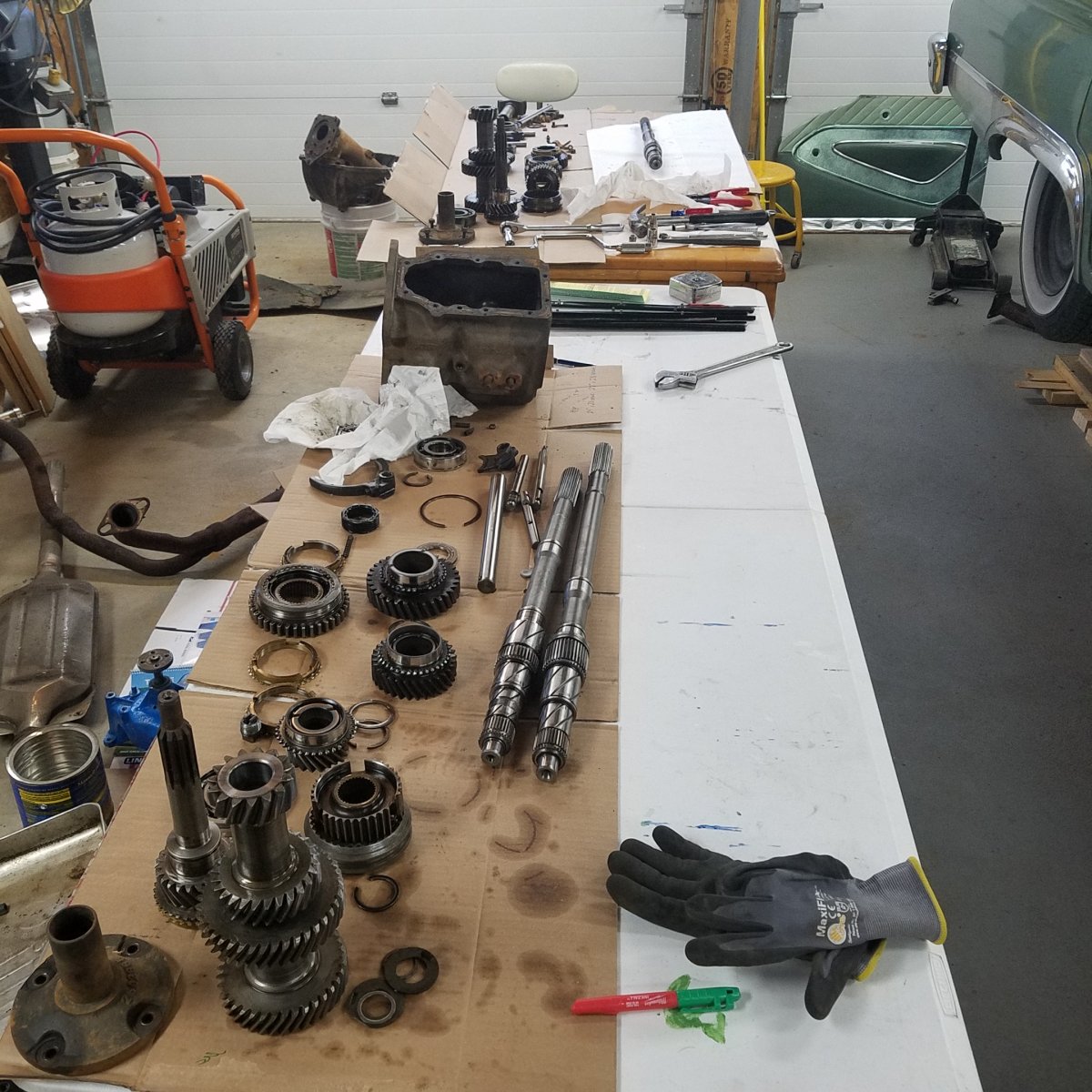

    Put all these things
    Back in here.
    Replaced bearings, syncros, counter shaft, 1st gear, 4th gear.
    Had 3 apart to use the best pieces from each.

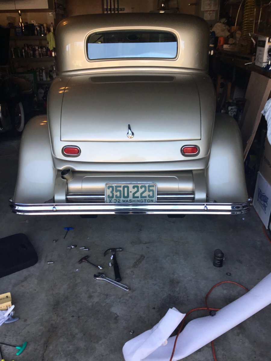

    02799862-0608-4FFA-9E6D-D5BC982CAA4C.jpeg Installed a rear bumper. A bigger pain in the *** than it should have been but I now know what to do with the front one tomorrow.

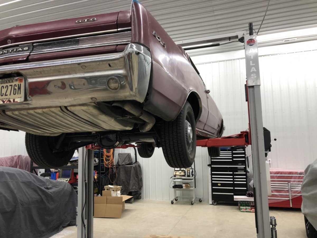

    I used my newly installed lift (finished yesterday afternoon). It’s been sitting here too long...
