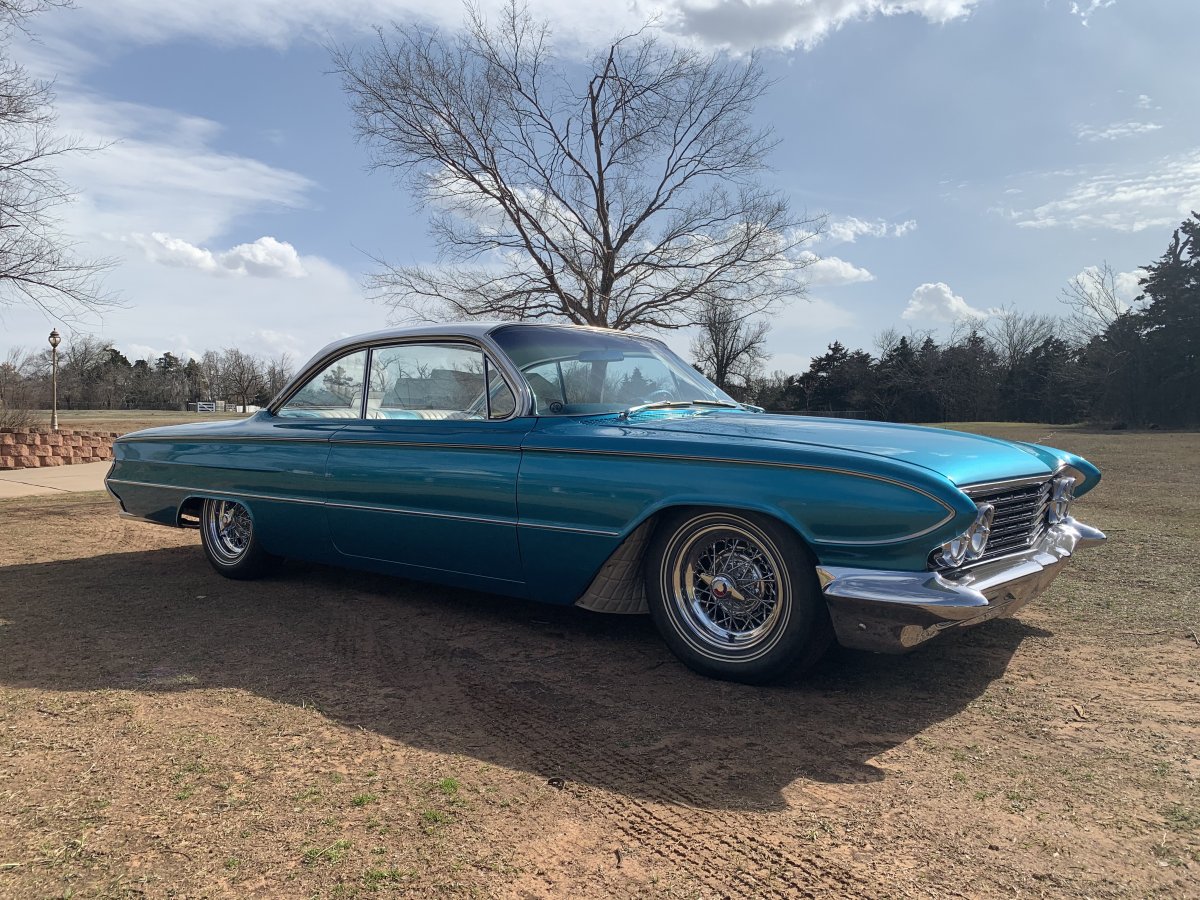

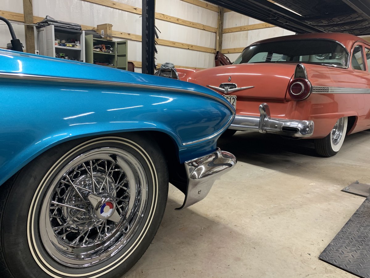

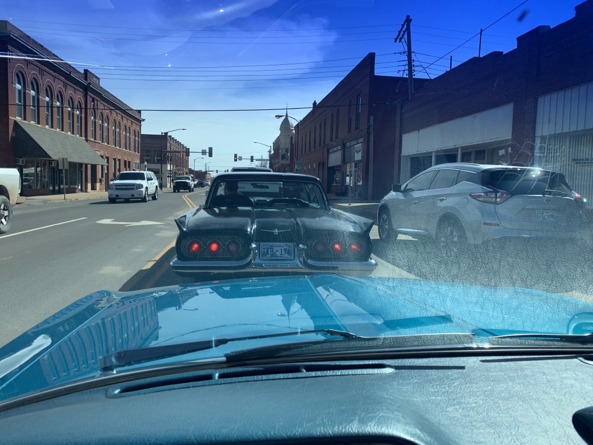

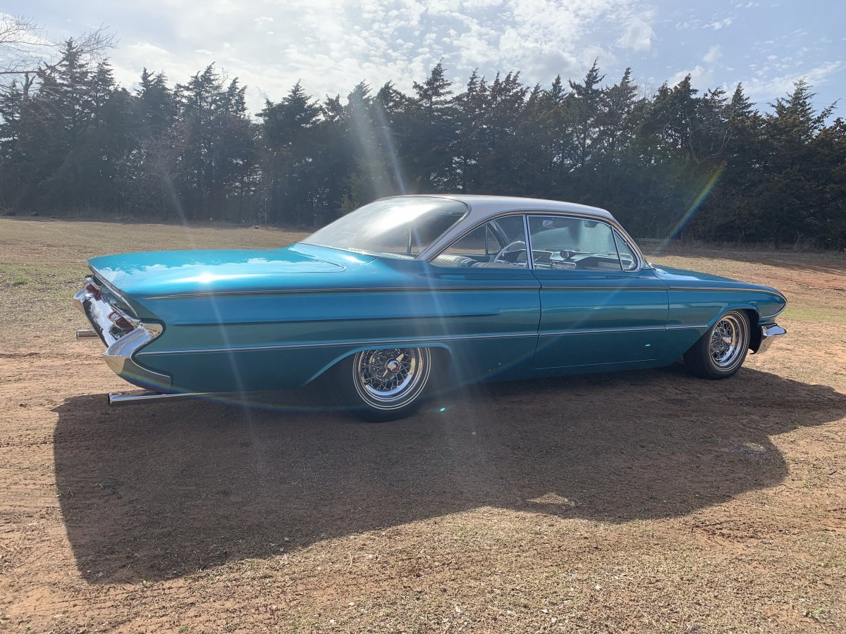

    It’s been a couple days ago now, but I took my car to pick up a familiar car that my younger brother just bought. I waited on him to tell the world before I spilled the beans. Anyway, he has become the caretaker of a familiar 61 Invicta the many on here will recognize. And, man is it kool! All that had a hand in building this car are well respected here on the HAMB. Still can’t believe Bob sold it, but I know my brother is sure excited to be it’s new caretaker.
    5AEBA98A-0E5D-426F-A9AB-288E56660EF3.jpeg 501F6B59-0F16-4036-9A50-AA813CA585FD.jpeg FD44C341-1A0E-45CE-AE56-649CC8FE62B5.jpeg 28A45ADF-BEFC-4298-AEEE-EAEBB4B96CB8.jpeg

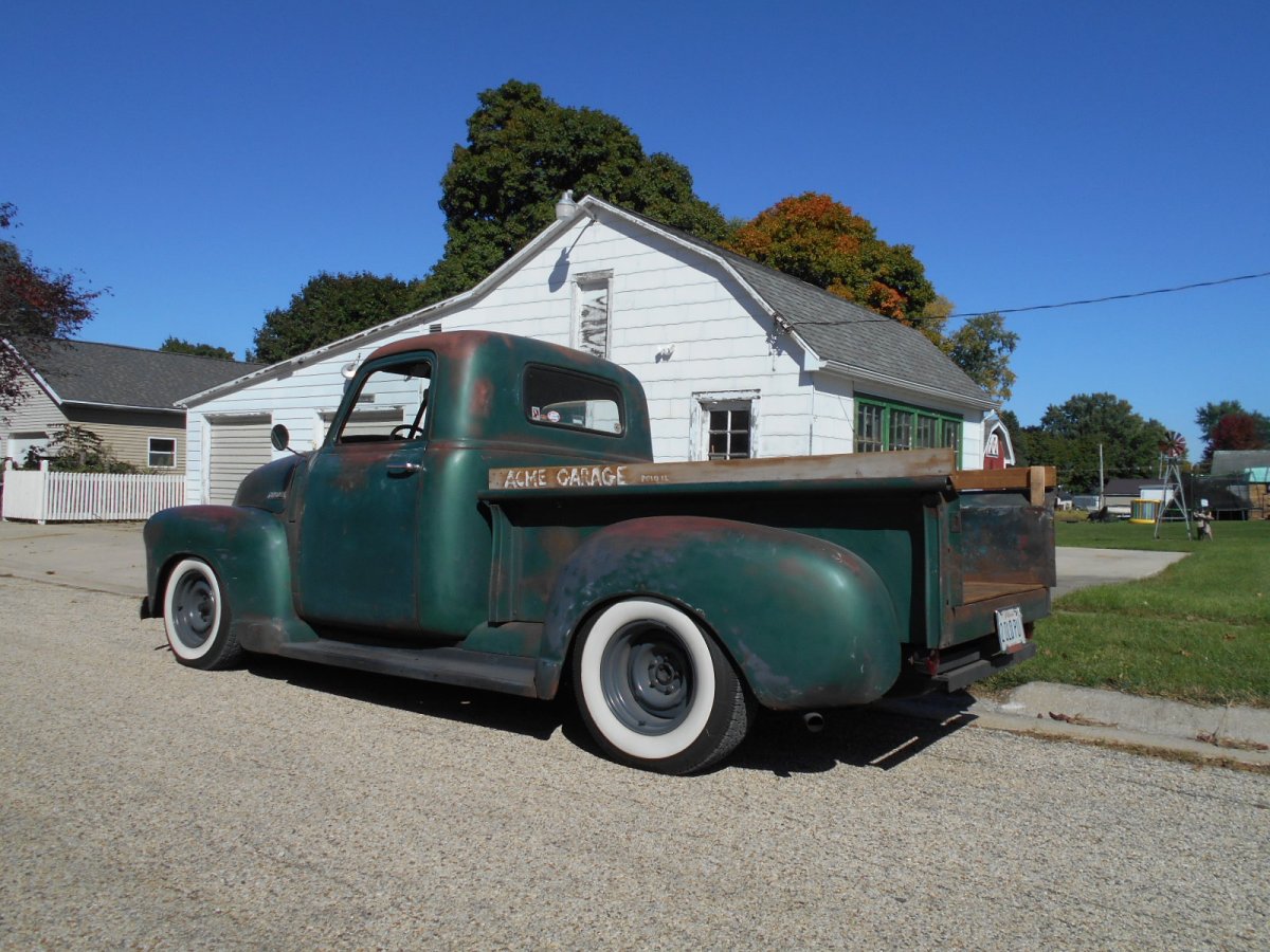

    ...finally the snow & ice melted away so I got my 47 pickup out for a drive after being locked in for 3-4 moths,..beautiful day yesterday.

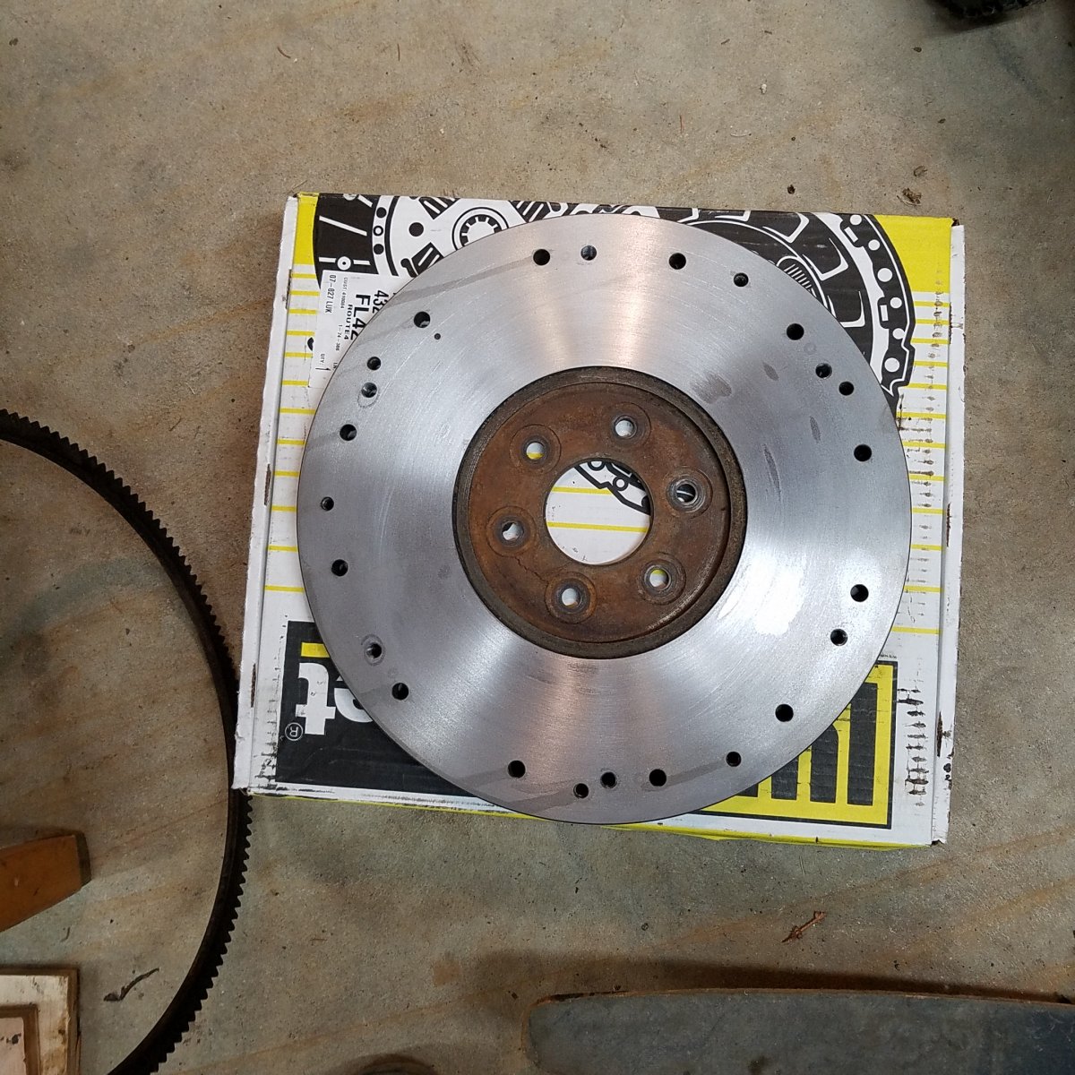

    Also played around with a lathe to resurface and drill my flywheel to accept a 11" clutch and diaphram pressure plate to replace the Ford long style for a nice easy pedal. 20210320_194731.jpg

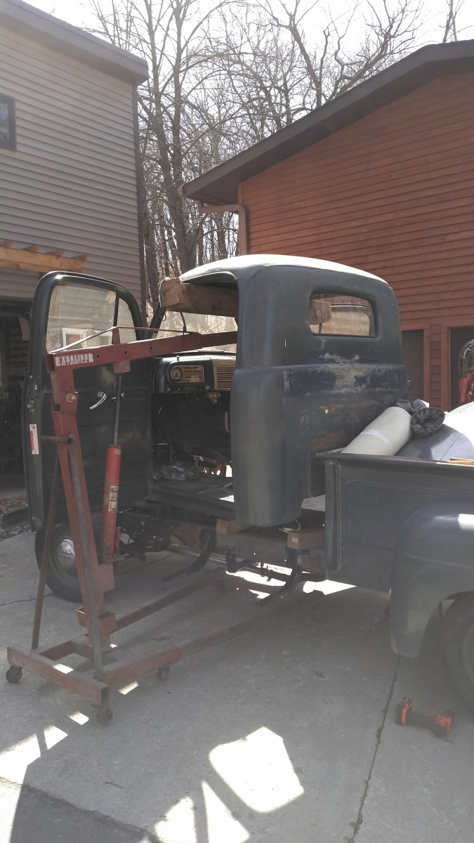

    Pulled the cab off. We painted the frame from the cab back last year. Time to finish the front half. KIMG0553.JPG KIMG0555.JPG KIMG0556.JPG

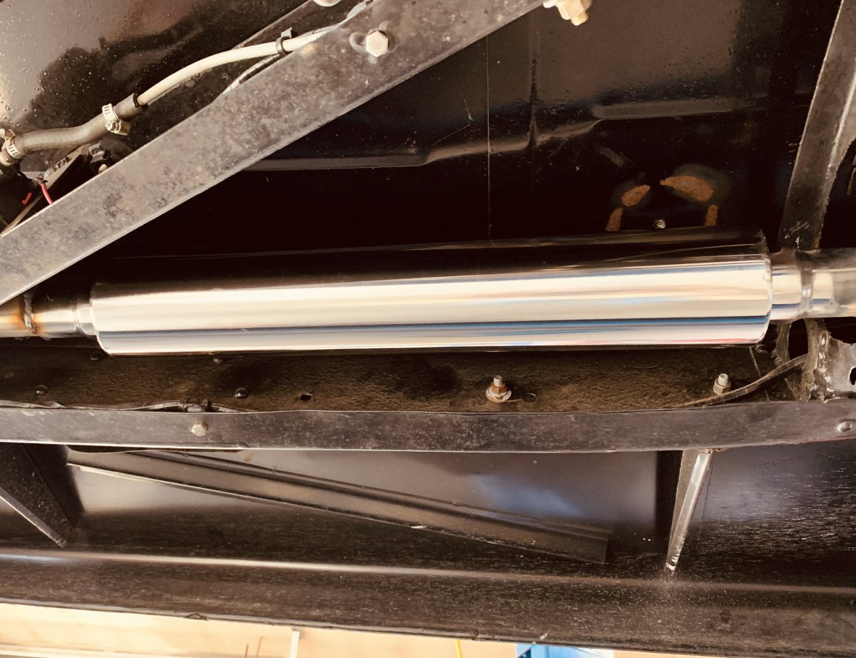

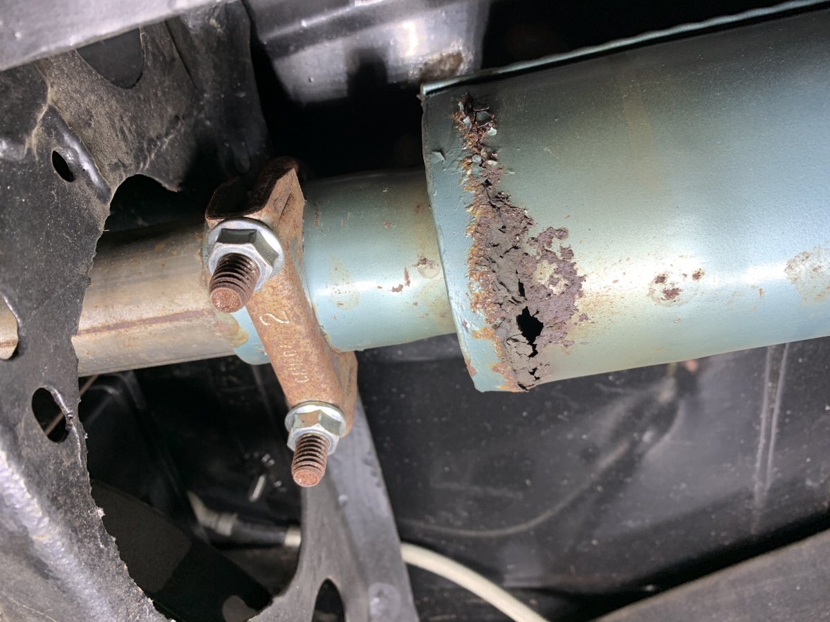

    Finally got around to replacing the old rusty Smitty mufflers with new Porters stainless. They look great and sound great. Threw on some stainless V8 embossed deflectors while I was at it.

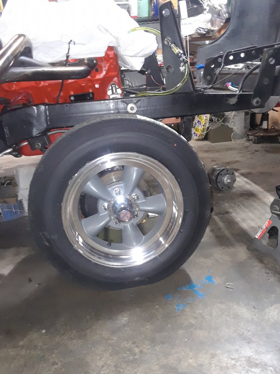

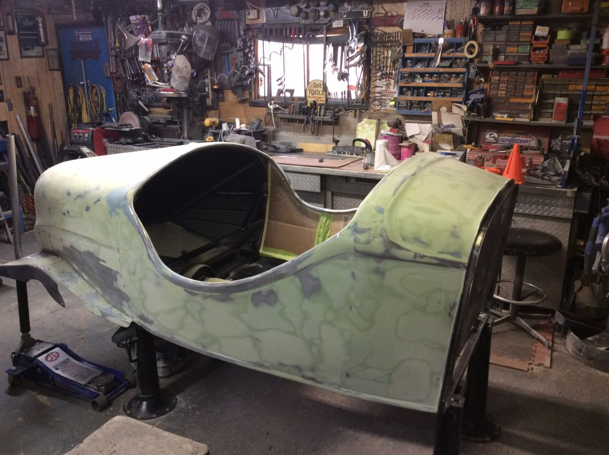

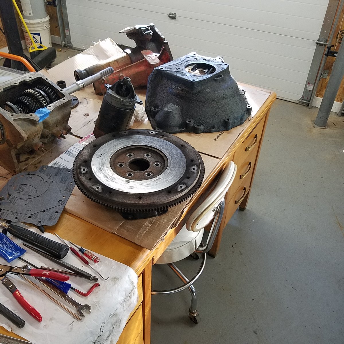

    March 25th 2021 Need to free up the engine hoist by getting the 302 Jimmy to a better storage location than on its side in the middle of the floor. It's current position is a good one for access to the clutch, however, so I decided to try to extract the clutch before moving the engine. I want to find out if the Hays clutch will fit the nailhead flywheel and Trans-Dapt HC-25 Adapter bellhousing.
    Turned out to be easier than I anticipated. It was out and on the workbench in about fifteen minutes. The Hays 11" Street/Strip pressure plate mounting circle pattern is about 1/4" too big and the flywheel will have to be re-drilled if I use the Hays clutch. It looks like it will work but drilling a flywheel is beyond my experience and I need some Deep Ponder Mode musing on this.
    Good news is that the Jimmy's ball pivot for the throw-out bearing fork is a direct bolt-in for the Trans-Dapt bellhousing. Beer of the day was Wooden Cask Brewing Company's The Scotchman Scotch Ale.

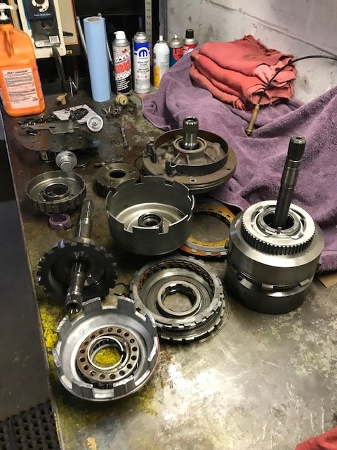

    Doing a Turbo 350 for a good friend.

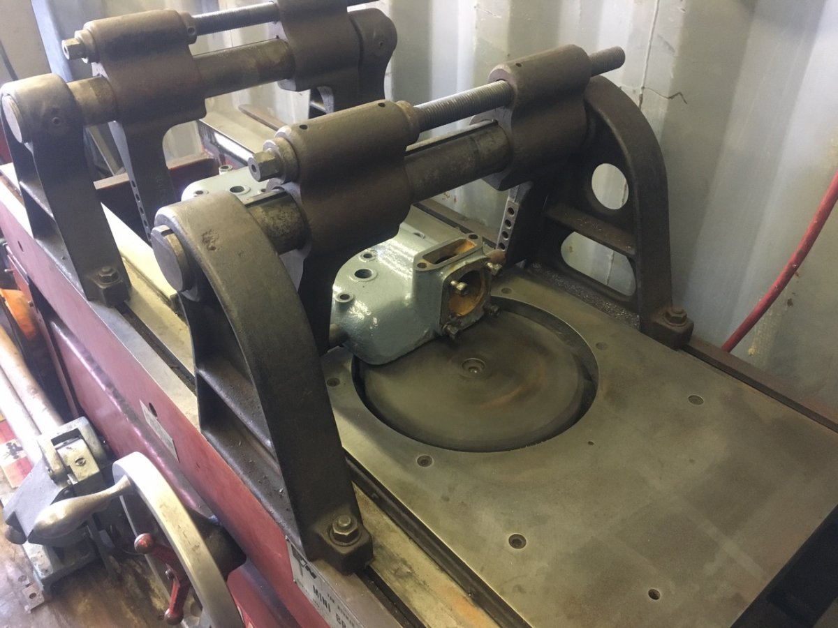

    Took a cut on a banger head for a friend. Been awhile since I had this machine running. IMG_2656.JPG

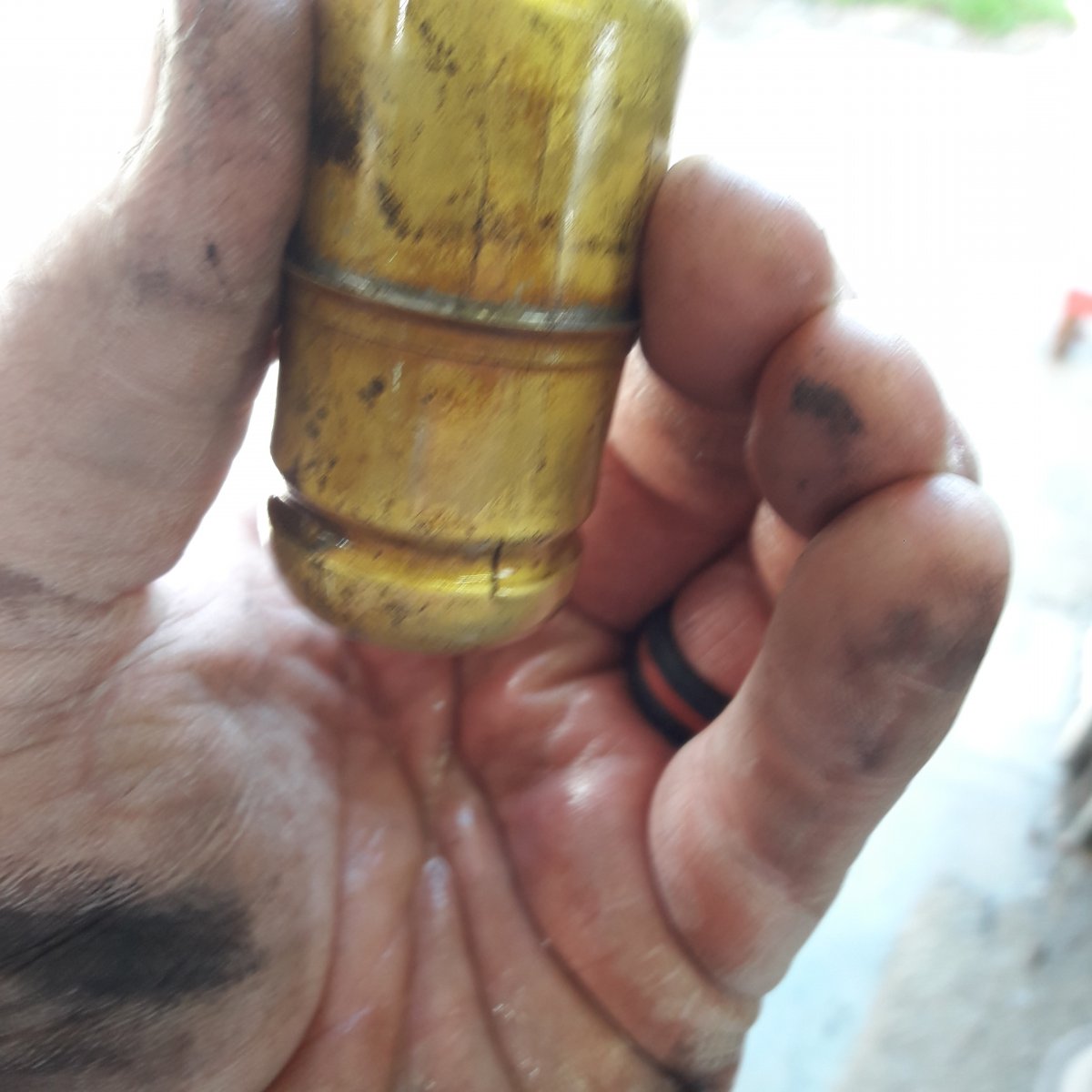

    Cussed it, rubbed on it, cussed it some more, started it, smiled at it, then fixed the gas gauge. All the gas is running out of the float! Need some stop leak! 20210326_171256.jpg
