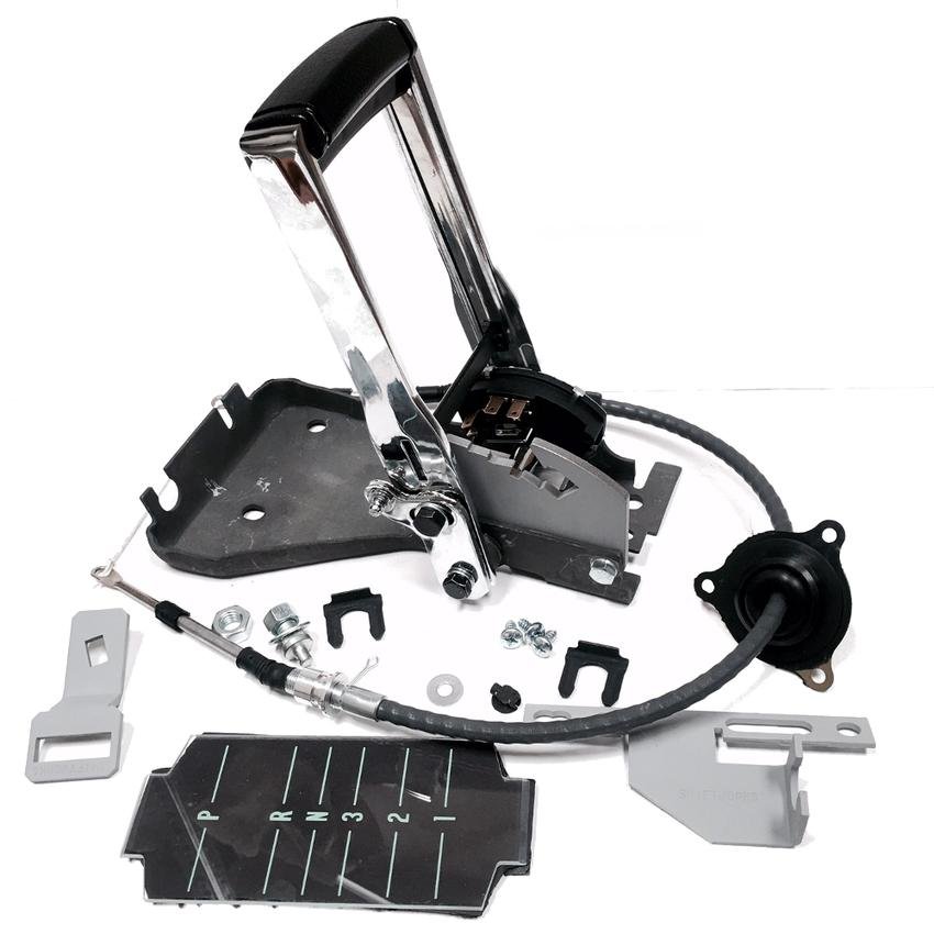

    Any idea if a GM shifter like this would work with a Ford trans SW1001-R_850x.jpeg

    Probably the only thing you may have to modify is the shifter arm on the trans. The pivot points need to be the right length so the detents in the trans match the detents on the shifter. That and how the cable connects. You might be able to change the detents on the shifter with a Dremel, but I think modifying the shift arm is a whole lot easier. Love those shifters.

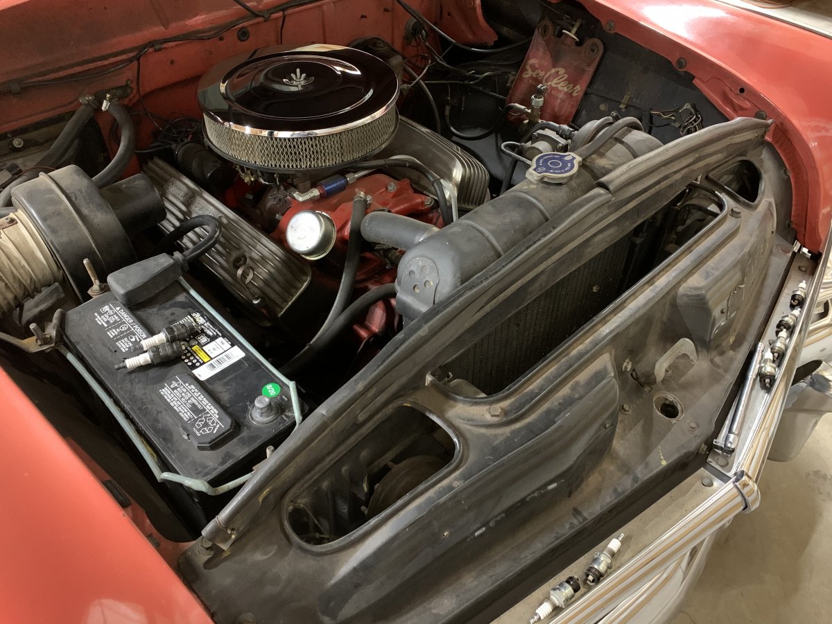

    Decided to change plugs and check the ol’ girl over before heading up to Springfield, MO for the SWMO Hot Rod Hundred next weekend. Looking forward to a road trip and hanging out with lots of great friends up there. Always a great time!

    Concur with X, don't know GM shifters but Hurst ratchets require modification to transmission arm on C6. Cable attachment there is similar to what you have.

    Seems pretty straight forward and the repos are cheap

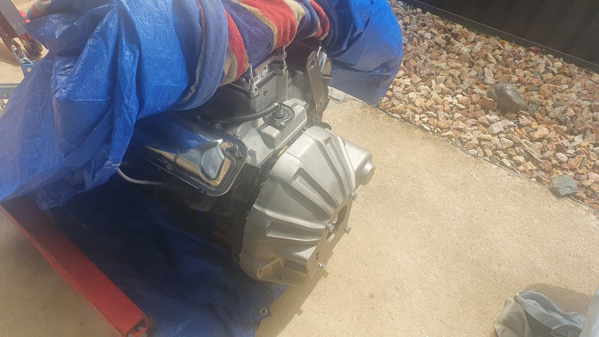

    I m***aged tunnel to provide additional clearance for period correct [Thicker cast] NHRA bellhousing and hand polished it when done. I used a heavy lump hammer with rubber cover to reduce any damage; it worked a treat. Steady steady wins the race. Engine installed now with minimal interference. Had a new nylon lower column bearing machined, it's next to be installed.
    I installed the engine, damn tight fit with bellhousing attached, and trimmed the apron panels to allow heat to escape as per OEM Thunderbolts, all I need to do now is relocate the brake lines and reposition junction block. Binding around edges tidy them up. NHRA required that Ford relocate line from firewall in case of a clutch explosion.

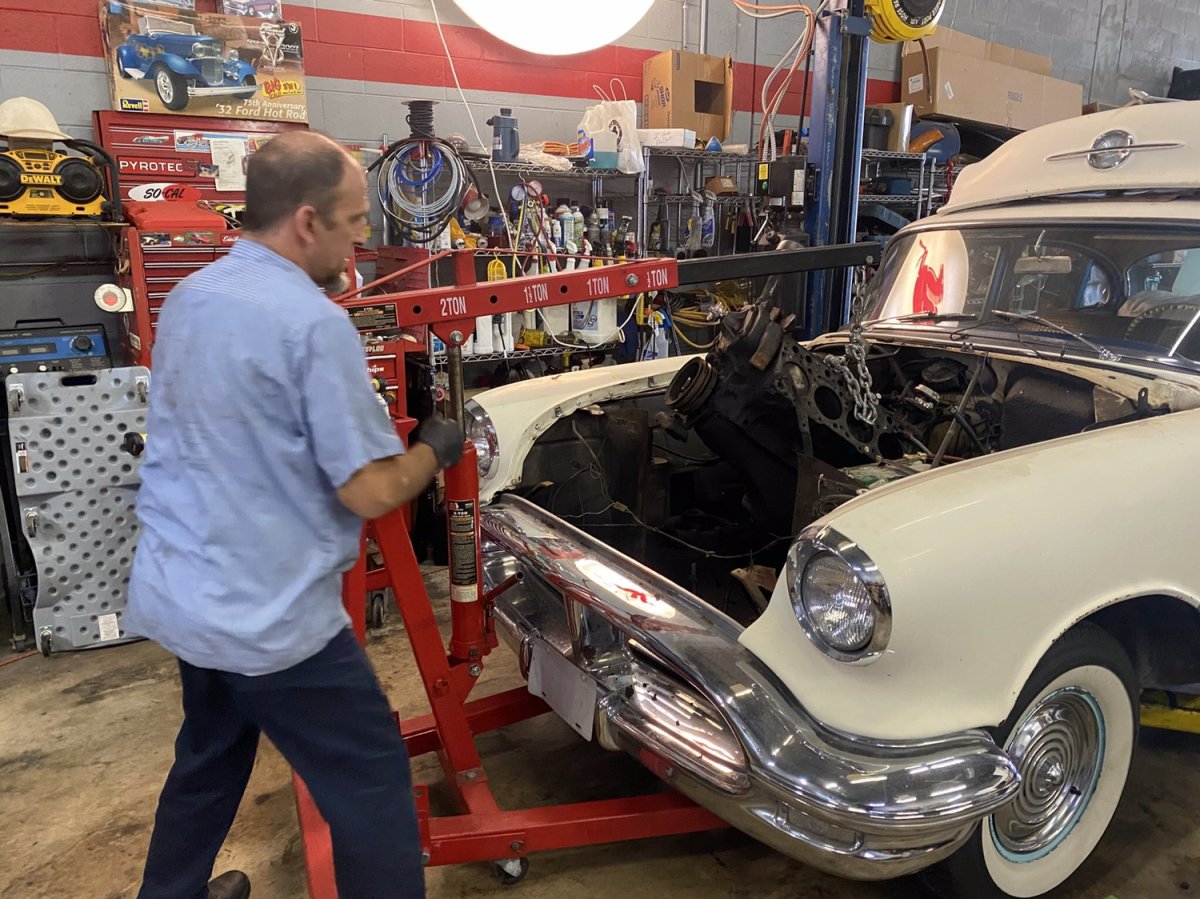

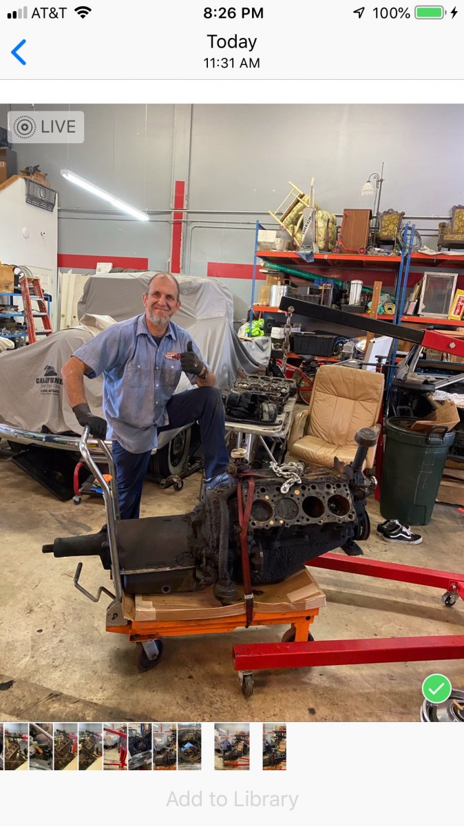

    Look at the size of that Hydro!!! I did a couple of Pontiacs with that transmission, it is a brute but they run so nice...

    I recall that the flattie 6 & cast iron hydro from my 46 Olds weighed a ton when I did the same, I can imagine the additional 2 x cylinders would be damn heavy!:D

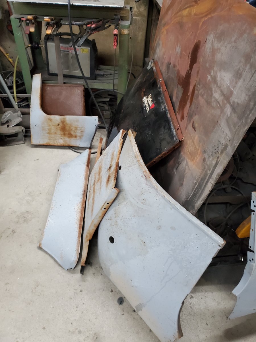

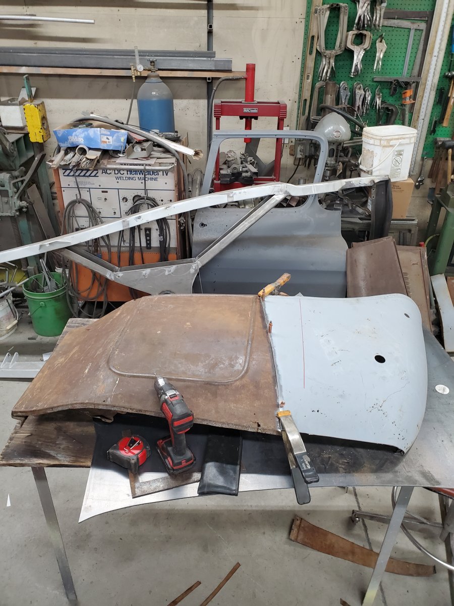

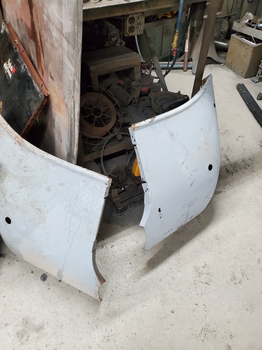

    I got to "help" a metal wizard (@Clark ) work his magic on my pile of 100 year old tin.
    Thanks Clark.
