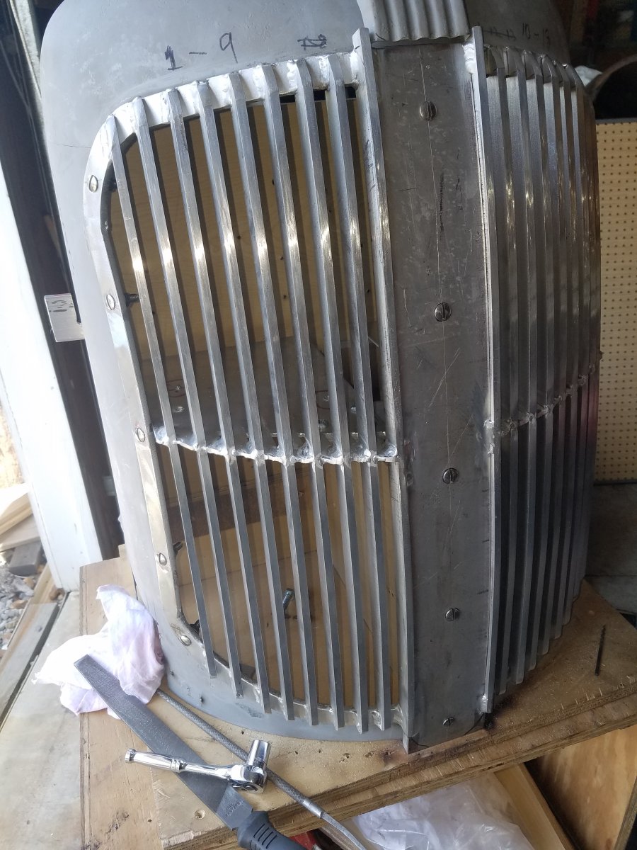

    Did a little more filling of the fender and inner panel where I wacked it out to fit the grille. At least till the welder bit the dust. Looks like I need to extend the lower edge of the hood a little. Next project lower the right hood hinge and fender. Hopefully by then the Amazon fairy will have dropped off a new Lincoln 140 at my friend's house. I thought I might bring one of my welders up here; but didn't want to have to change the plug. IMG_20210419_170829.jpeg IMG_20210419_171158.jpeg IMG_20210419_171303.jpeg

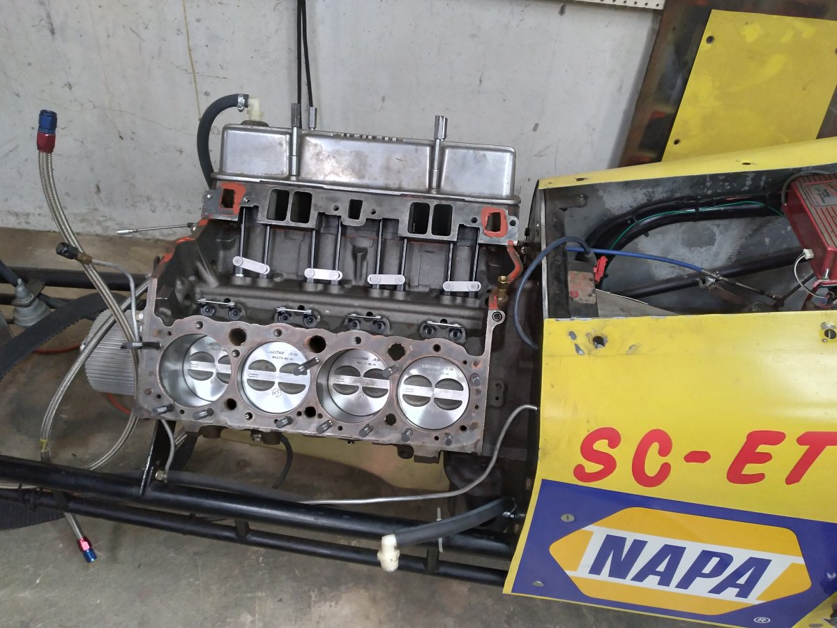

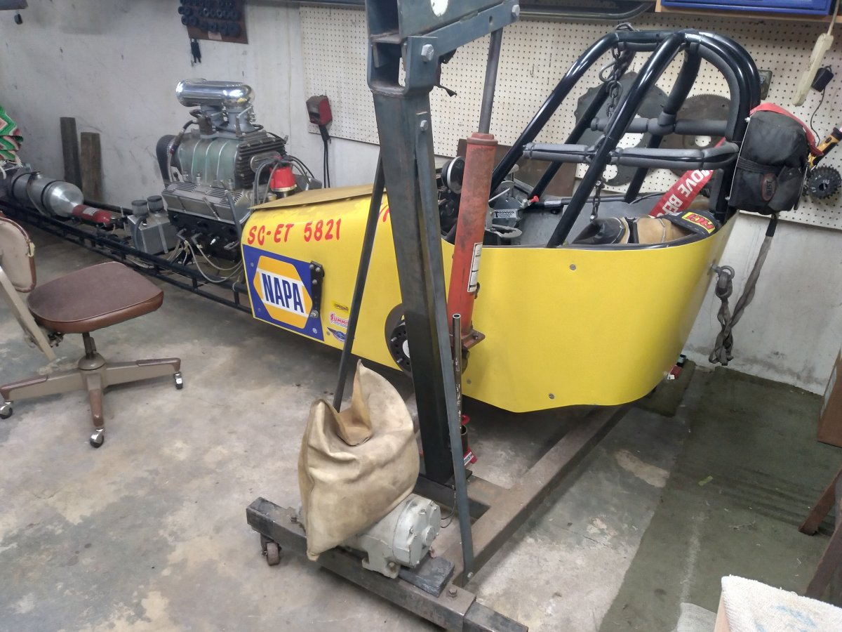

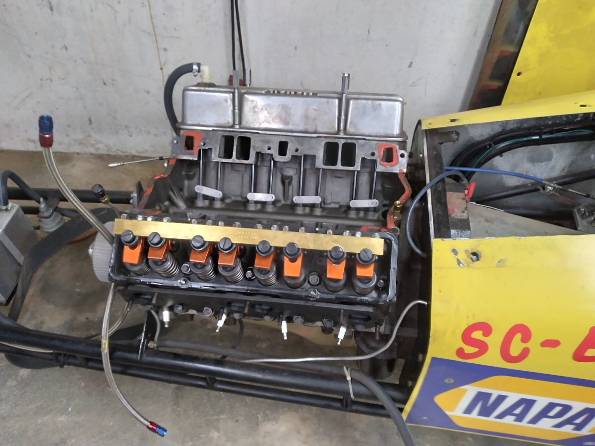

    For once I spent some time on "MY CAR"
    Got my dragster pulled out so I can dive into the engine and see what it is made of. Don't know much about what's inside and thought that being I plan on driving it I wanted to know how low in the seat I will need to be. :eek: :D
    So far so good, Bowtie block and world product heads. :)

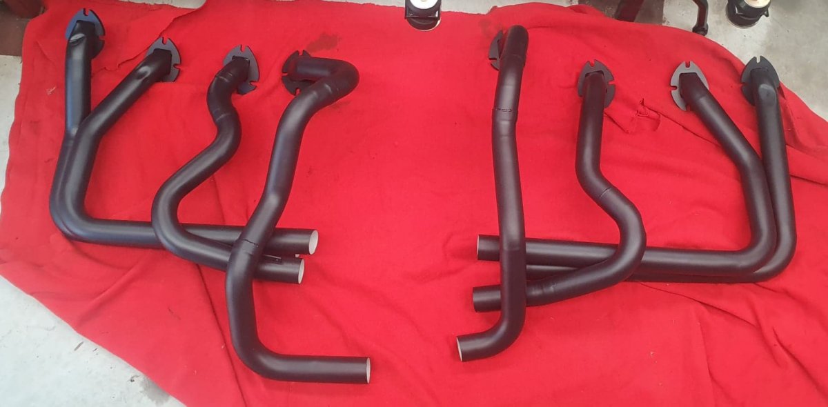

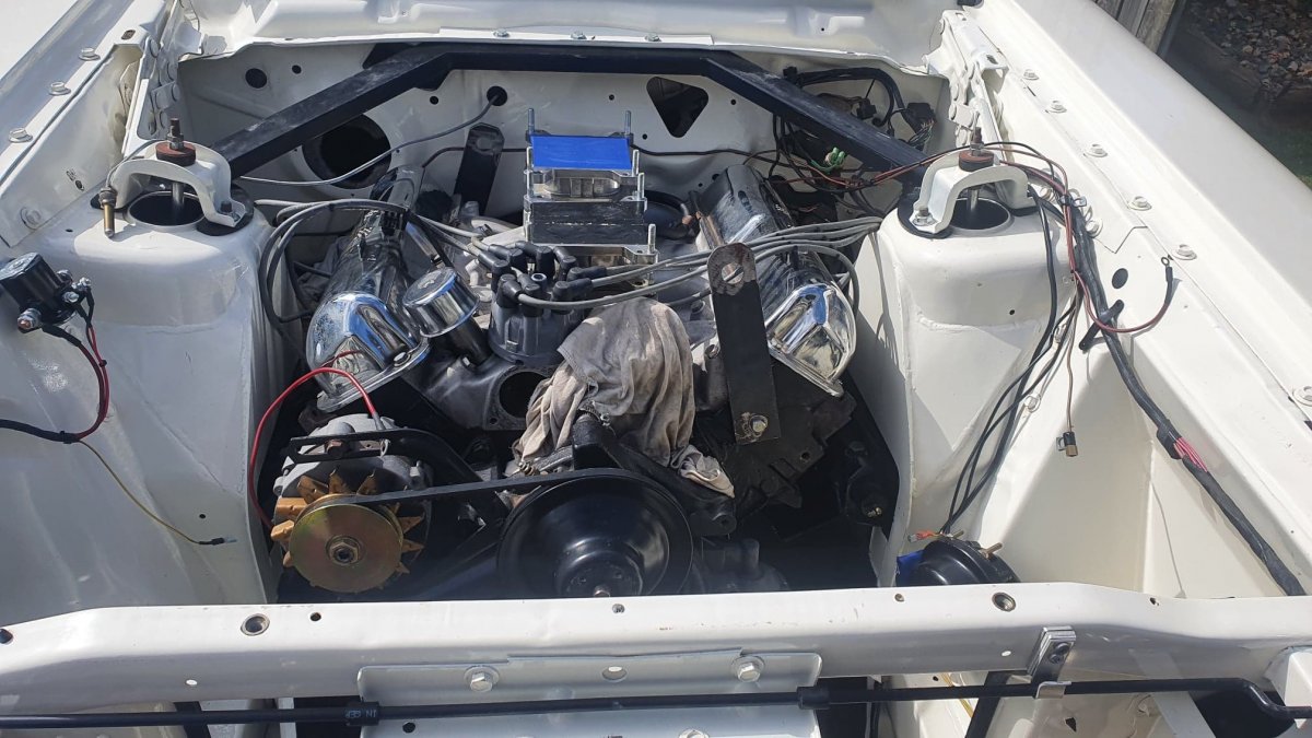

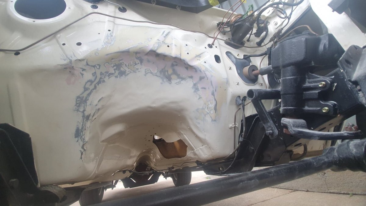

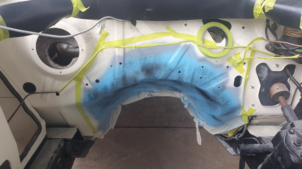

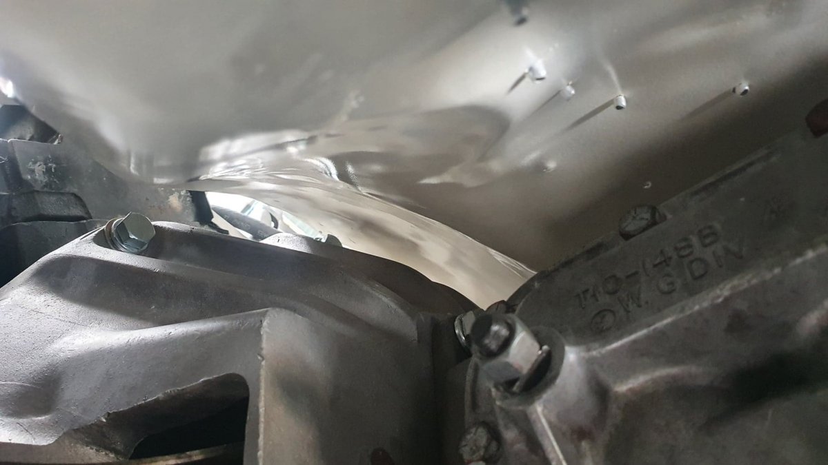

    Finished firewall/tunnel m***aging with a rubber covered BFH to allow fitment of period correct RC Ind bellhousing (****tershield). I had some paint matched before I repainted reworked areas. Engine reinstalled and now re***embly time with newly coated headers and collectors. Next thing is to make and reroute new brake lines. 177378945_322277912641783_8752889990660240379_n.jpg
    175540619_788715055103690_5108705616712080899_n.jpg 174007233_1639394059584324_8806370805413091887_n.jpg

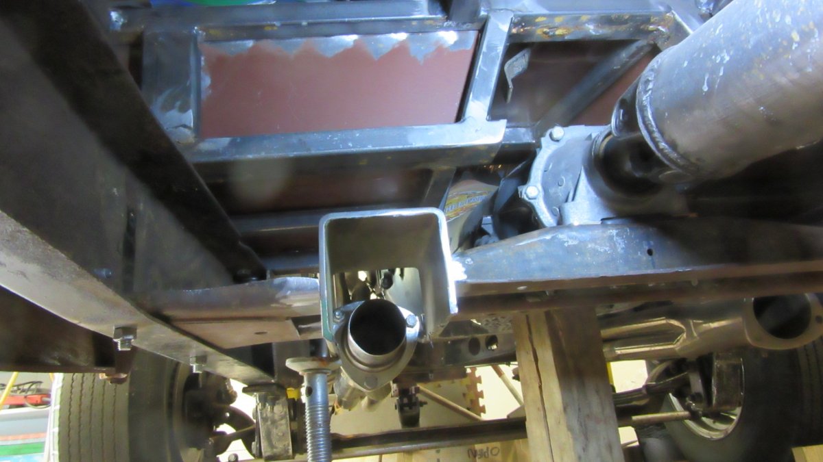

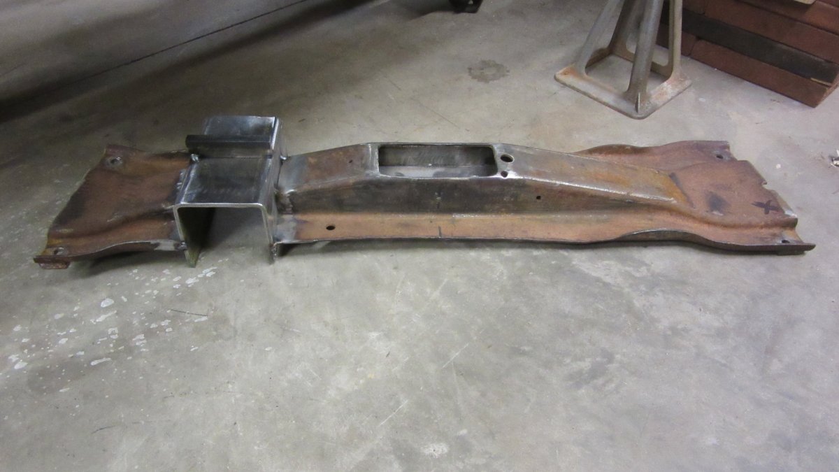

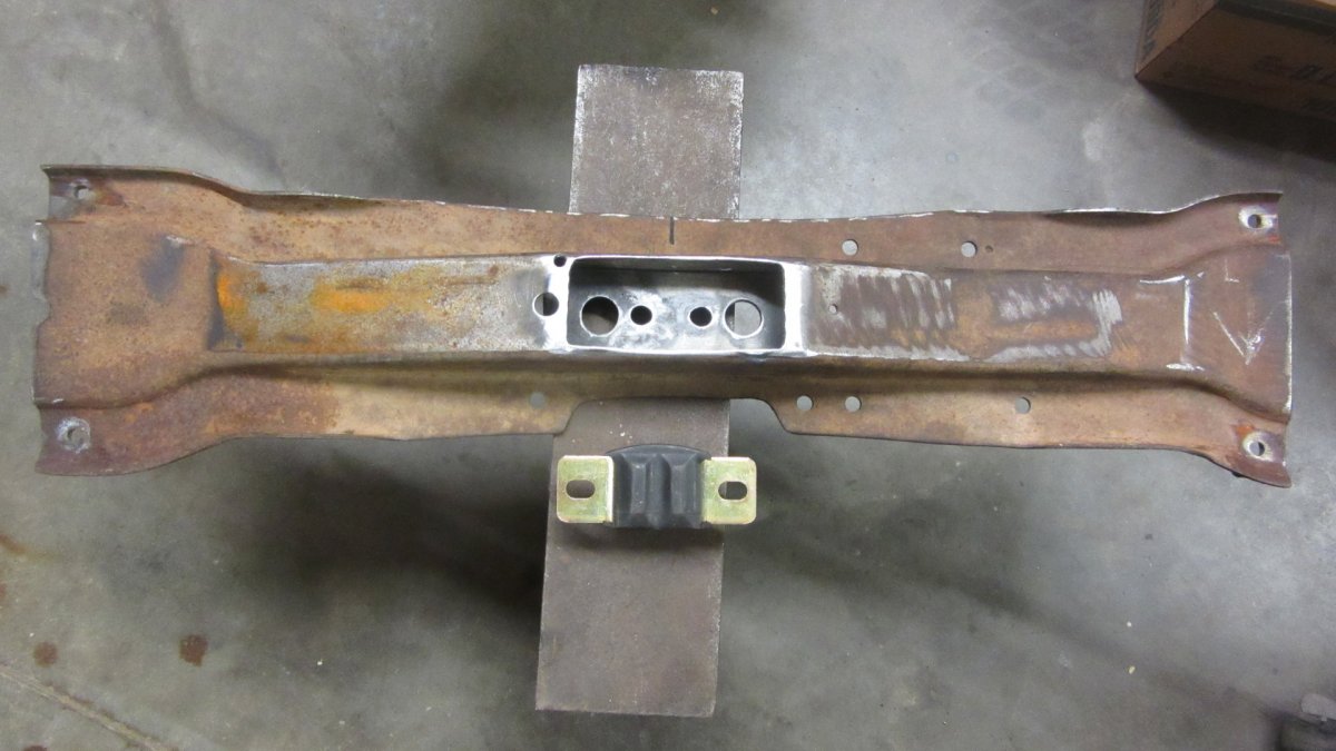

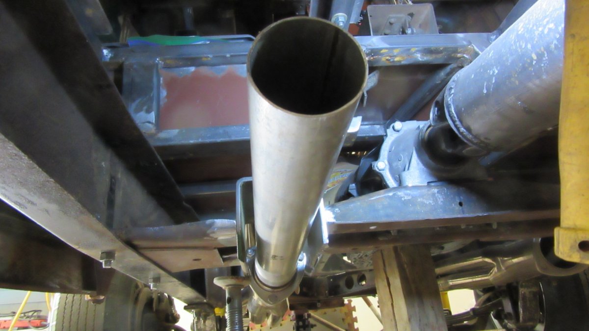

    I have been working on the crossmember making room for the exhaust, it has a ways to go but I have a good start on it. studebaker build 009.JPG studebaker build 001.JPG studebaker build 003.JPG

    Looking good but I've got a question. Are you planning to add box plates to the bottom of the original crossmember on both sides of your new channel section?

    The plan is to use some 1/4 or 5/16 plate and make a semi - circle and tie it to the original crossmember and to the piece of tubing . Then I can cut that out for the pipe to clear. Like you noticed it will need something to keep it from bending in the center of that channel I added. The crossmember will also carry the driveshaft loop . I have a piece of 1 in. channel tacked across the top now as a stiffener will I work it all out. I could also weld a couple pieces of flat stock turned on edge across the top , good observation though ! Thanks
