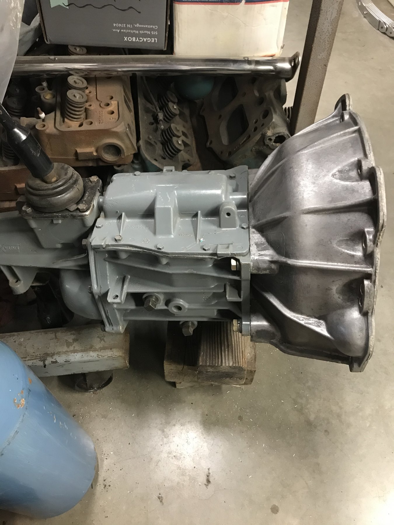

    I took the first step towards putting a T5 behind the 215 Buick in my Morris woody. I found a factory bellhousing at the March Meet swap meet for a reasonable price. I gave it a quick cleaning and bolted it to my trans so I can take some measurements of the critical dimensions.
    Now I’ve gotta find a fork, flywheel and clutch****embly.

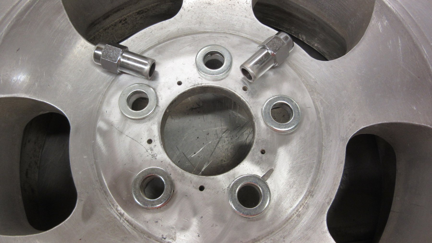

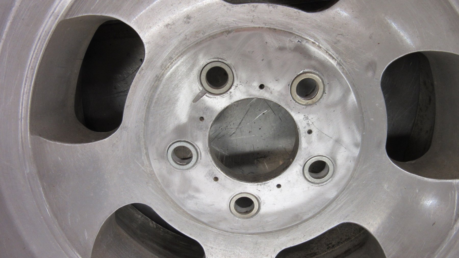

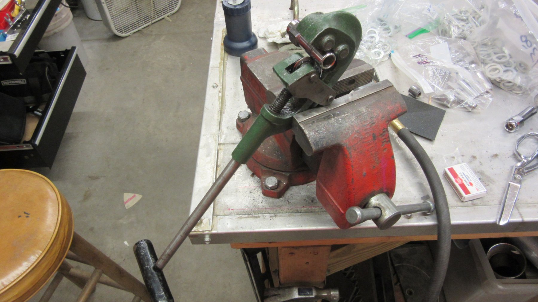

    I have a pair of 15 x 8 Fenton wheels that I am using on the rear. So I cleaned the bolt holes up and had some washers to fit the recess in the wheel. I have to use an open end lug nut so I cut some Cragar Super Trick lugs down to size and added a nice heavy washer so they are good to go. View attachment 5081257 studebaker build 007.JPG studebaker build 009.JPG studebaker build 011.JPG studebaker build 012.JPG

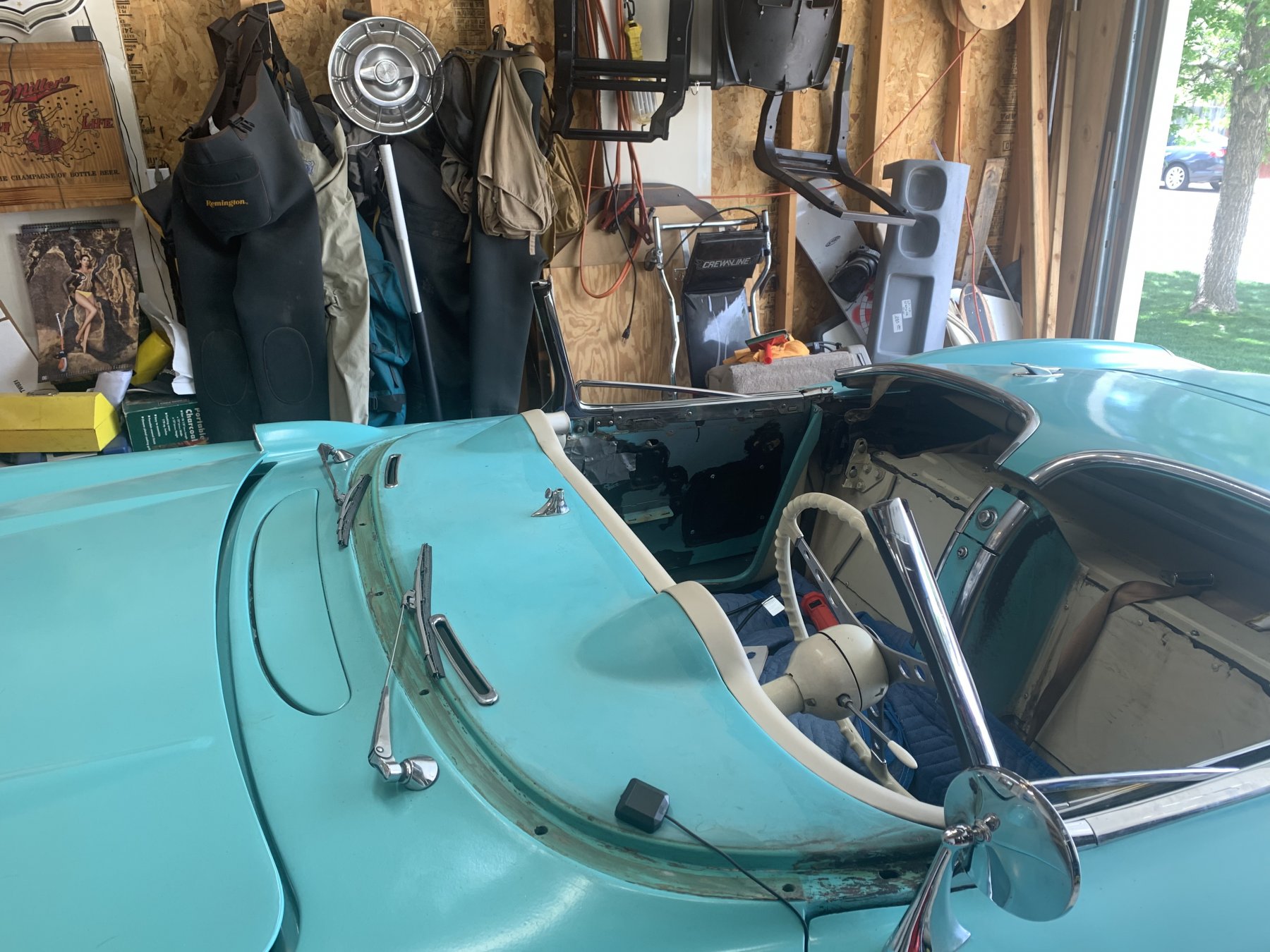

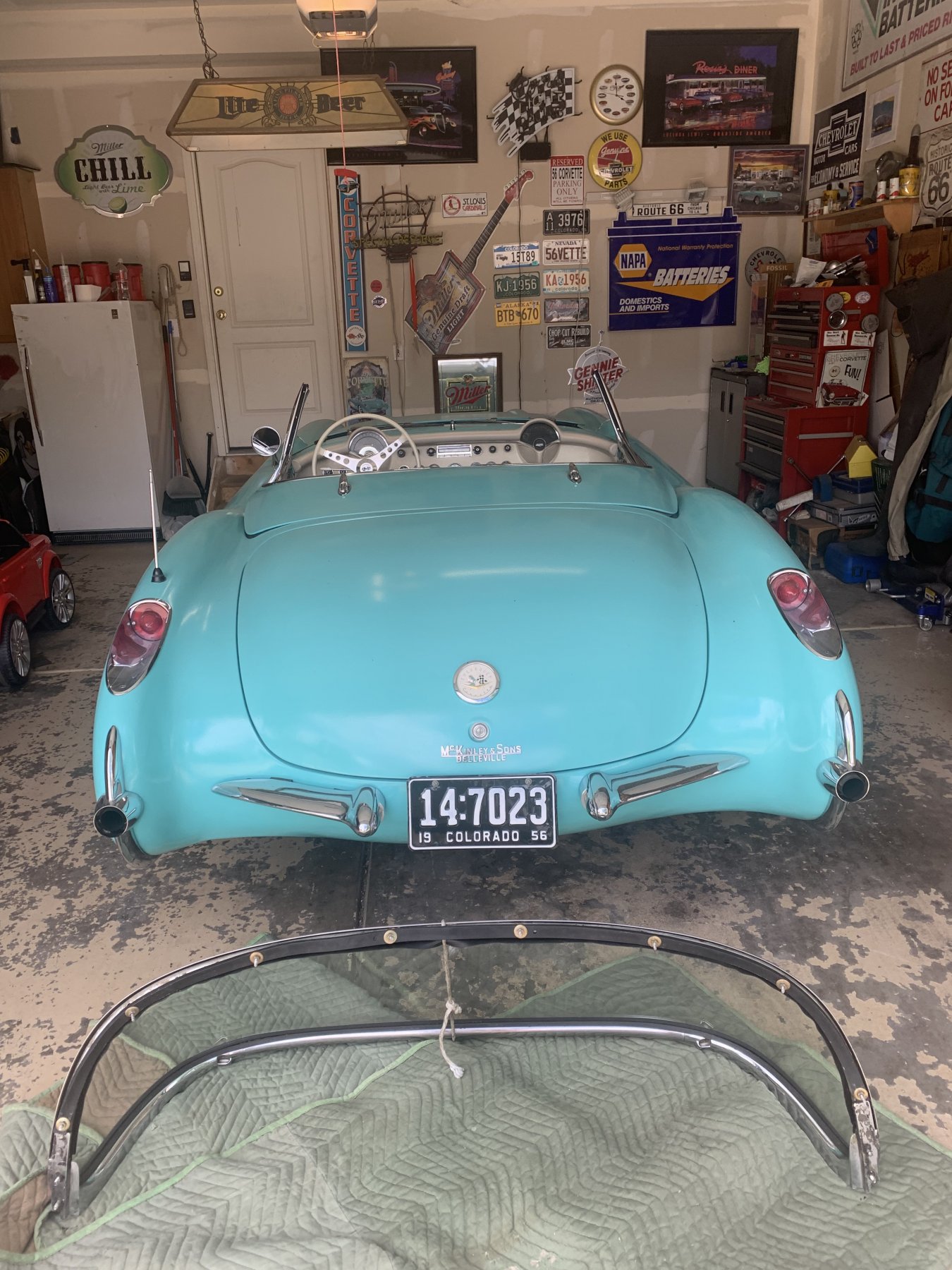

    Got the new windshield set back in place on the Corvette with the new base gasket. I also ran a good bead of 3M Auto Bedding and Glazing Compound. I had to throw in the towel on getting some of the mounting bolts cinched up, I was getting real mad. The bolts 4 closest to the doors are a real b..ch, no room at all on the back ones. Well tomorrow is another day. 8638C338-1D86-4A46-80DF-8278D85BE5DA.jpeg 6C99158C-000F-44FE-B97B-83AE920ACE10.jpeg 38637E9D-68CA-4FAB-9CB8-C0BA542956BA.jpeg 1D1D447D-F7AE-43EE-ADB1-640A209806F2.jpeg EEE63B74-E7E2-4E28-AC94-E0EE3377F639.jpeg
