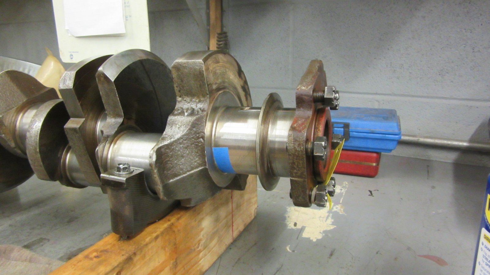

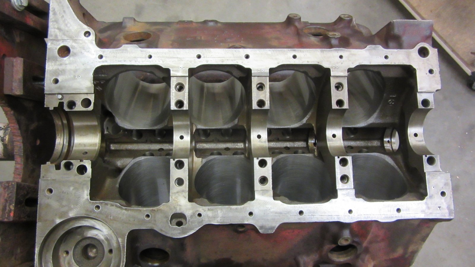

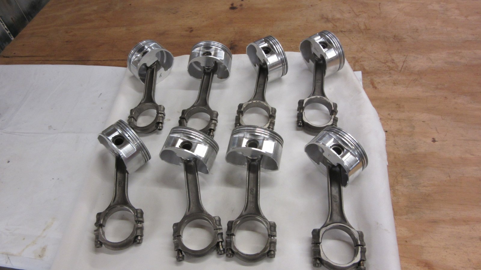

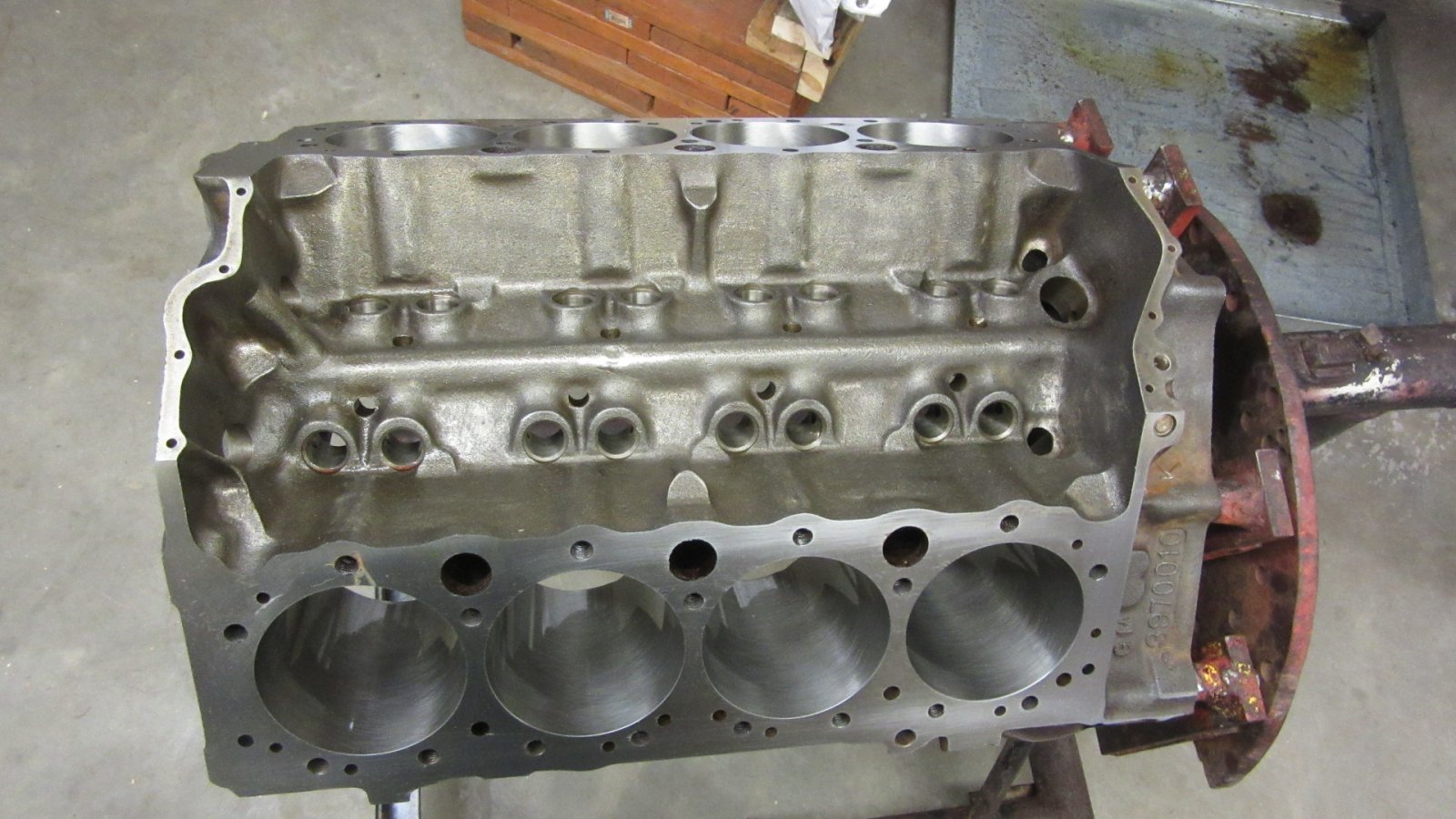

    I gave my block it's final wash. So this block was cleaned at home and it did take some time but I am happy with the results. I now have a nice seasoned 040 over 4 bolt block. All the internals are used parts from a no longer legal round track motor. I have been getting all the parts together and gathering up all the bolts and bits and pieces to put this thing together. In the theme of keeping this low budget to no budget project going forward I am doing all I can at home. I found a young guy who is setting up a machine shop at home so I let him bore/hone and take a clean up cut on the deck for $285.00 (cash) with a five day turn around time. One shop wanted $660.00 for the same job. So I opted for the cheaper route. I checked all the main cap journals and they all measured the same with no taper except the rear which was a little smaller. ( I have read that is pretty common) I have about .0025 of clearance on the mains which I am good with. But the crank has a little tight spot on each revolution. Anyhow long story short, after looking everything over the thrust journal of the crank has a little egg shape and taper on the front of that journal (blue tape in photo) hopefully my new found young machinist can help me correct this. The oil studebaker build 004.JPG studebaker build 009.JPG studebaker build 010.JPG studebaker build 021.JPG studebaker build 013.JPG studebaker build 001.JPG studebaker build 004.JPG

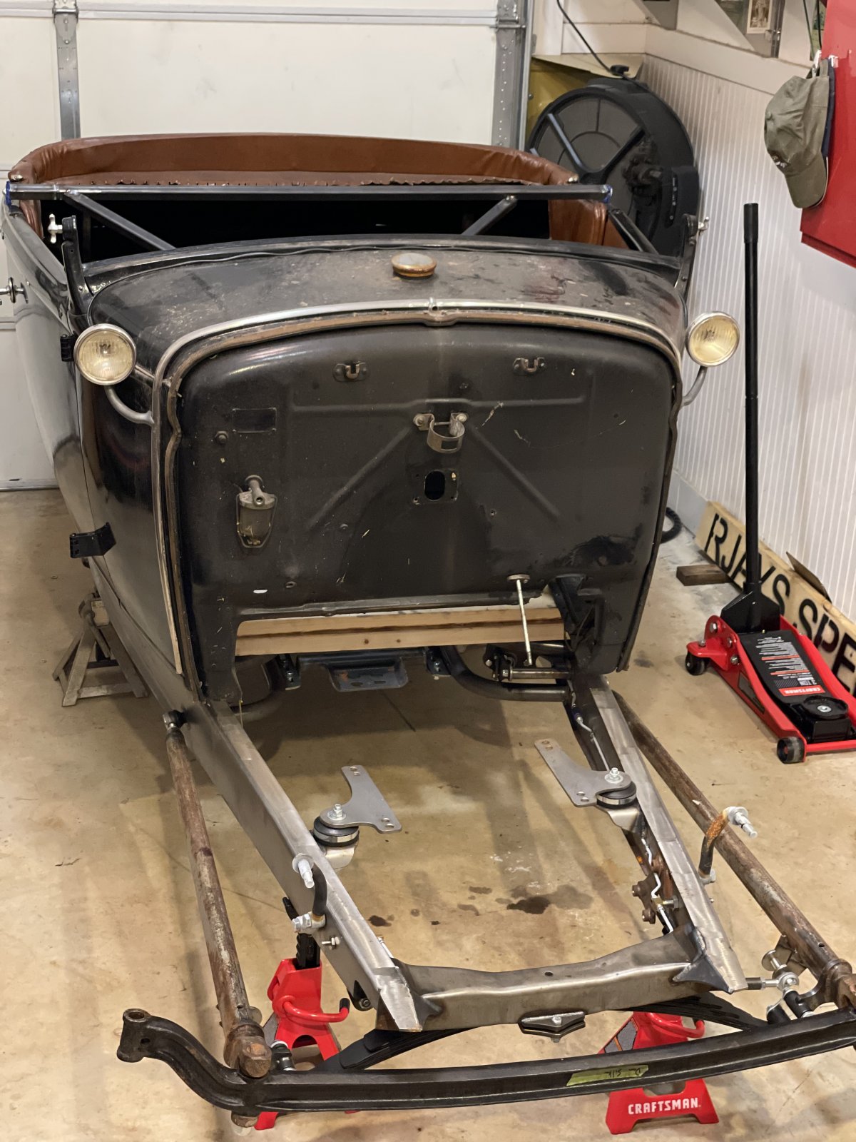

    I took my ‘31 roadster body off of its original frame and put it on its new pinched and bobbed ‘32 frame for the first time. Now it’s time to tackle getting that Steadfast rear subrail kit installed…

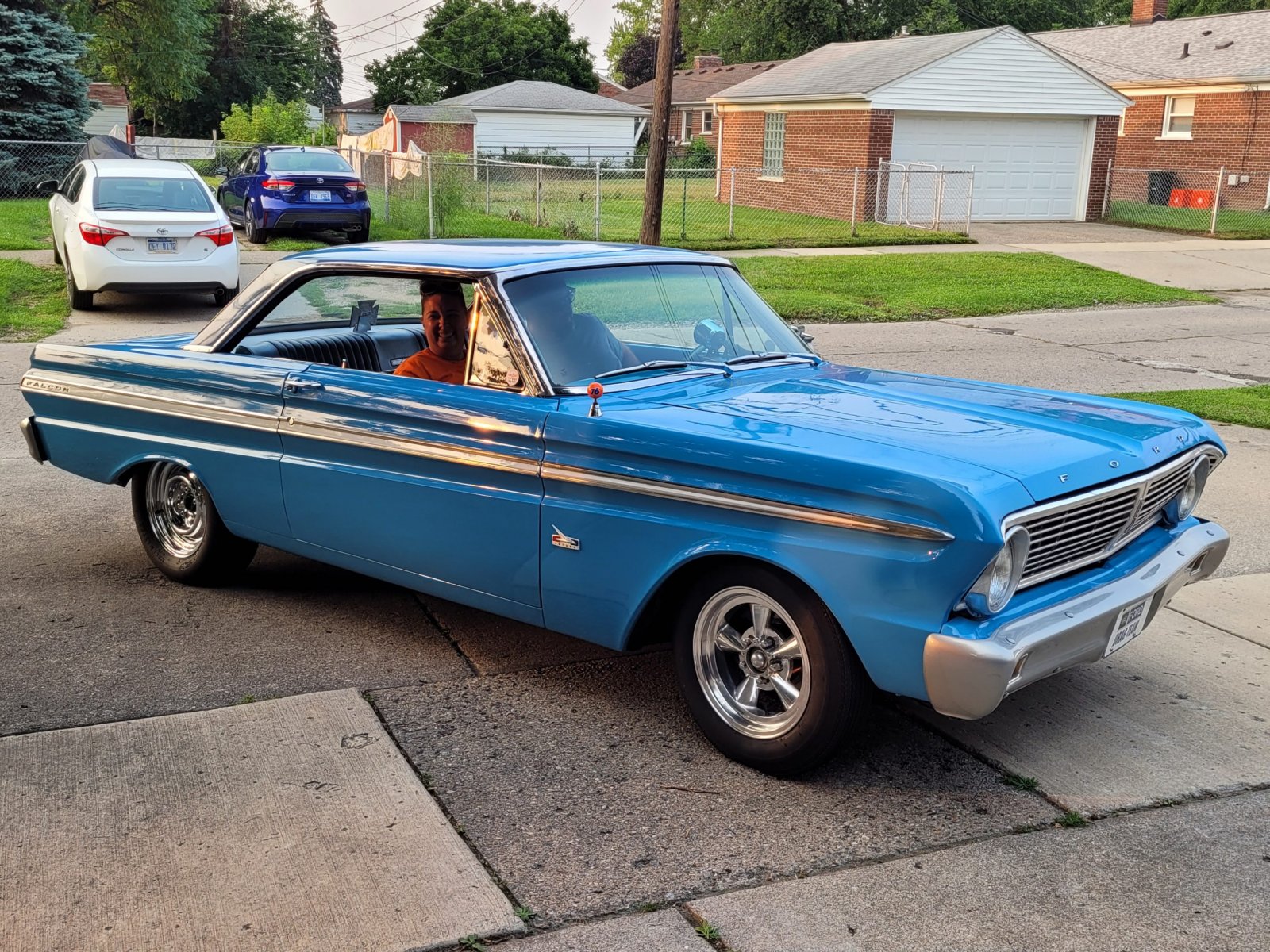

    432F5412-C468-43CC-867B-57CF5C23F0CA.jpeg 8F5D9373-18D5-434B-85B8-A19DD26C8810.jpeg Drove that *****…the car..not the Wife haha….running great..my dance to the break in Gods must have worked…just keep doing my shake down runs…so far , so good…
    Oh yeah I did get my kick panels dyed and put back in today..also got the hose clamp on the puke tank to work and hold fluid.

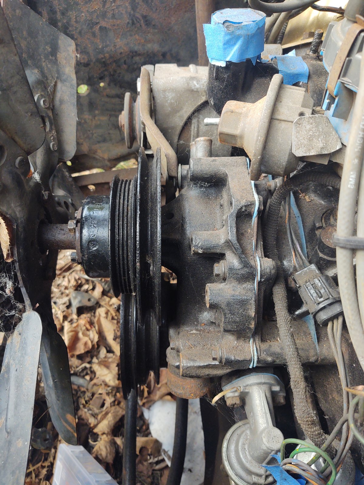

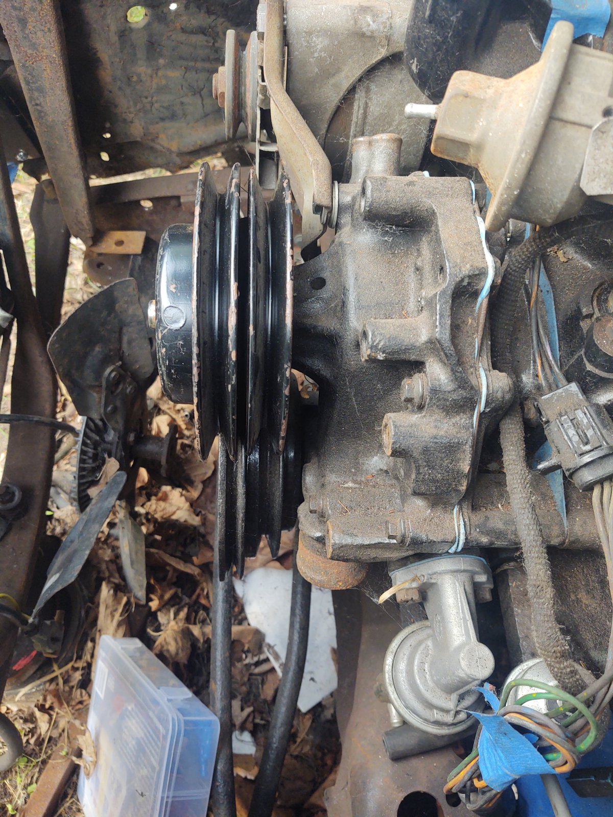

    I picked up this double v water pump pulley for my 351w. I put it on and it's about a half V's off. The pic with the fan and the serpentine pulley is what came with it IMG_20210719_081128934.jpg IMG_20210719_081950448.jpg

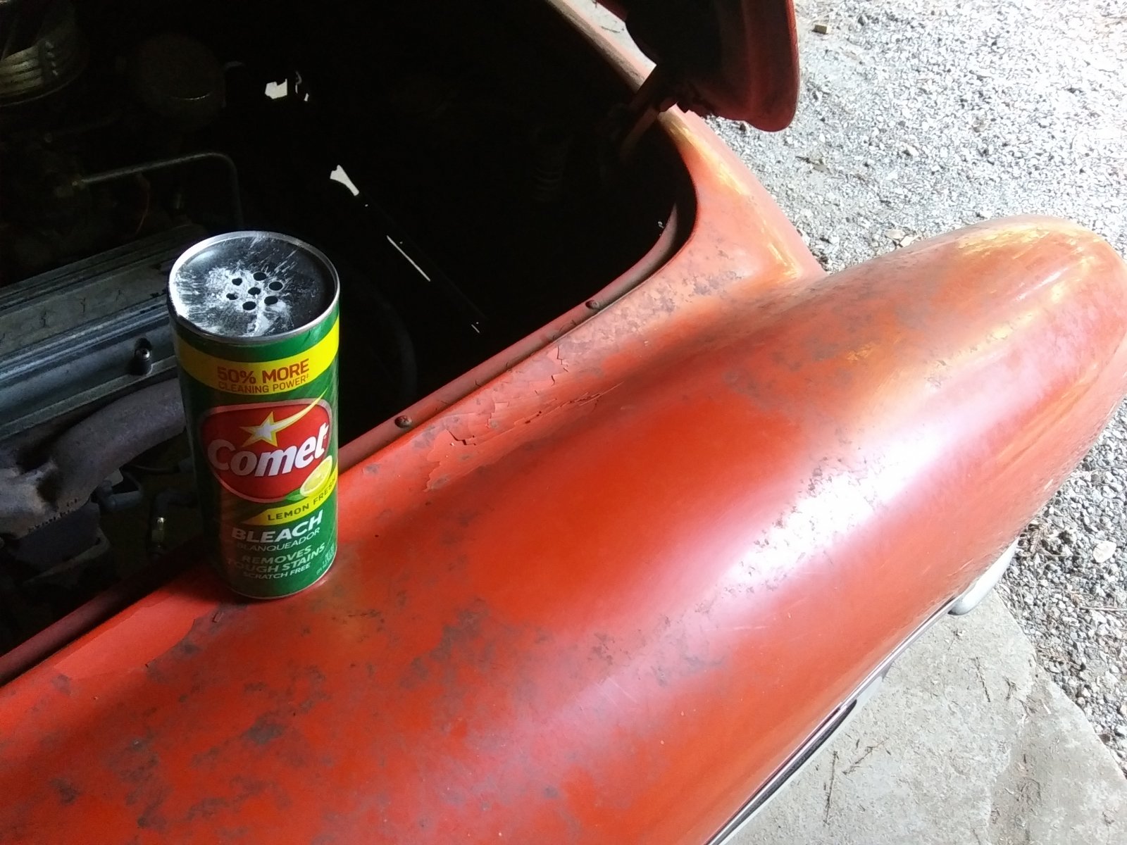

    Gave it a complete Comet scrub down. Still stains, chips, wear, and it's flat orange, or red I guess it's supposed to be, Venetian red. Anyway definitely a 20 footer at least but good enough for me 20210719_151142.jpg .

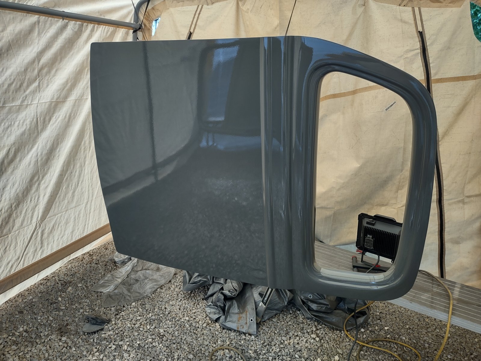

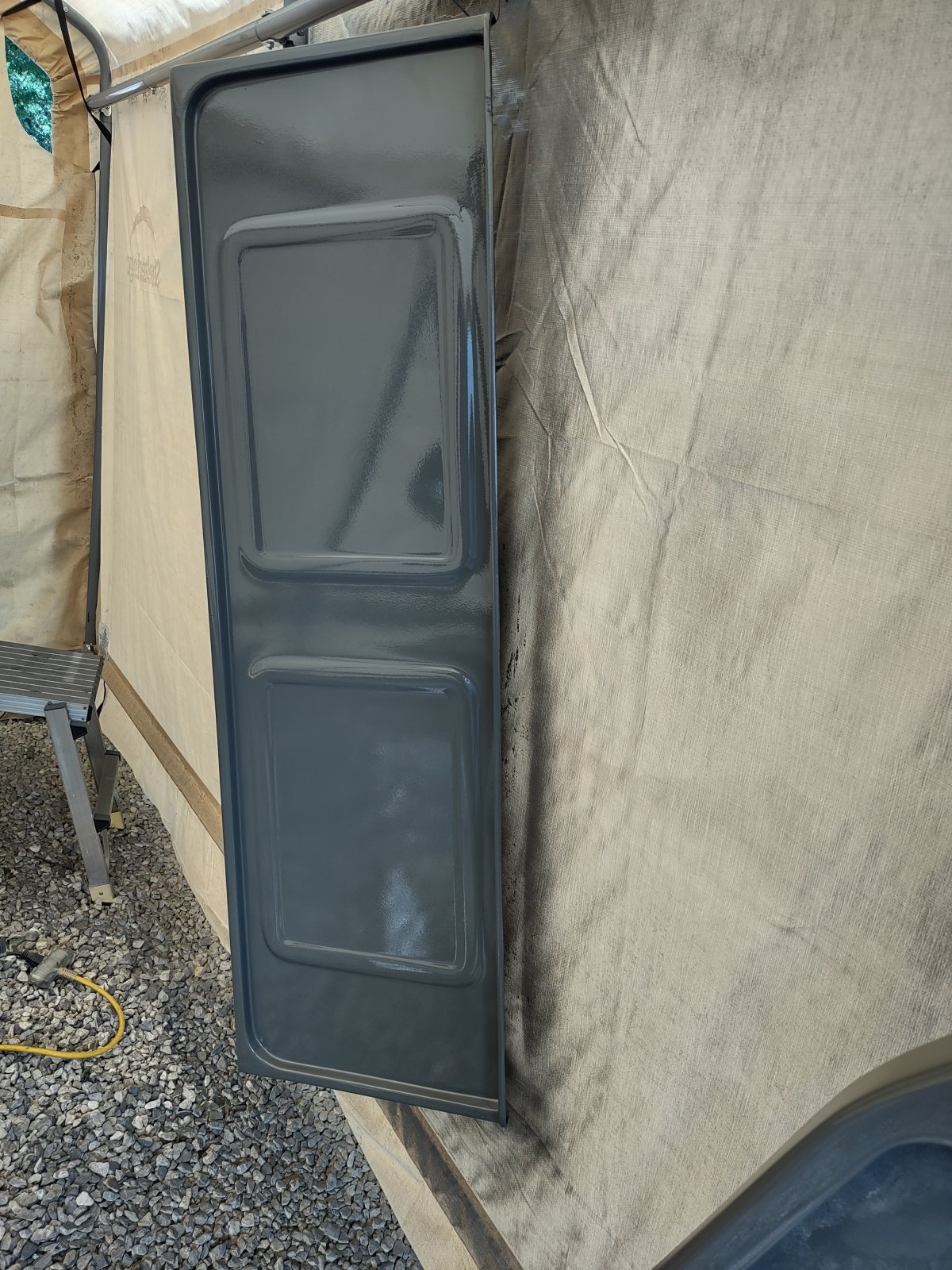

    Just got done painting the doors and dash and tailgate

    I using PPG Nason single stage urethane... I used urethane primer and sealer... with 3 coats of color...the last coat has another part of reducer.... I'm using a LPHV harbor freight gun... I put up a portable shelter and wet down the gravel ... keeps down the dust...lol. paint has flowed very well and has great gloss..
