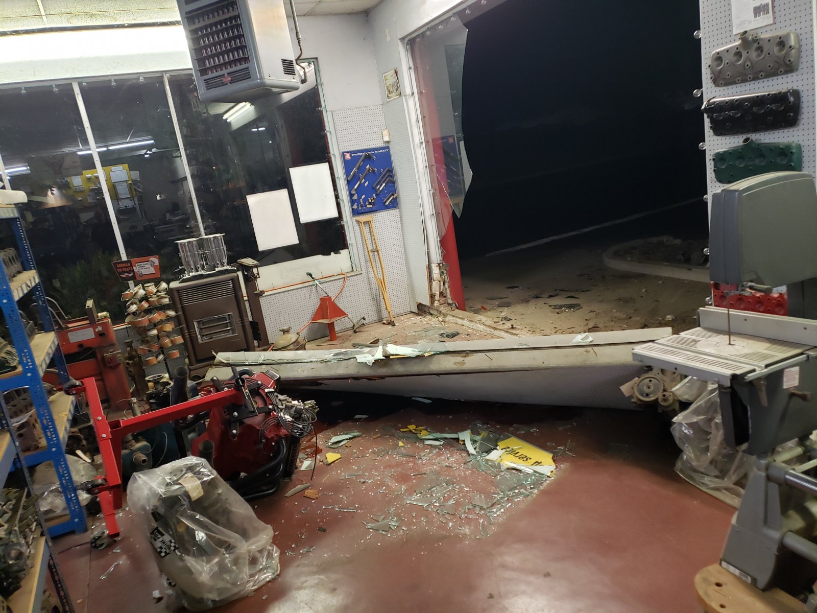

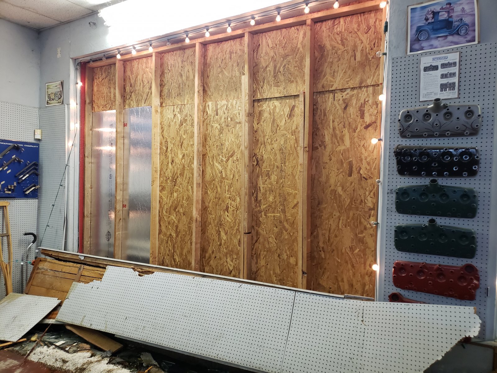

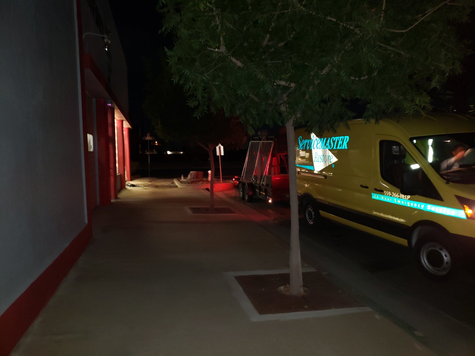

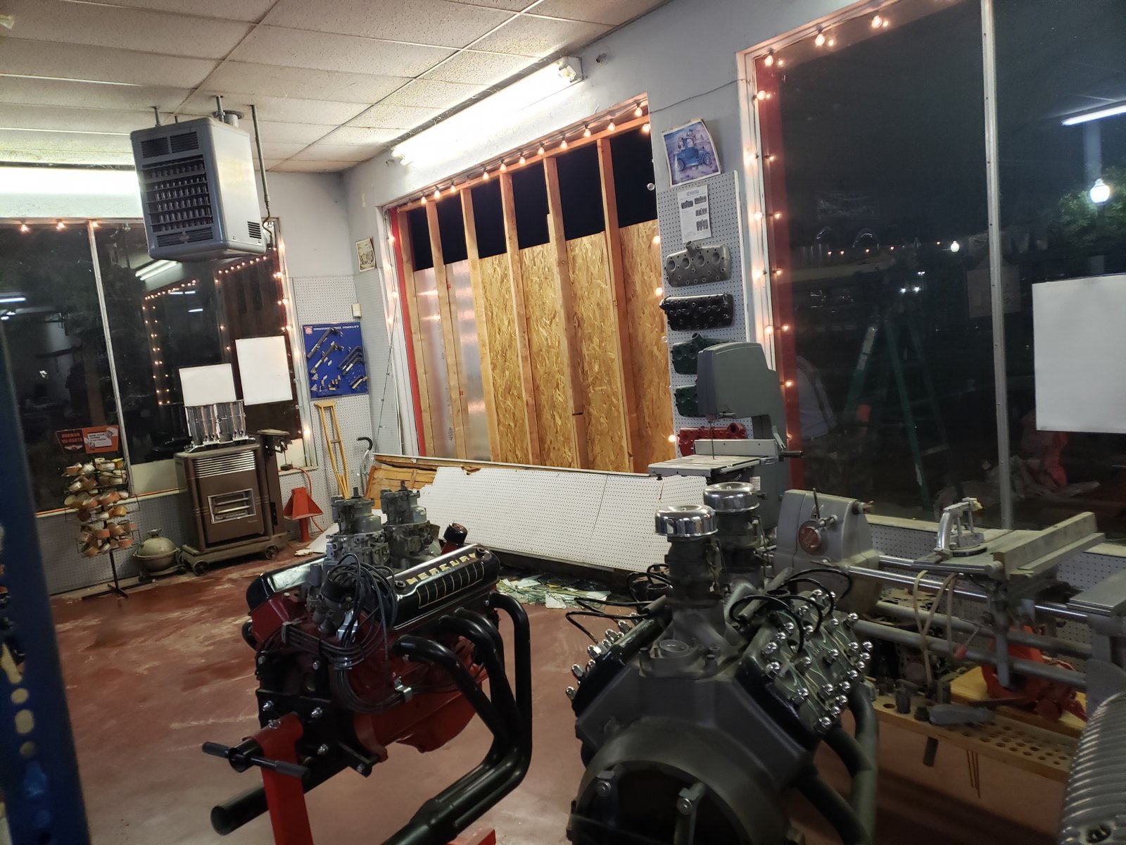

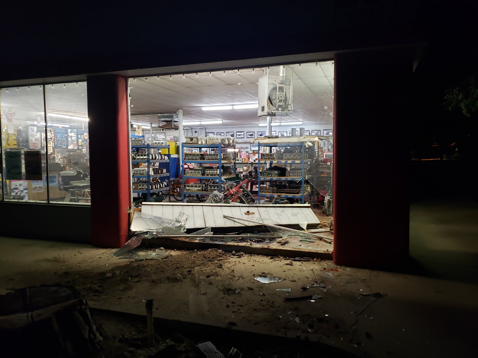

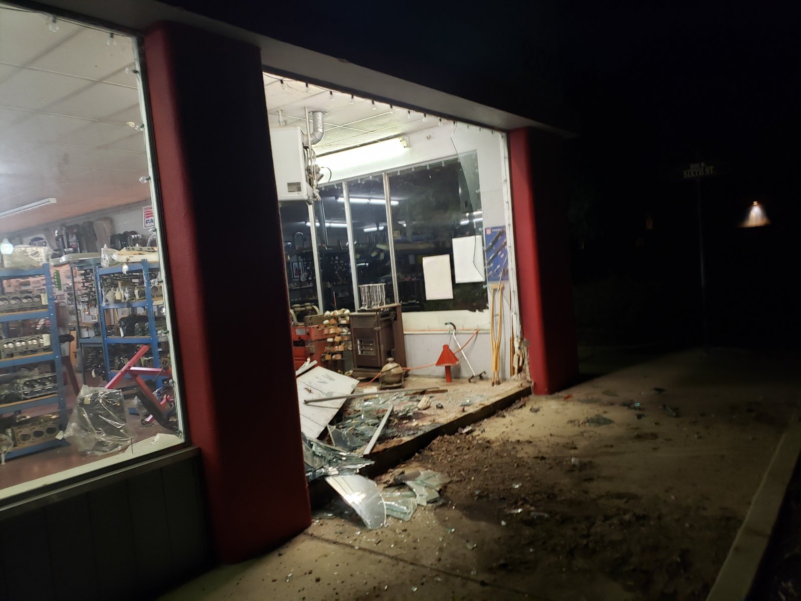

    ****, that’s terrible. ****** drunk drivers. I hope they throw the book at him(or her). I hope your business doesn’t suffer to badly.

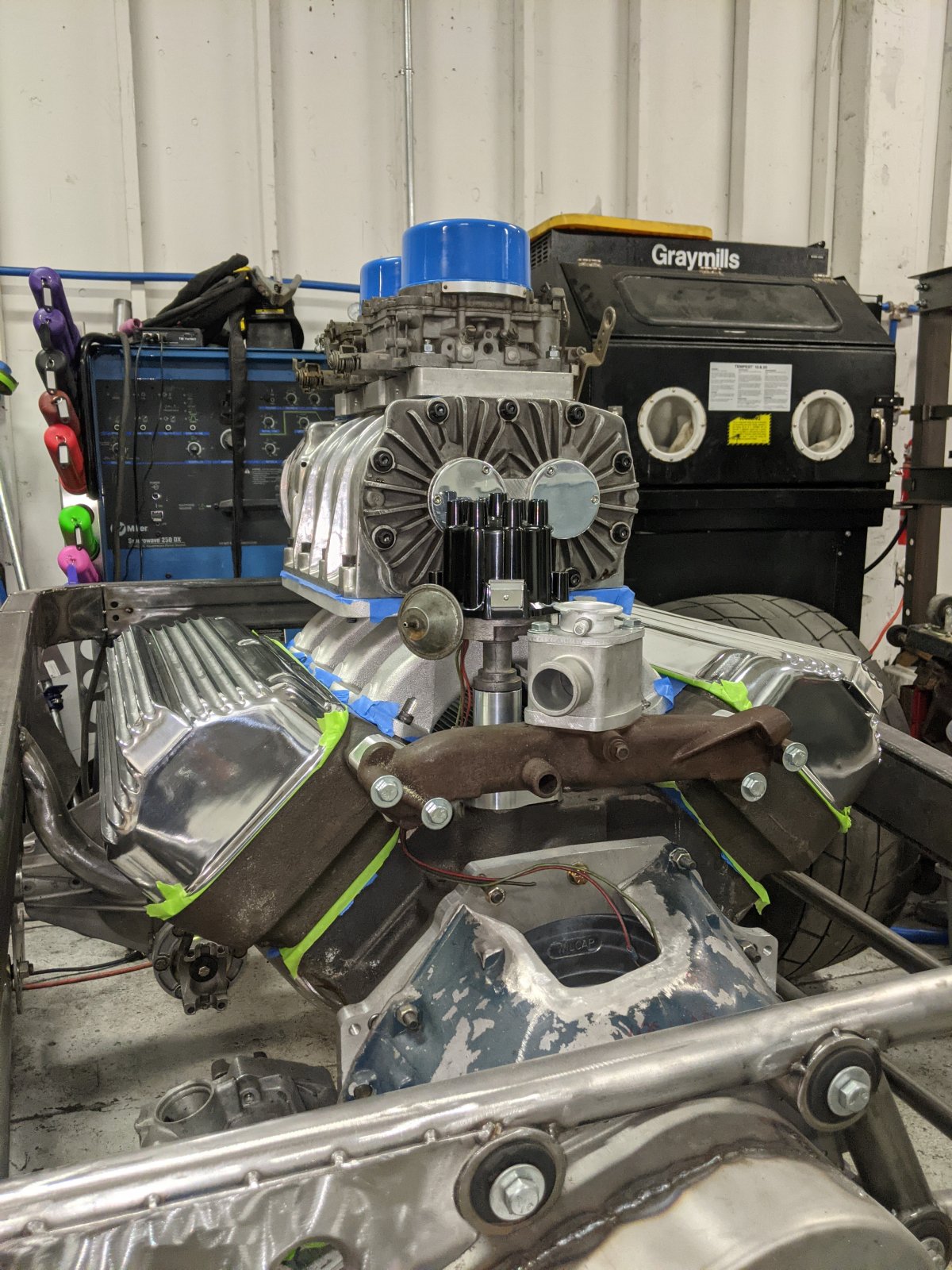

    I'm curious; doesn't putting the crossover and upper hose on the back of your engine shortchange how the water flows thru the heads.

    I 3D simulated the flow in CAD.
    It actually increases flow across the heads, and the rear cylinders.
    Conventional flow short changes cooling to everything at the back of the block.

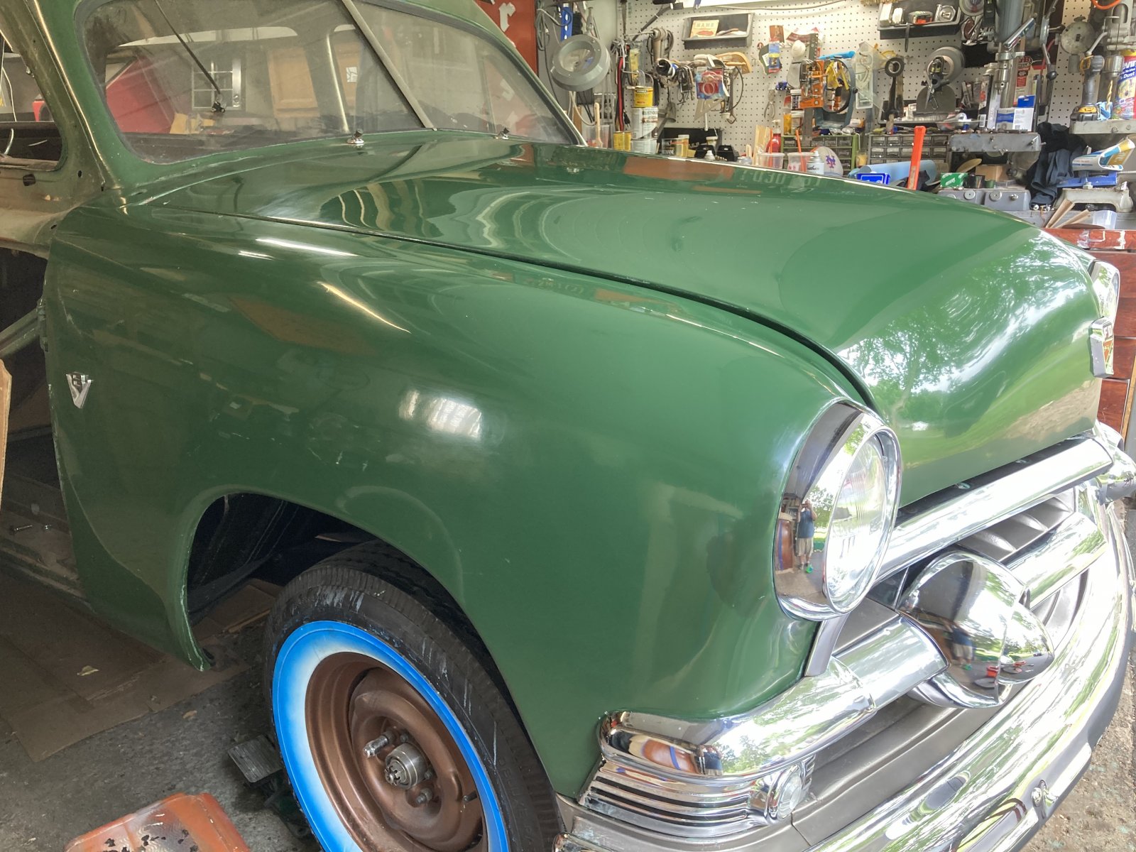

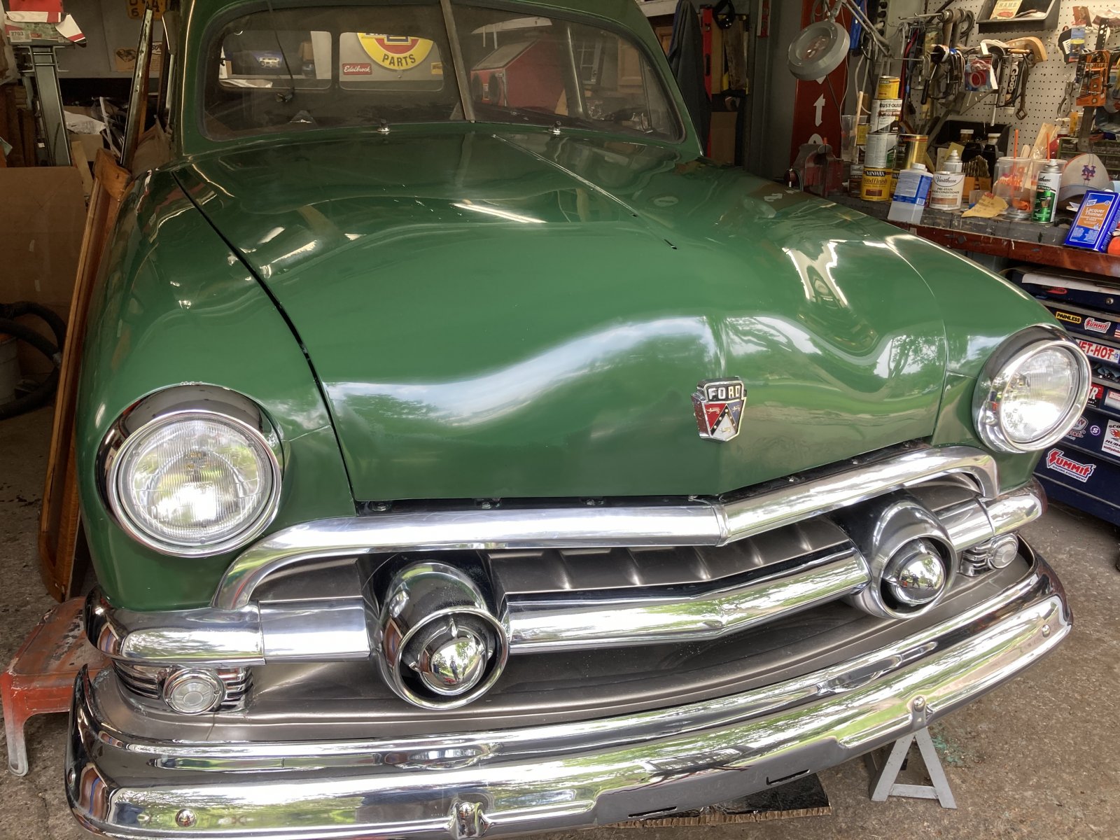

    Spent some time trying to breathe some life into the paint on my 51 woodie. It is an ancient enamel job but I want to try and save it and do spot repairs. I started with wet sanding after a clay bar treatment. I used 1500, 2000, 2500, 3000 grits followed by McGuires #7. All done by hand. Pretty happy with the results.

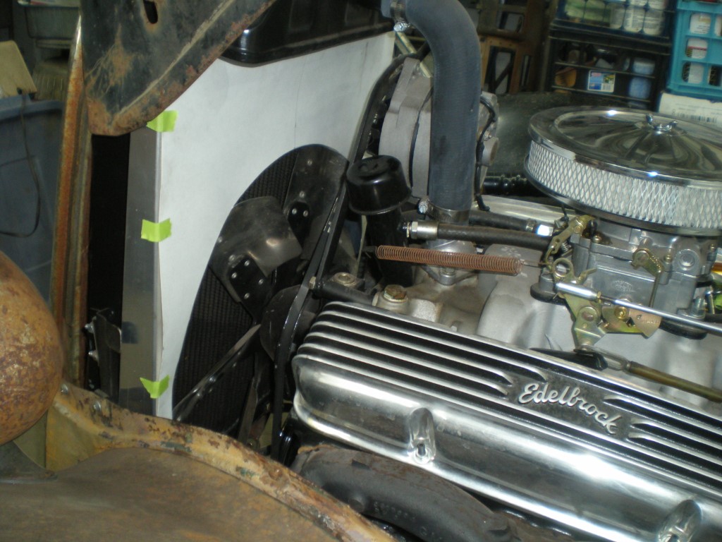

    Started making a fan shroud for my coupe; sheared and bent the side pieces up over at my kid's house. Have to jack it up tomorrow and figure out the bottom; looks to be a little complex.

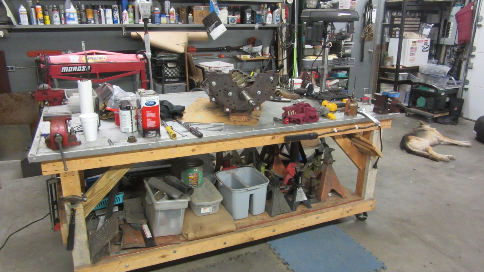

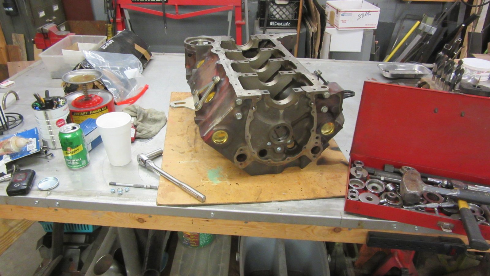

    I got to spend a little time in the shop today. Got the block on the table so I can put the cam bearings in. Knocked the freeze plugs in, filter adapter and motor mounts on. That was about all I could take. studebaker build 001.JPG

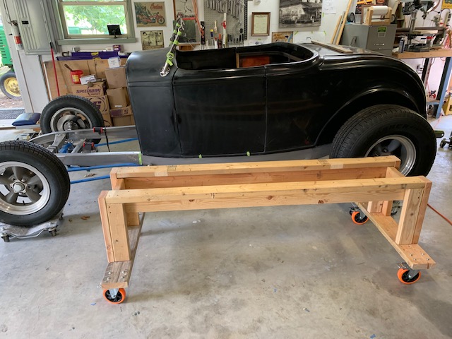

    Made a narrow body cart to allow me to work on the underside "rockers" to better fit the frame. Shout out to Gary of Blackboard Hot Rods, I used the ch***is crate material my frame was shipped on, even reused the screws. Cheap Chicom casters from Amazon make it somewhat mobile.

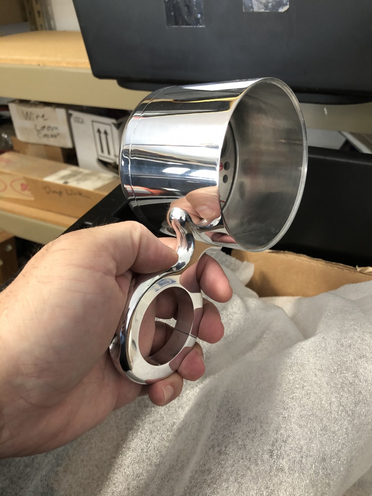

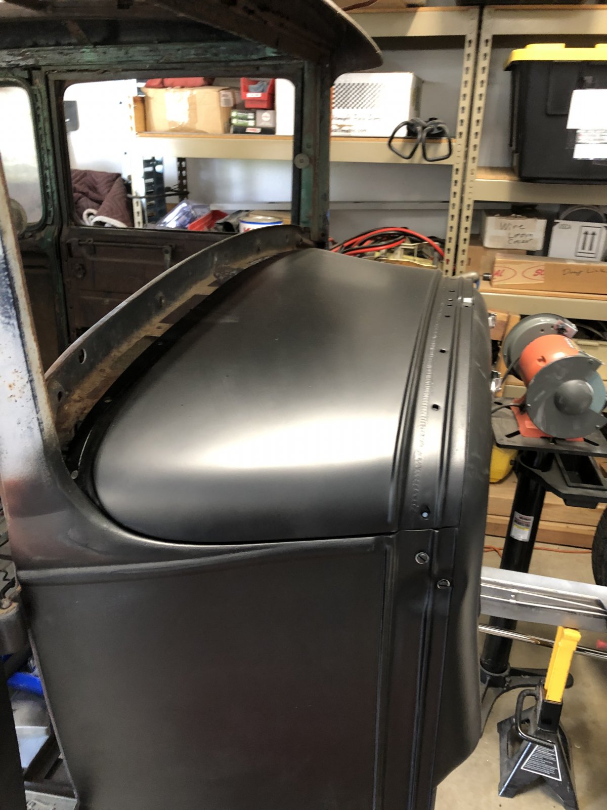

    Got the gas cap on the cowl welded up and filled. And got a tach cup in the mail. 473E429C-3F9B-4C62-A813-E30EFCD03CA3.jpeg 2C0131CC-0A11-47E5-A968-B23FEE2EDF1A.jpeg
