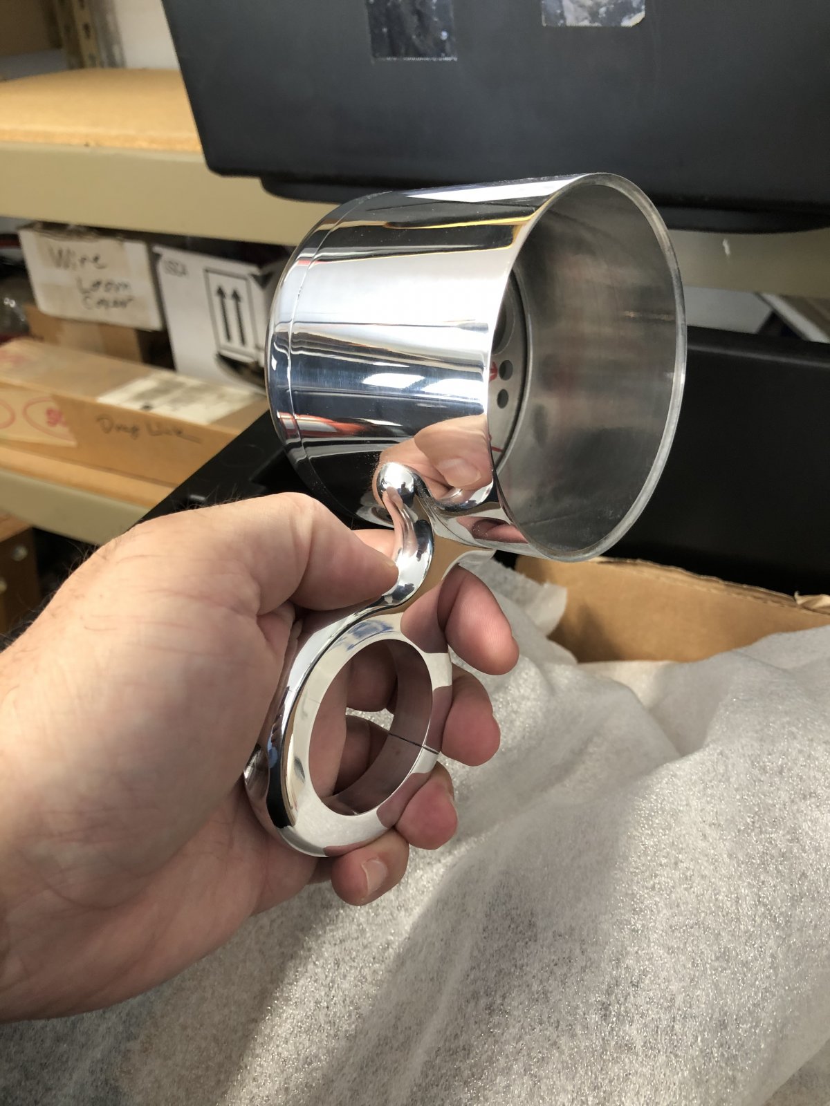

    Where did you pick this up? Looks really nice. Would like to see it installed.

    Thanks, I found it at Affordablestreetrods.com
    I wanted something nice to mount the tach to the column, rather than the normal hose clamp setup. I saw one at the last socal open house and had been looking for one when I found them at affordable street rods. It’s going to be a while before it’s mounted, so I attached the photo of the car that i got the idea from.

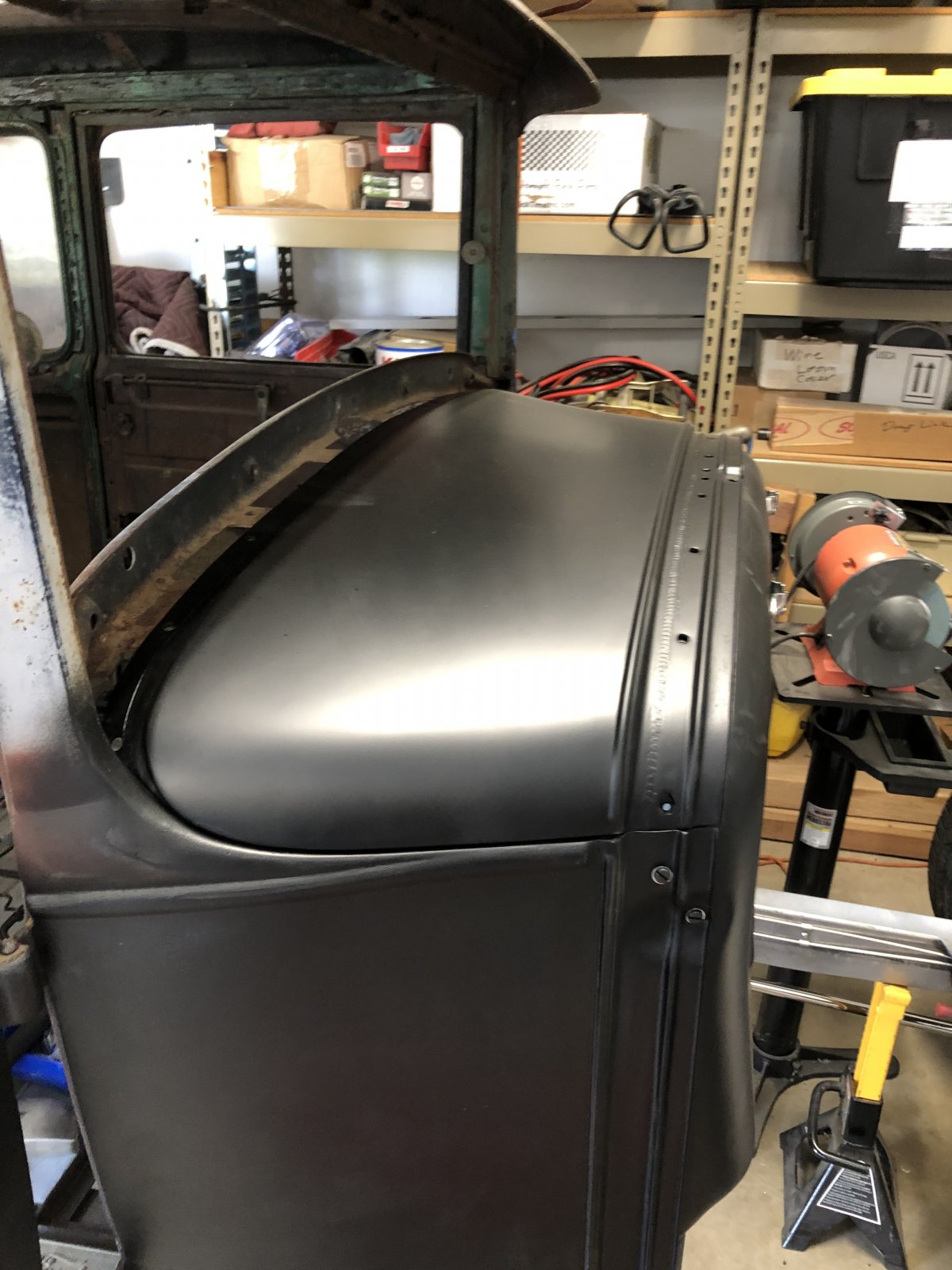

    Mounted the doors today

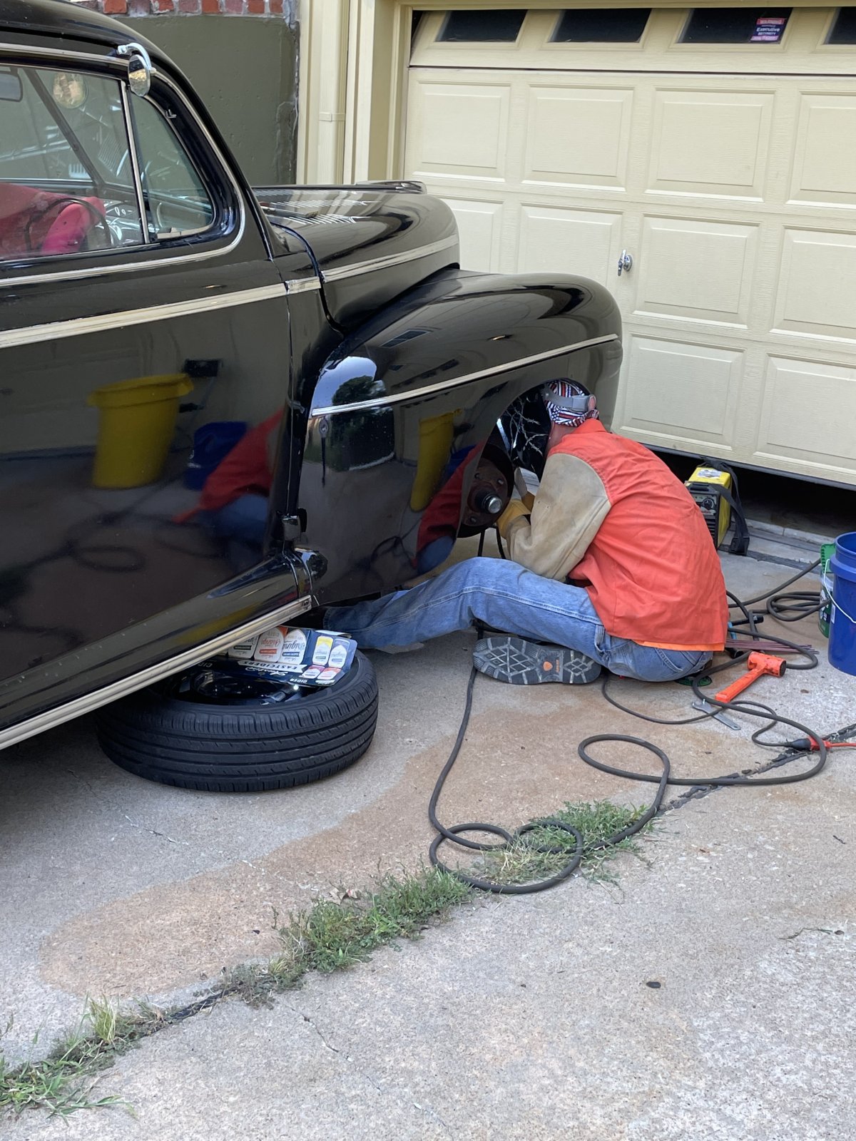

    Watched my 6’6” buddy stick weld on the 46’ getting ready to replace the upper shock mounts with taller ones. After years of the spring settling the shocks were bottoming out after about an inch and I managed to rip both of them off the frame the last few years flying fast and low on pot holed city streets 77A81EC1-5CD6-4C9B-9B21-201C03987242.jpeg

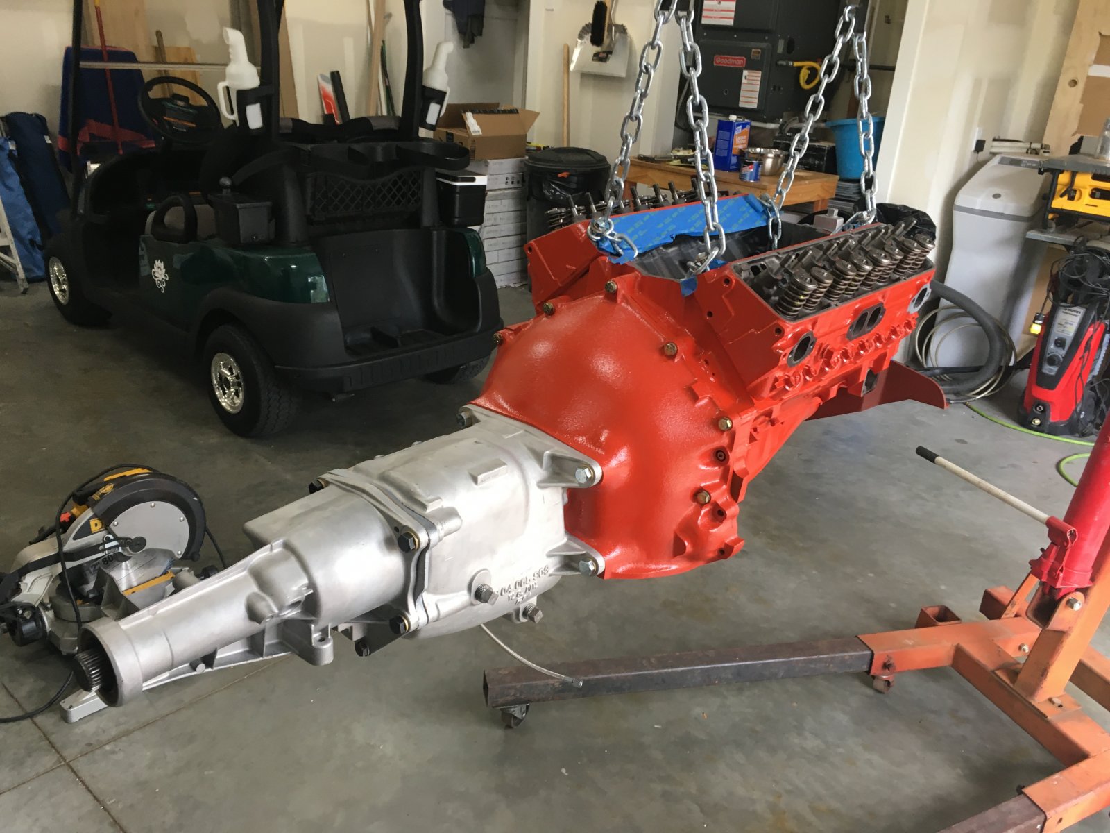

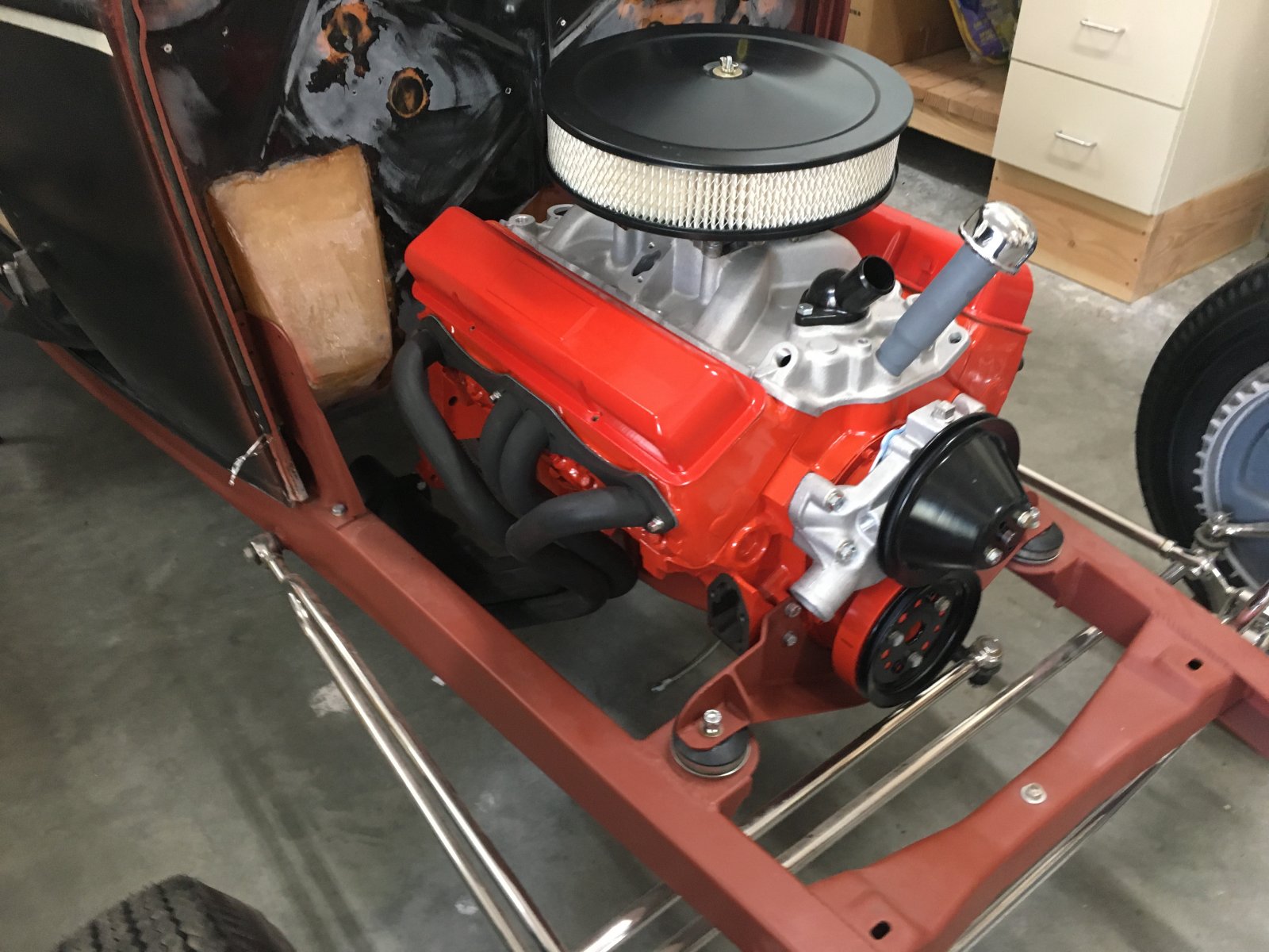

    A9E31A44-9E43-4C8D-BA53-2E7A7D8B2ADF.jpeg DFF06F15-5E7B-461A-835E-2B3AE7423934.jpeg ****embled the engine, clutch, bell housing, and trans. Slid it in place ! Great day!!

    hope he had jack stands under car or whoops there goes ya legs
    recently we had over here someone at 2.30 am get a flat in a Merc SUV
    pulled into car park to fix,next morning they found the front wheel off
    and him laying under car squashed/dead

    Jack, stands, more stands, tires and wheels under the car. Shook the***** out of it and waited another hour before any one got near it. I don’t even like being under a car on stands

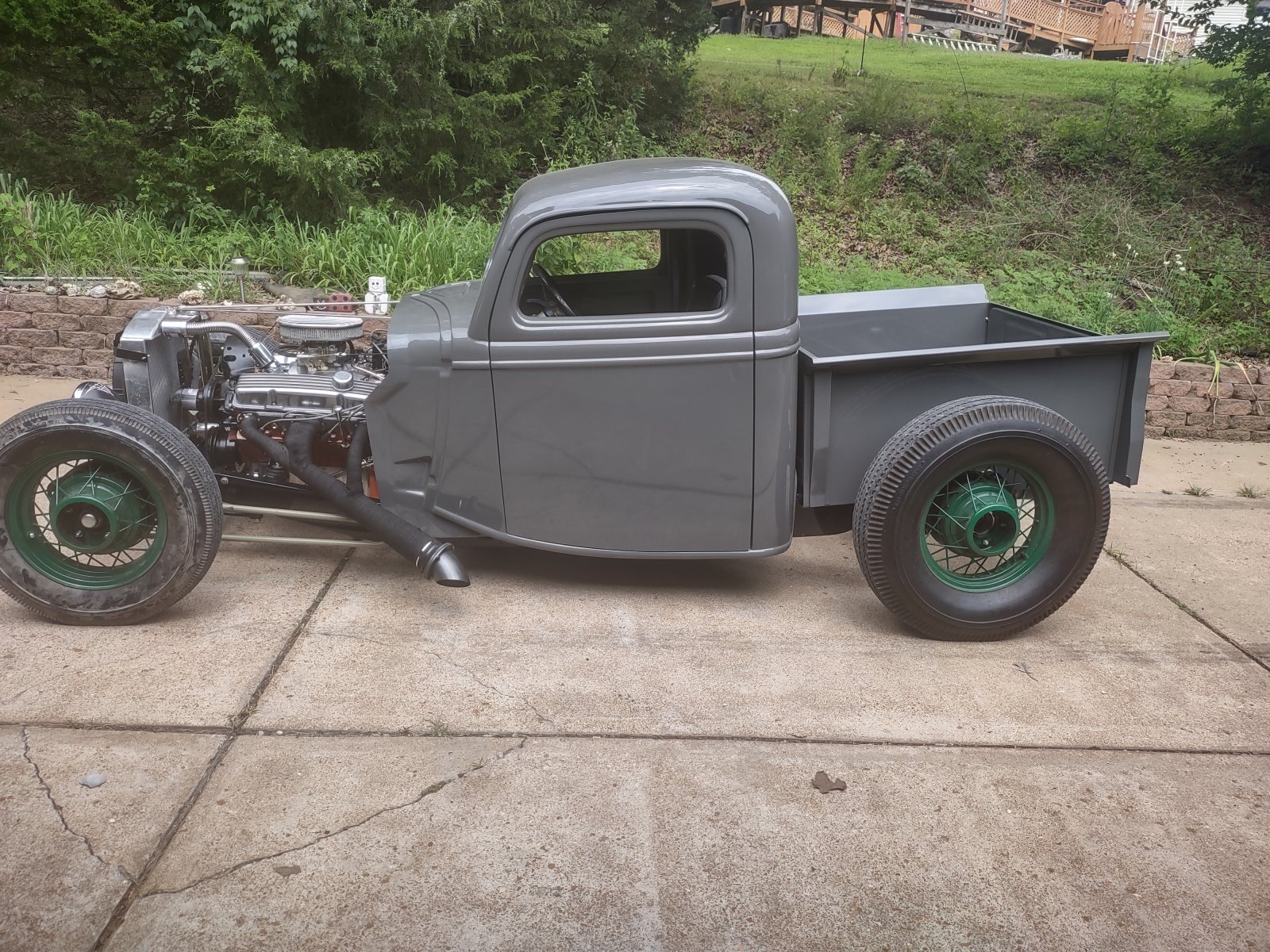

    That little truck looks great!
    I love the swoop st the bottom of the cab.
    Very cool!

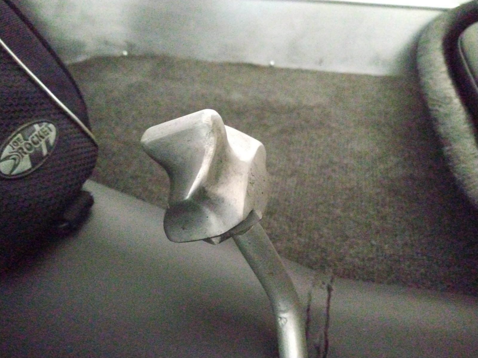

    I had a Oly beer tapper handle on my T Roadster for a shifter handle/knob, but it was too tall and the corner of it poked me in the thigh. Being a chronic tightwad I couldn't imagine just "buying" one, oh, no. Looked around the shop for anything that might be interesting or work. After about 2 or 3 hours of fiddling around I ended up with the "knob" pictured below. My guess is you'll maybe need to be 55+ years old to know what it was for, or to have ever used some of them.

    Yep, I have 3 or 4 in the bottom drawer of my tool box. I know I'll never use them but I can't seem to get rid of them.

    I got Lance to help me put in motor and trans mounts. I tried doing it all myself out in the backyard on dirt last summer, with the cab on, but ended up getting them*****eyed by about an inch. So I pulled the cab off, swallowed my pride and asked for****istance. That's why we're Busch AND Busch, lol. Lance got them stuck on quickfast and now things are straight and tight :) Tomorrow I'll clean off the slag and throw on some primer. Stoked to get a major step done!

    I know I know!
    Hint 1/2" square drive
    Looks good!

    Yup. I was able to get the 1/2" square flats kinda threaded to 5/8"-11 and JB Welded in a short piece of 5/8" all-thread that was drilled and tapped to 3/8"-16 to screw onto the shift lever. Lots of messing around to keep from buying a $8 shift knob. :eek::D
    I'm thinking it's just as one-off as some of the custom, carved shift knobs though.

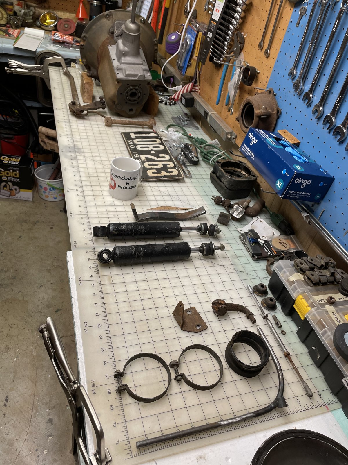

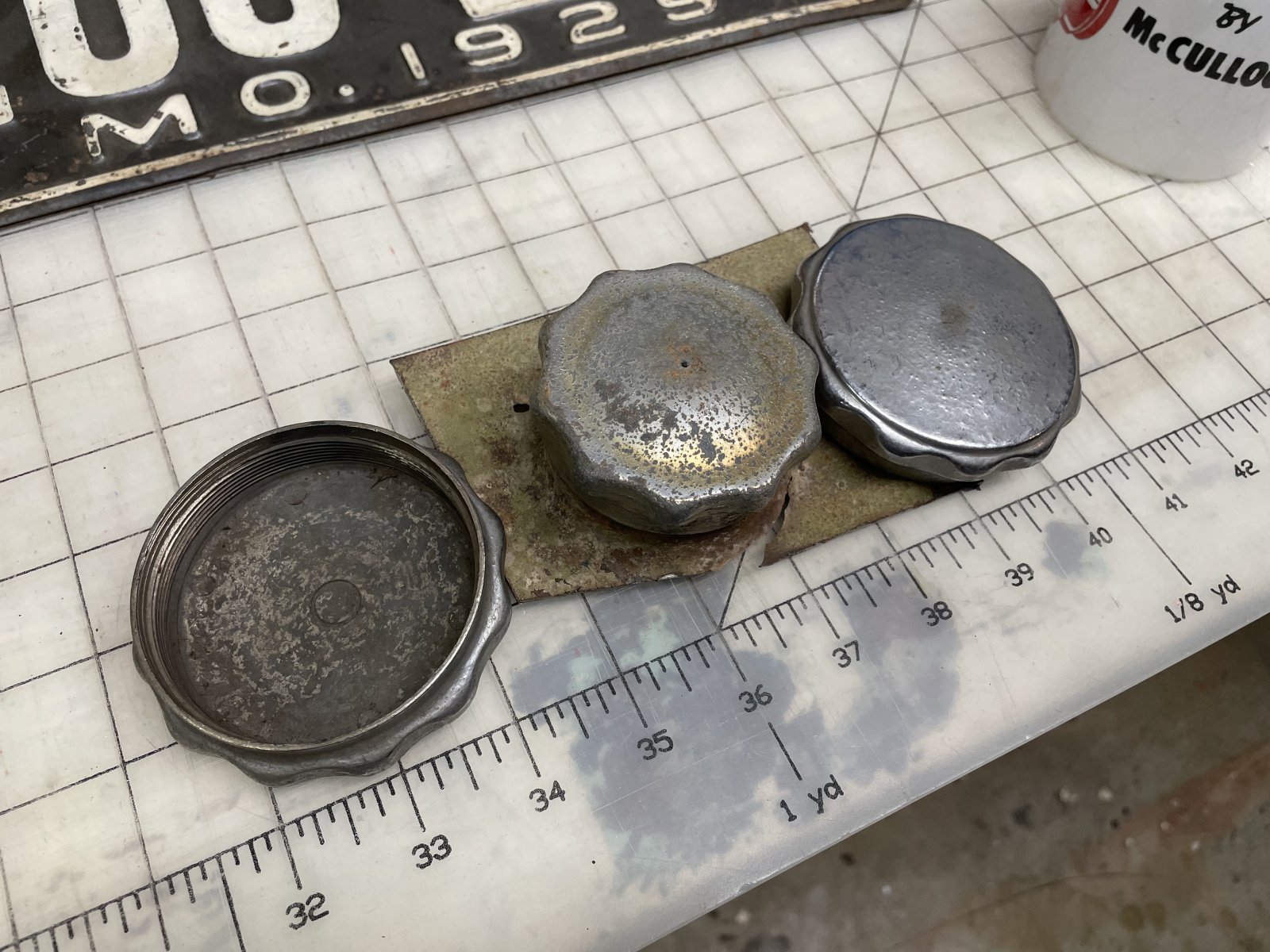

    Cleaned up the shop and cut down this used up cutting Matte for a new work bench cover E9666685-DA4A-4751-922E-F5A2129CB14D.jpeg buddy brought by some gas caps for me to try out on the model A project. Not sure what they are. The center cap shown is stock model A 1AE1E834-E79E-410B-9EFF-FA8AD08FCF50.jpeg used the new cutting matte to find they are roughly 3.25 inches across from the tips of the bumps 1EE03B4E-FE7A-4CD8-AEFE-2F02842EFE45.jpeg no idea what they are I’m thinking 1920’s and not Ford? Don’t seem to be vented and I think they are standard pipe thread

    To be truly representative it should probably have some blood on it. Winding those things in was always a knuckle buster.
