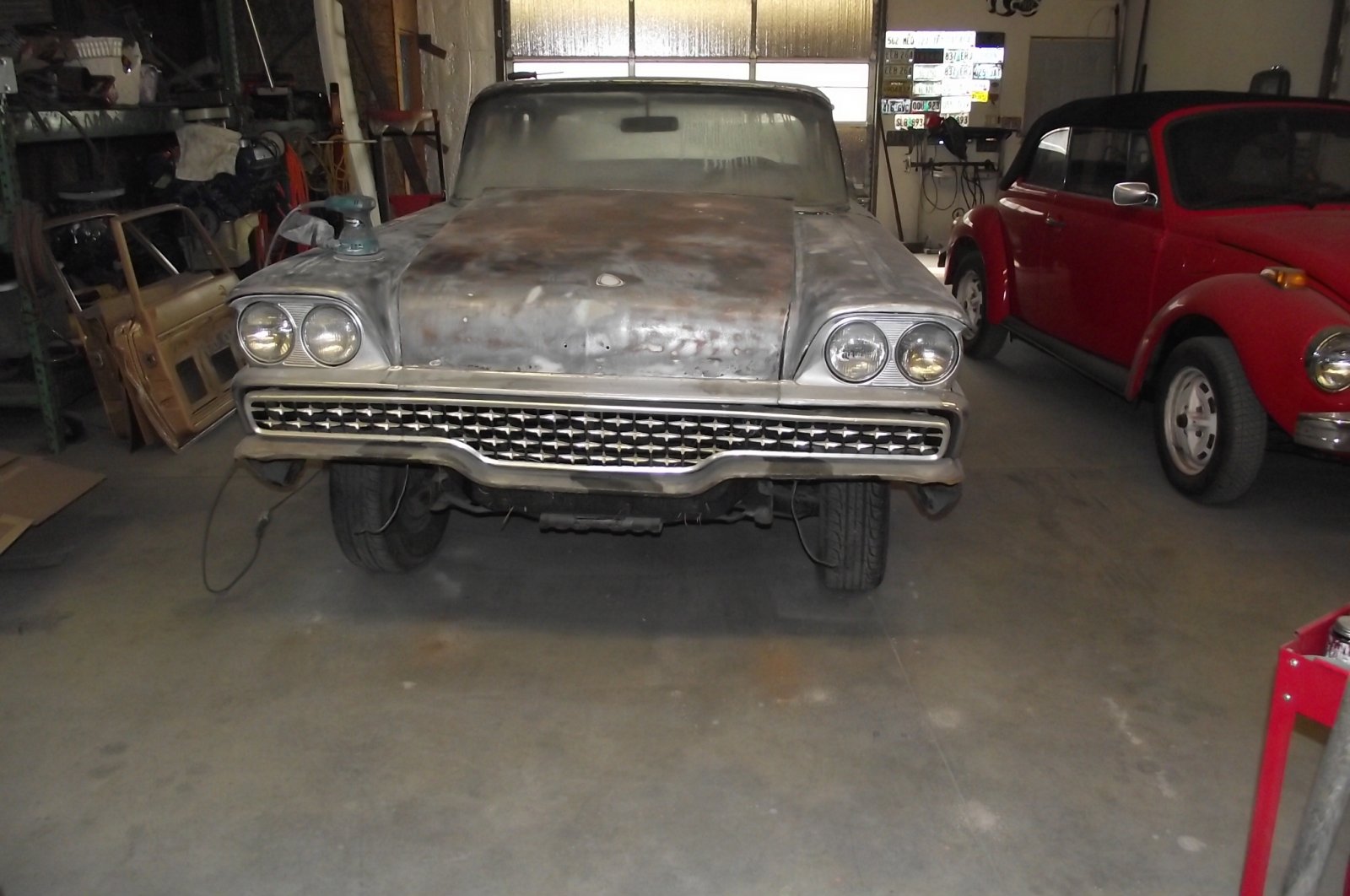

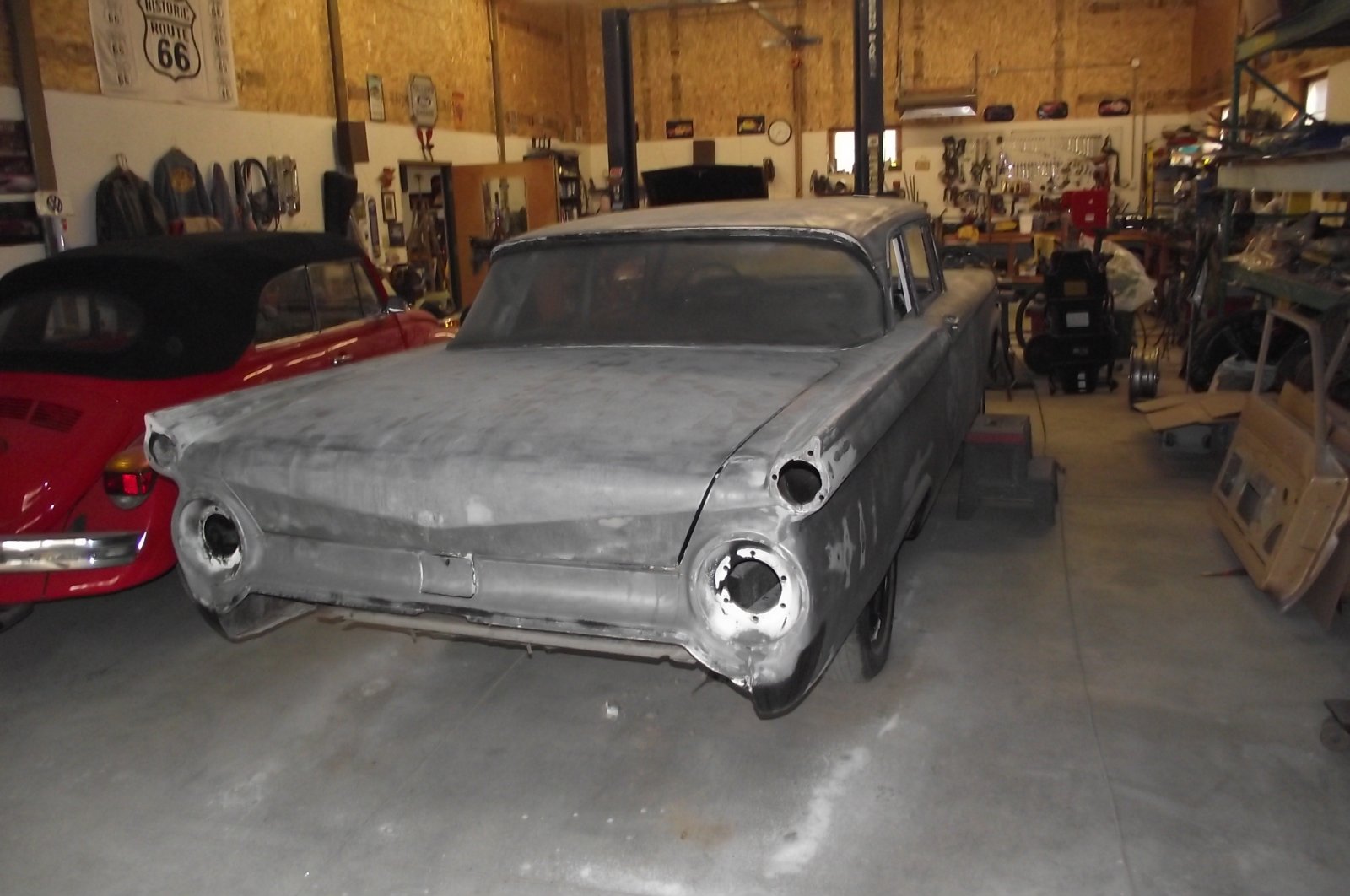

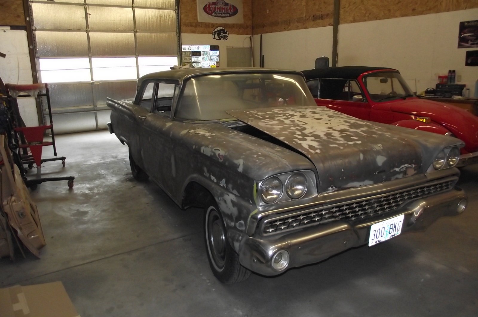

    Got after the 59 with some 40 grit on a DA. This thing is really pretty good other than the soft floors and a few pin holes in the corners of the hood and doors.

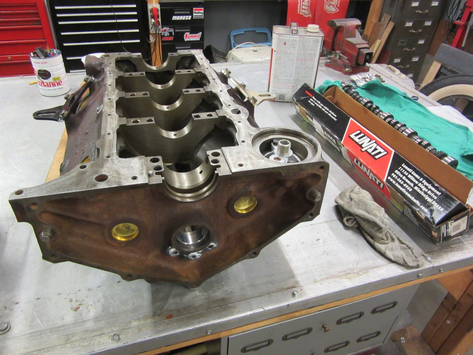

    STUDEBAKER BUILD 002.JPG The machine shop did not chamfer the cylinders when they bored it so I am correcting that, the one on the right is finished. And I have the cam bearings installed and the cam fits so all is well !

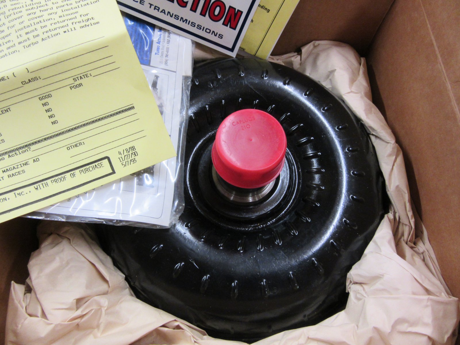

    It's a great day to be alive, I finished my block work ( used a cone shaped mandrel ) taped up so I would not hit the walls. Getting all my parts in one place, I am down to my last converter ( dated 1993 ) I wonder if Turbo Action would still warranty it LOL.
    I had to drill out the flex plate holes as the converter takes 7/16 bolts. This pile is about ready for some brake fluid and a motor !

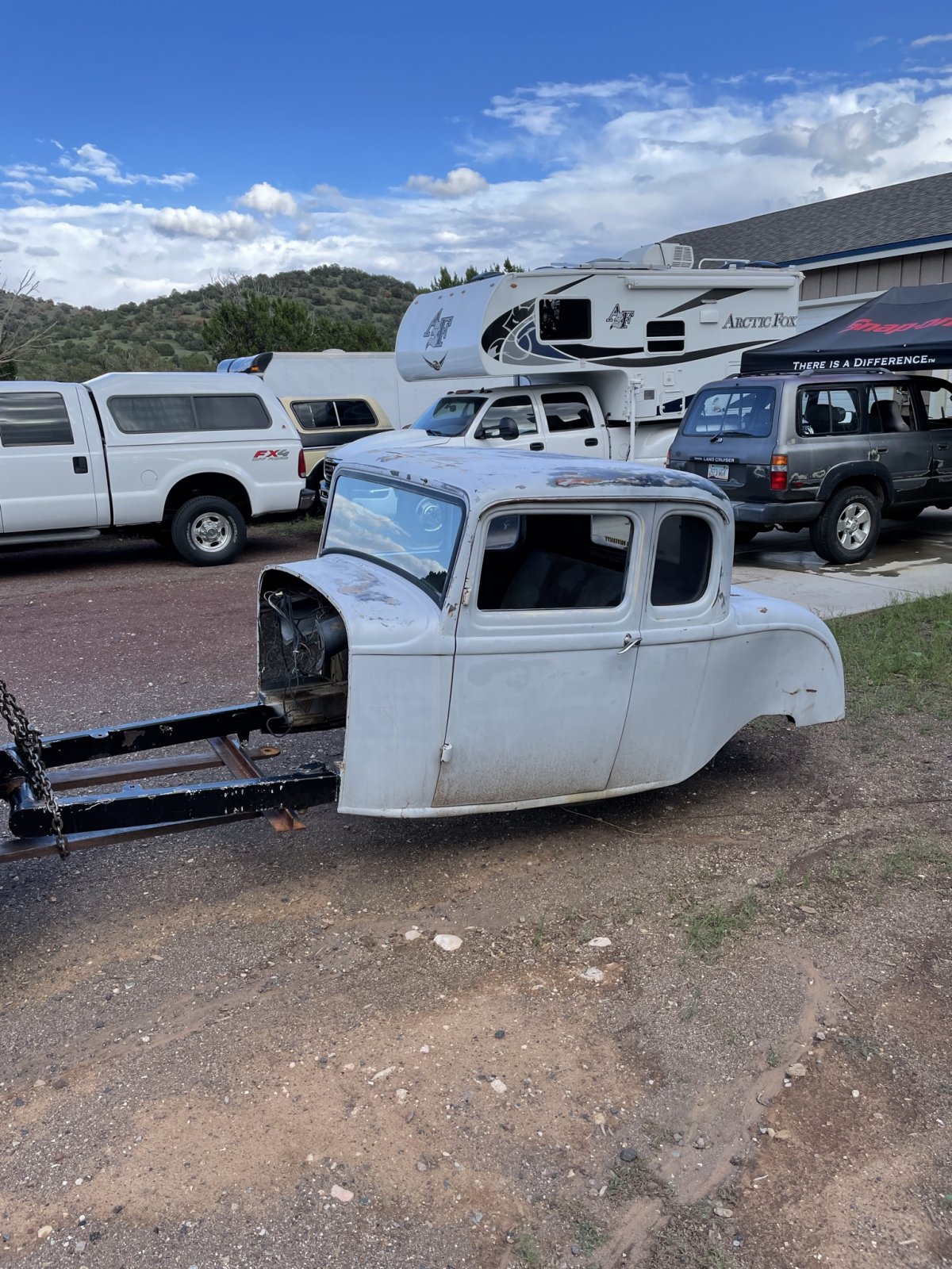

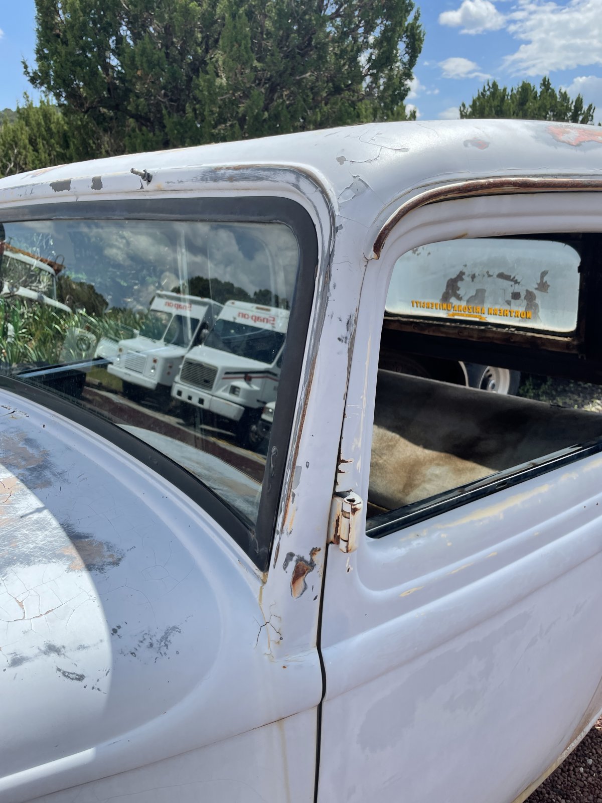

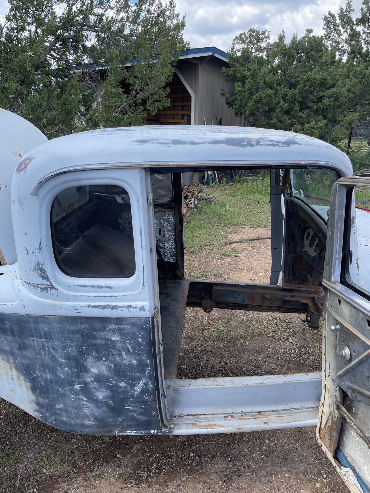

  18. Drug my 32 5 Window out, got the hose and evicted all the critters from their home. Then I made a list of things that need done so that I could drive it. Step #1 would be to un-channel it and I’m not sure if that is something I want to do.
    Every time this picture pops up on the banner I think maybe it could be my car when it was being built back in the day, same filled rear quarters, fenders bolted on higher up to clear the tires, and channeled to the bottom of the frame. My car has flat washers welded inside the rear quarters for mounting fenders, might have been built back East with fender laws?
    Probably not, but it’s a good story.
    I’m thinking somebody else needs this one and I need to focus on my 37-38 Chevy!

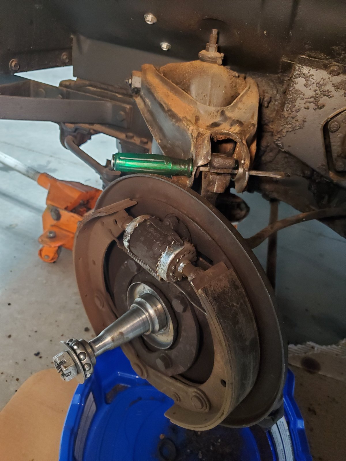

    Removed what was left of link pin. Waiting on parts . Going to replace pads also. 20210908_150513.jpg

    looking at this made my **** hole pucker, ...what is keeping the spring from coming out?? besides the screw driver???

    @FRANK GRELLE I have a jack stand and a jack underneath it. It ain't going anywhere. You can't see stand in pic but it's under there.

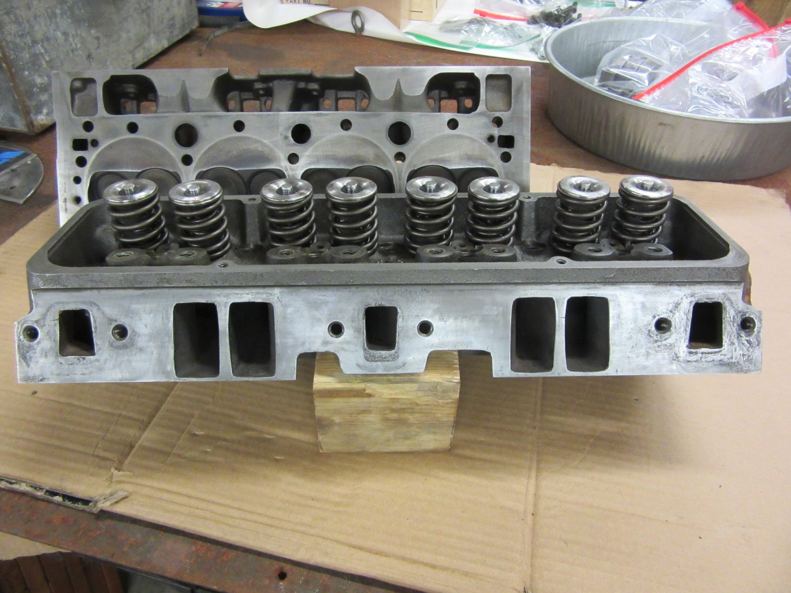

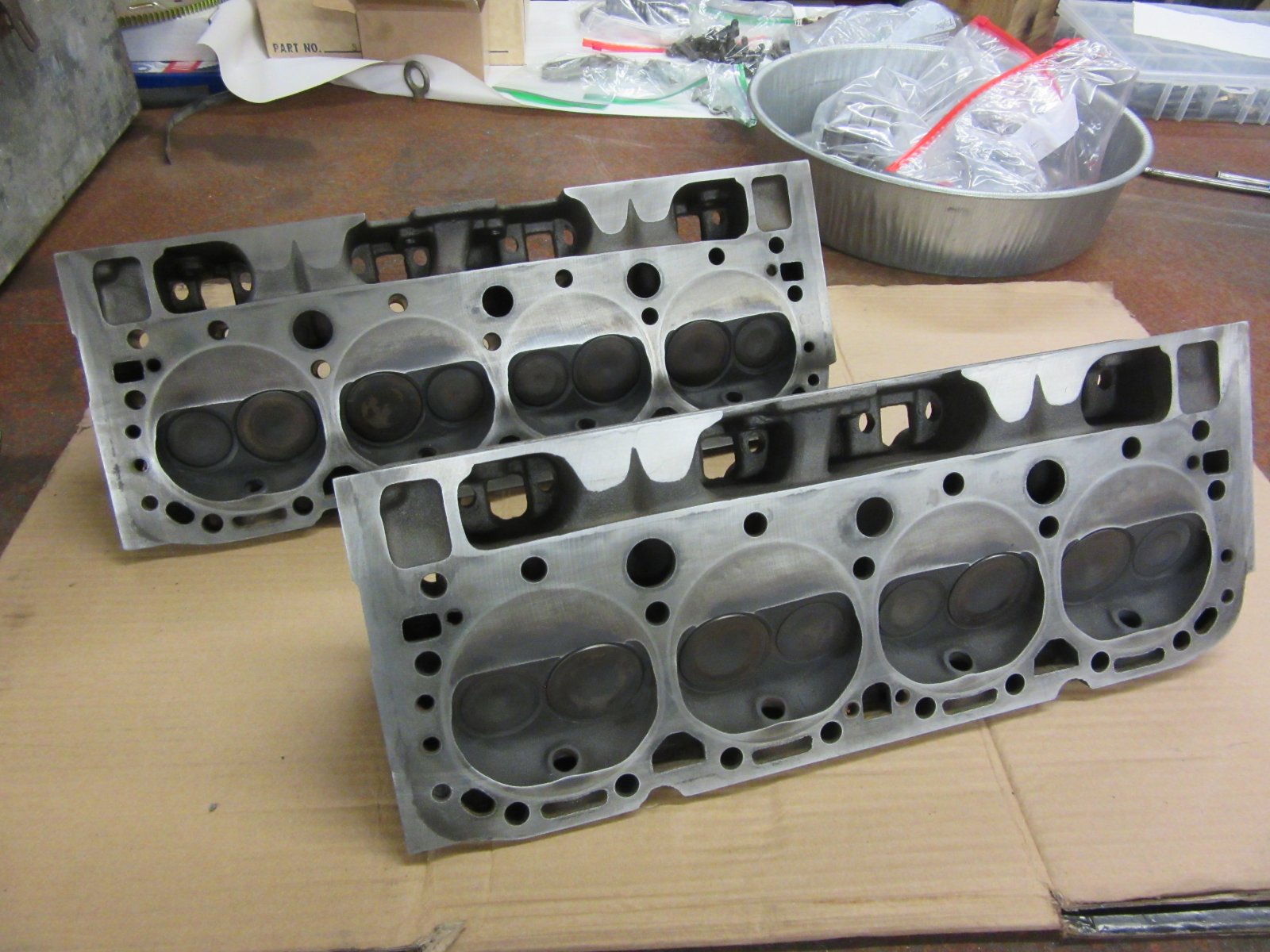

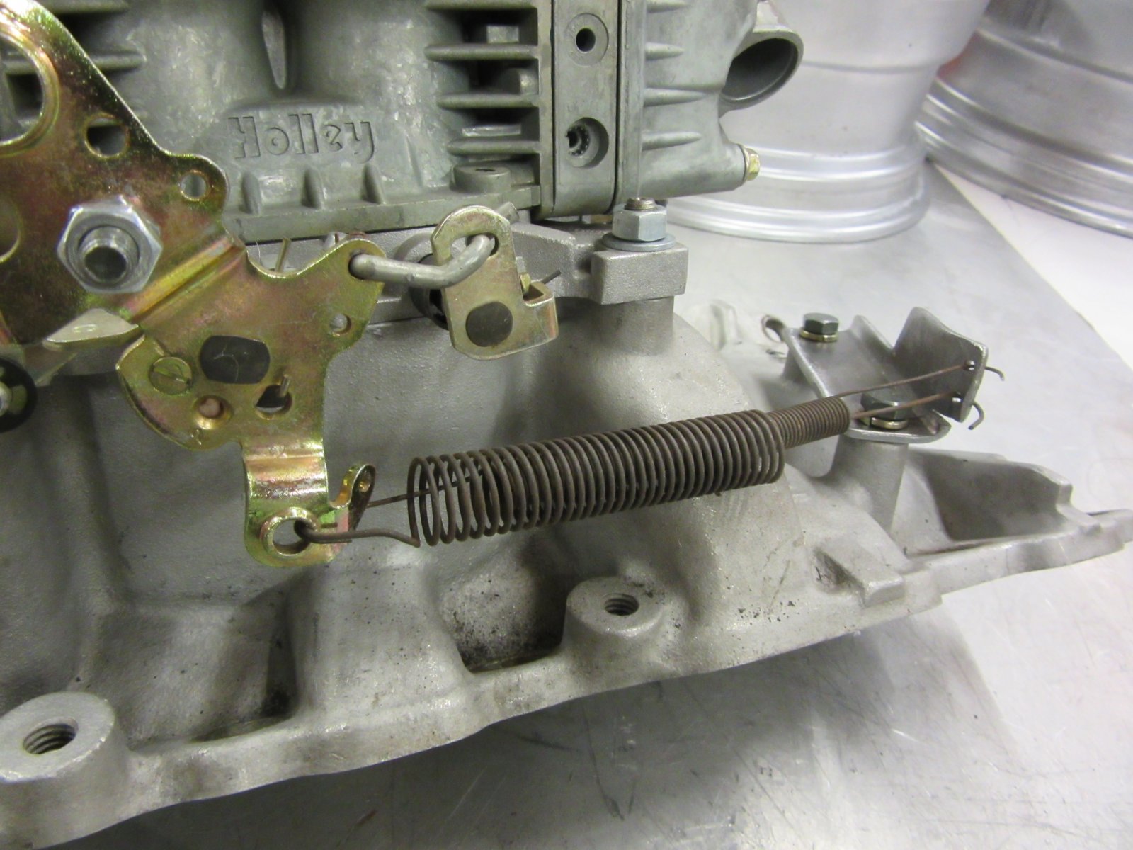

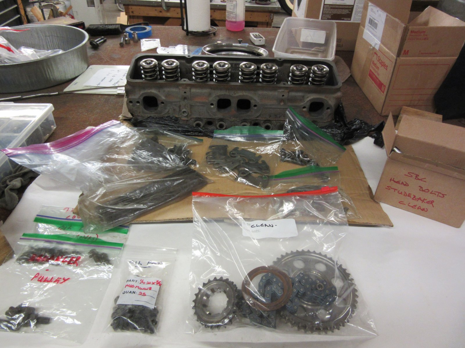

    I have been making good progress this past week, I got my heads cleaned up ( yes they are used but very few laps ) they will get one more bath in Varsol and be bolted on. Got the intake and carb out so I can finish the return spring bracket and see what I have to make a fuel line with. I try not to buy anything if at all possible. studebaker build 001.JPG studebaker build 002.JPG studebaker build 002.JPG studebaker build 007.JPG studebaker build 008.JPG

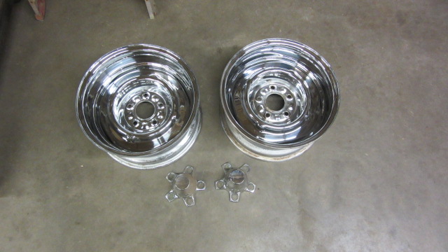

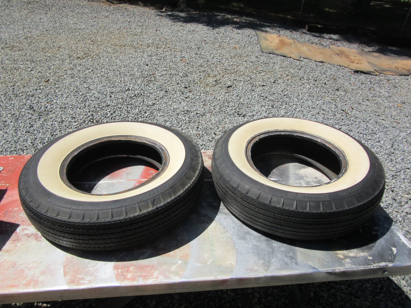

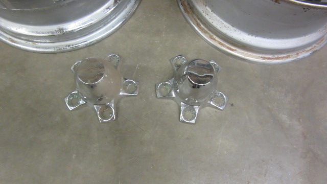

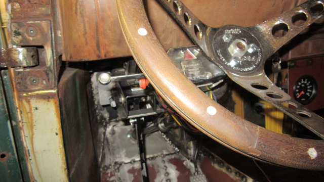

    Plus I got these old tires off the wheels and found the center caps I will be using on the front, I have some non-traditional tires that should be here today to go on the front. Plus I got the turn signal switch in place. studebaker build 003.JPG studebaker build 005.JPG studebaker build 006.JPG studebaker build 007.JPG

    ok now i feel better :)

    Just about got it, pays to scrub these old beasts down to metal. I've found a few places where moisture has infiltrated through the old primer under previous body work and started pitting the metal, nothing big but still needs to be eliminated and neutralized before proceeding. the old work was well dome but time has taken a toll on it and doing it over with modern materials isn't that much work compared to having it bite you in the **** later. By the way, I need bumpers and a windshield if anyone near by has parts.
