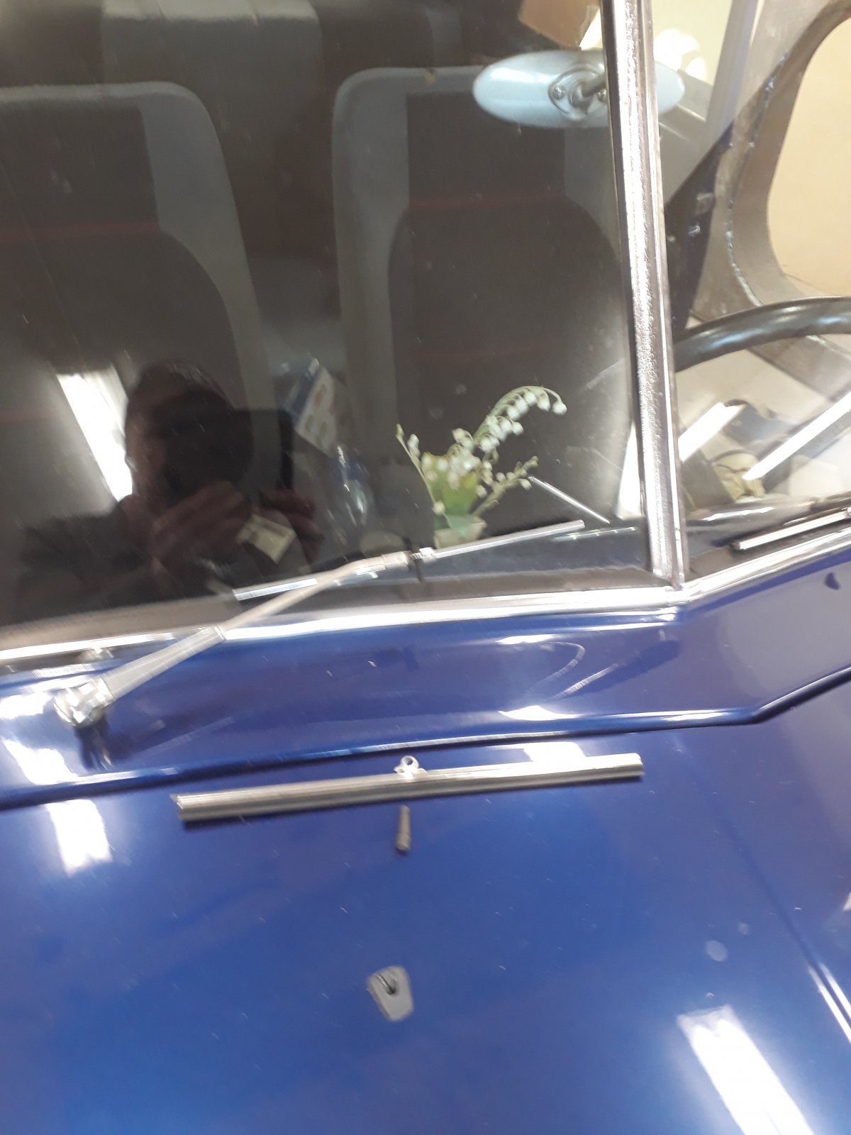

    Got new viperblades for my Morris. The n 005.jpg ew ones are 1 inch longer (9 inch) so so mayby I can look out with both eyes at the same time.

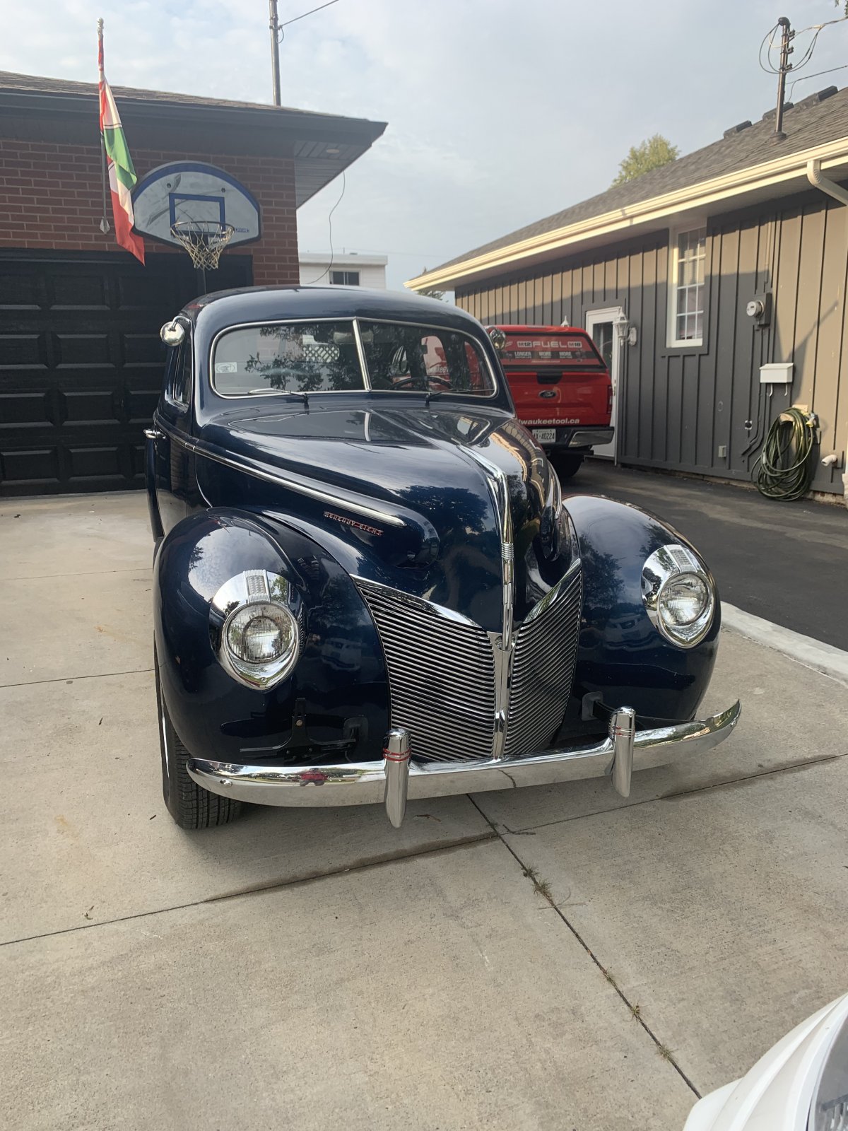

    Just got my plates and insurance
    Going for a cruise !!!!!!

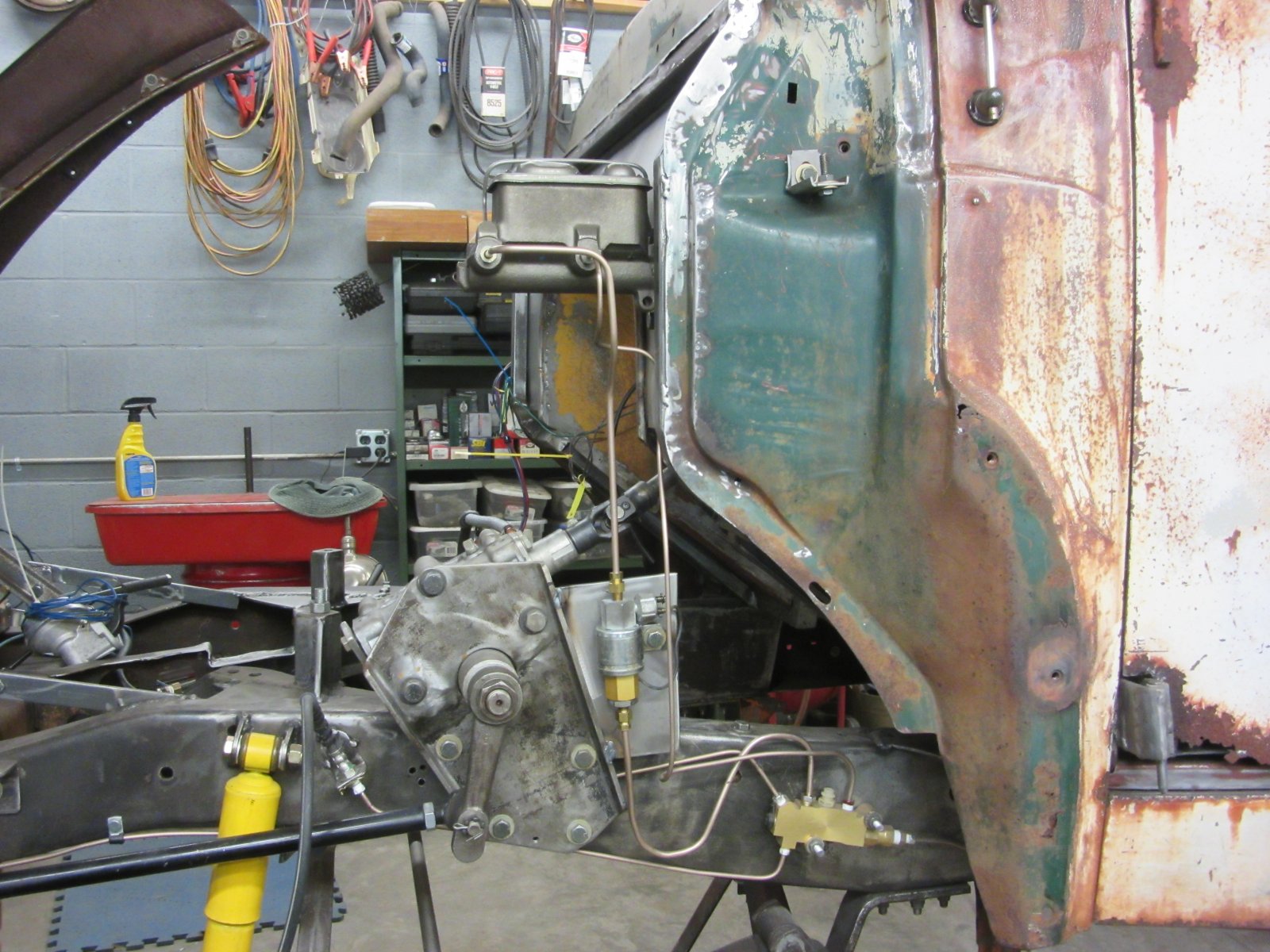

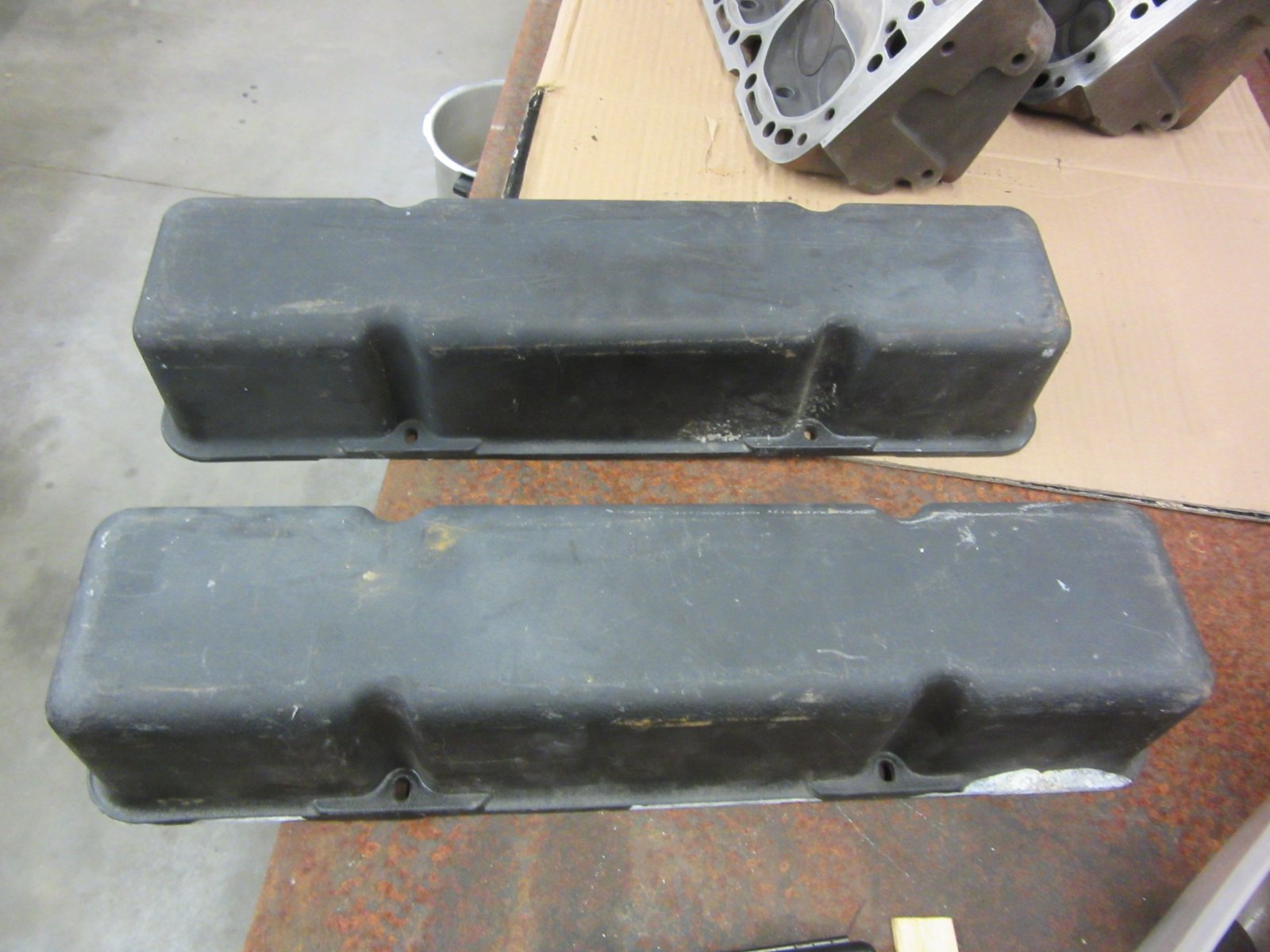

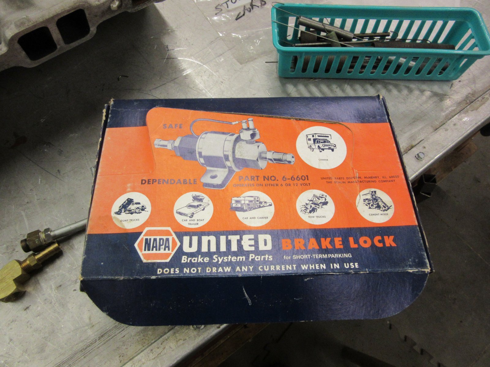

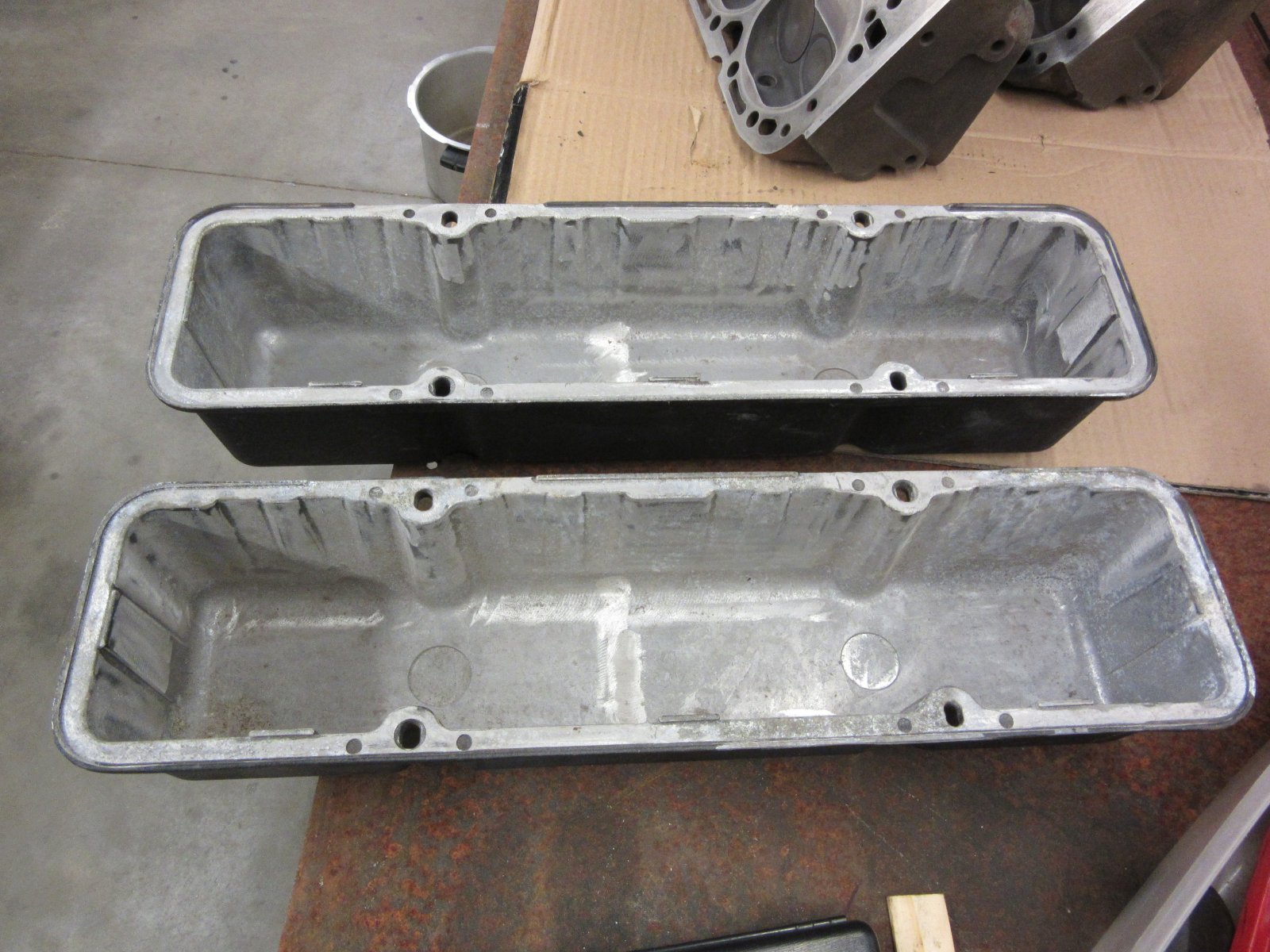

    studebaker build 004.JPG studebaker build 005.JPG studebaker build 002.JPG studebaker build 001.JPG You have to have a line lock ! how about a vintage NAPA brake lock. And hit the local Flea market and got these valve covers for $10.00

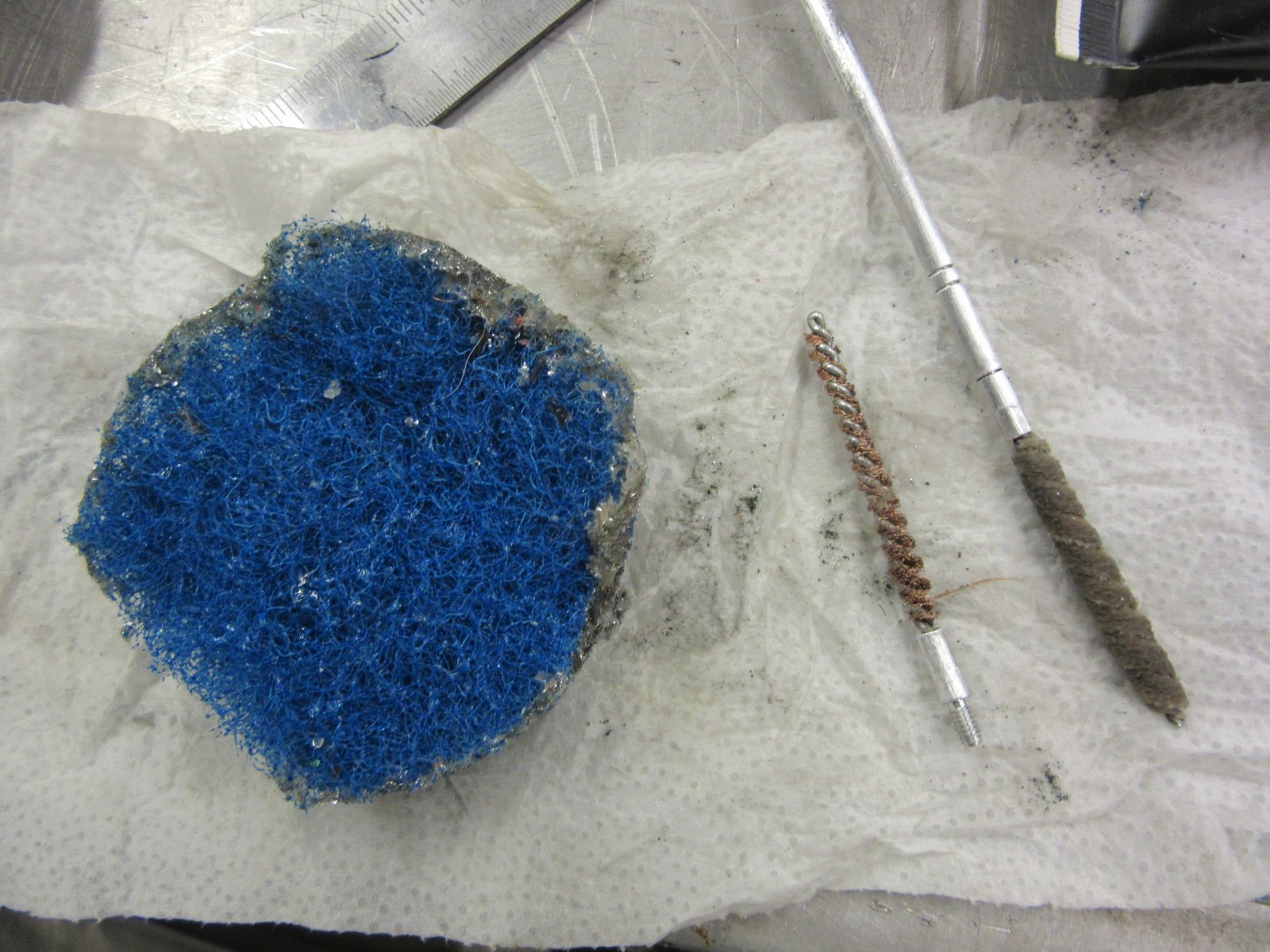

    Gave the block one final hot ! hot ! water and soap scrubbing. washed the crank again after having it balanced
    and polished. For those who are interested , make sure to clean and flush and clean the journals in the crank. The blue pad goes in the drain of my parts washer and you can see all the grit that came out of the journals from the polishing. I probably went through them 5 or 6 times flushing and using a gun cleaning tool until they were clean. And the crank was clean already as I had put it in to check the clearances. But I like motor work to be super clean. I got the crank bolted down and it is as smooth as glass ! you can turn it with no effort. studebaker build 001.JPG studebaker build 003.JPG

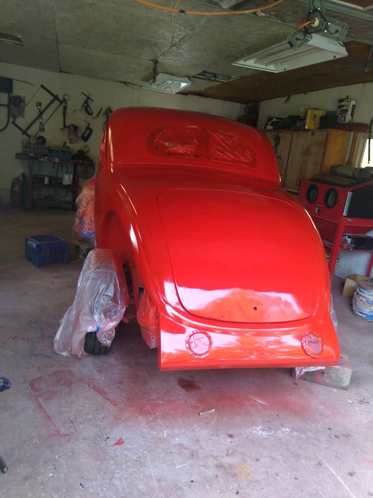

    Got my 1937 ford coupe painted!!

    Still have to do the rear fenders and hood.

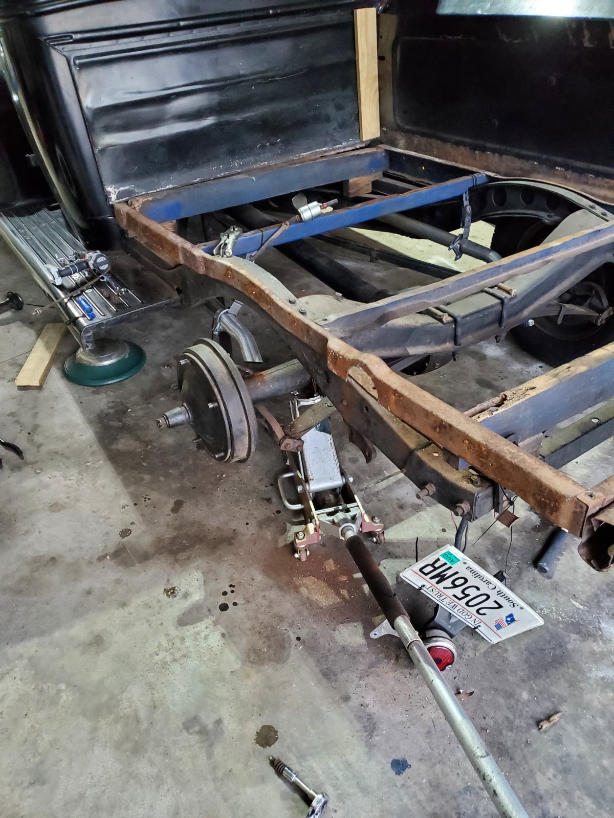

    Well, former owner had welded a sheet of 1/8 steel plate in bed as floor. As a winter project I intend to replace floor, replace front panel which is***** and replace all 4 stake pockets.The welds as you see in pic were aprox 2 inches apart . I carefully ground these welds with a 4" diamond blade . Cant see in this photo but the bed sides are wavy somewhat right at the area where the bed sub frame is riveted, caused mostly by trash , dirt or whatever getting between sub rail and actual bed side. Will end up removing sub frame frame rail from bed side , work on getting bed side strait ( rest of bed side is strait) re rivit , add new front panel, pockets and floor. Already removed a few rivits from rail/ sides. 20210912_140448.jpg

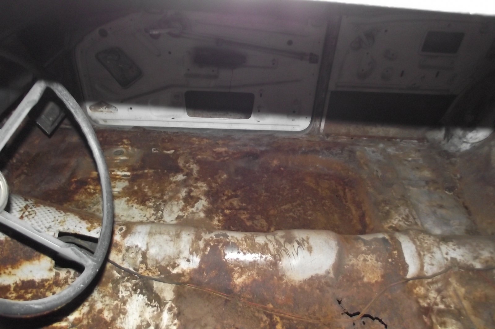

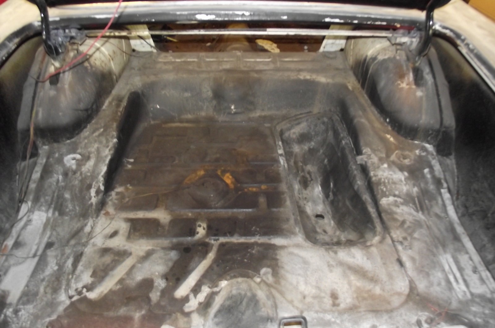

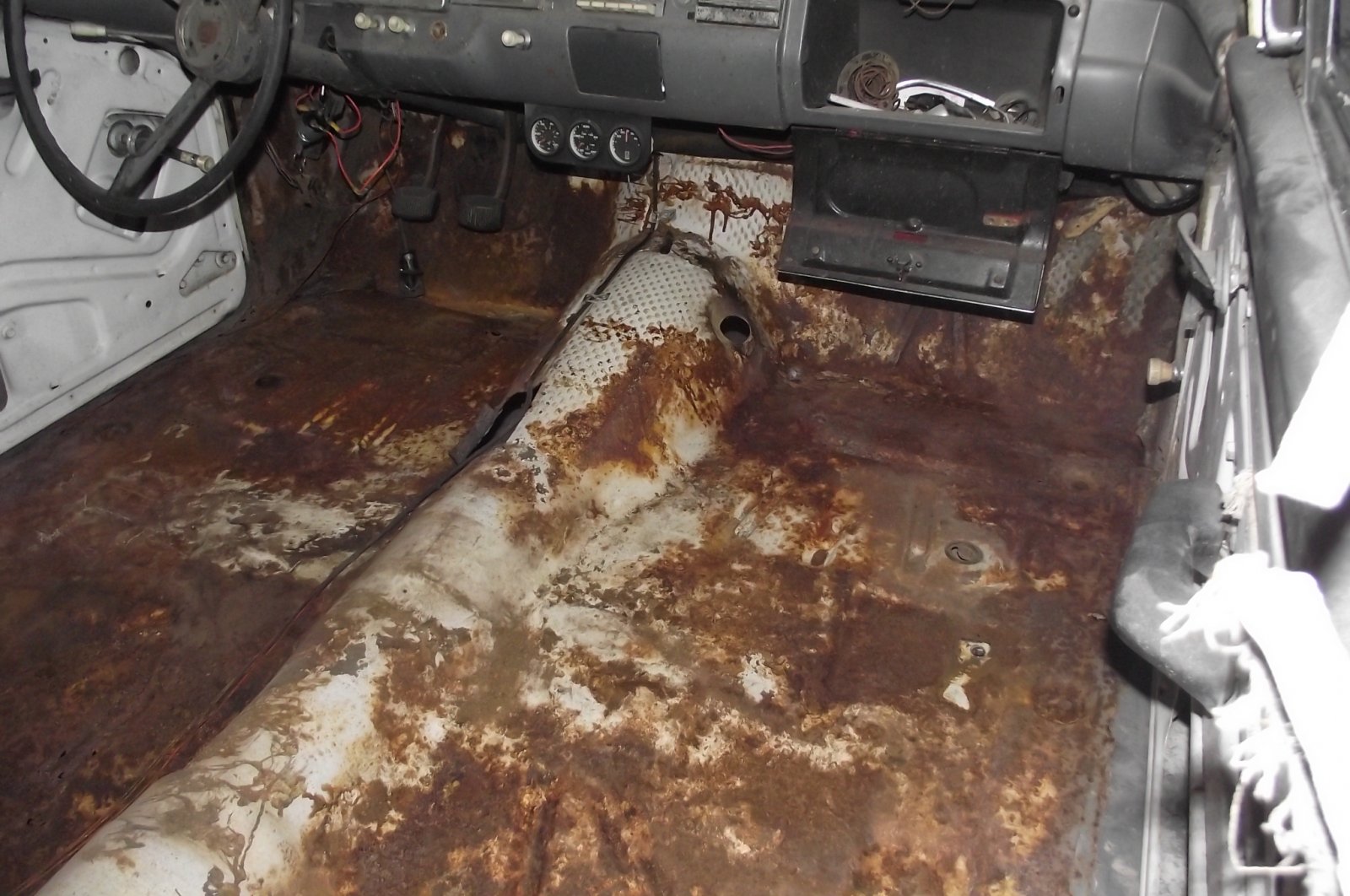

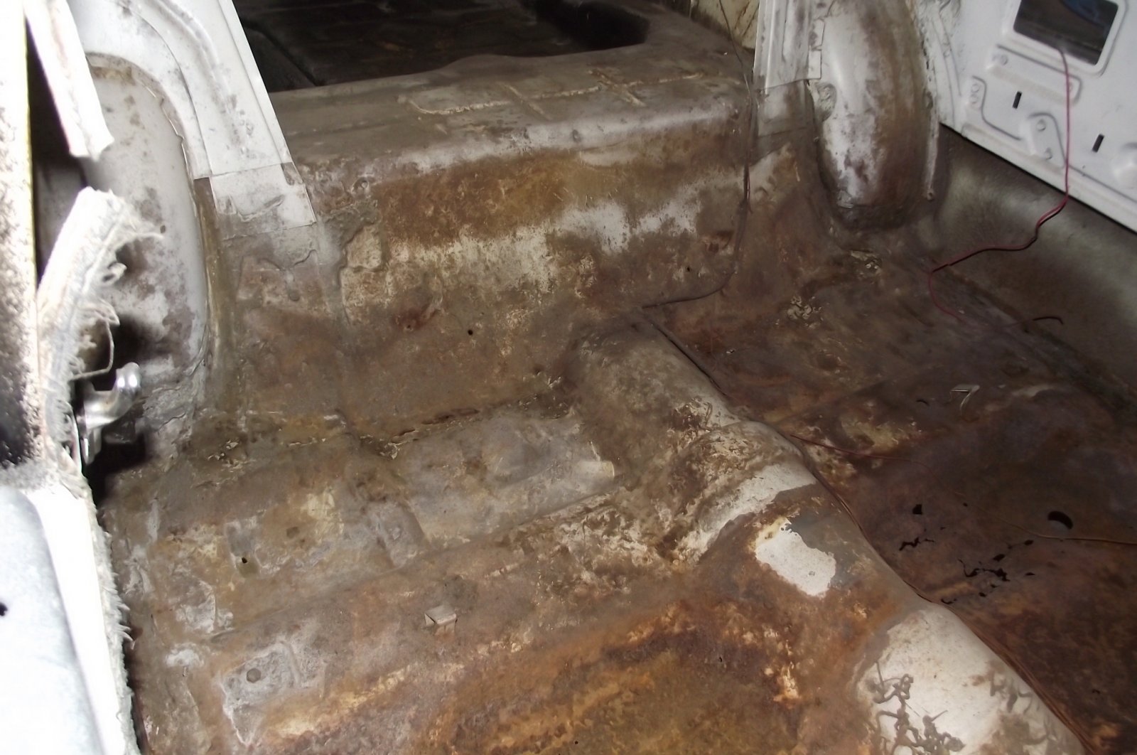

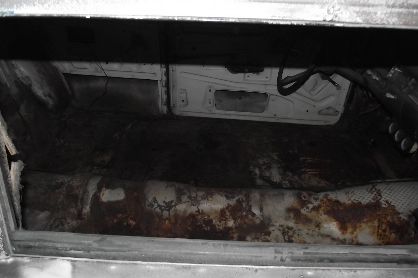

    Cleaned and started****essing the floors on the 59 Ford, I am pleased over all with the condition of the sheet metal on this car. Not perfect but much better than the 56 wagon I just did. Found an outfit that makes floor panels for these old beasts , It will be a luxury to weld in a new panel rather than what ever I could find. There isn't a lot out there for the 59s.

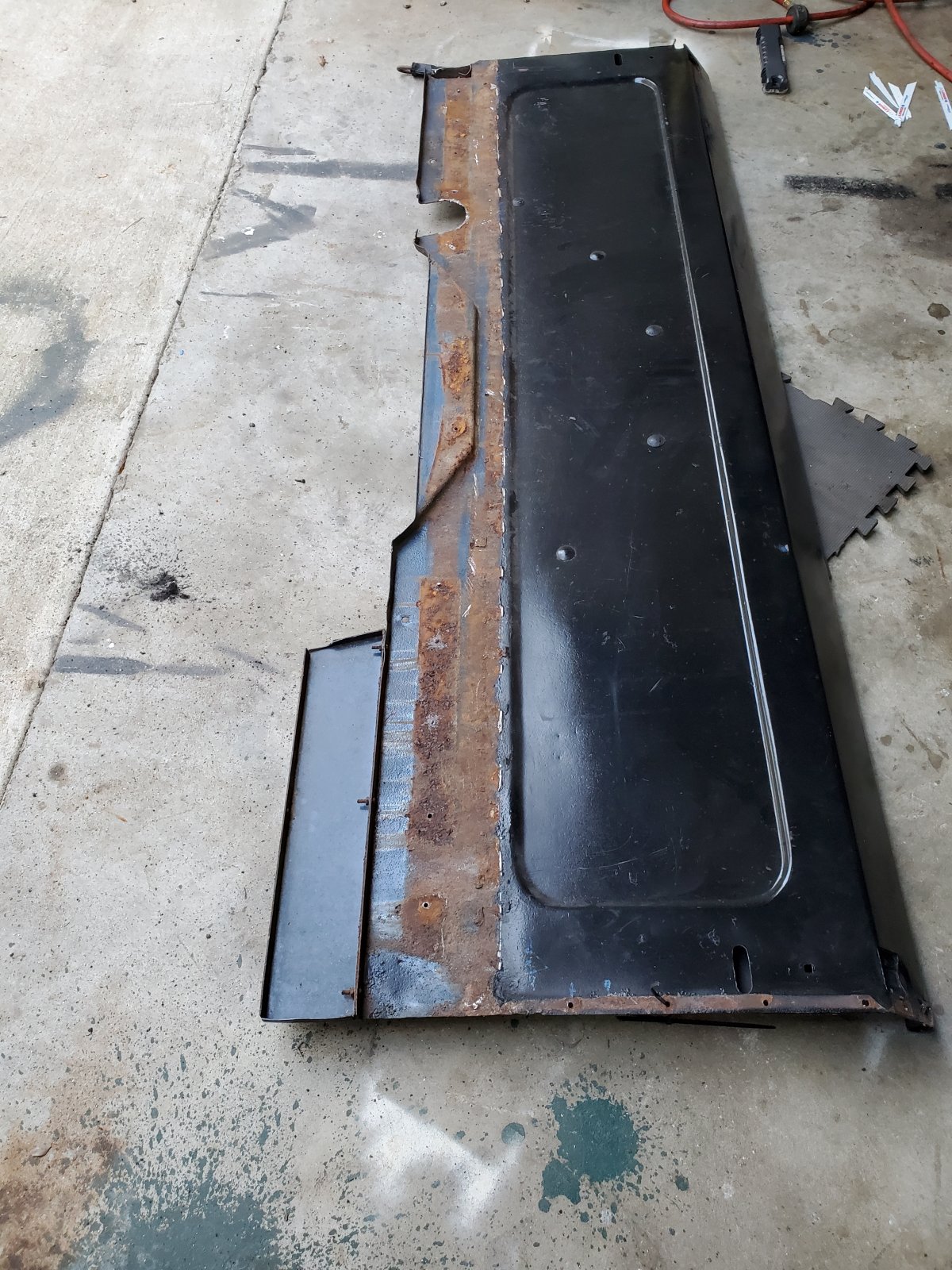

    Removed bed side , was going good , removing rivits till saw that someone welded the bed side to the bed sub frame right at gas tank outlet, and about 6 inches from the rear so ended up removing gas tank and got the welds ground / sawed

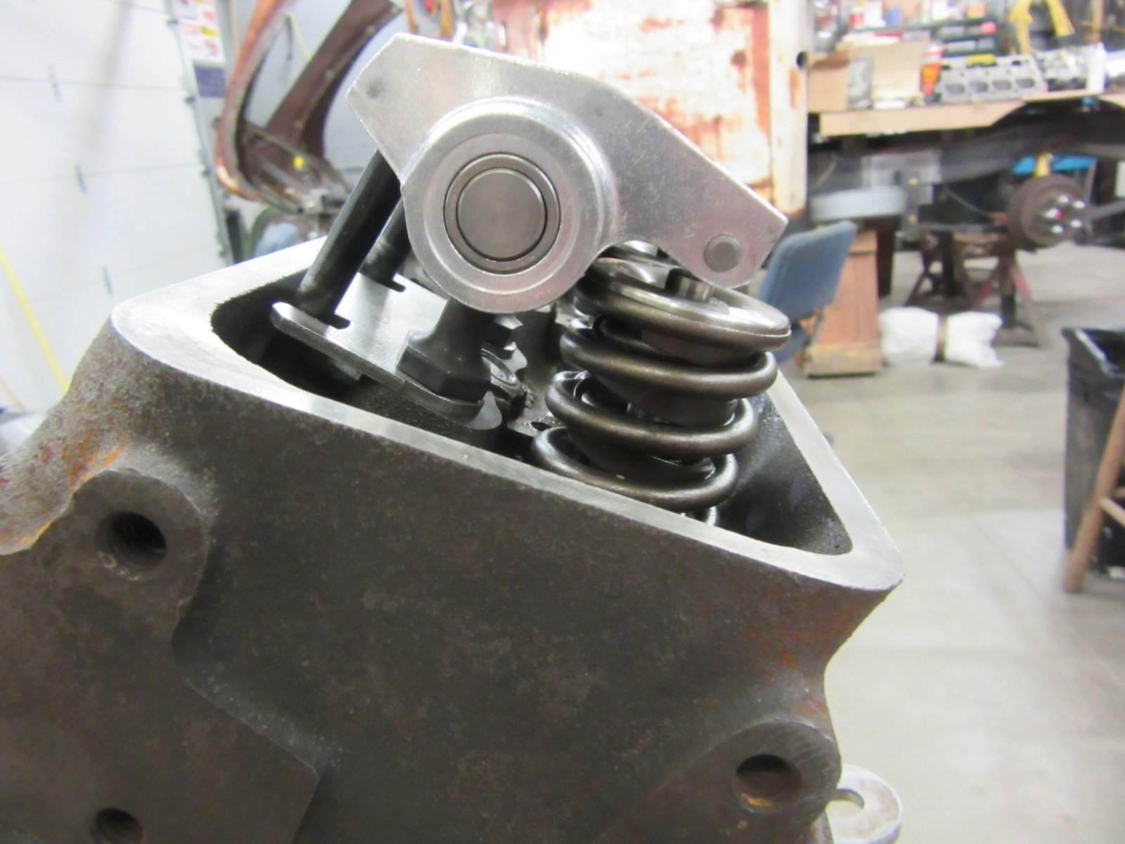

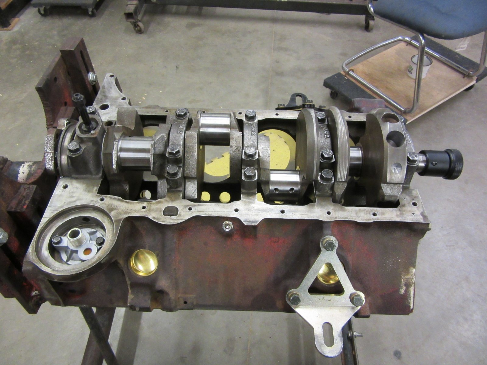

    I have been moving forward, crank is in, 3 thou. end play. Rods and pistons are in, 18 thou. side clearance. Slid the cam in to check valve clearance in a couple positions and as seen in the photo that the push rods I have are to long. No big deal someone I know will have a set. studebaker build 003.JPG

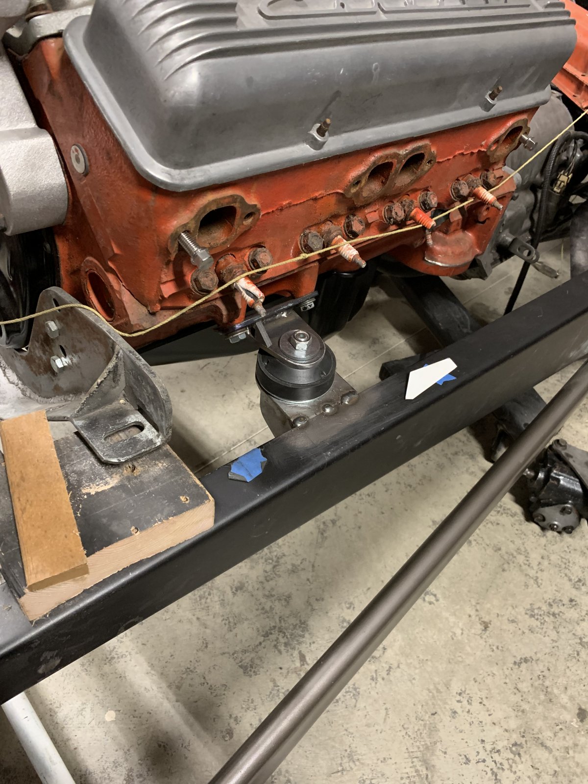

    Built the motor mounts for my coupe this past weekend. Was going to run the Hurst mount, but didn’t want to have to run additional bell housing mounts, so went with side mounts using early Ford style pads.

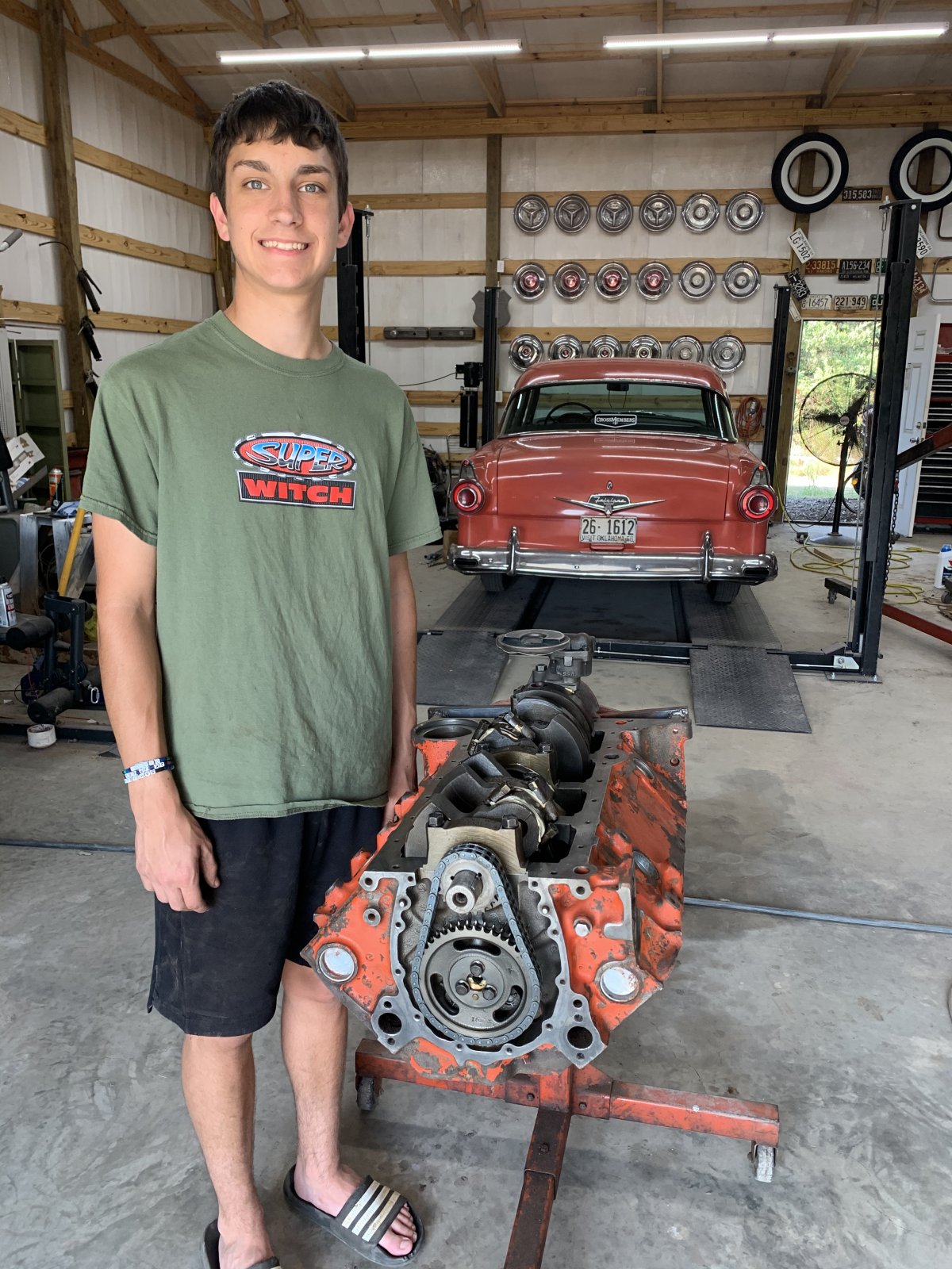

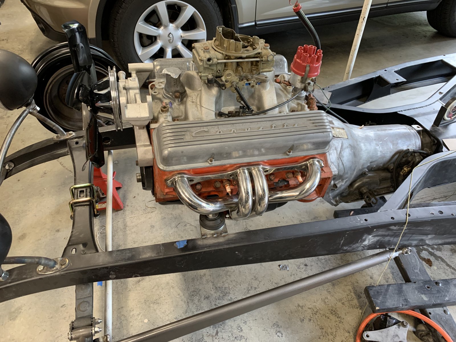

    Started back on****embling a motor that I was building about a year ago. Since I sold the vehicle it was going in, we are now*****oning it up for my 16-year-old sons car. We got the timing cover and pan on after the pic. Just need to prep a set of heads and we are about done. Notice my sons safety shoes...
  30. Wait until he drops a cylinder head on his toes...he'll learn! Remember Dad, he's at that "invincible" age, and safety shoes ain't cool.
