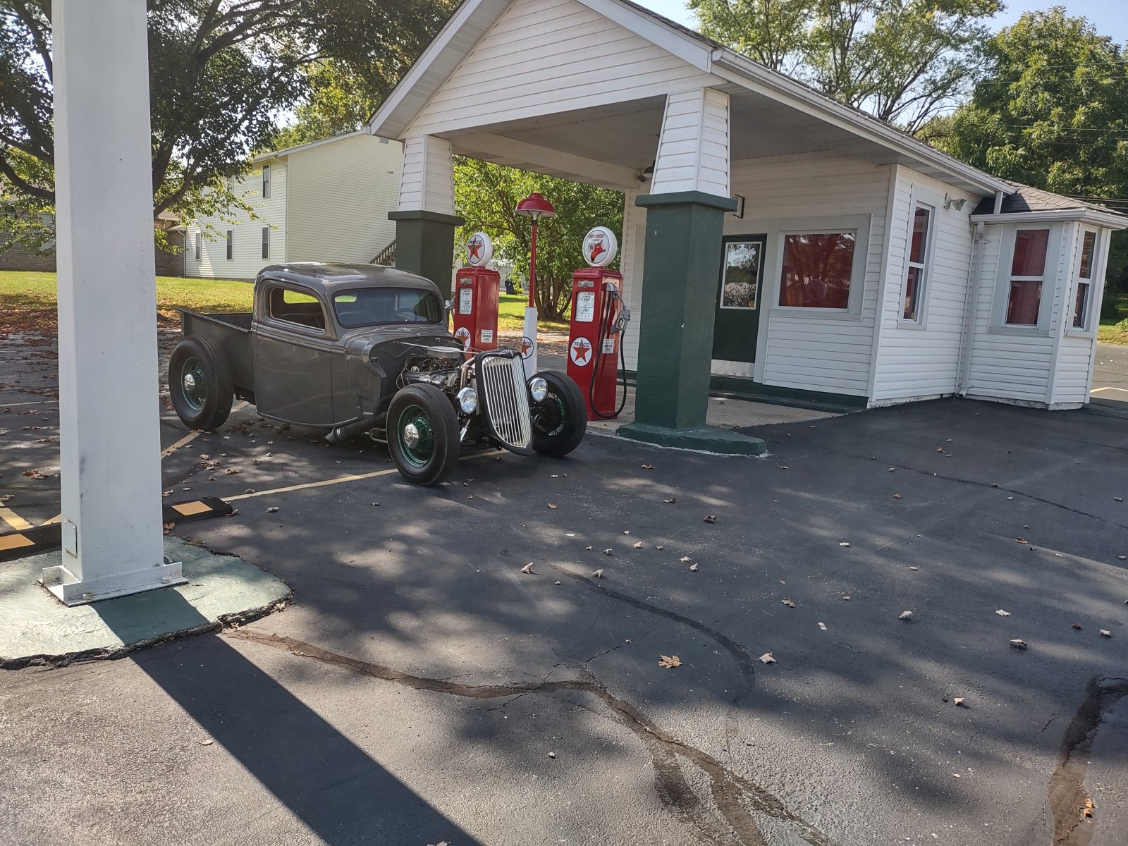

    Got some gas today

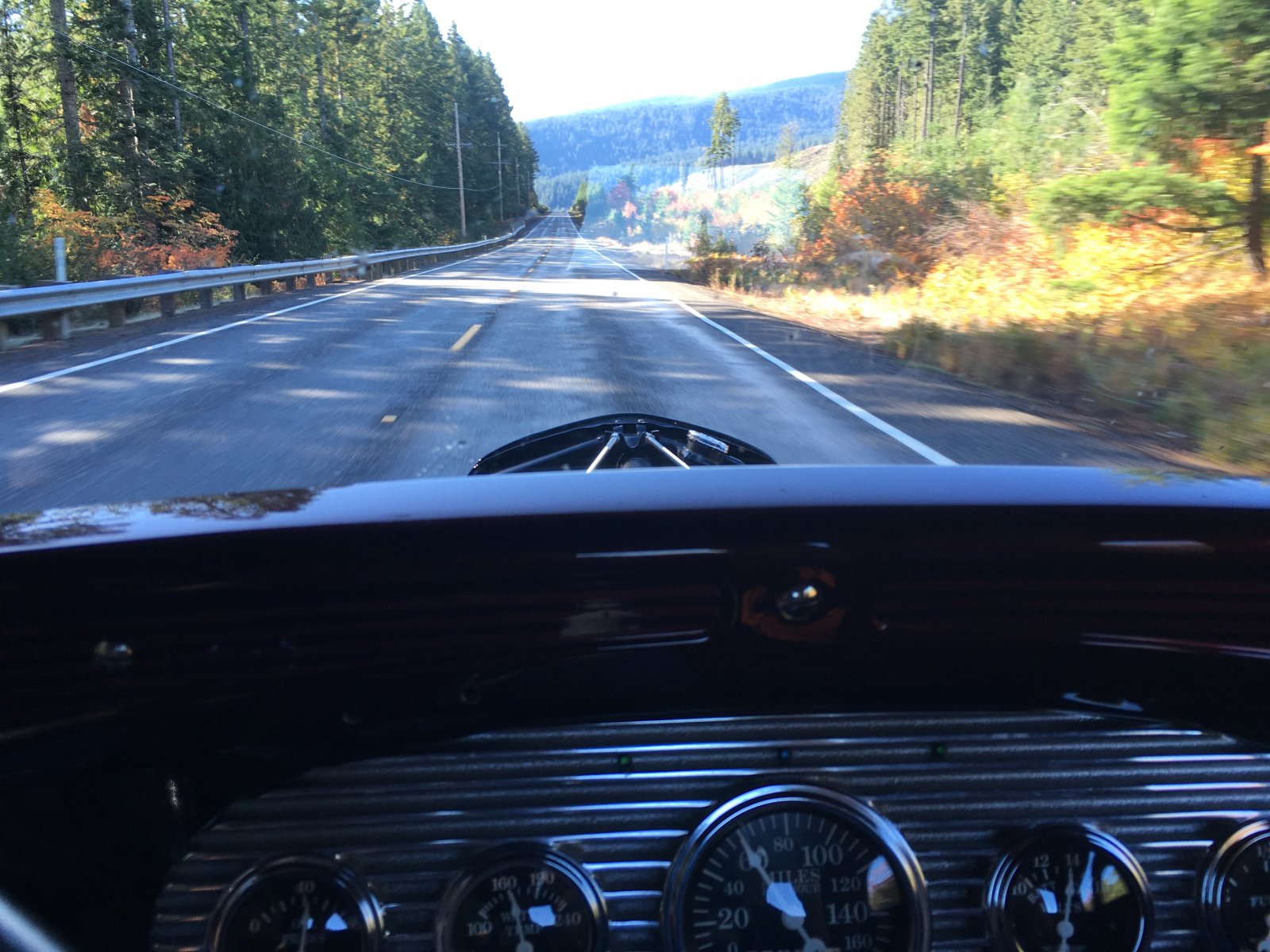

    Took a 50-mile drive in the Washington Cascades.

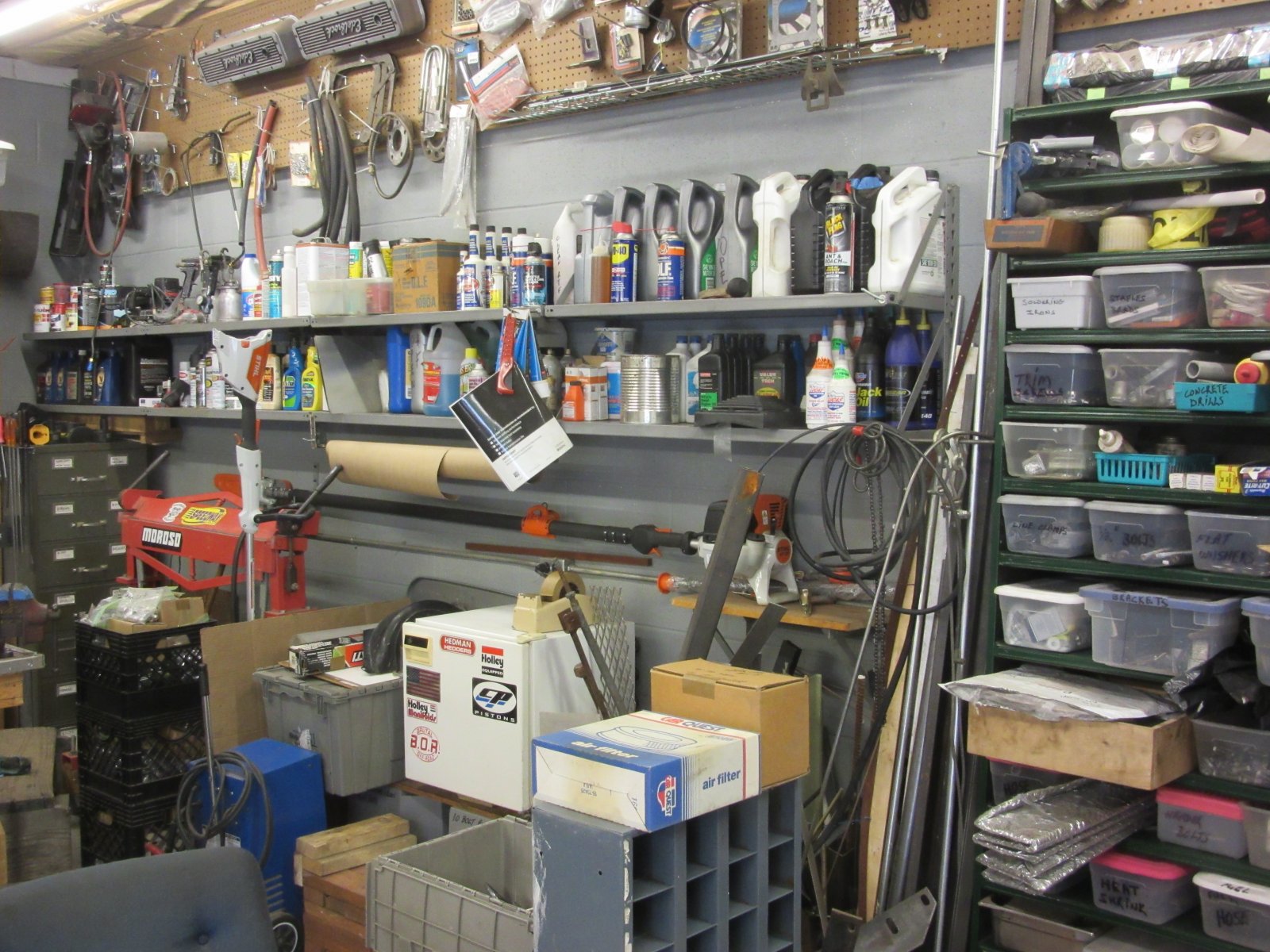

    Steady steady wins the race. Not too long now until I apply underbody coating before everything else receives colour. ;) Whilst doing this I:-
    • Did a mezzanine floor in the shed and added a shelf, another shelf to come once the hood and fenders come off the wall.

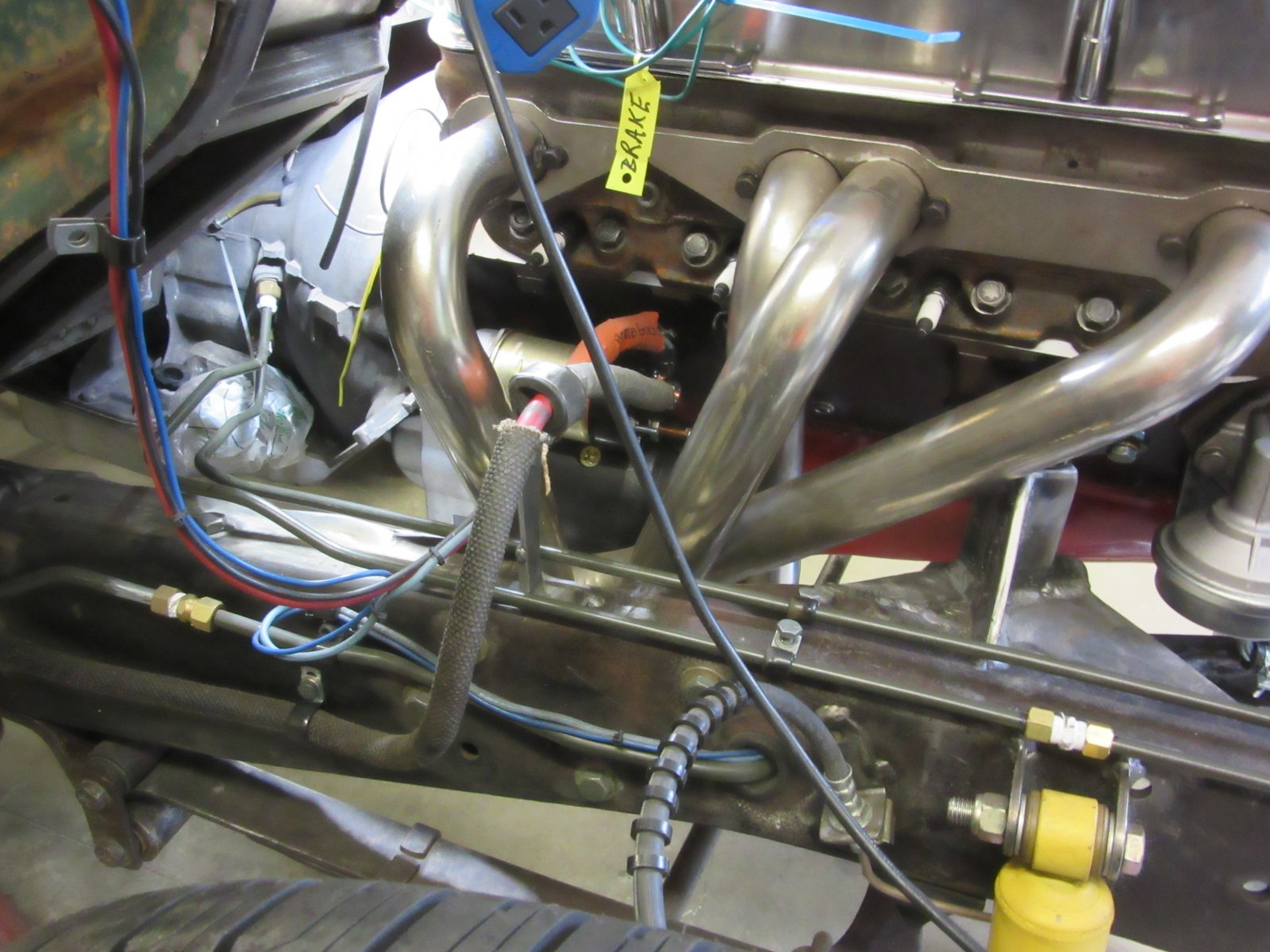

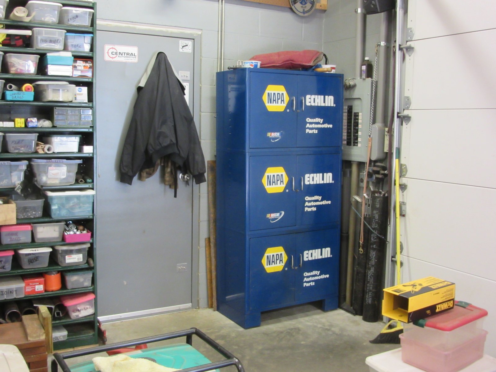

    Not much to report other than I got the starter wired up and trans lines in place. I did pick up some nice cabinets and my loving bride cleaned them up and did some rearranging /cleaning in the shop. marketplace 017.JPG marketplace 003.JPG studebaker build 001.JPG studebaker build 002.JPG

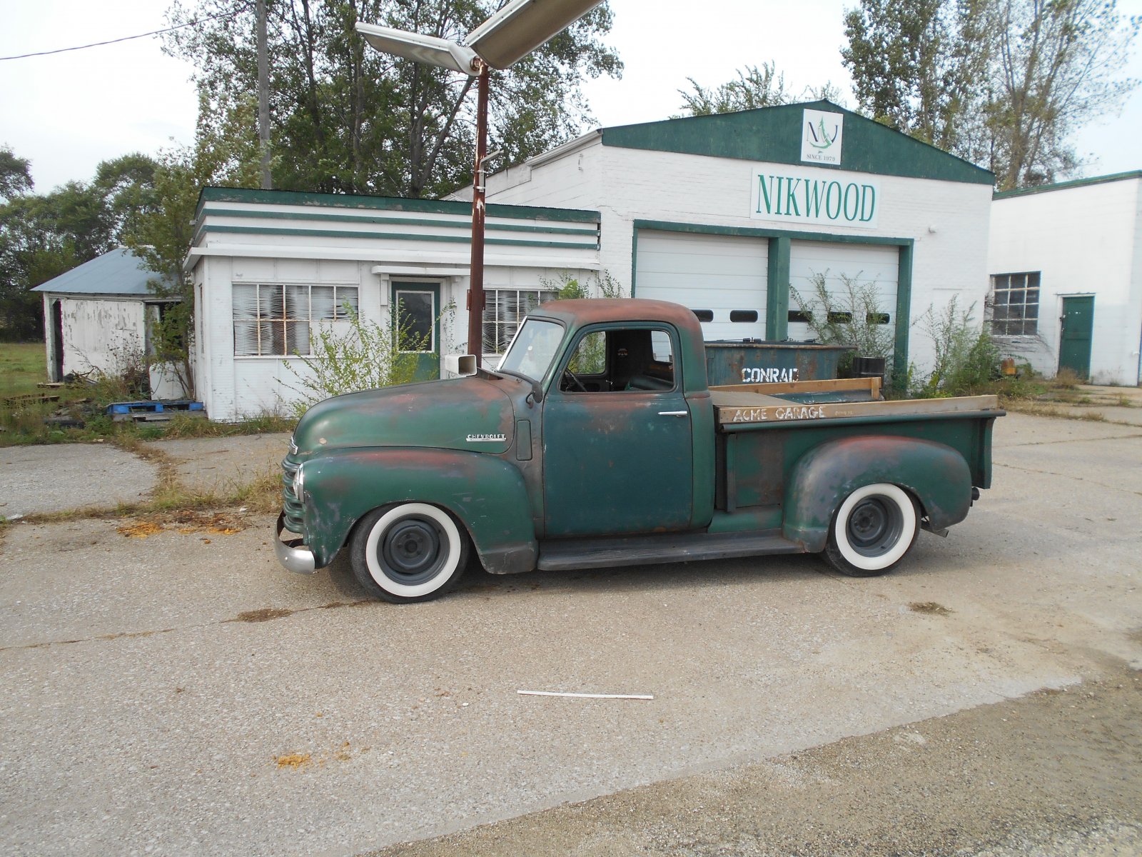

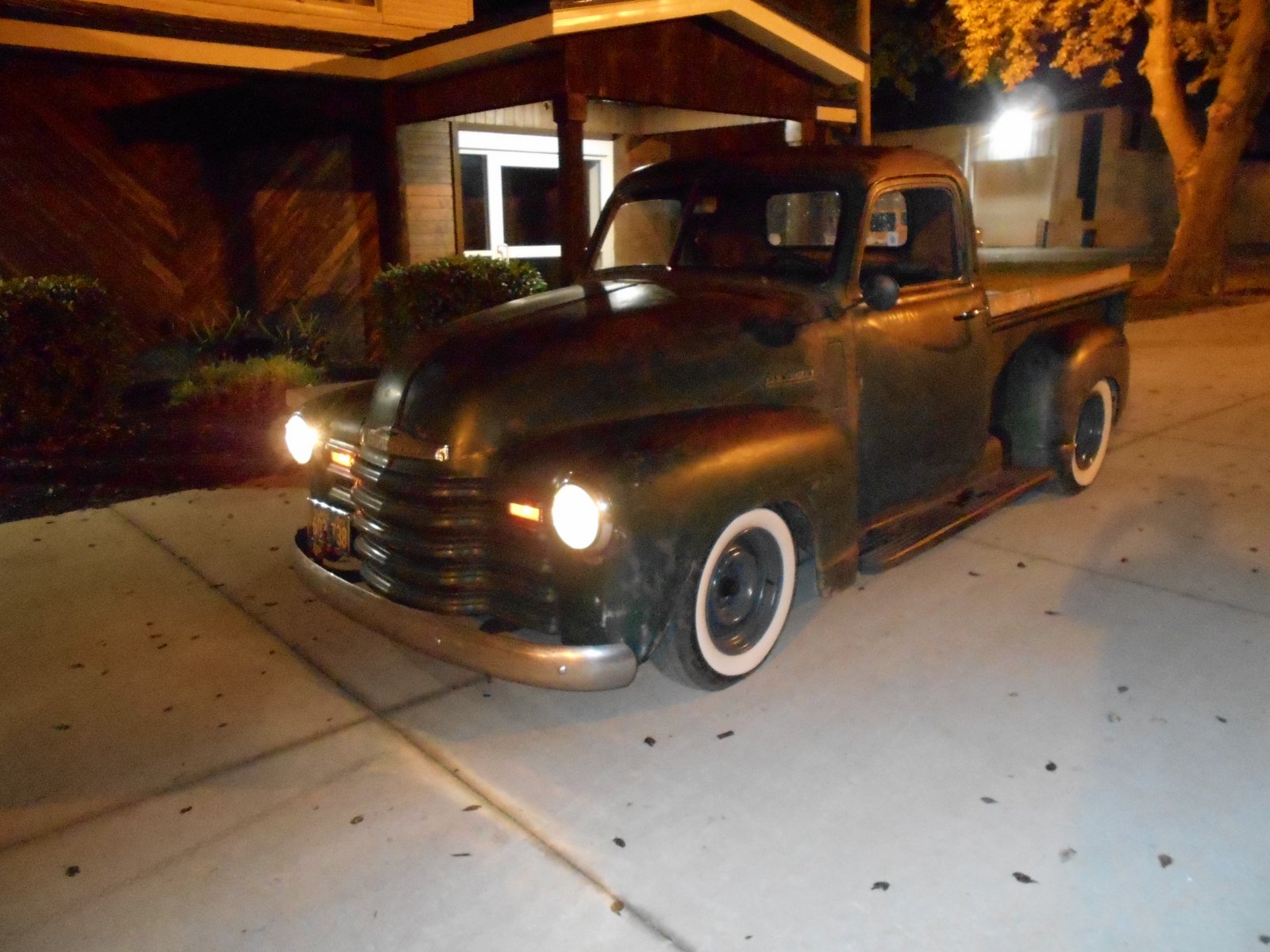

    took a few pics of my 47...

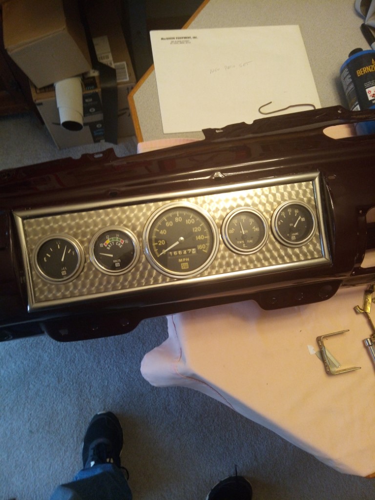

    Installed the dash panel and bezel on the '41 dash I am using in our '47. I need to figure out the indicators now; leaning toward combining the signals in one along with another for high beams. Two indicators would keep things symmetrical.

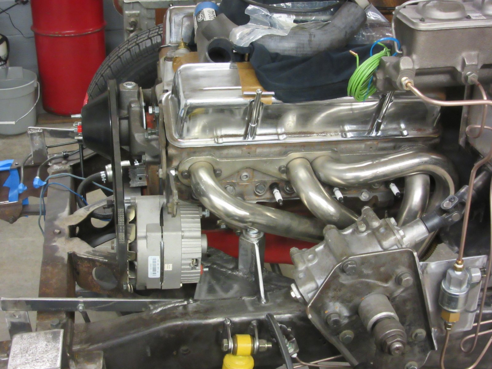

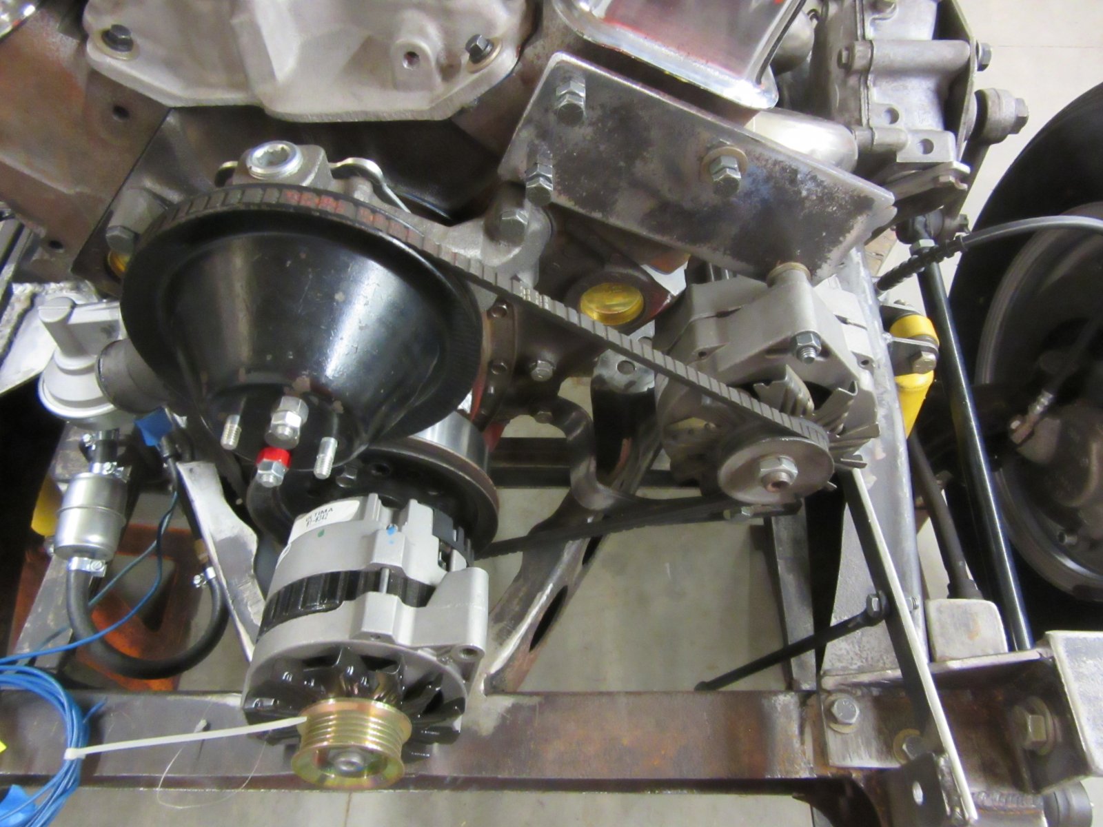

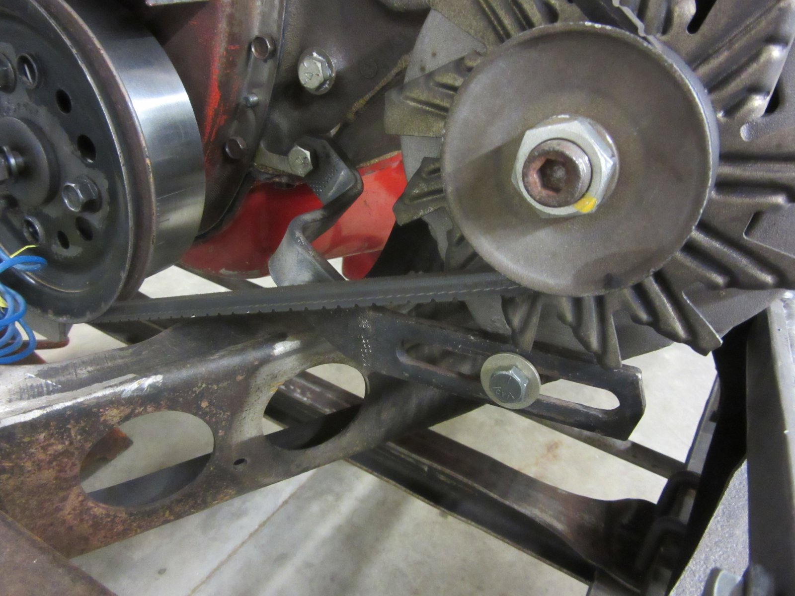

    I have been working on hanging the alternator. Now it make a bracket or two. studebaker build 001.JPG studebaker build 002.JPG

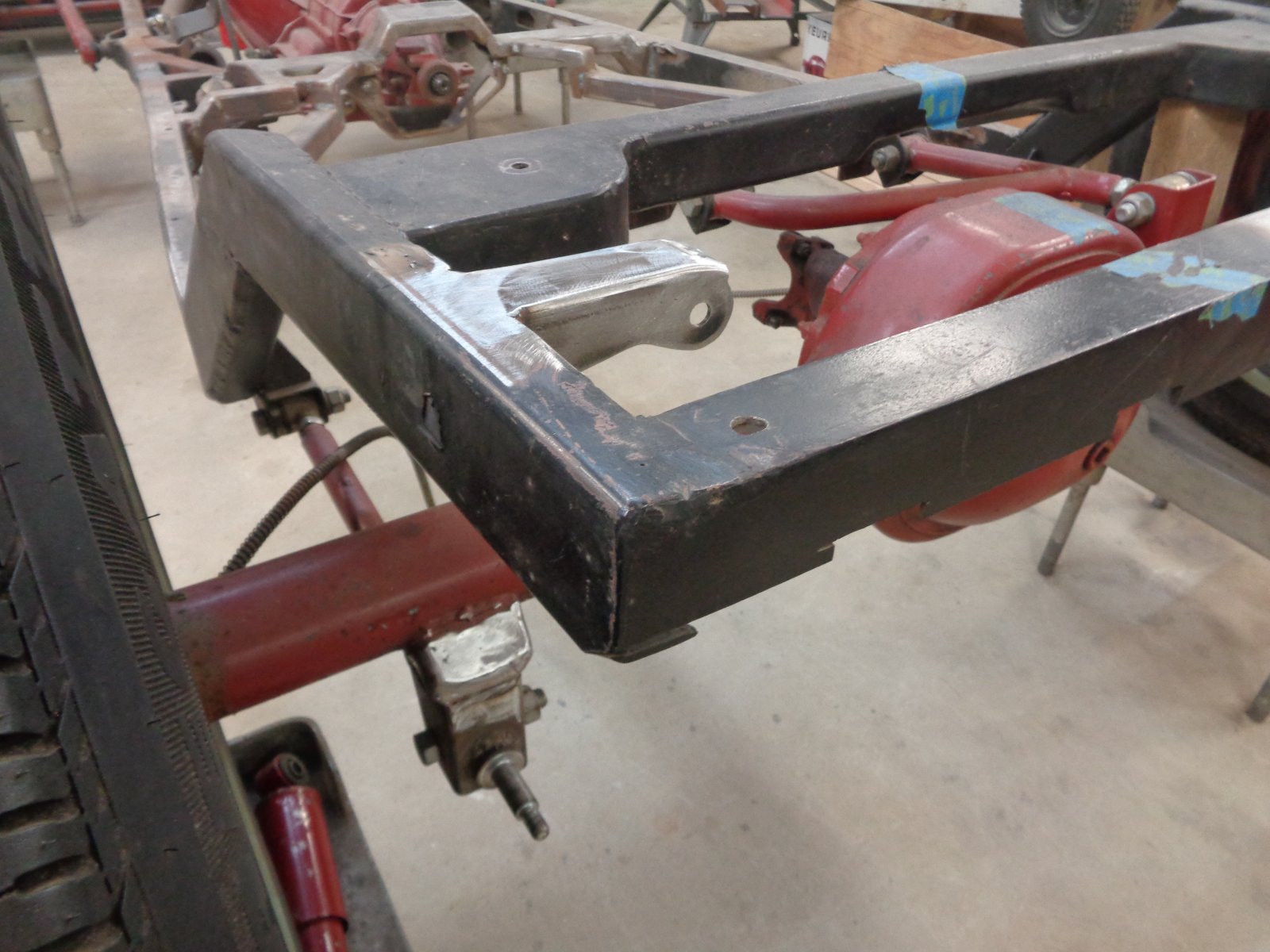

    Finished remaking my lower trailing arm mounts on the rear and making new shock mounts to move them in so the lower end will clear the body. Last thing I needed to do before stripping it to a bare frame to finish the underside welding.

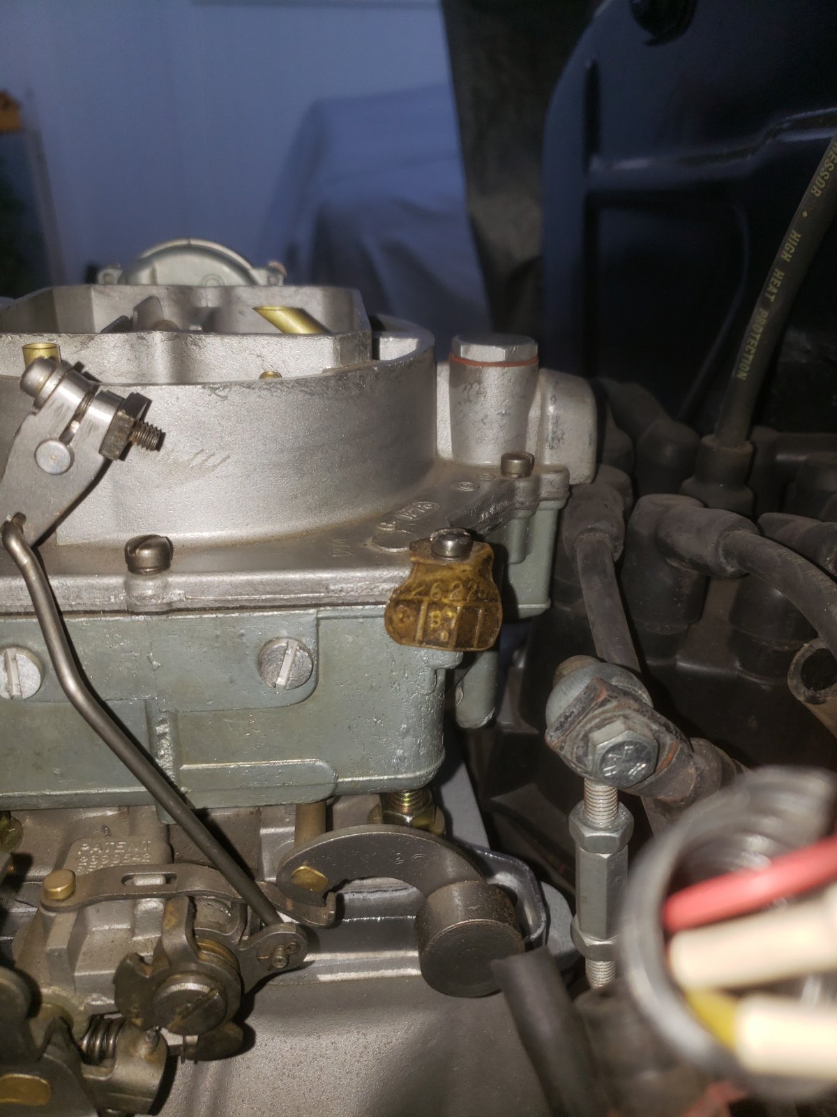

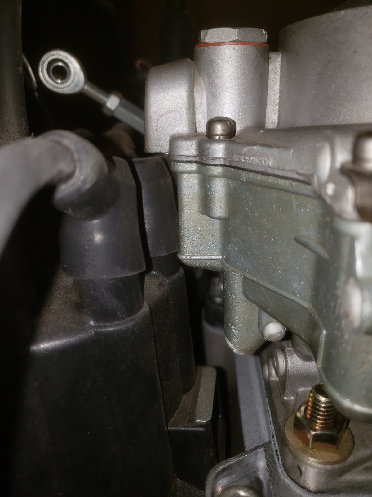

    Trial fitted a Carter WCFB carb onto the Offy dual quad manifold on the 283 in my A pickup. I picked up a matching pair of these at the last Pomona swap meet for a very nice price, and am replacing the dual Rochester 2G's that are currently on it. I ran into a little problem I wasn't expecting, interference between the back of the carb and the distributor cap.
    This photo shows the carb making contact with the cap:
    And the mounting holes are still about half way covered up:
    I went ahead and forced it into position and was able to get the bolts threaded in, but that really pinched the #1 plug wire boot, which I'm not happy with.
    I guess I'm going to order in some spacers to raise the carb up high enough so that portion of the housing will clear the cap. It will take about 1.5", which there aren't any 1.5" spacers that I've found, so I'll have to stack a couple to get there, or go with a 2" spacer, which I'd rather not do.
    The good thing is that I fired it up and it ran great. A very quick adjustment of the idle/air screws and it settled into a very smooth idle at 700 rpms, which is lower than I can get the 2GC to idle at, and dropping into drive does not kill it. And it accelerates very nicely (in neutral, sitting in the driveway, haven't driven it yet), surprisingly better than it does with the 2GC.
    One good thing about adding a carb spacer is I can drill it to gain a manifold vacuum source since these carbs only have ported vacuum, and I need manifold vacuum for the vacuum modulator and the pcv.

    How about '56 distributor with it's smaller cap or even a Mallory? Might be a better look than the spacers.

    They don't make a crab (flat) cap for those distributors?

    I was unaware that the 56 distributor was smaller. Re the Mallory, I ***ume you're talking about a vintage unit? There is a new Mallory Unilite, that might clear, but I do hate to lose the vacuum advance, for a street engine I think it's helpful.
    Note, I did locate a marine supply that sells what they claim is the equivilent of an old Mallory point style distributor, that might be an option, but I still don't know if it would clear.
    http://www.marineparts.com/p-3231-gm-bb-amp-sm-blk-points-mallory-point-distributor-v-8.aspx
    I've never seen a crab style cap for a standard Chevy distributor.

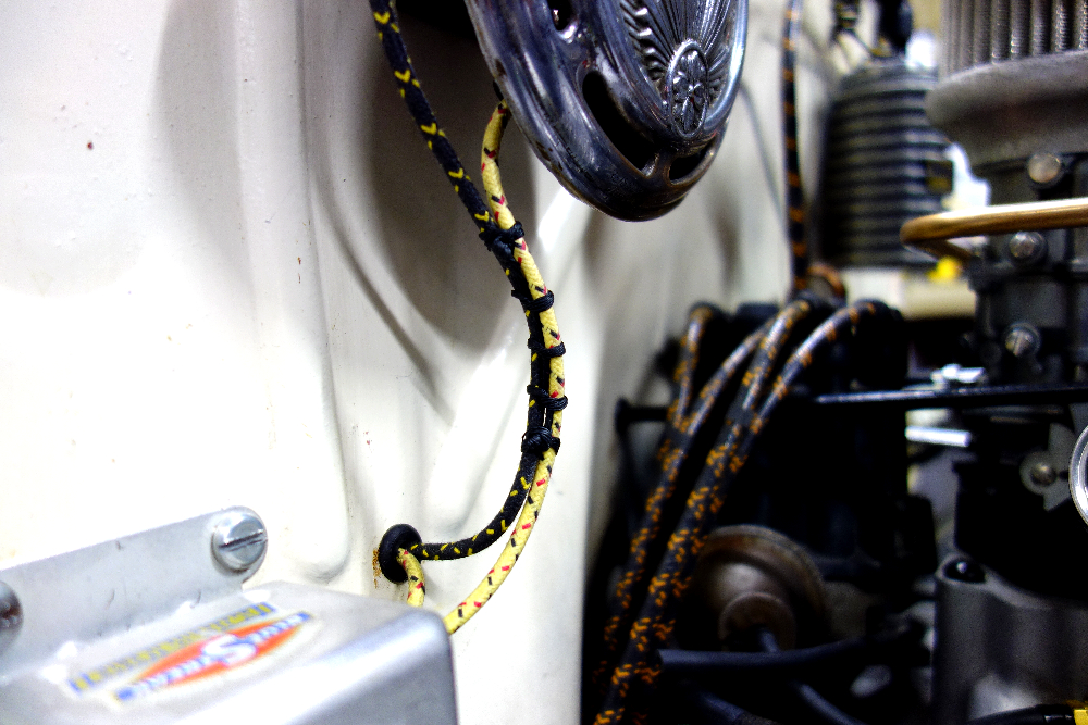

    Did a mini trial run on cable lacing my horn wires......before doing my plug wires.

    Well, after thinking about this awhile I'm thinking that it might be best to go with a Mallory distributor. Mallory isn't making the dual point distributor anymore (not that I can find), but I do have a line on a new unused dual point that I'm leaning towards buying. I'm unfamiliar with running a dual point distributor, but I think I can work it out.

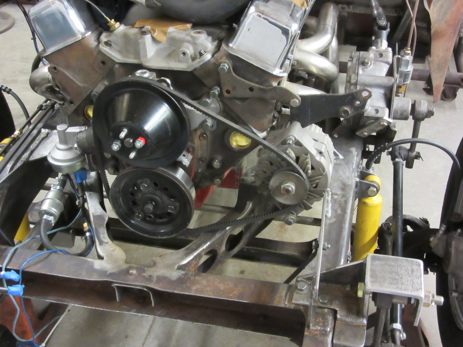

    I got the belt lined up and the brackets roughed in. I would like a little more clearance next to the block, I have a SI style alternator I am going to try as it looks to be a little smaller. Plus I dug out some pipe and a pair of collectors to see what I can do for some exhaust. Straight pipes, no mufflers and my collectors that I have had for 40 studebaker build 002.JPG STUDEBAKER BUILD 003.JPG studebaker build 003.JPG plus years They will look good sticking out at the rear cab corner.

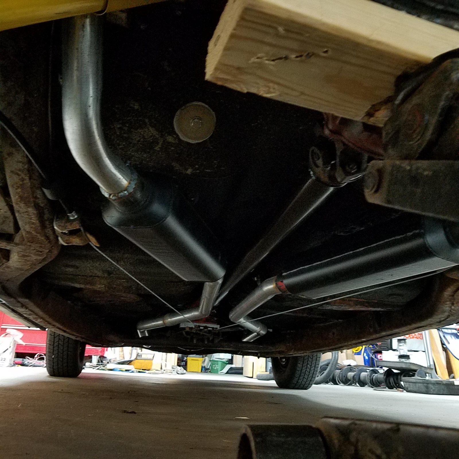

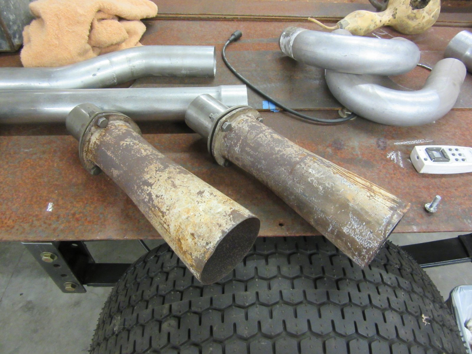

    Finally got the exhaust done on the 59. A little warmed up 352 does the noise maken'. 20211002_180912.jpg

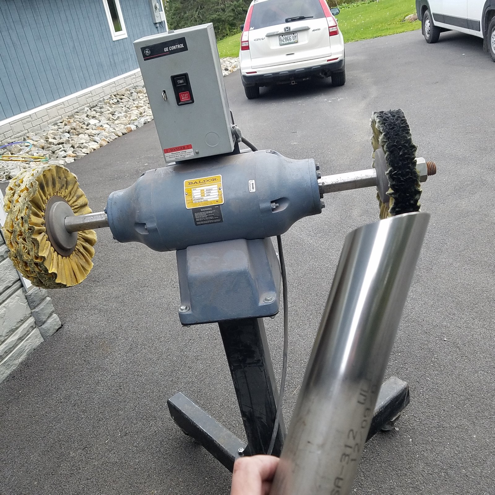

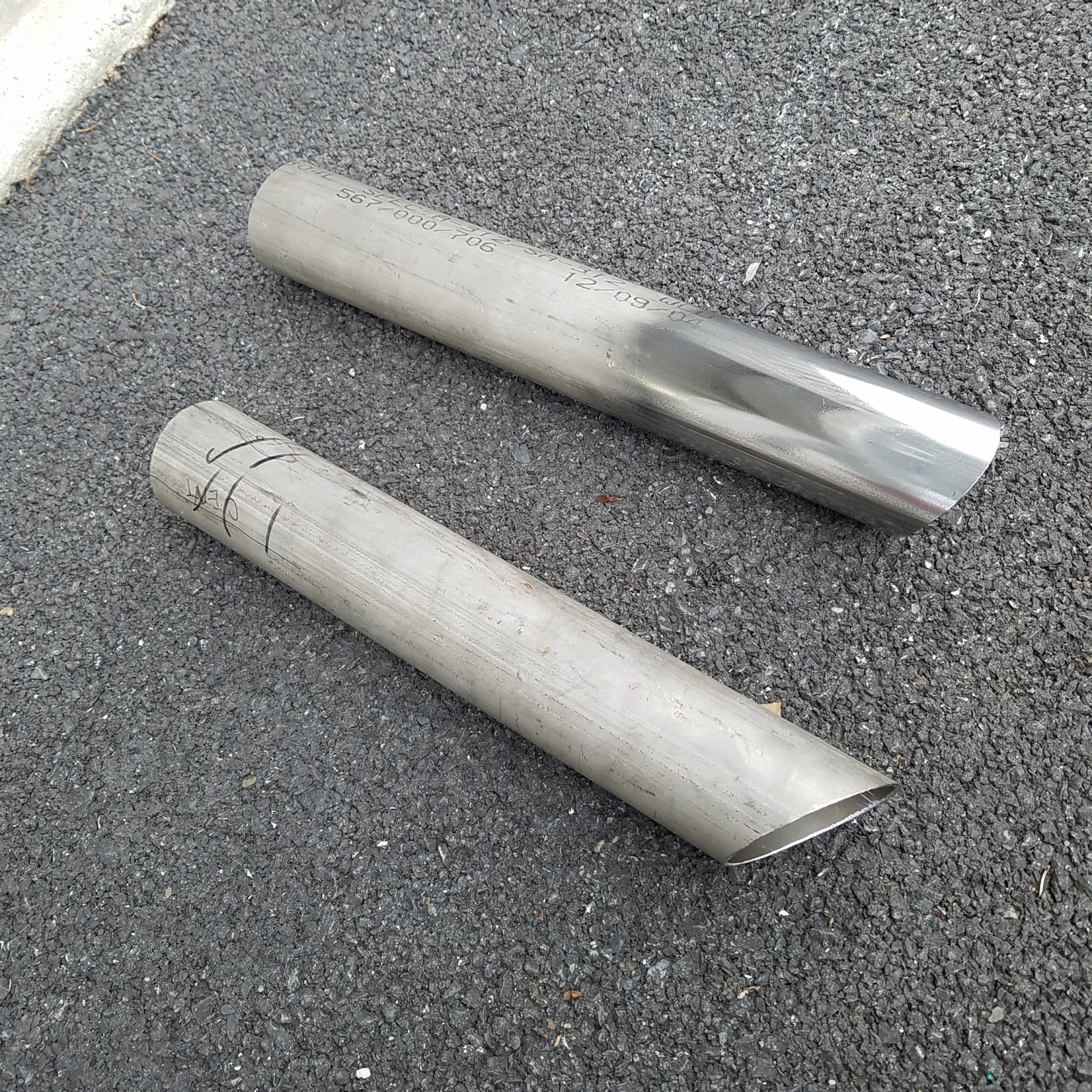

    Polished up some 2.3" 304L stainless pipe to make some tips. 20211002_164530.jpg
    The final product

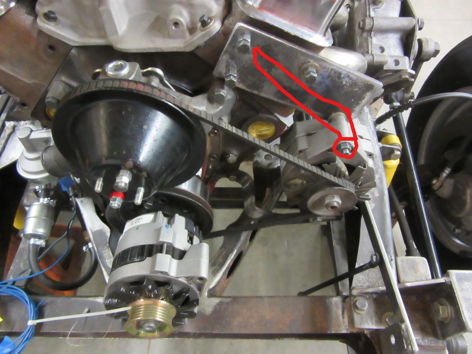

    I know you said you have just got things roughed in. This may already be in your plans. Adding a gusset that goes back across the head and out to support the end of the mounting bolt will add rigidity and strength.

    A very good suggestion. Suspending an alternator from a singe bolt is not a good idea without a brace on both ends.

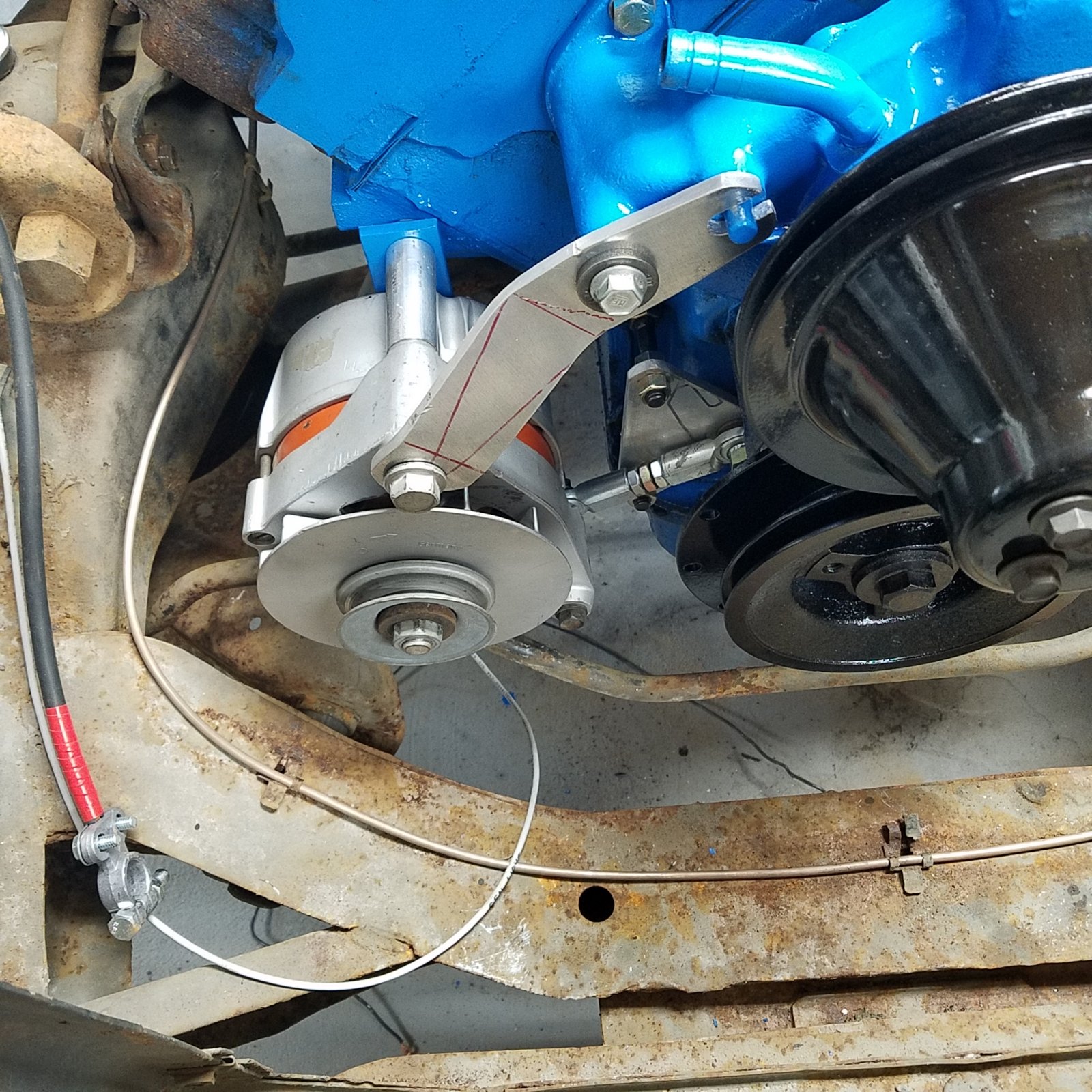

    I agree, 3 points of contact for any belt driven accessory should be considered minimum.
    I built this bracket for a 90amp Bosch alternator I had laying around from my VW days. 20200817_201624.jpg
    The bottom is the adjustment, which is a double heim joint with a bracket I made that mounts on 2 studs i put in the timing cover. 20200623_145804.jpg
