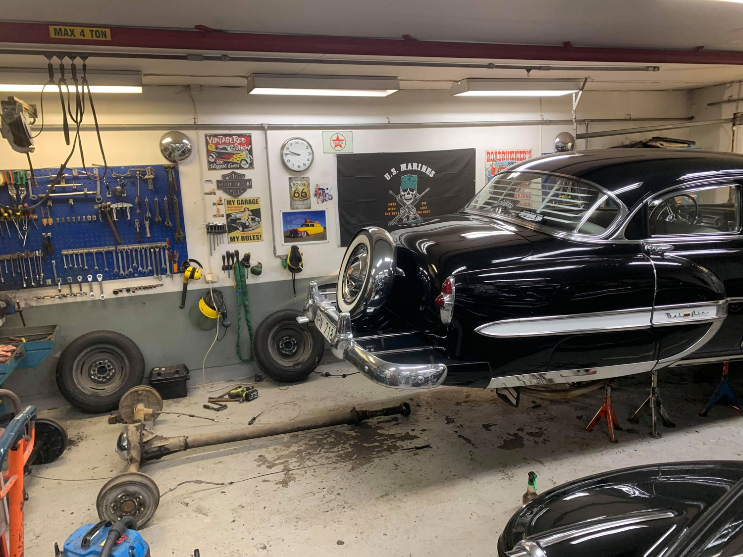

    Replace the rear axle on my -53 Chevy today. 247021115_6444174942320356_202821237519002513_n.jpg

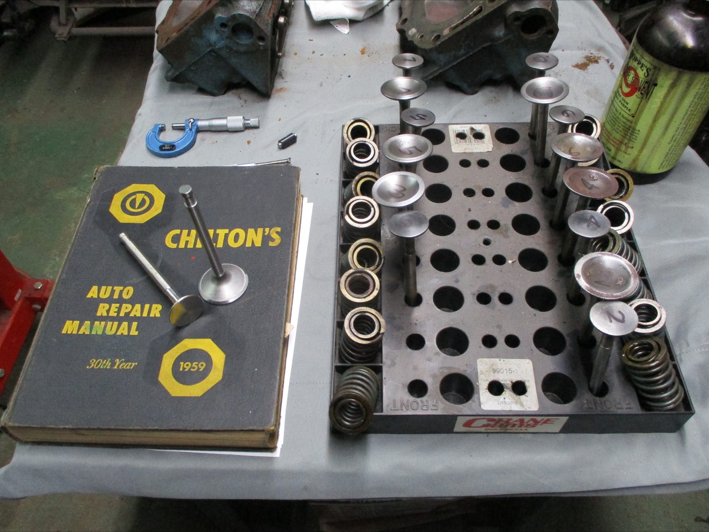

    October 28th 2021 Recalibrated my micrometer and took another go at the nailhead valve and guide measurements. Ended up being more confused then a blind man feeling his way around the elephant.
    Number one cylinder intake valve was pretty pitted so, when I ordered a new exhaust valve for the one I ******ed, I ordered an intake as well. These came from Fusick Automotive Products and now I can compare them to the existing valves.
    My new measurements were unclear but they gave me a sloppy .0005" average valve clearance between valves and guides. The new valves and guides were consistent with the old ones, however, and this was a good sign to me.
    According to my Dad's old 1959 Chiltons manual, the valve readings were closer to a 364 nailhead than a 322. This is a head scratcher to me unless replacement valve specs changed over the years. At any rate, I have enough info to take to my friend John to help me suss out.

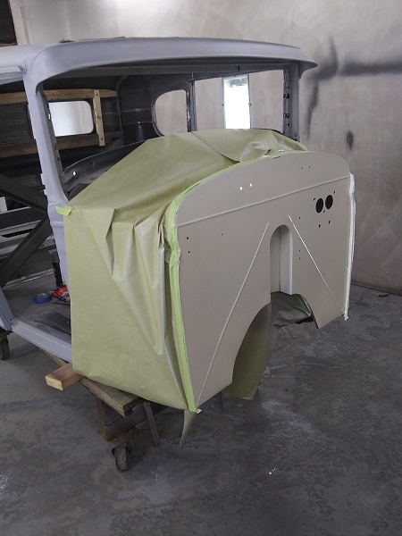

    Finally after a ten year project we put some color on the A. Wimbledon white for the firewall, black for the body maybe next week.

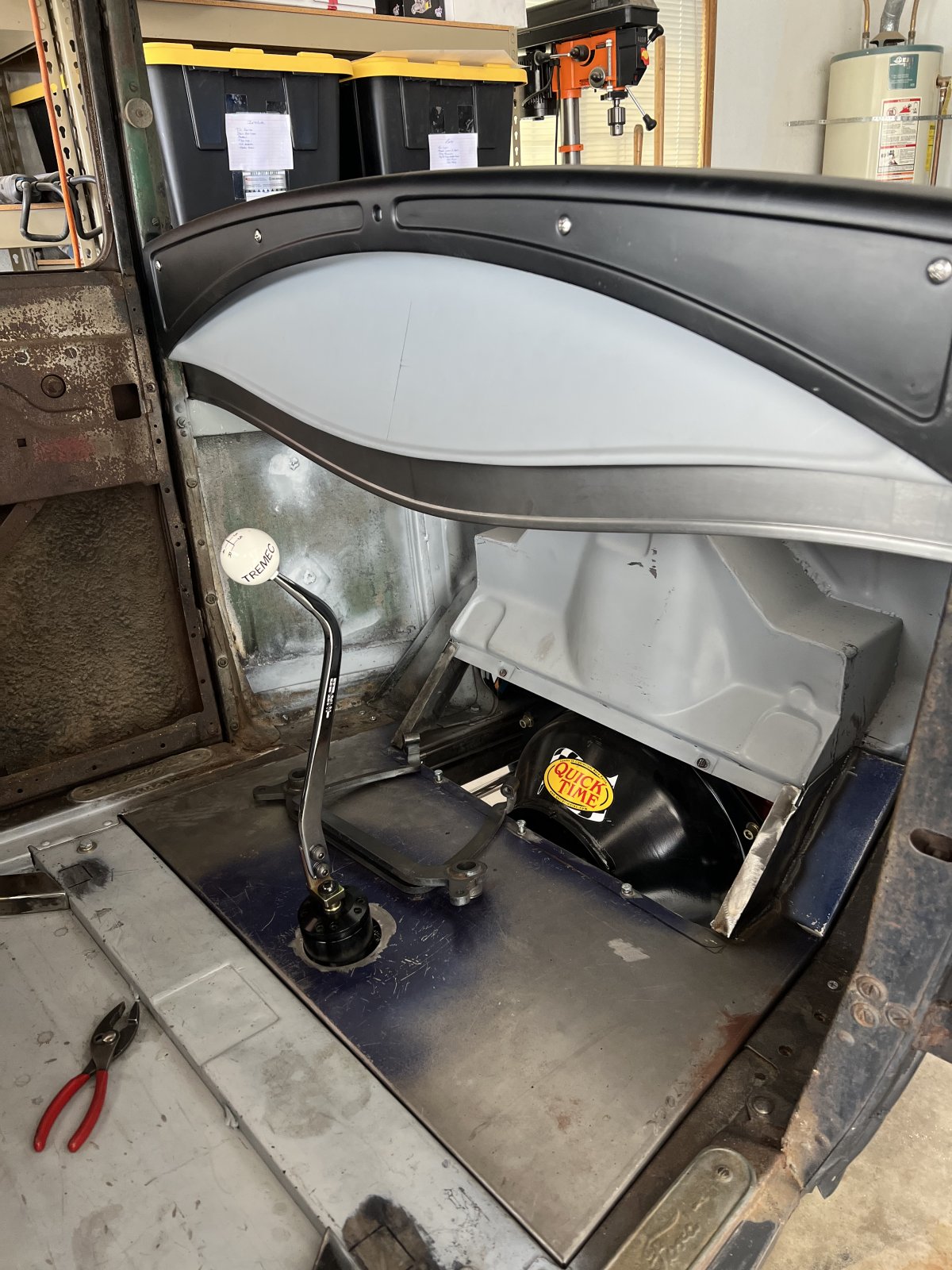

    Worked on dash today. Installed 32 dash for model A. And fitted in sub dash for switches. Also worked on seat mounts for bench seat. 15D6E235-B35F-414C-B7AA-6B4C31FA40A9.jpeg

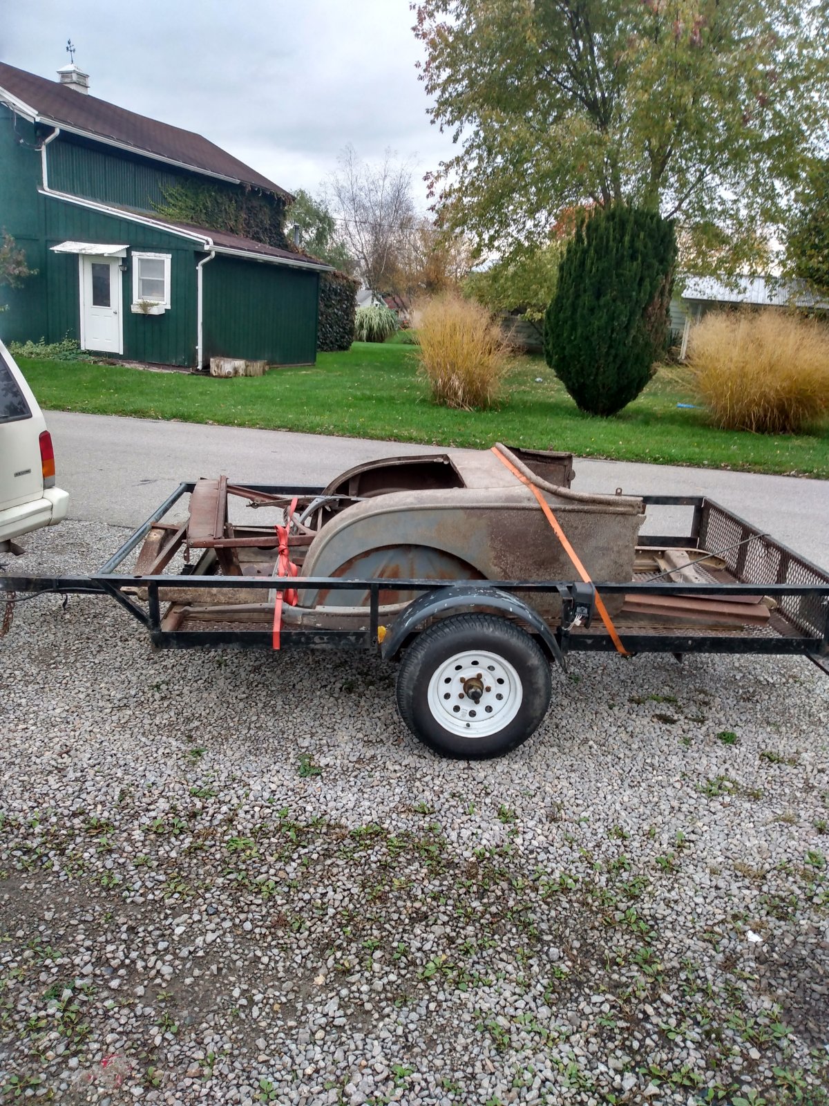

    IMG_20211030_173728331_HDR.jpg IMG_20211030_184403504.jpg may be in over my head, but i finally made the move to upgrade my roadster from gl*** T body to steel A body.
    I have the major parts for the ch***is upgrade also. Now I just need to make the time to make it happen.

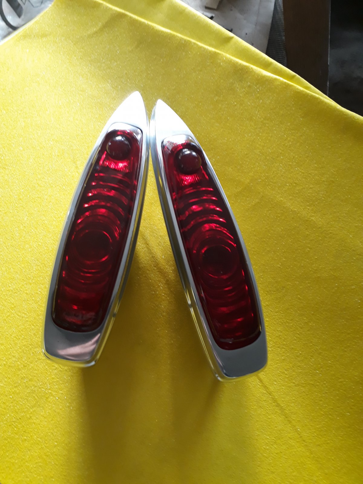

    Went to a swapmeet, with mostly american parts. Looking for 40 ford stuff in Sweden is not that easy, they where never sold new because of ww2. After twenty minutes I found something I been searching forat least two years. Taillights from Studebaker -41. Brand new repos in really good quality. I know they cost 450Dollars + shipping , toll and tax easy 600 before I have them in my hand. This was 280 dollars and igot them directly- no waitning. Score of the dav 063.jpg

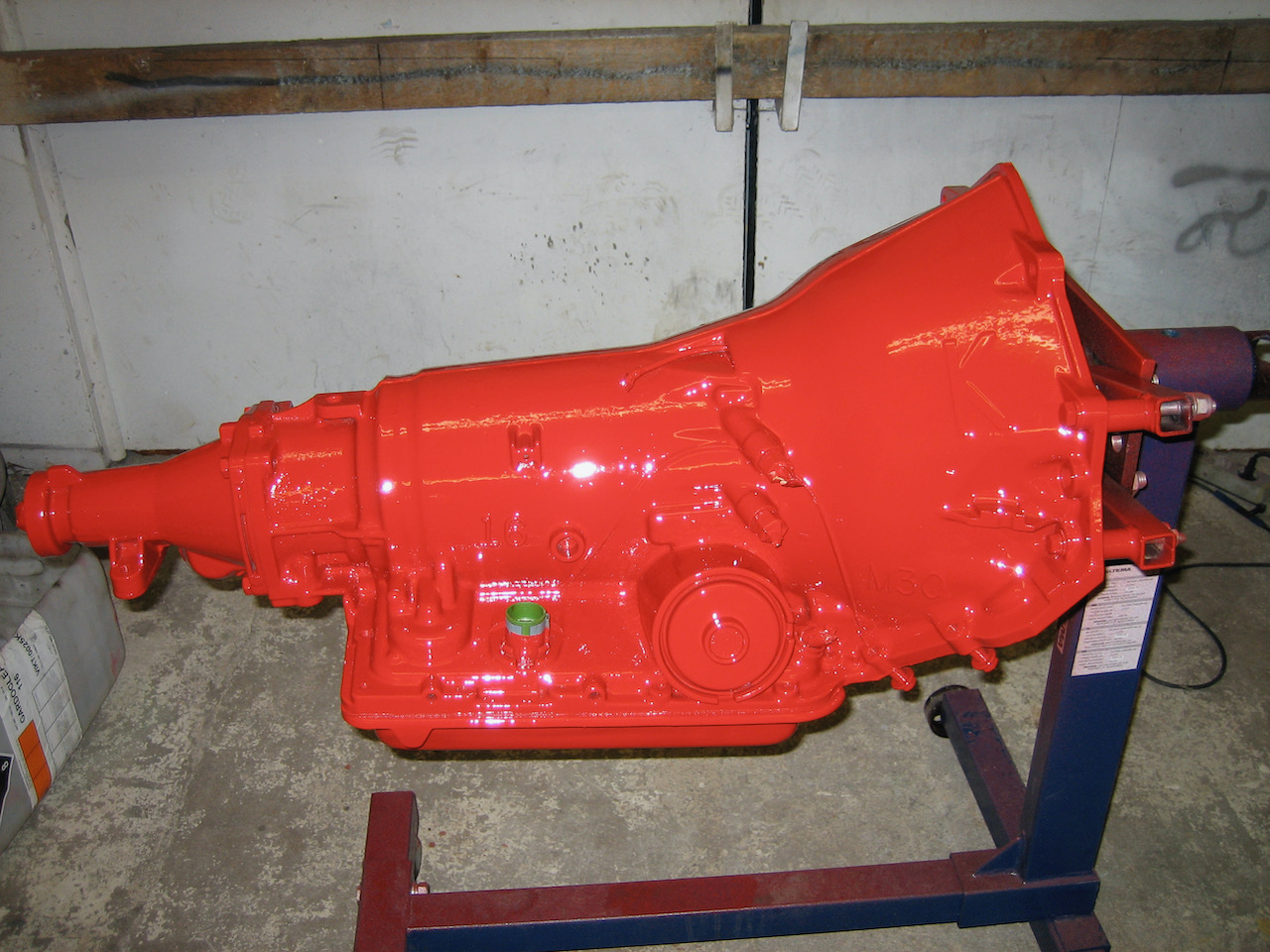

    Starting the installation of the new trans in the sunliner,it will probably nit get done as quick as I could a few years ago,

  16. Those are gonna look sweet on your '40!

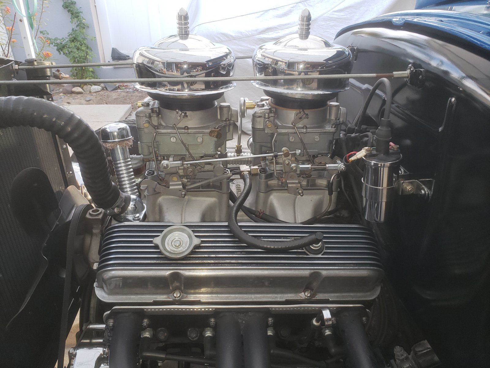

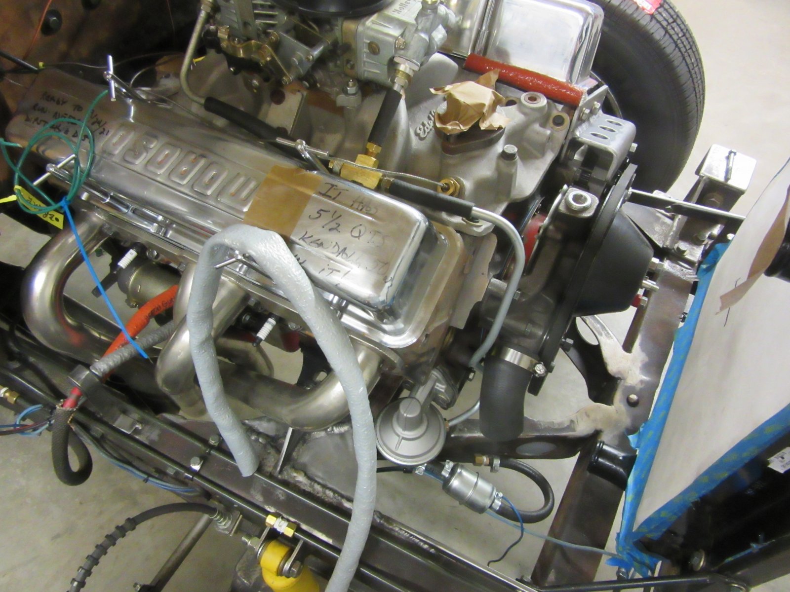

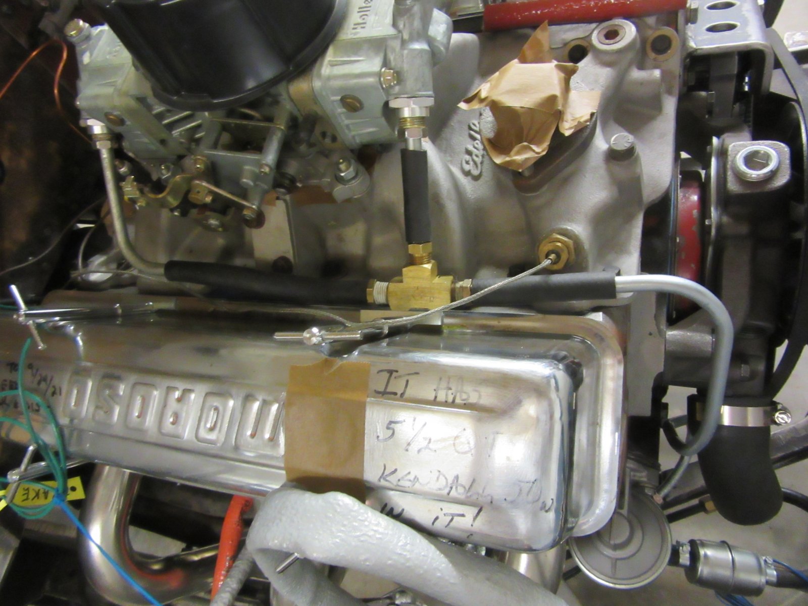

    Got the carb swap on the 283 in my A pickup mostly done, still need to hook up a choke, and will probably need to do some sorting out , but I have a few miles in on it and it runs good. My seat of the pants dyno says there isn't much, if any, more power out of them than the dual 2GC's, but there's certainly a large visual impact.

    Got the old trans out and the rebuilt one in,ran out of energy and patience so time to quit and finish it tomorrow. A couple years ago I could do all in one night but not now.

    Blues4U, ^^^^The loops on the fuel lines are a nice touch

    Thanks Lynn

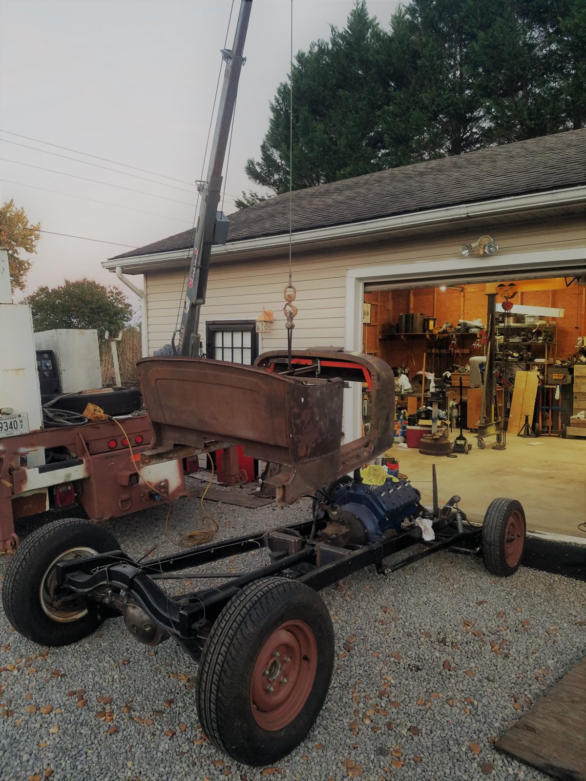

    Got the roller back on the ground so I could do a final fit for the body. Looked around and all my help had disappeared. Sometimes, you just gotta work with what you've got;) 20211101_184854.jpg

    Nice! I drove a Ford F800 service truck for about 5 years, with an IMT service body with 8600 # hydraulic crane. Your picture reminds me of those days. I kept the truck at home and often travelled directly from home to the job rather than going into the shop and being dispatched from there. That often saved the customer a lot on travel time & mileage (and saved me wear & tear on my personal vehicles). It was convenient having all my tools, plus oxy/acetylene torch set, air compressor and Miller welder all in one tidy place, a complete shop on wheels. Wish I still had that at my disposal.

    I'll sell you mine. I was replacing dock levelers for a trucking company that had 13 terminals all over the south from Memphis on the west to Raleigh, NC in the east to Columbia, SC, Birmingham, AL and points between. I looked for a truck like this for 2 years before I found it. It made me a heck of a lot of money and I didn't have to pay a helper to ride from home to the job, most of the time while he was sleeping. Didn't have to pay his motel and daily meals, either. Right now, it's serving as tool storage and comes in handy when I get the occasional welding job.

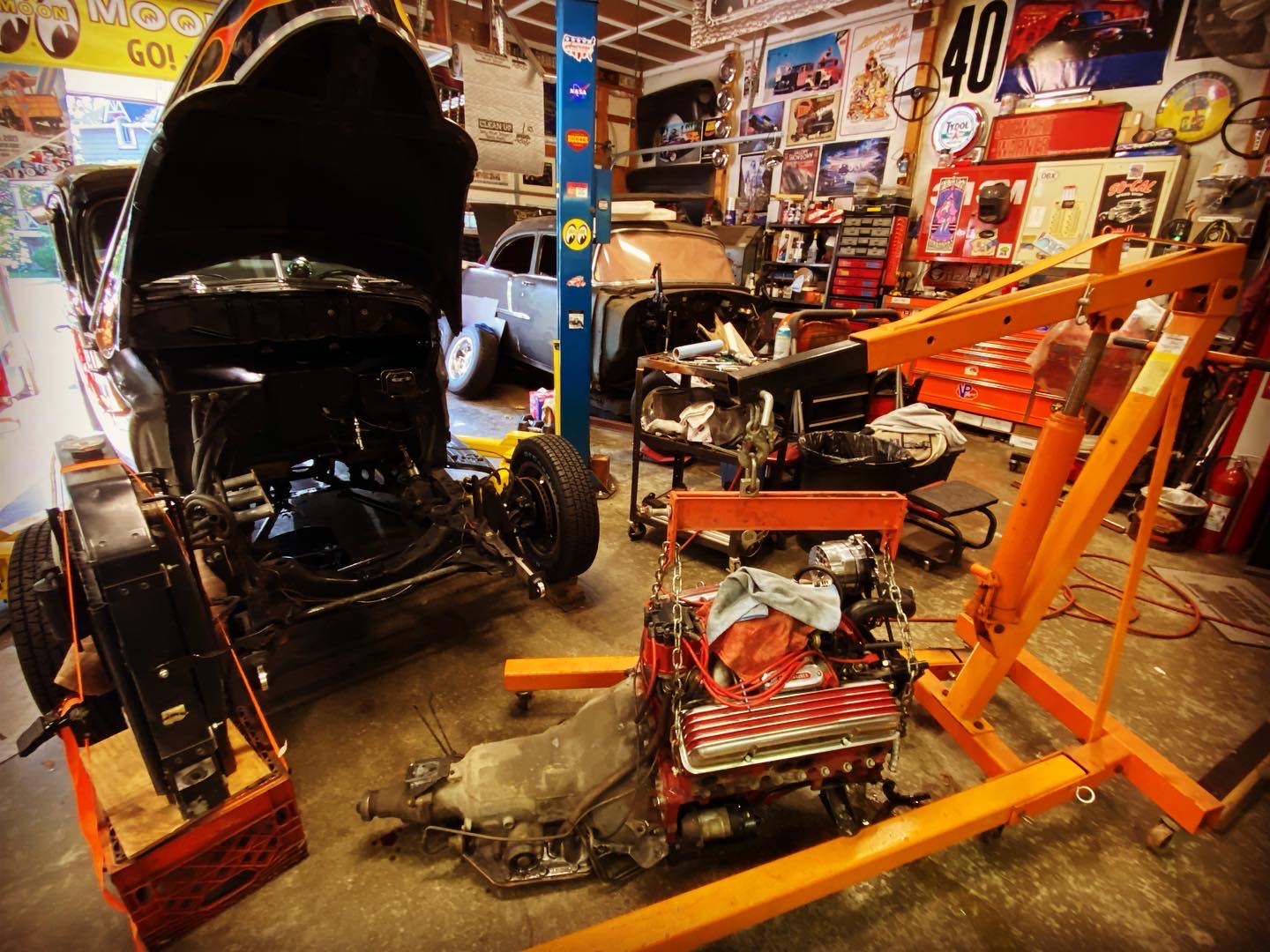

    Trying to find an oil leak. Got outa control! :rolleyes:
    1827F790-6687-46FD-8665-6A8D19F451FB.jpeg 11A1F76A-FE77-4043-82AF-0C44AF8E6B7B.jpeg
