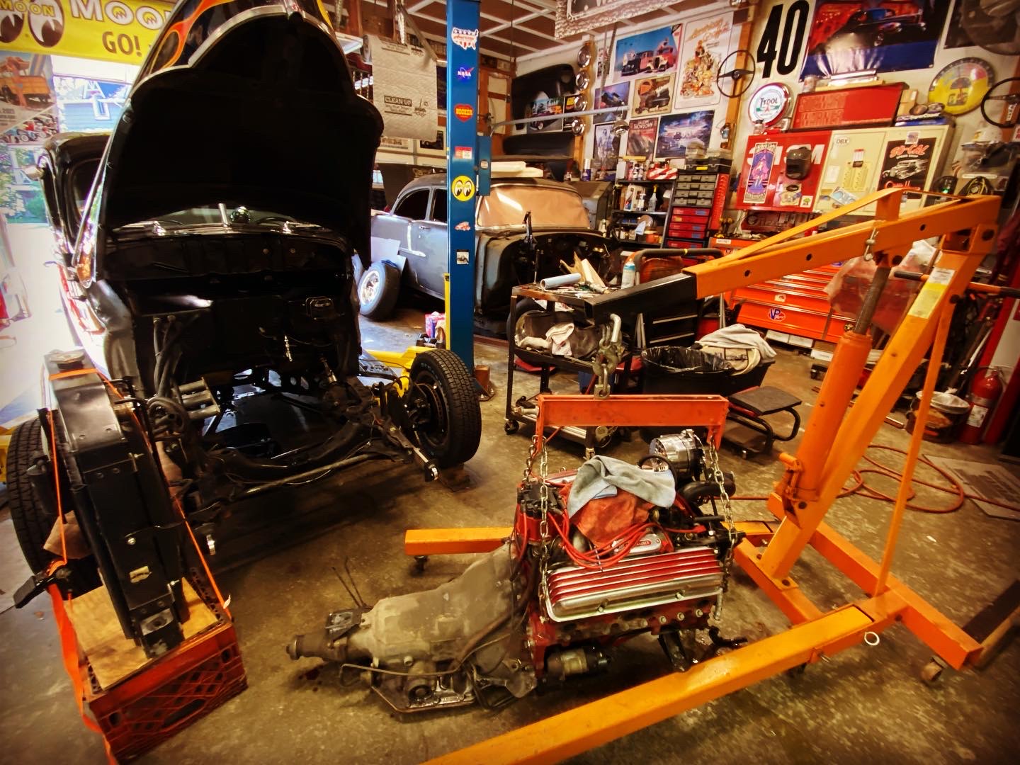

    Got the trans installation finished in the sunliner and have other things to do to it while its on the stands,its always had a exhaust leak that I think is a cracked exhaust manifold and now is the time to fix.

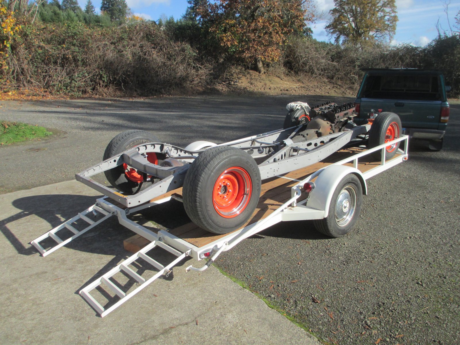

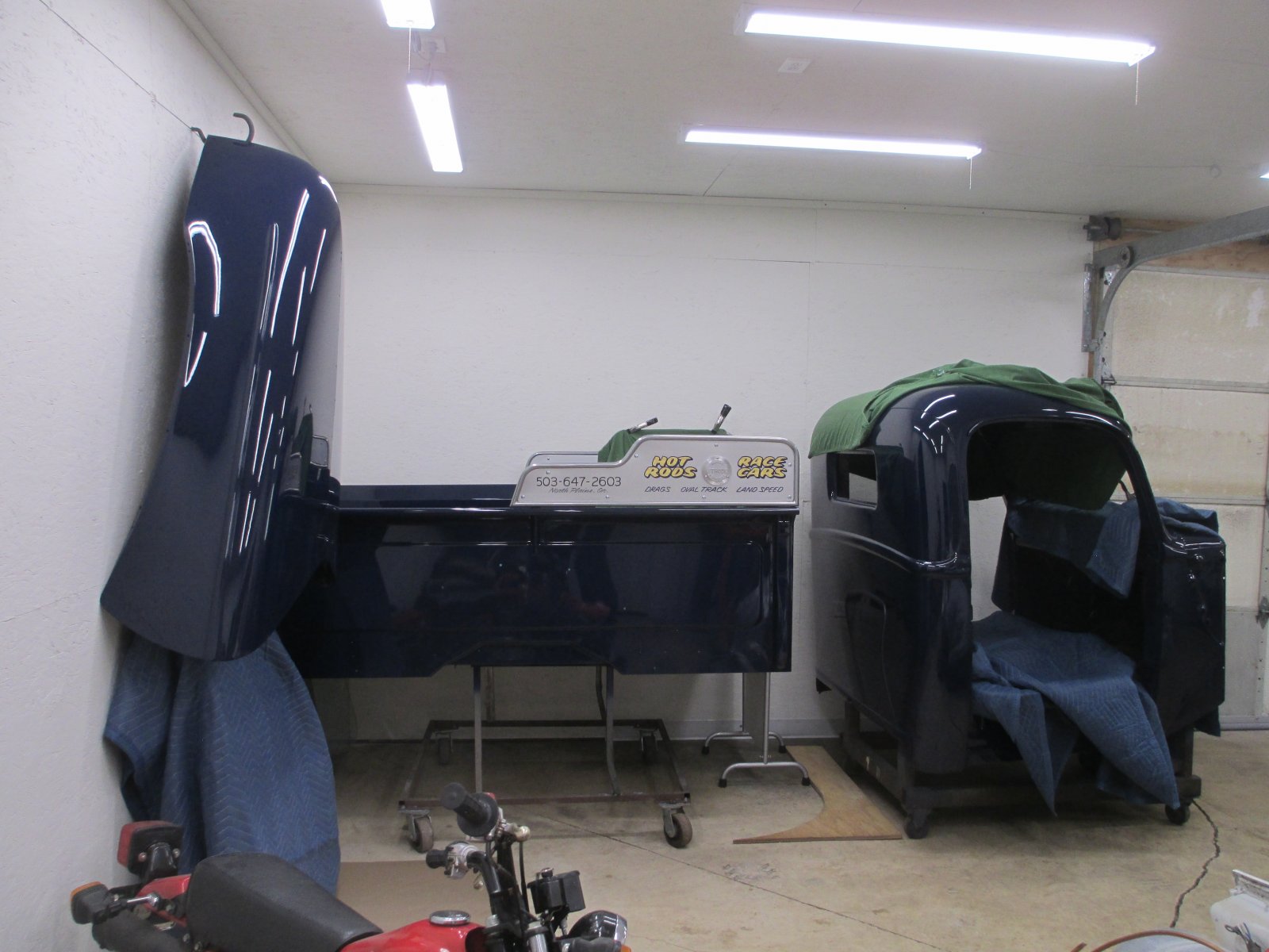

    I spent the morning transporting painted parts for my '40 PU, and the afternoon getting the ch***is out of storage, for completion this Winter. IMG_7942.JPG IMG_7945.JPG IMG_7946.JPG

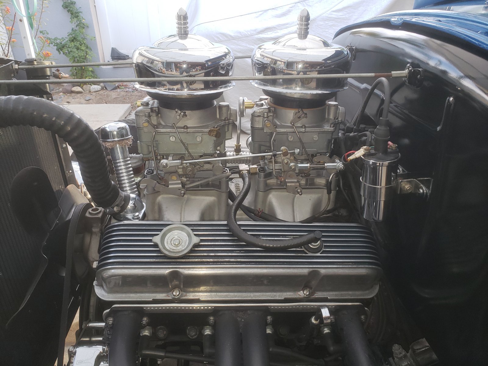

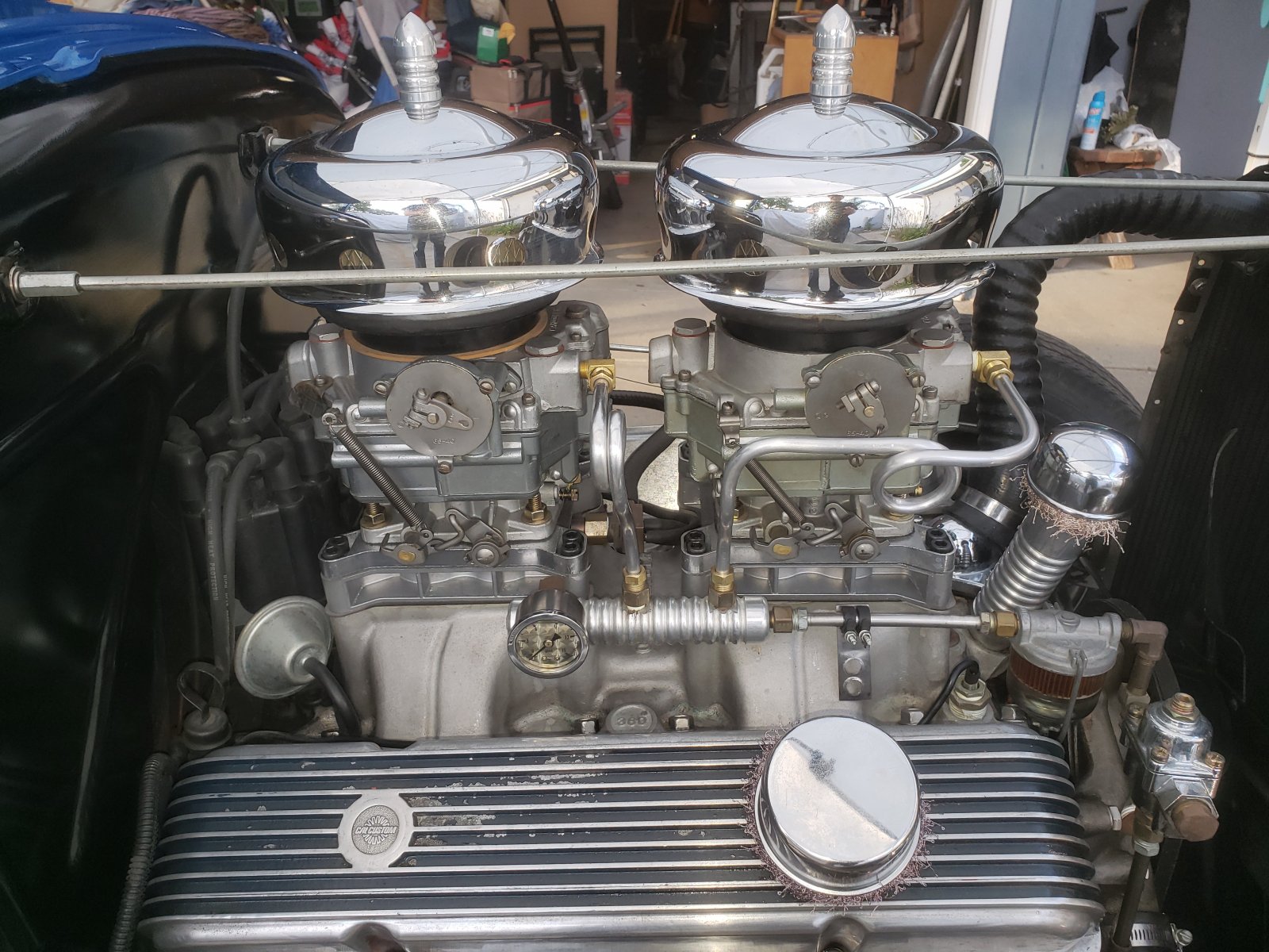

    Spent a little time dialing in the new dual quad carbs, it was loading up at idle, causing the engine to stumble, and blowin' some black exhaust when clearing it out. I leaned out the idle air/fuel screws a little and smoothed out the idle, I'll probably have to mess with it more but it's running better now. Then I took her out for a full tank of gas, 9 gallons worth, at the cheapest station in town, $4.09 per gal. (be careful who you elect to your state government....) That's up over a dime since the last time I filled it. Anyway, brought her home and wiped her down, ready for the poker run tomorrow. I'm hoping she runs good when were out there a****st all the other hot rods.
    I also brushed off the 47 coupe and wiped her down good. She'll have to wait till Sunday to get to stretch her legs.

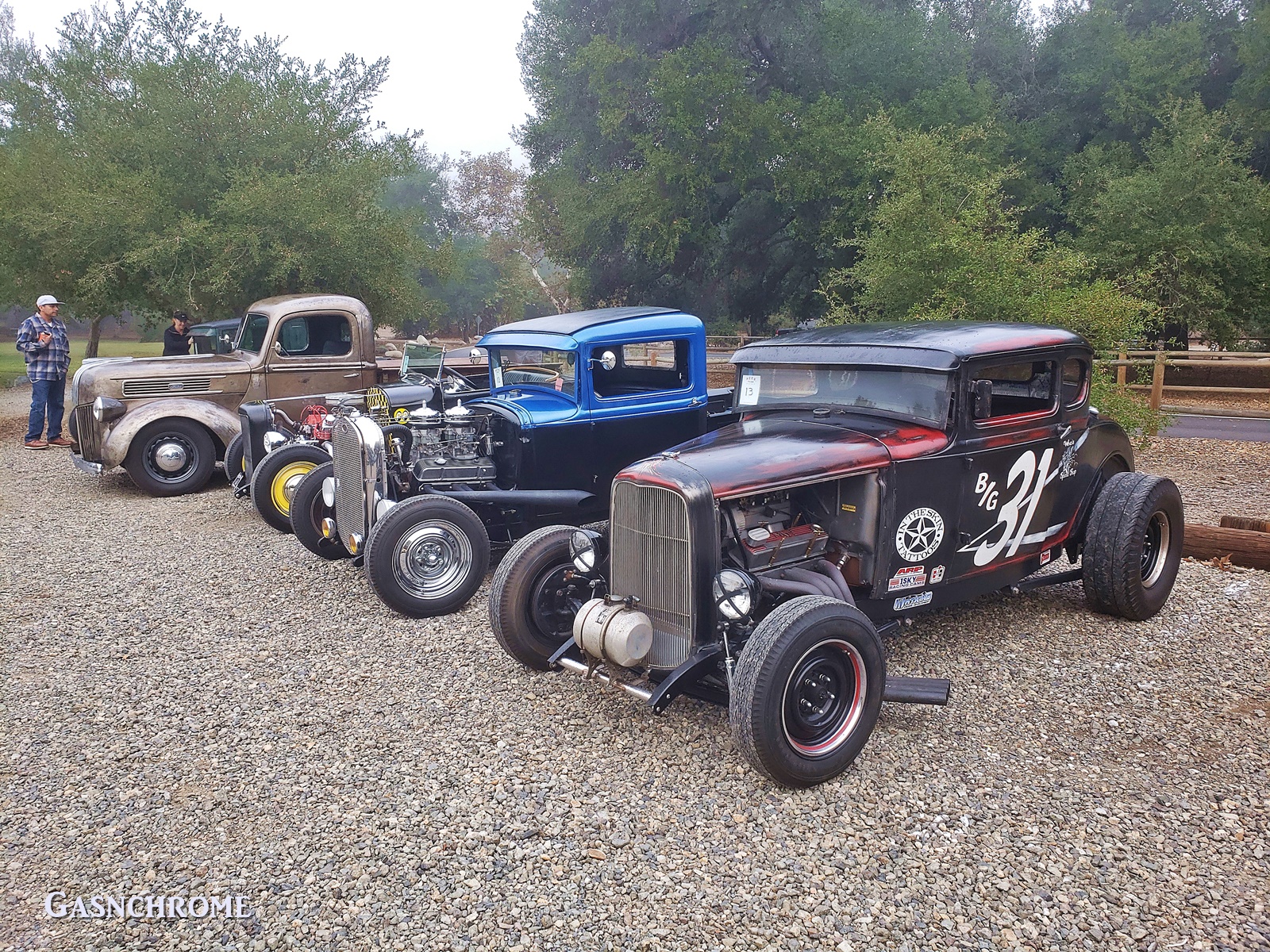

    Oh yes! Took the pickup on a poker run this morning, first outing with the new carbs, Damn, it runs good! Really stoked with the way these worked out. Not perfect, but really close, and damn it sure runs better than the dual 2 barrels I had on there before. Really responsive, very smooth, no hesitation; well, maybe a little here and there, but much better than before, pulls cleanly in top gear from down low, and really strong. I'm feeling good.
    I'll post more photos later, maybe a separate thread, here's the lineup when I got there.

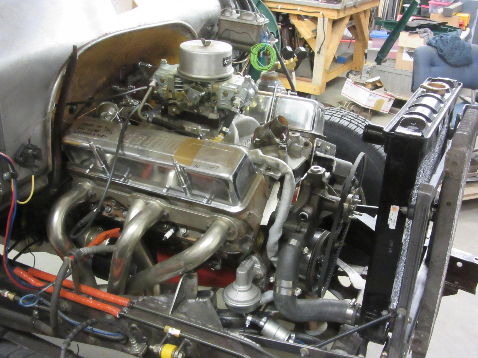

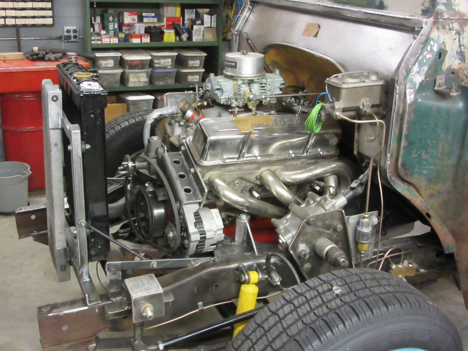

    I am still moving forward. I finished the radiator support and got the radiator and the trans. cooler mounted. I need a upper hose and some plug wires, a battery ( they have went through the roof ) and a few other odds and ends I am still undecided about a fan I am leaning towards a clutch set up if it will fit. studebaker build 006.JPG studebaker build 007.JPG studebaker build 008.JPG And I have to make a driveshaft loop. Then it will be on to putting some brake fluid in and see about getting some stopping power!

    - whatever fan you decide on be sure to install a full fan shroud - that large trans cooler location may block/disrupt direct air going through radiator

    Yes , a fan shroud is on the list.

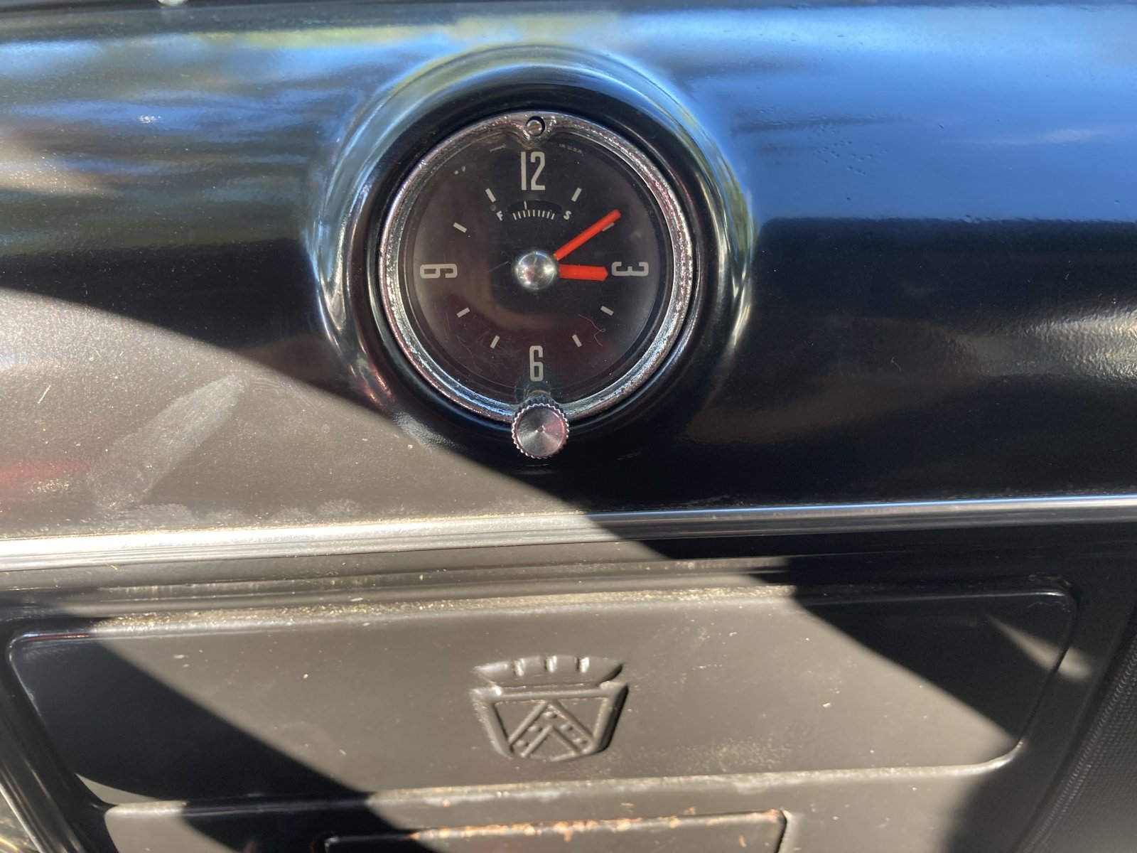

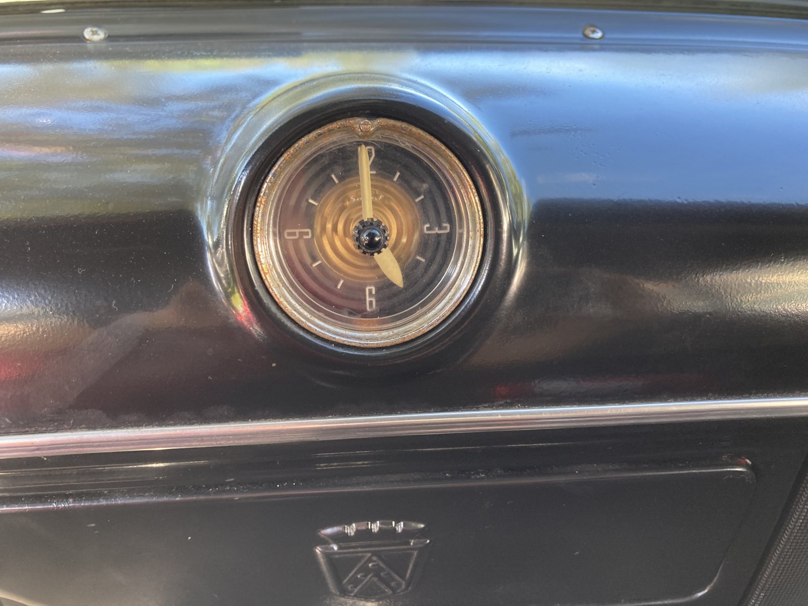

    The clock in my car has never worked. Discovered that an option for my car when new was a stem-wind clock made by Westclox. After a several year hunt, finally found one in good working order. So, I’m now the only kid on the block with a wind-up dash clock! 80DD4E27-B5B9-407B-9686-C03B3E85E5ED.jpeg 7A34B6C3-617D-4FC5-8FD6-697DB6D36C34.jpeg
