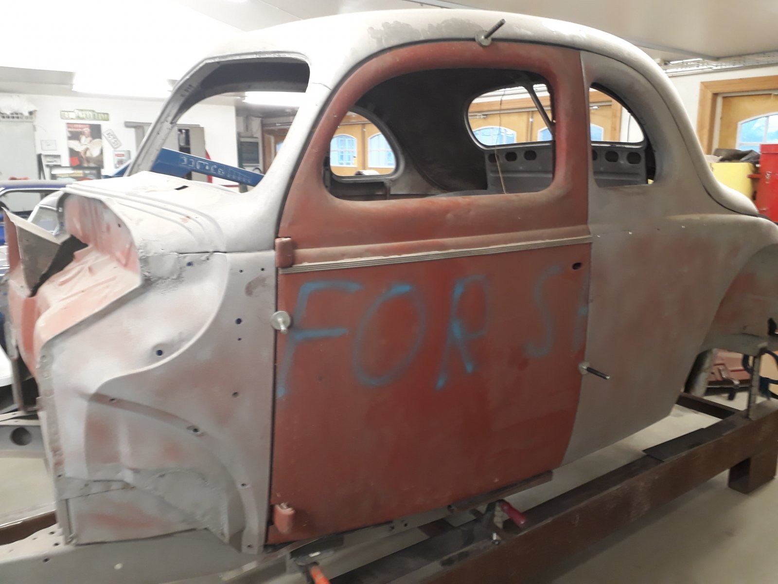

    005.jpg 009.jpg Finally I got the body tighten down to the frame. I testfitted the doors- fitted quite good. Then welded in some tubes to keep the body straight when i split the roof to replace the raingutters.

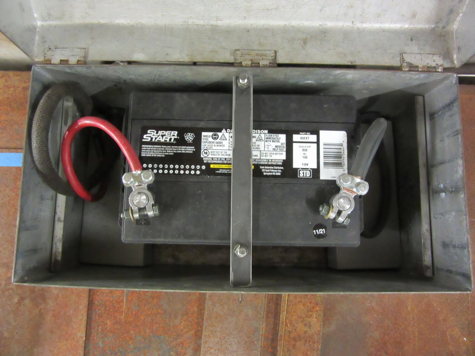

    studebaker build 002.JPG studebaker build 004.JPG studebaker build 005.JPG studebaker build 010.JPG I finished up mounting my battery in the homemade tool box. Right now all I have as far as a wiring harness is the starter and ignition circuit. They both work as they should , juice at the coil and the starter spins the motor !I had a Taylor cable trunk mount battery kit so I used that. It came with 2 AWG fine strand cable for the positive side and my local Oreilly auto parts had some 1/0 for the ground. The battery is a 65 series with 850 CCA. I still need to vent the battery but I have to come up with the rectangular connector that plugs on the battery. The battery is nice and secure and is not going anywhere unless you put this thing on it's top ! then you will have other worries. Should be just right for spinning around in the intersection. Next Saturday is the goal to fire this pile up

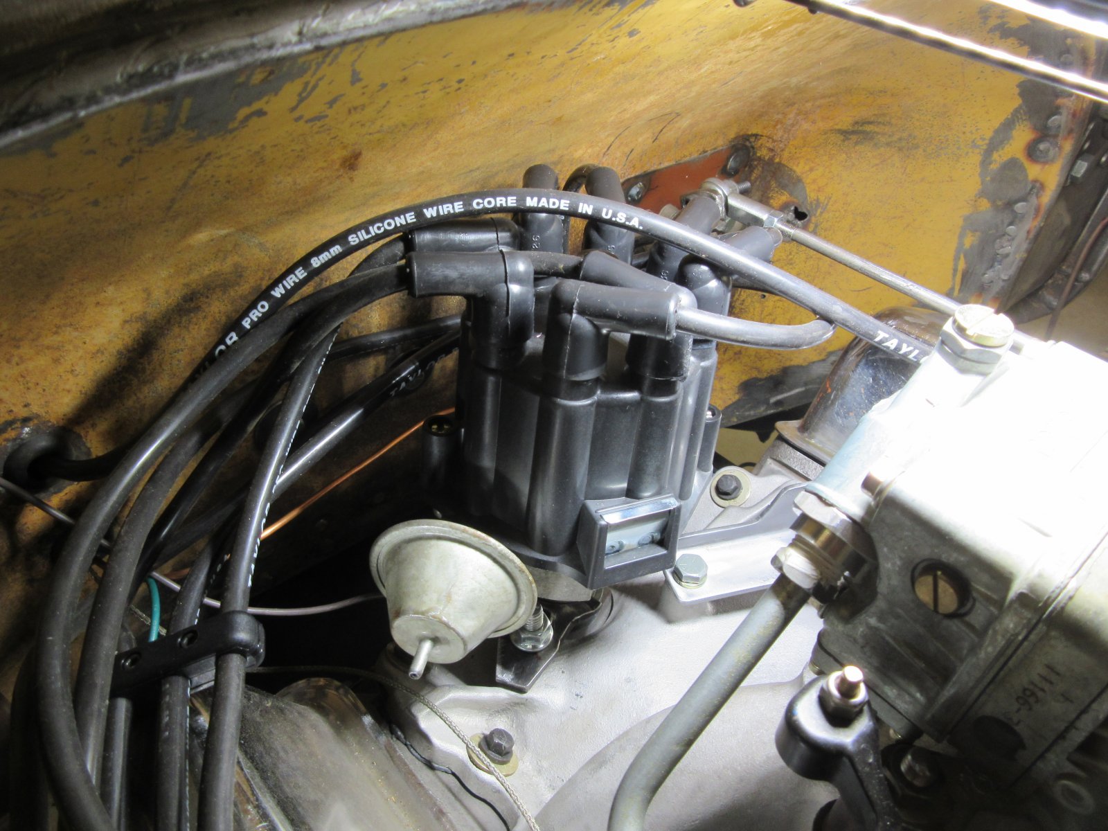

    Almost there, I still have to put the dist in time and fill the bowls with some fuel !
    Installed some nice Taylor cable studebaker build 001.JPG USA made solid core wires.

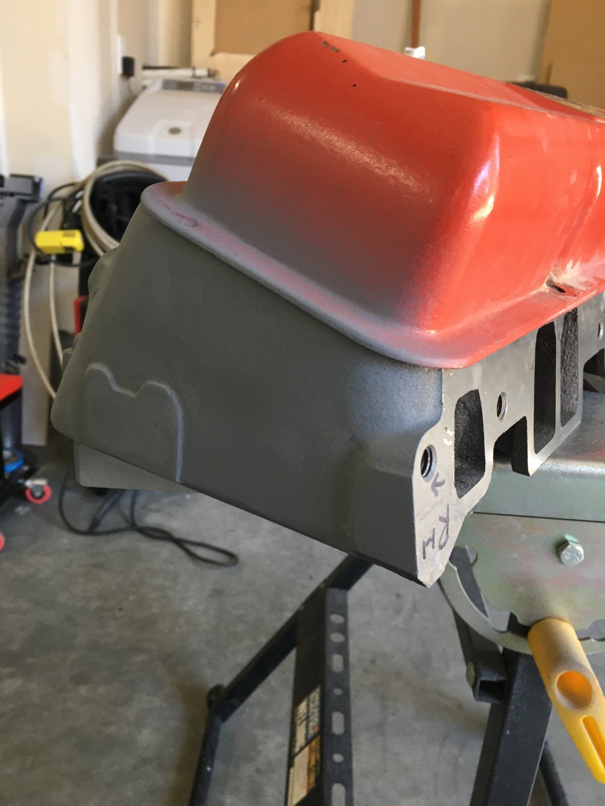

    6E5D55A8-CD91-4D06-B292-1834BBCDD004.jpeg C8CE3264-B0E2-4CE4-A9DF-753B57C19BB0.jpeg
    Good eye! I was going to use a 327 until I researched the cost to overhaul it. Quite expensive to say the least. My wife, who loves to find a bargain, came across a deal from Jegs, 290 horse 350 delivered for $1300. Even has a 3 year warranty. Being on a fixed income the cost prevailed. However being an old hot rodder I disguised it a bit. I almost cut that tab off behind the pump. My build is a fibergl*** body so I figured anything goes. Found some valve covers on the local Craigslist, they came off an original 62 corvette. Turns out the are kinda rare. So I decided to use the crate heads but love the camel hump markings. So again I got creative. There’s more, Gl*** ‘32 5 Window build thread has most of the details!

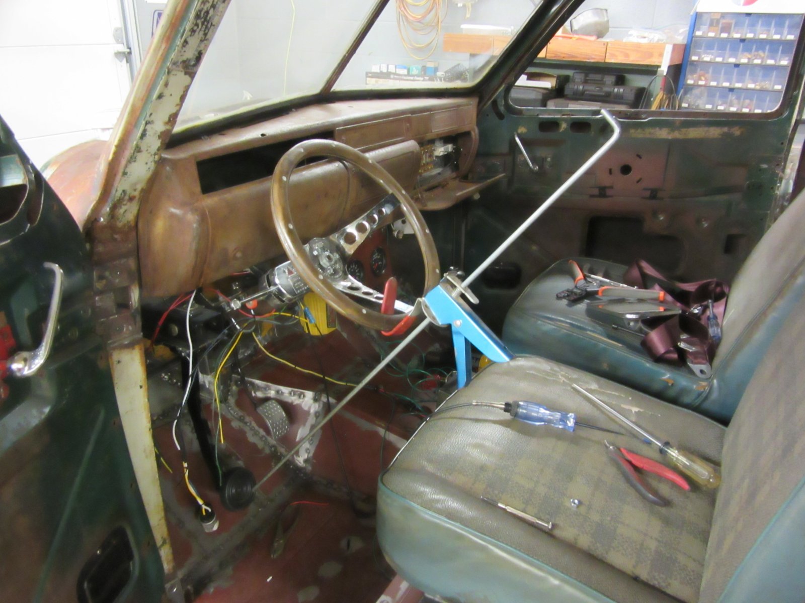

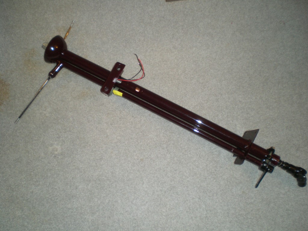

    Been slacking; but I finally added the back to the shortened glove box liner and after trying it out in the car found it was too stiff to flex into place. Ended up making the third version of the support strap for the heater to get it in place.
    On to better things; I gathered up all the parts for our '47's steering column and got them together with minimum paint gouging.
    The signal switch acted up and while it tested OK before it didn't work once in place. Took it apart and sanded down the contact block, guess the pressed fiber stuff swelled up over the past 74 years since it left the Lincoln factory.
    Going to have to get serious about knobs soon; was thinking about laminating maroon and white plastic, or maybe getting some repop Merc knobs and making shift and signal knobs to match.

    Those 62-63 covers are rare; seldom see them at a swap meet, etc. The following years had arrows stamped on either end of the decal box.
    The thing that got my attention was the lack of crankcase ventilation. The 350 works best with a breather cap on one cover and a PCV valve in the other, connected to the carb base. You have a breather tube on the intake but I don't believe the 350 blocks have an open p***age way to the crankcase underneath the intake. Fresh air flow through the crankcase will be minimal at best. But the detail work is great.

    488230FF-44F0-4855-8D02-63EBE6C1DDDD.jpeg 0351D299-8254-41B5-8891-2908C03C3C68.jpeg B2847416-0024-41AB-BEF0-824893113A87.jpeg
    There are two fairly large openings down to the crankcase area. Also between each lifter bore. One in front and another next to the distributor. Having said that this is an experiment at best! Too much pressure or oil vapor and the 62 valve covers might hang on the wall! I also have a PCV valve behind the carb connected to the carb with baffles under the intake and a windage tray in the lifter valley. I am surprised I didn’t get **** for the fake camel bumps !!!!

    That looks awesome. That's definitely the way to do it if you're trying to run smooth valve covers. I'm going to be doing basically the same thing in my SBC here soon, except I'm using a baffled grommet and a push in breather. Makes the hole in the intake bigger (1.125"), but does the same thing you did. I love how you put the baffle in the bottom.
