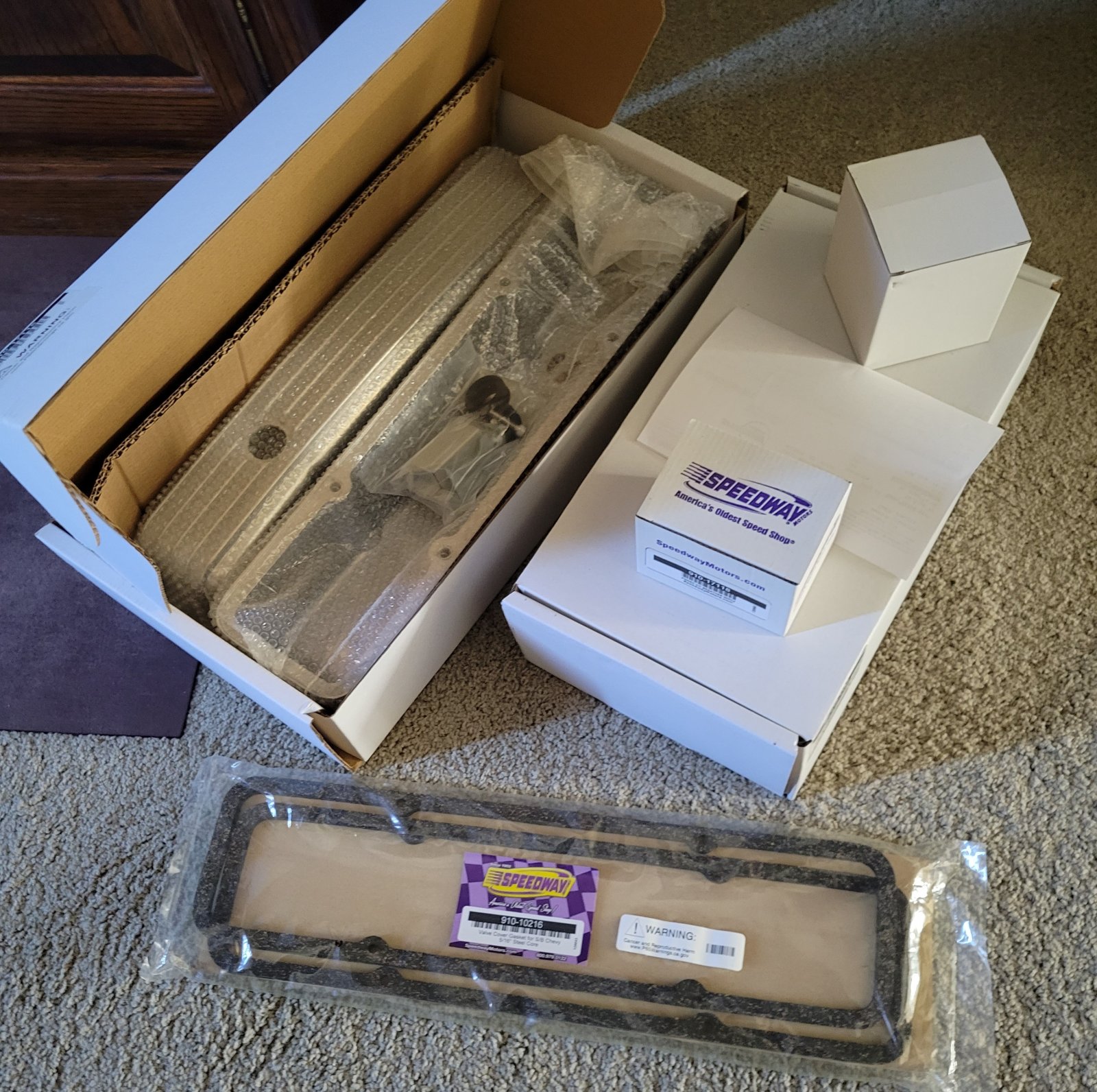

    Replaced the worn 15" air cleaner and rocker boxes (oops, valve covers) that were slightly rusted and replaced them with new, plus filters and breathers.

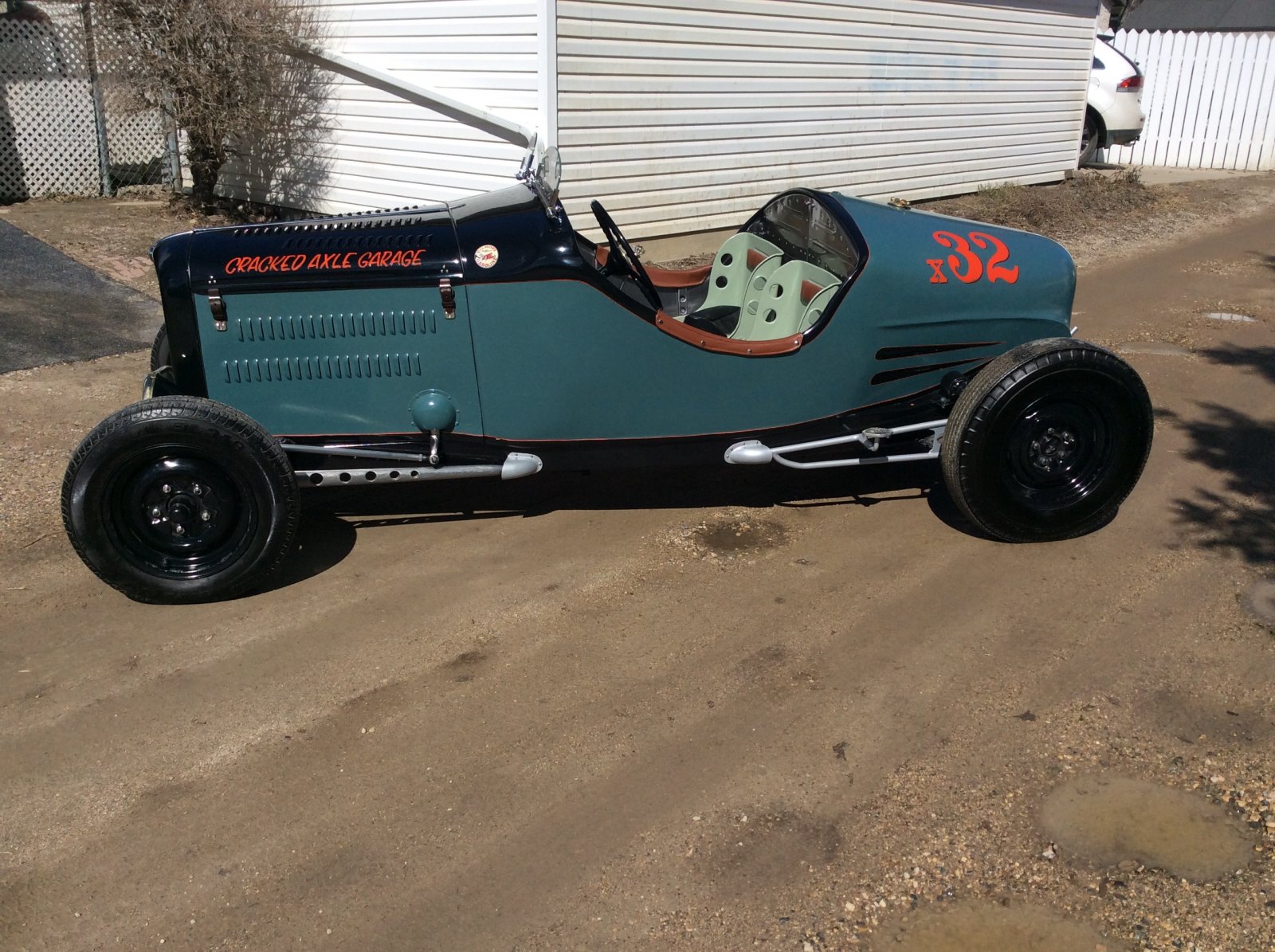

    E4F59A5B-34DC-4EE5-800A-0444B16B9BA1.jpeg 9CA46B91-9351-4C14-8FEC-C70A73E2E3E0.jpeg 64F52EB2-2227-4D16-95EE-A86984524CA5.jpeg Got the speedster lettered.....

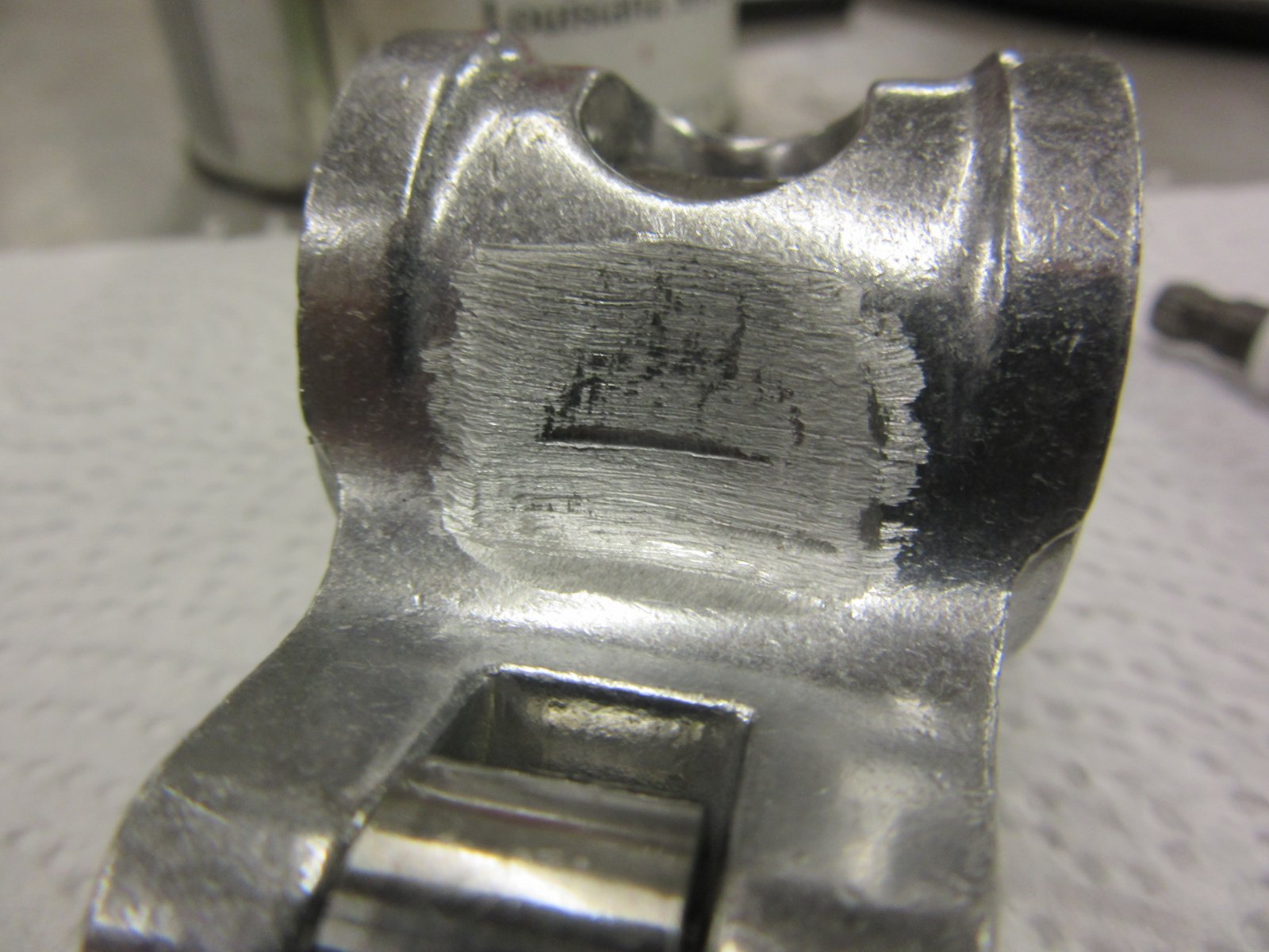

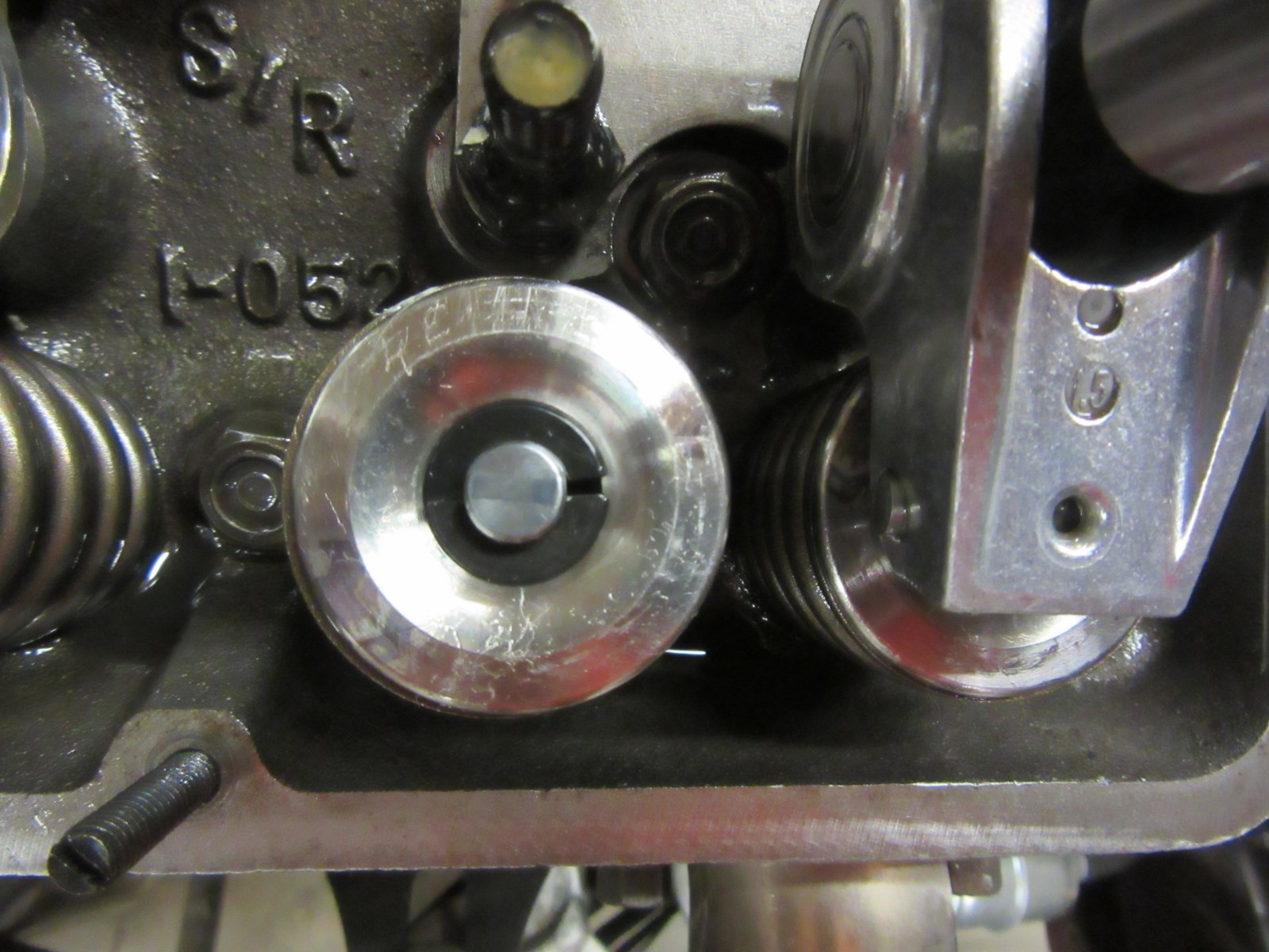

    Got the Stude off the ground to look things over after putting a few miles on it. All is well, no leaks and nothing loose. I had all the rockers off the motor after a little run time and had 2 or 3 touching the retainers. Clearanced those and ****oned it up. So after driving it some and spinning the motor up a few times I thought I would take another look at them. There were 3 that had a slight witness mark so I touched those up and changed the oil and filter will I was at it. The good news is the valve adjustment was still spot on ( no cam wear ) and the rockers are running dead center (maybe a little to the inside of the valve tip ) I like to see them about 10 thous. to the inside myself. So my white lithium grease and a mix of 20 year old Kendall GT 50 and a couple qts of VR1 60 on my used flat tappet cam with the used lifters that were tossed in a box has made it through 20 gallons of Cam2 so far !
    My new blend is some 40, 50 and 60 weight ZR1 ( they used to make some off road ZR1 but I am out of that ) Any oil is better than no oil ! IMG_0351.JPG IMG_0350.JPG IMG_0354.JPG IMG_0349.JPG IMG_0355.JPG IMG_0356.JPG Got it back on the ground my Bride came out and said "take me for a spin" so we went for a little ride. Plus all the plugs looked great ! I got a 750 Holley on it. It is/was new a few years ago. It was run on the dyno taken off had the bowls pulled off and dried out, set on a shelf with a rag over it until it was p***ed along to me. I bolted it on without touching it and it runs super. Pretty amazing really that the pumps hadn't turned hard. You know the old saying "**** it ! run it !

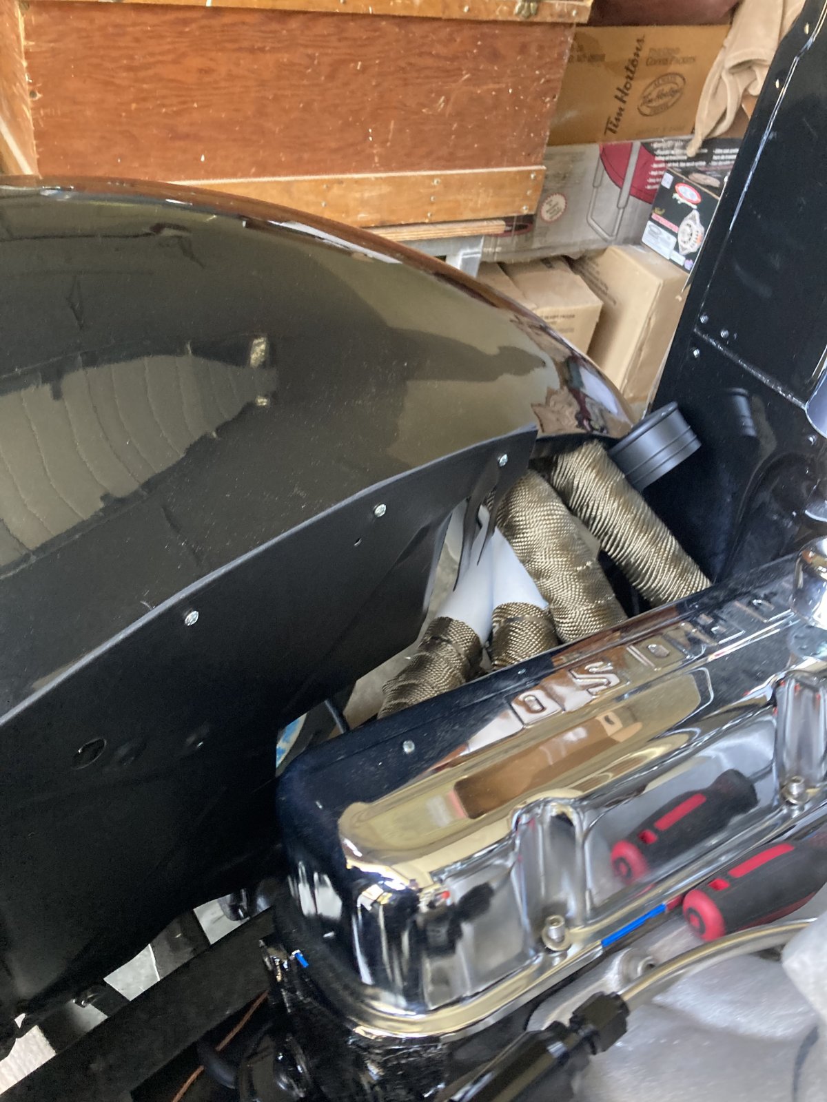

    Added a new set of ceramic coated lake headers to the hot rod today.

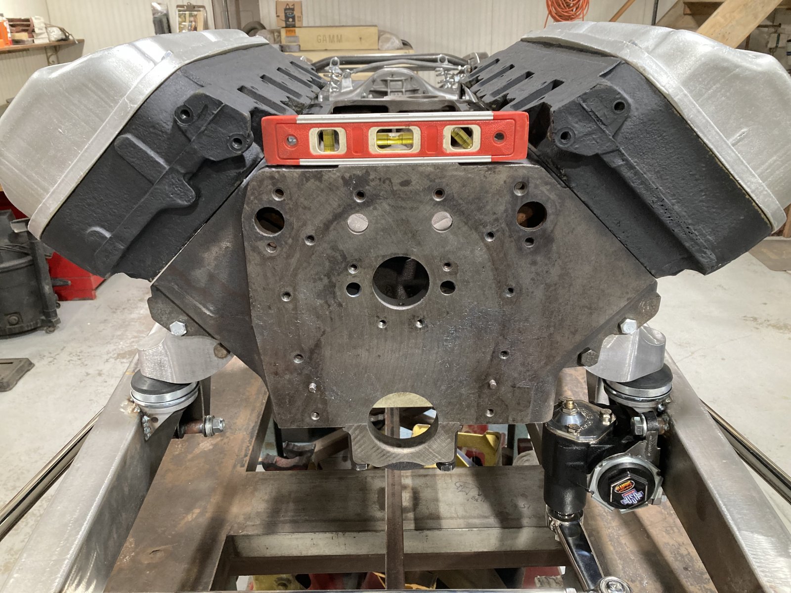

    IMG_0137.JPG IMG_0138.JPG Made the drivers side motor mount, lots to clear and make as much room as possible for the exhaust. I may add some holes to it in the future. It's made from 5 pieces of 3/16" flat stock and no it's not a solid chunk. Thus why I may add holes to it. Edit: both sides now done, time to move rearward to the transmission ans frame x-members. IMG_0140.JPG

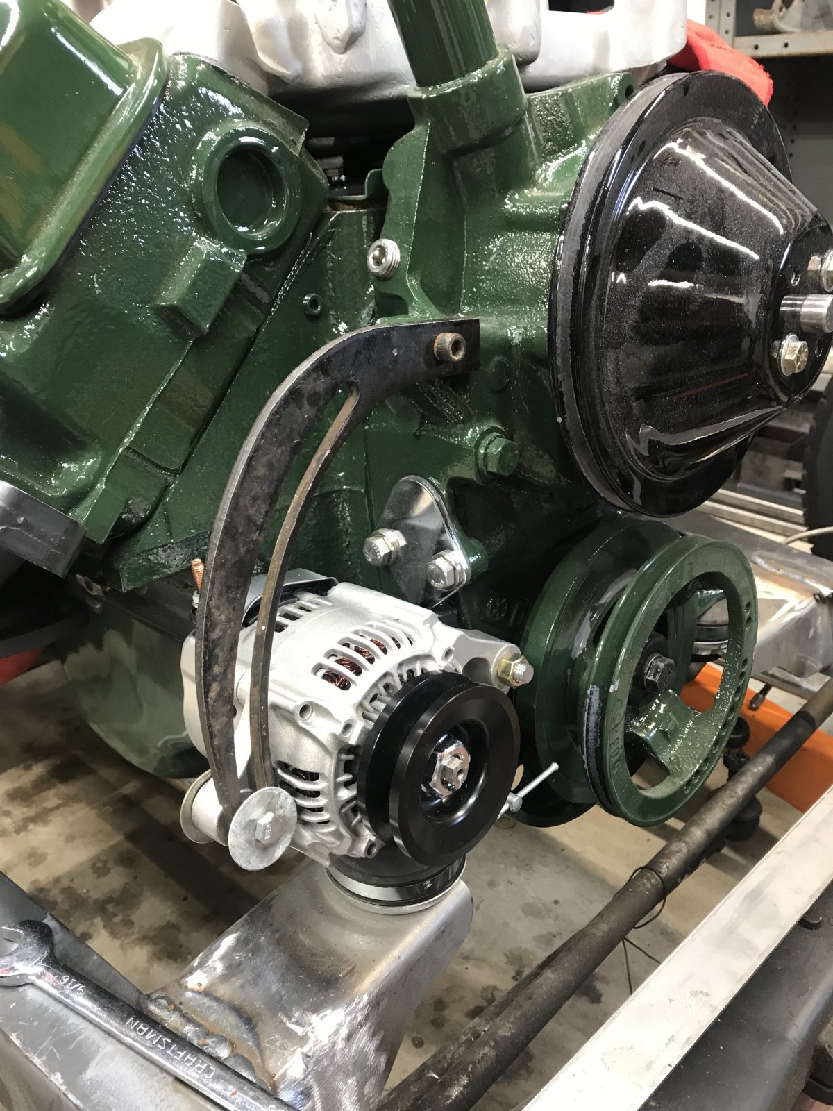

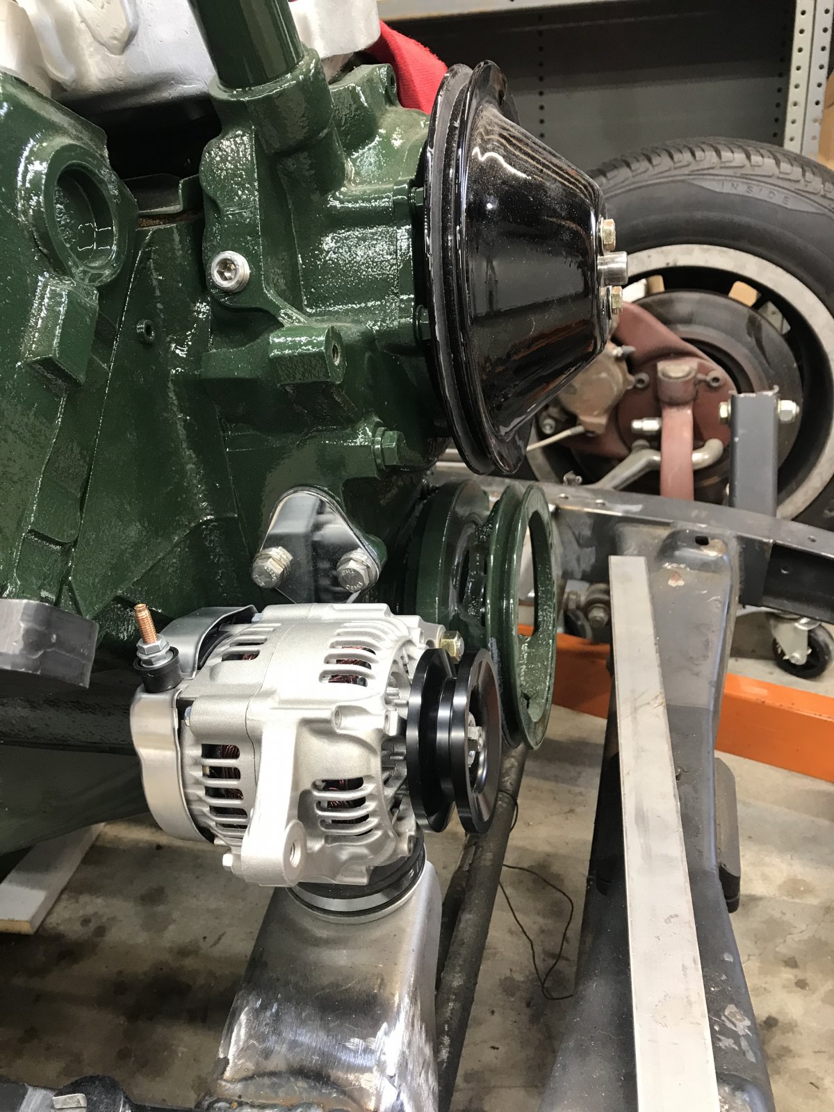

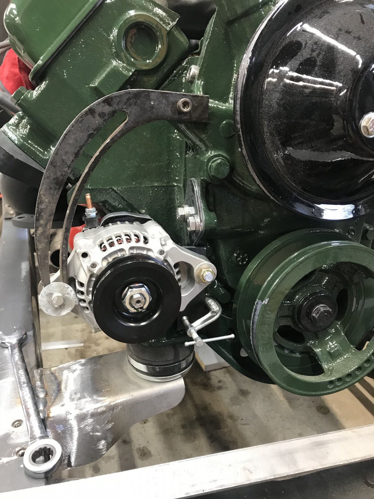

    Mocked up my alternator, not sure if I like it. 8050F8C6-6201-4476-A7B5-5EC985BF4609.jpeg 56C4C177-A050-4BE1-8F20-3A10EBFB790E.jpeg F90C9EE7-C087-4A06-94ED-31508254CB66.jpeg

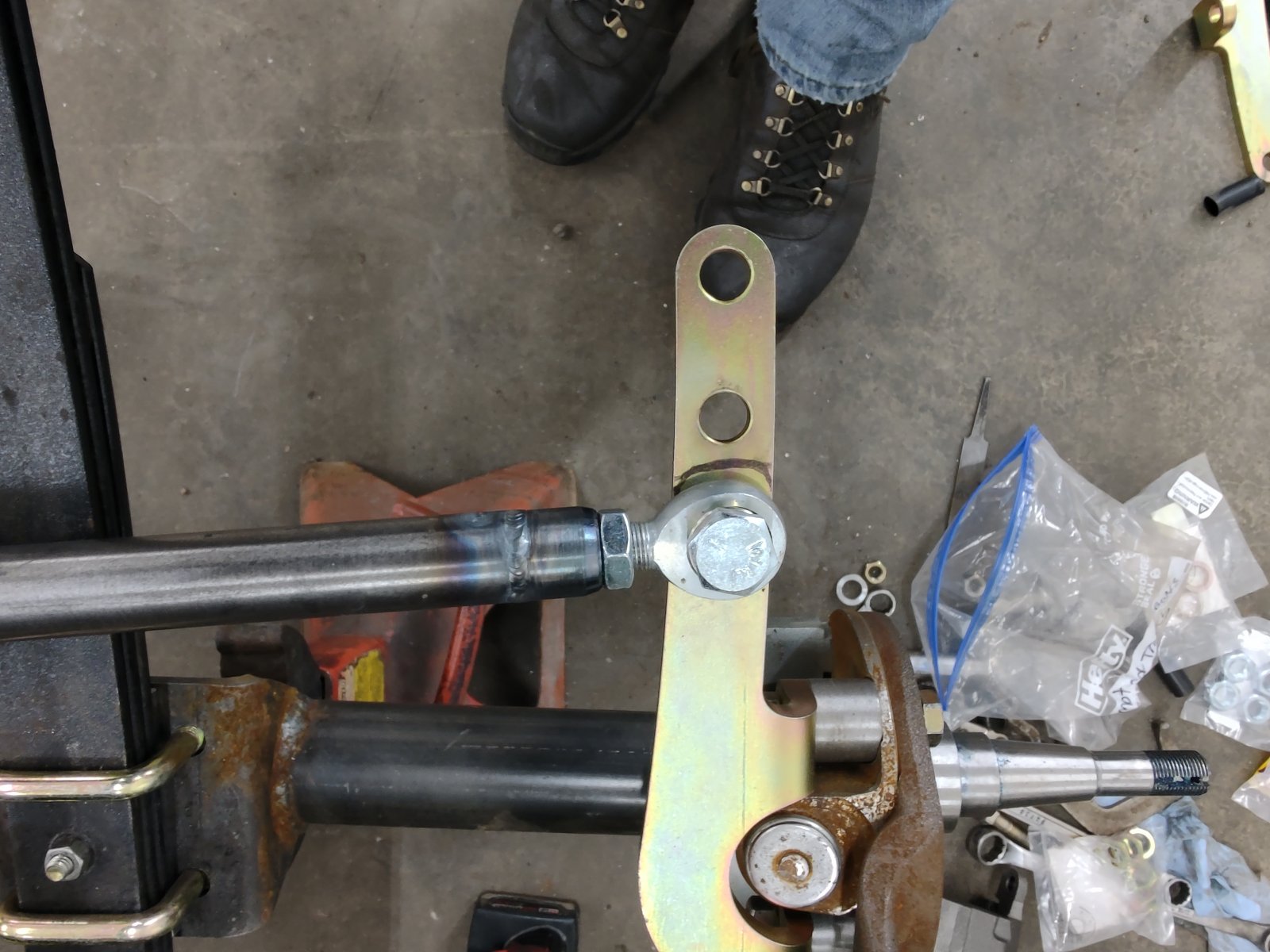

    Welded up the drag link for the Olds. Had a friend help me with it. Can't seem to hold steady as I use to with a tig!! IMG_20220426_200342587.jpg IMG_20220426_200336109.jpg

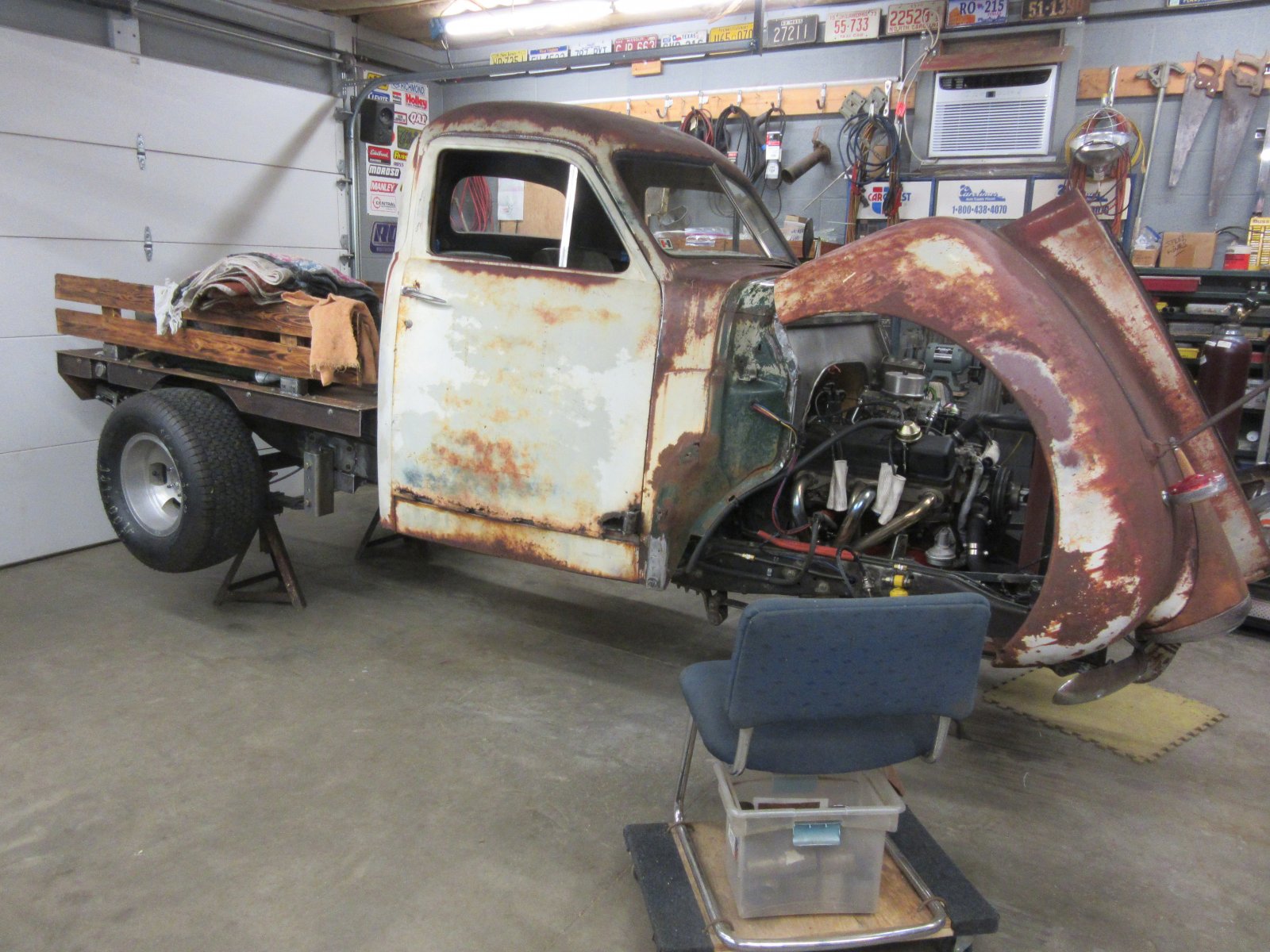

    Finally getting the wiring straightened out on this one so it can go back on the road:

    About 3 years ago I changed my valve springs and retainers in the car because some touched. I found some bee-hive style springs and retainers in the Compe***ion Products Catalog that would work with the pressure and lift. Never gave them a thought before that.

    You might try a 55-up V8 Chevrolet generator adjustable arm. They curve at the end only where the slot is and are flat. You’ll need to cut it shorter and drill a new mount hole. I’ve used them on a lot of close mounted alternators
