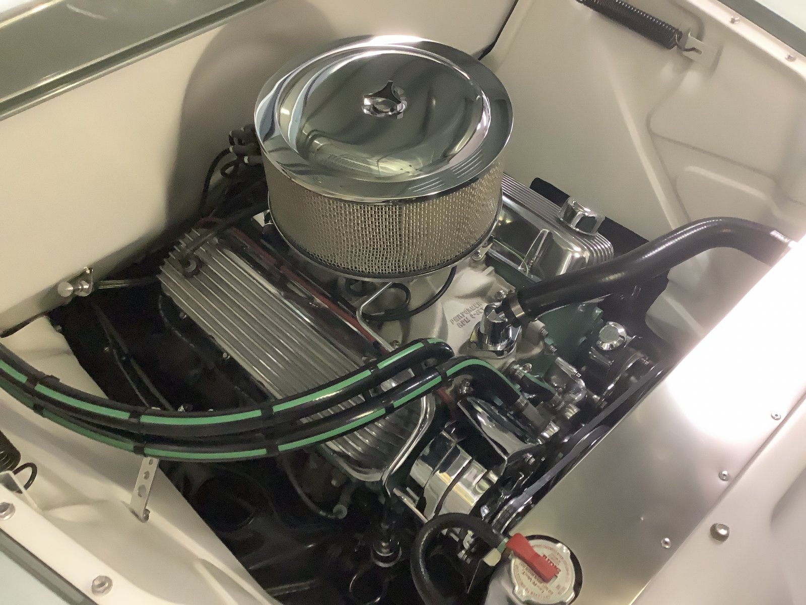

    It rained all week, and looks like the weekend is going to be a washout as well. I got the garage picked up and spent a few hours detailing under the hood. I’m running out of stuff to clean…

    I think I see a speck of something on the firewall.
    Oh wait, it's my computer screen.
    Beautiful!

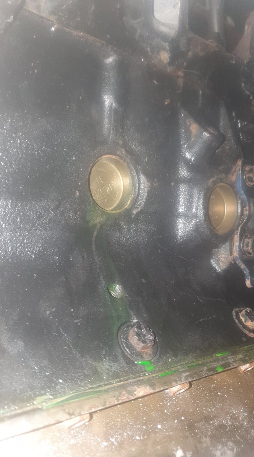

    Distracted from working on the 46 Olds and decided to tighten the header bolts on my FE 64 Fairlane when I felt a drip from above, thinking it was from radiator coolant overflow that had dribbled down and moved along the block to RH side near starter motor. I soon discovered that the engine was rebuilt with incorrectly sized freeze plugs, 1 3/4" size and NOT the correct 1 49/64", hence the weep. 6hrs to remove headers etc, a size 8 foot in a size 6 shoe. Now to remove engine again to rectify as they can't be replaced whilst engine is in car, there's just NO ROOM! :mad: I wish that it was weeping when 1yr ago when I replaced the flywheel and clutch. I've owned car 3yrs and until now it's never been an issue however it appears to be a common rebuild oversight that leads to this issue. 6 x new br*** freeze plugs ordered. I just have to now wait for them to arrive along with new idler arm bushings, might was well replace them whilst it's apart. Rebuilt 9" now also has a weeping pinion and axle seals as well, it never rains but pours.:rolleyes:

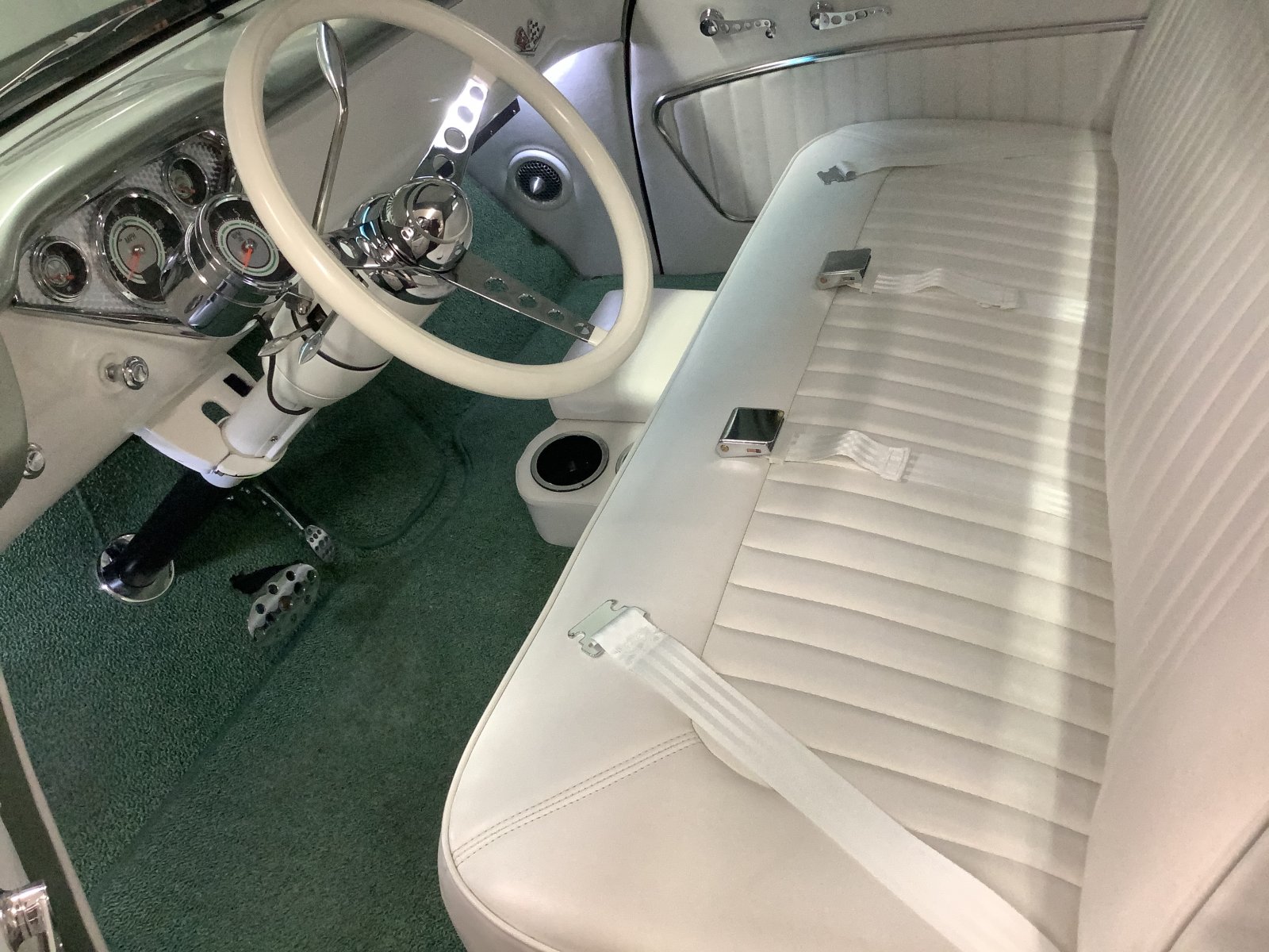

    Then I wiped down the paint and chrome and threw the cover back on it. Besides basic maintenance and cleaning, there was a handful of things to do and the belts were the last item. Now if it would just stop raining…

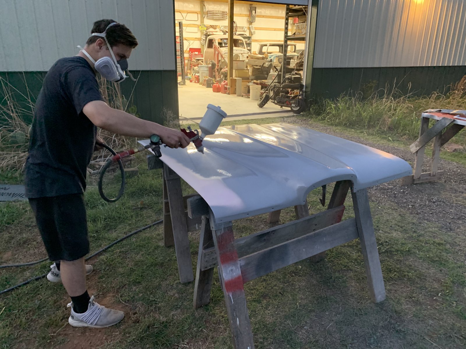

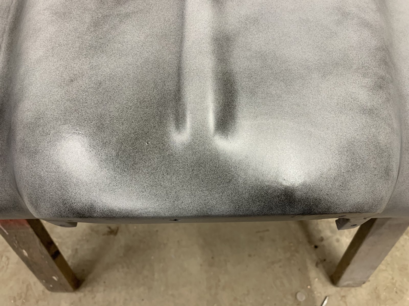

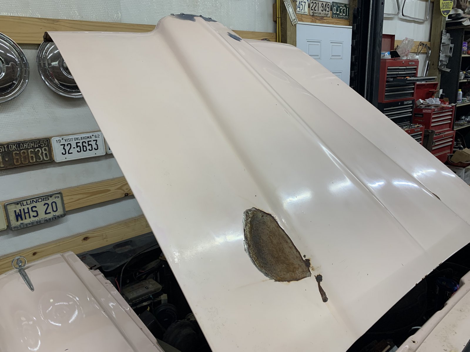

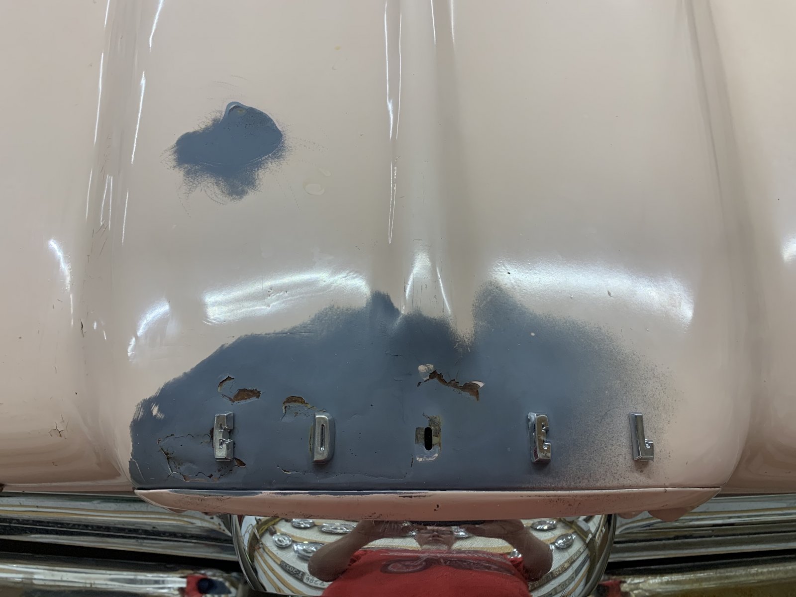

    Yesterday bodywork and priming...today, some painting. I guess technically it is on my kids car, not mine. Doing some repair work on the hood and painting it, the wiper grill, and the wheels. Was reminded he has no patience for bodywork. But, he did weld the holes, prime the hood, and help with everything.

    I think if you have room to take that photo, you have room to replace the plug.

    You have one clean effin' car. What a beaut!

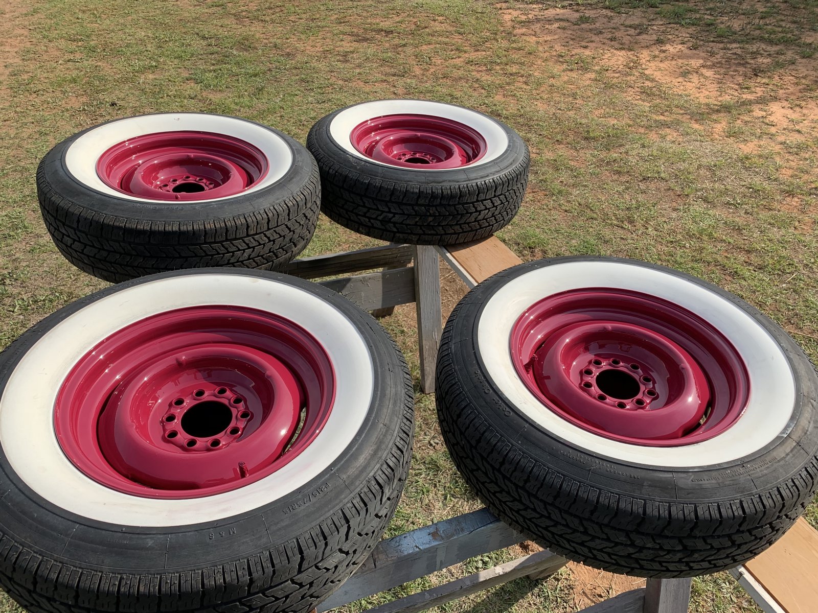

    Painted the wheels for the pink Edsel...

    You can get a hand in there to use a cellphone however the shock towers, frame rails and lower engine mount brackets/cradles soon take up all available real estate, not to mention both engine mounts.
    I could remove the current freeze plugs in situ however I'd need to remove engine mounts independently, there's still insufficient room to use a BFH with sufficient force and drive the new ones in square. A larger wider framed Galaxie could be doable however a unibody is a different story remembering that both front towers were cut back to squeeze an FE into a body only designed for a SBF. Given the wider frame rail width on my OT 66 Fairlane it could be doable from underneath, a LOT more room.
    Trust me, when you see it first hand you'd understand my dilemma. Quicker and easier to remove, repair and drop back in than attempt on a hoist from under car.;)

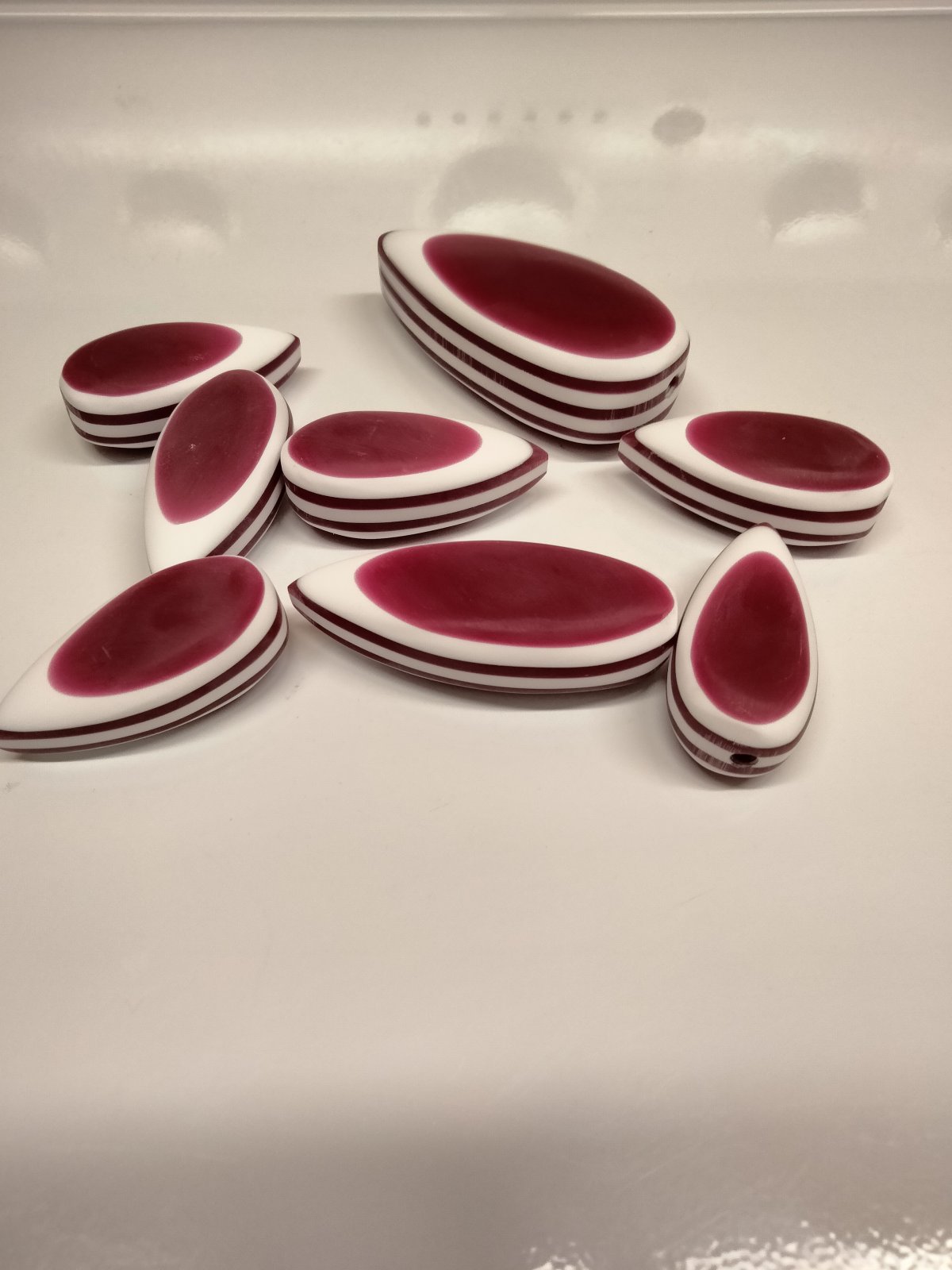

    Hopefully this will be pink shortly. Nothing like painting something a couple days before a car show... :eek:

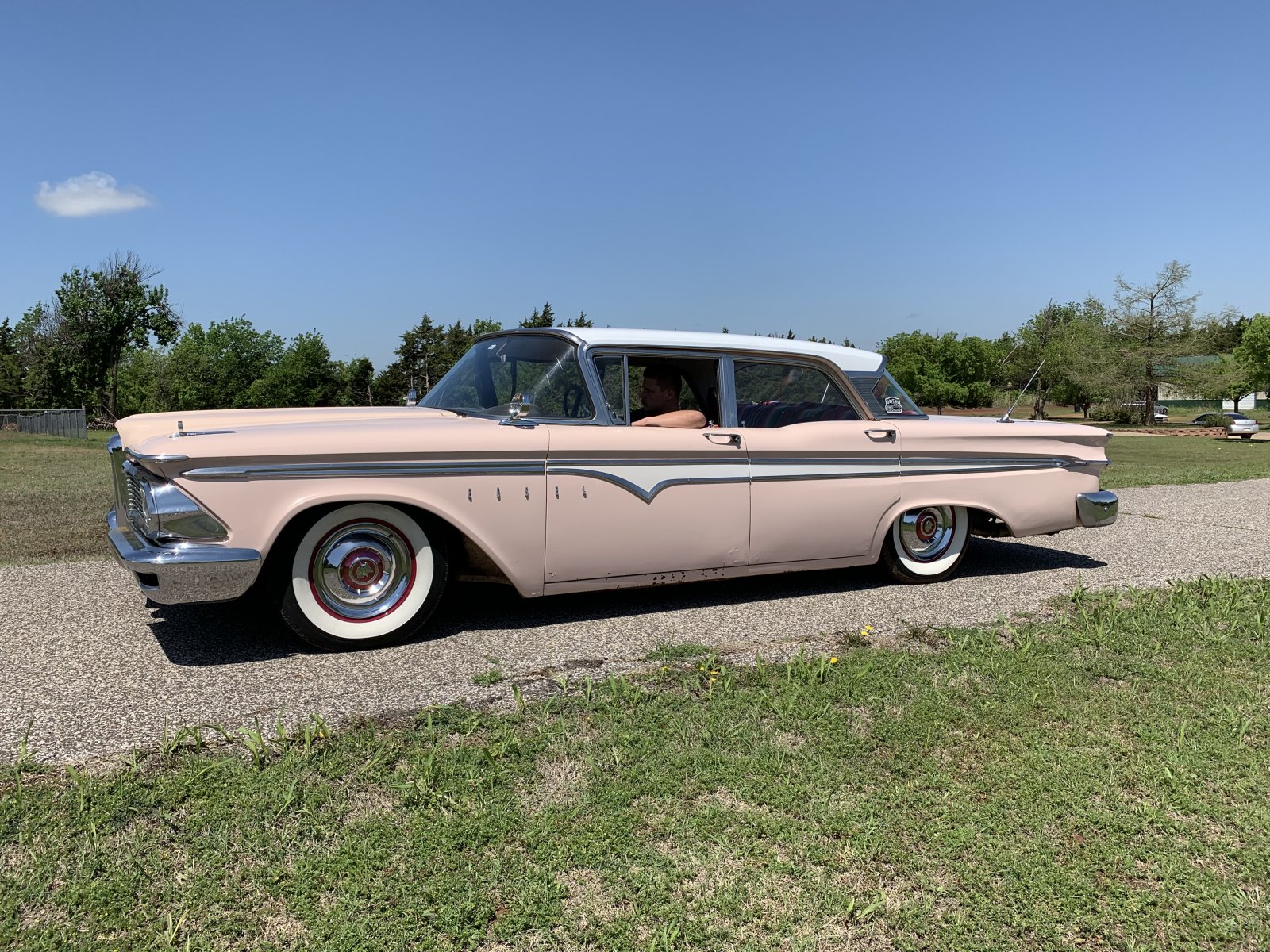

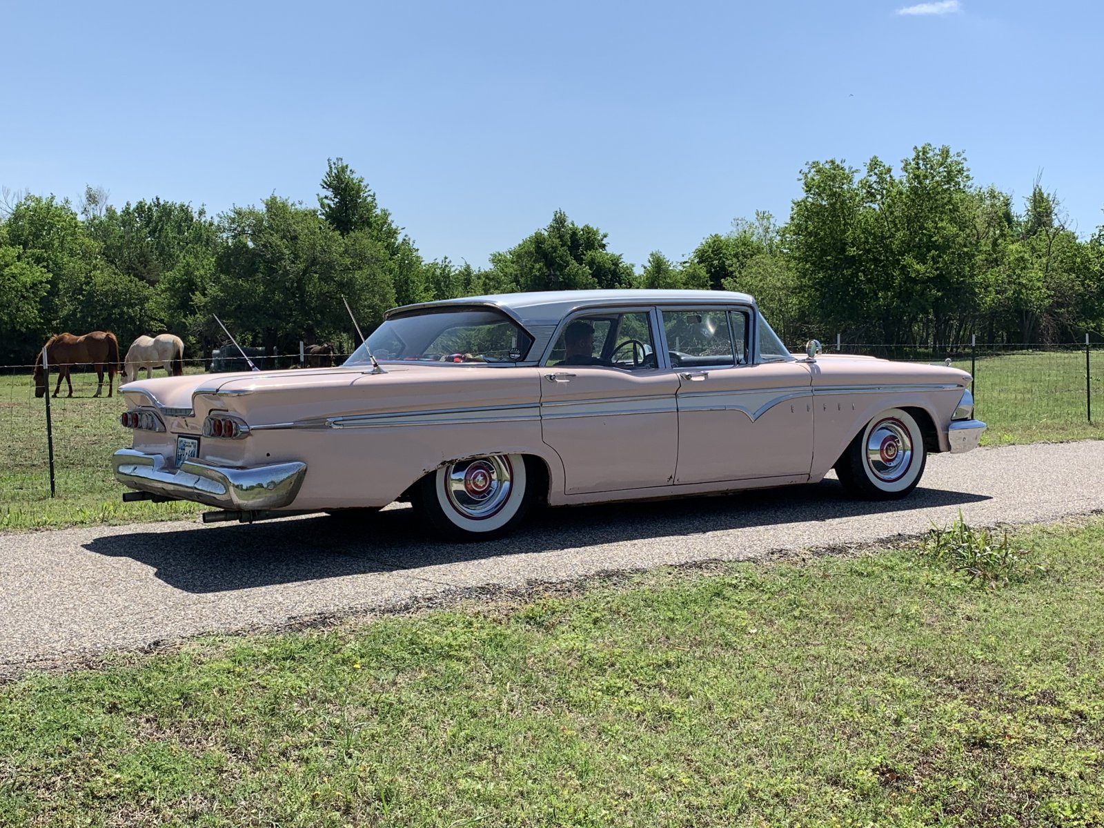

    We finished putting everything back together last night and this morning on my kids beater just in time for him to stop by vo-tech on our way to the Stray Kat 500 in Dewey, Ok this afternoon. Knocked several things off the long list on it this week. Looking forward to a relaxing weekend with my boys and lots of friends. We are taking all three cars (to save on gas...) :rolleyes:

    It's really looking good!
